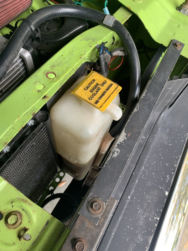

Doing a crate 6.4 hemi into 71 challenger. Overflow tank I have is a quart. I look on line and google says they very from 2.6 quarts to like 6.4 quarts. Depending on what it's in. Truck bigger one. What have others used? I am not sure a 1 quart size would work well.
If you're talking about the radiator overflow tank, I have a 1 quart with my 5.7 hemi. I live in the desert southwest and the 1 quart tank has always worked for me.
