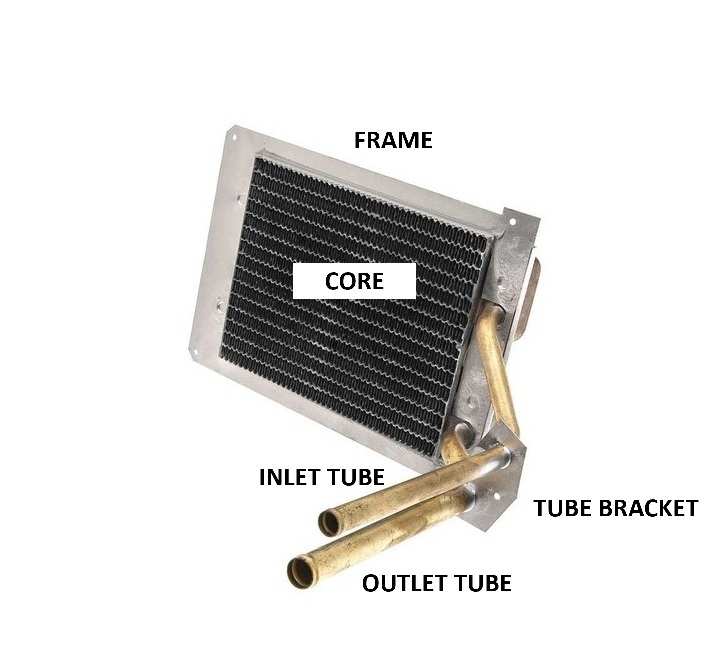

Here's a stock photo of the replacement frame, core, tube mounting bracket, and tubes Generic Heater Core Image.jpg

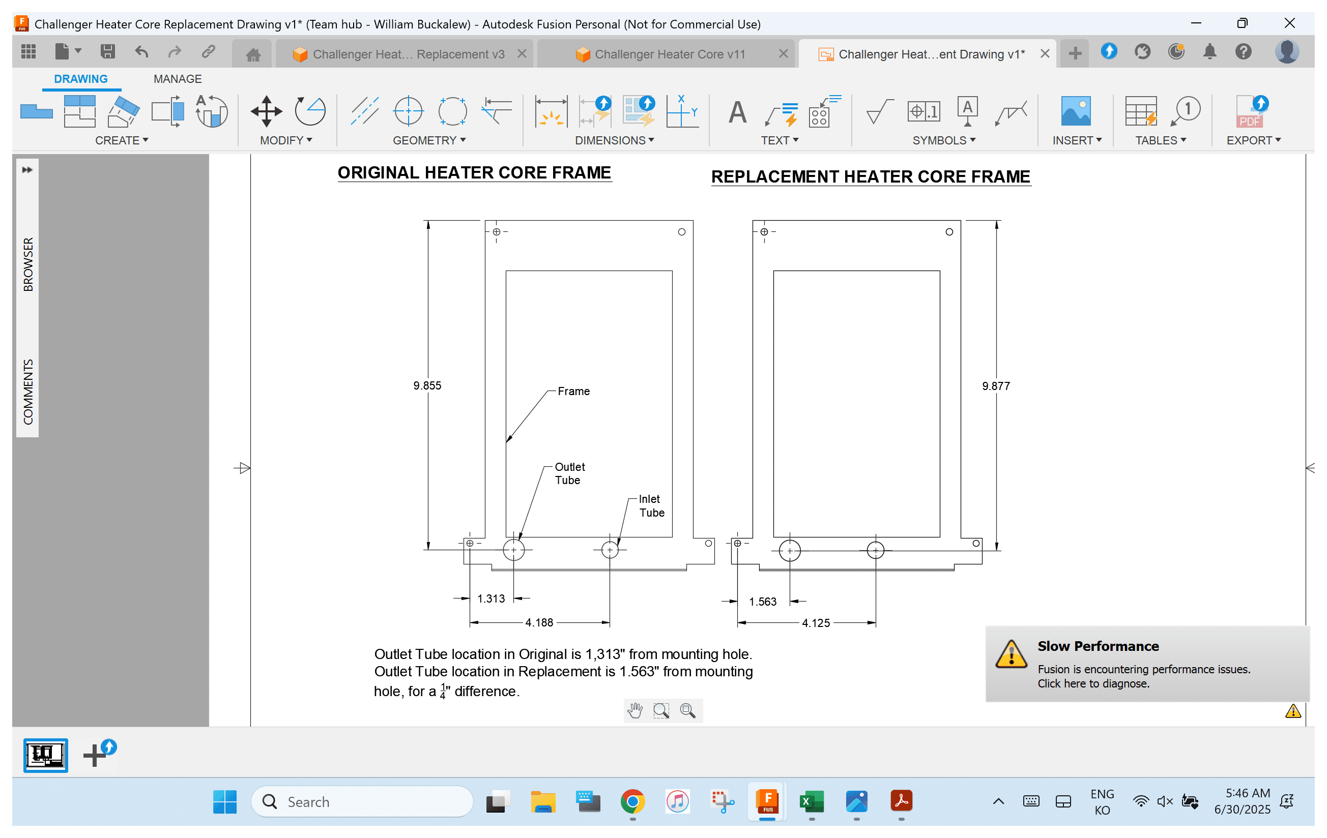

Here's a screenshot of the comparative location of the tube holes in the frame (feeding the header box) - the original vs. the replacement

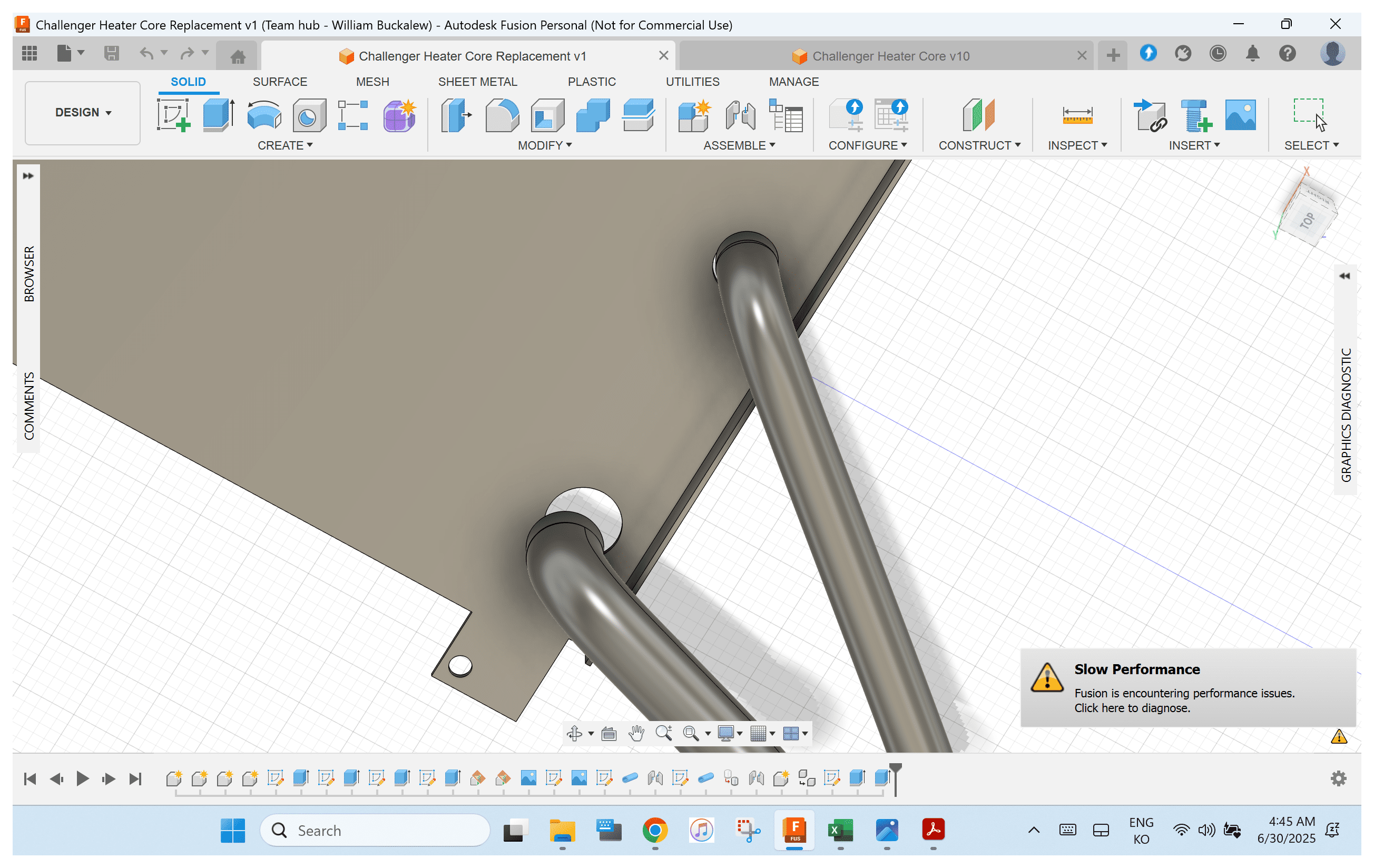

Here's a rendering of the original tube location and orientation as if trying to install in the replacement frame

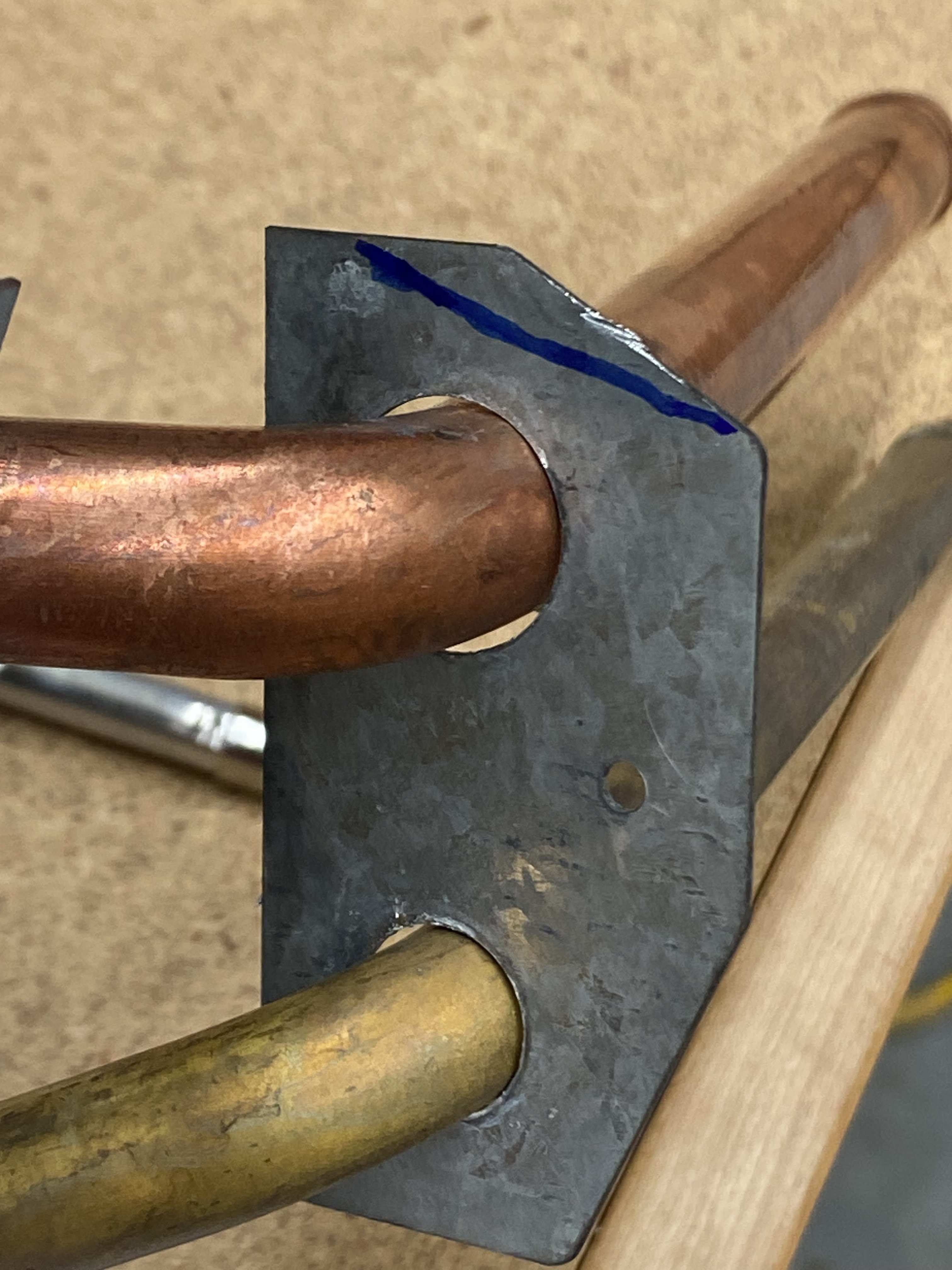

Here's the change to the tube mounting bracket, which goes along with having to re-orient it on the tubes. I removed the outer portion indicated above the blue line

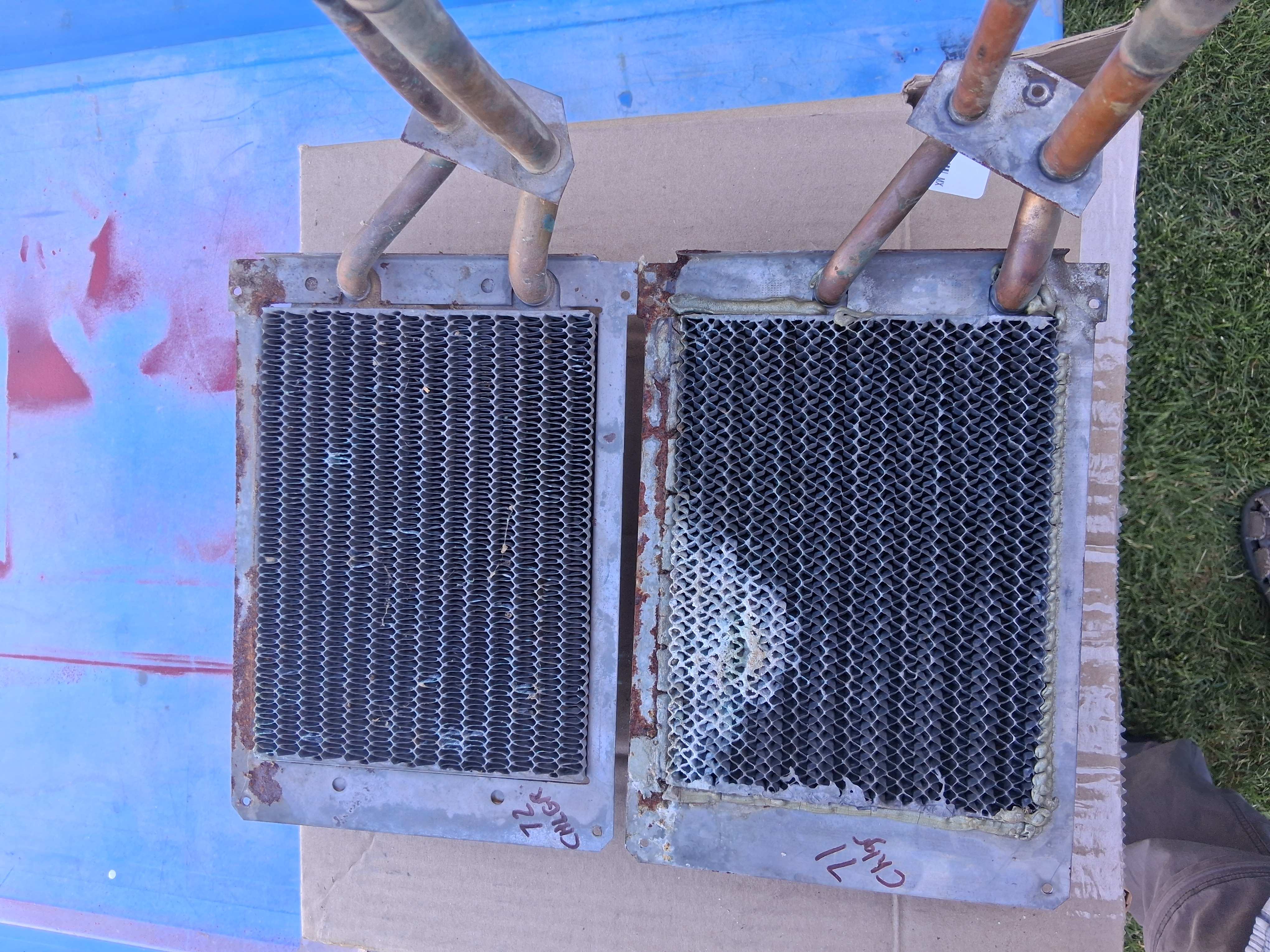

So, I said I would let people know the heater core I selected for my 71 Challenger convertible as I stated in @bill70j other post on his heater core replacement. In my 72, I ordered from Rockauto a heater core, Four Seasons 91508. It fit with almost no problems into the heater housing for my 72 Challenger. It looks great. I have not installed it yet. For my 71 Challenger, I ordered a Duralast heater core 94508. I pick it up tomorrow. I looked at the heater cores I pulled out of both the 71 and 72 Challengers and I don't believe they are original cores, so I won't send them to Glen-ray. I'll let you know how the Duralast fits when I get it. See link for previous posts.
Removing a non-AC Heater Box

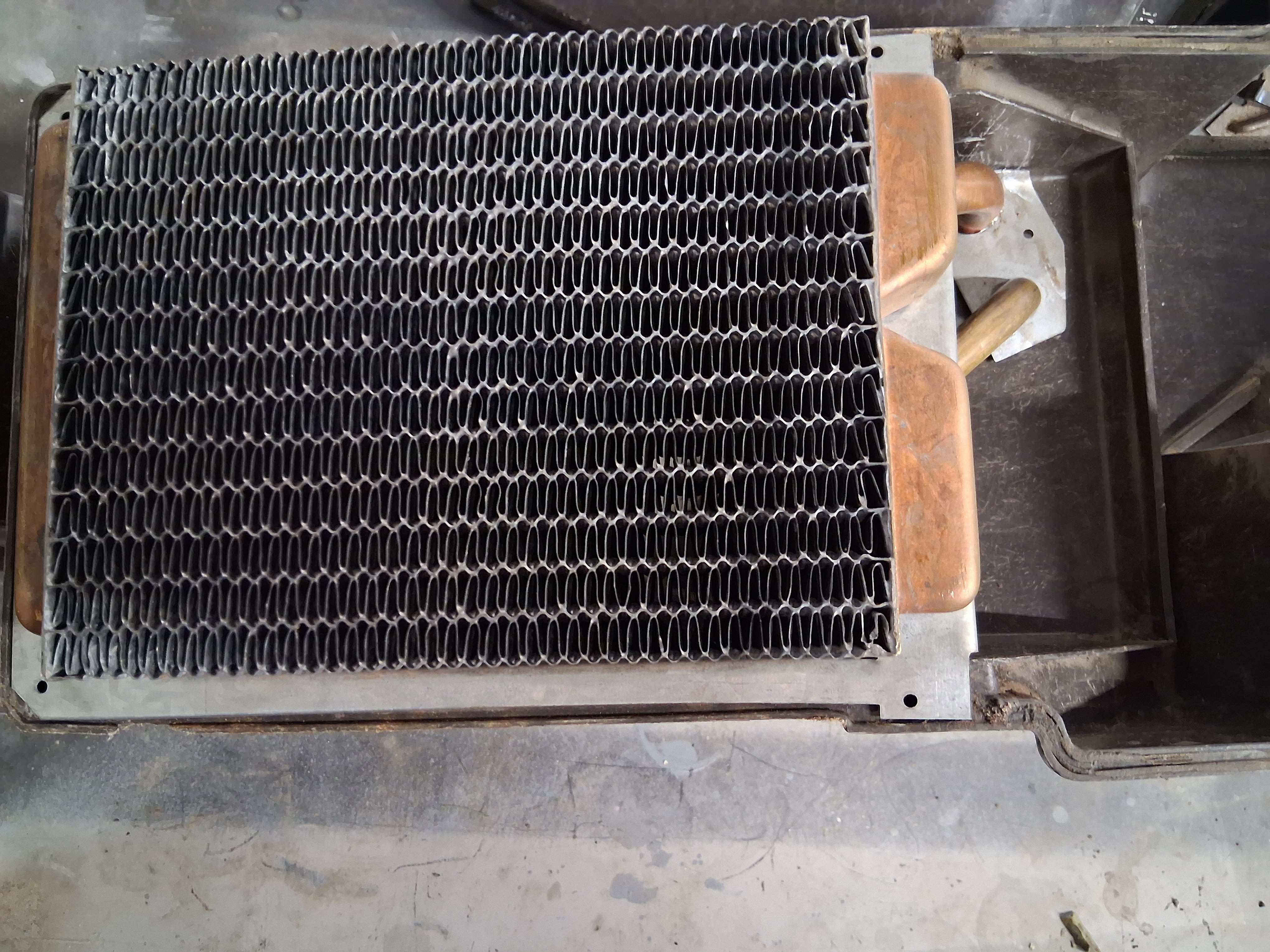

Here's the ones I removed. Heater core comparison in photo.
Looking at the fin design on the 72 heater core, that one may be an original. The car was off the road since 1984 that I know of.

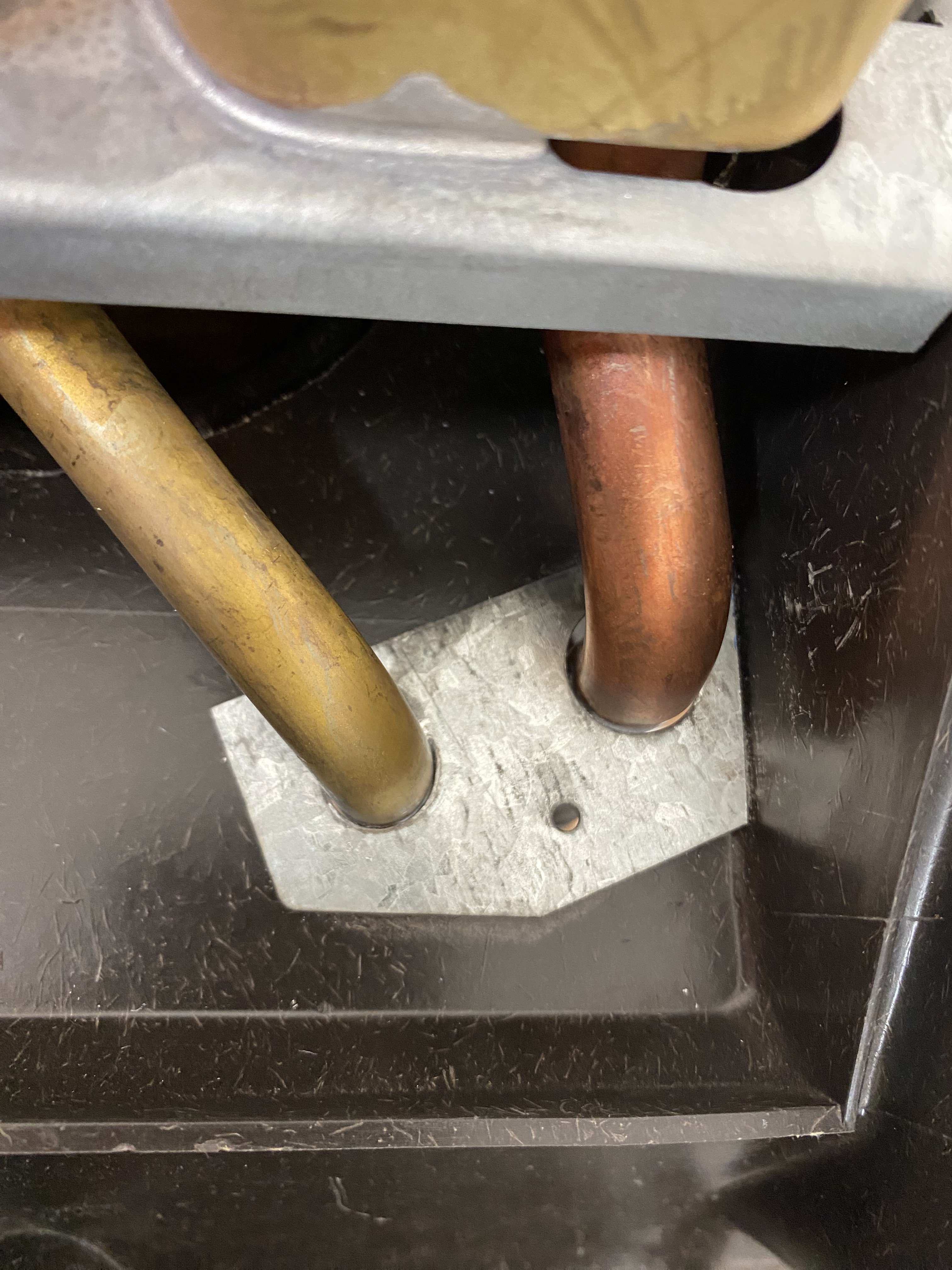

Here's the results of the Duralast Heater Core from Autozone as promised. It looked good after I unpacked it. I could tell as soon as I put it into the heater box it was going to need some adjusting. The inlet /outlet separator plate was not soldered on very well. As a matter of fact, the solder joints between the plate and inlet/outlet tubes came loose as soon as I started fitting it into the heater box. Not a problem. My torch with a 1 inch flame will be good to redo it. I found out later it was soldered on the tubes crooked and would not lie flat against the heater box case any way.
Here's a photo of it as received out of the box. I marked where it looked like I'd need to cut the plate with a brown line.
Terry W.
I cut the plate and after fitting it several times to get it to fit in the heater box as it should, I thought, 'why not just bend the top of the plate down to radius it with the inside radius corner of the heater box. You can see in the photo the core is now placced where it needs to be. You can see the plate is not flat against the heater box near the smaller tube. This is where I decided to mark the plate where it needed to be and resolder it using my torch.
Made it easier.
Terry W.

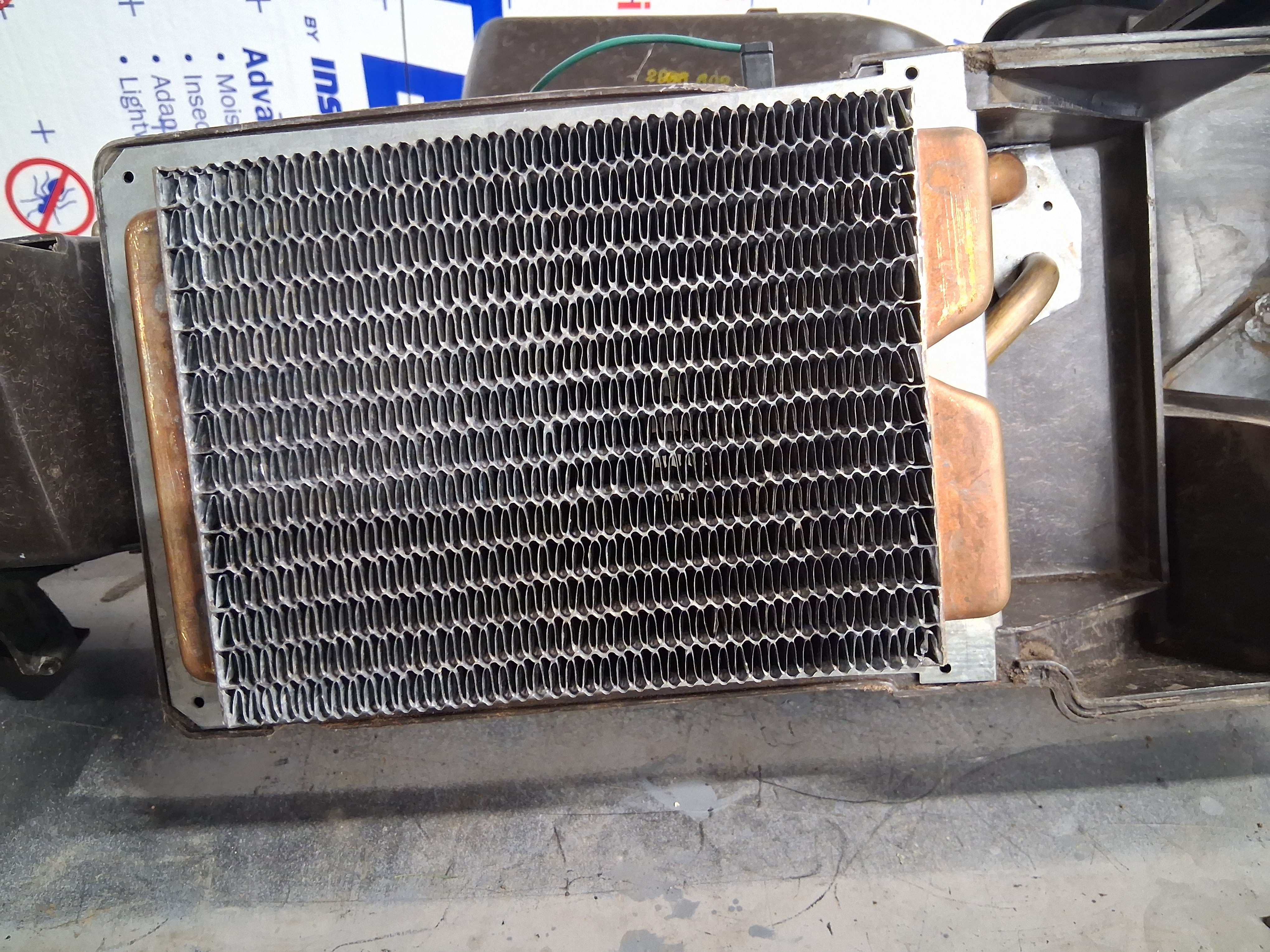

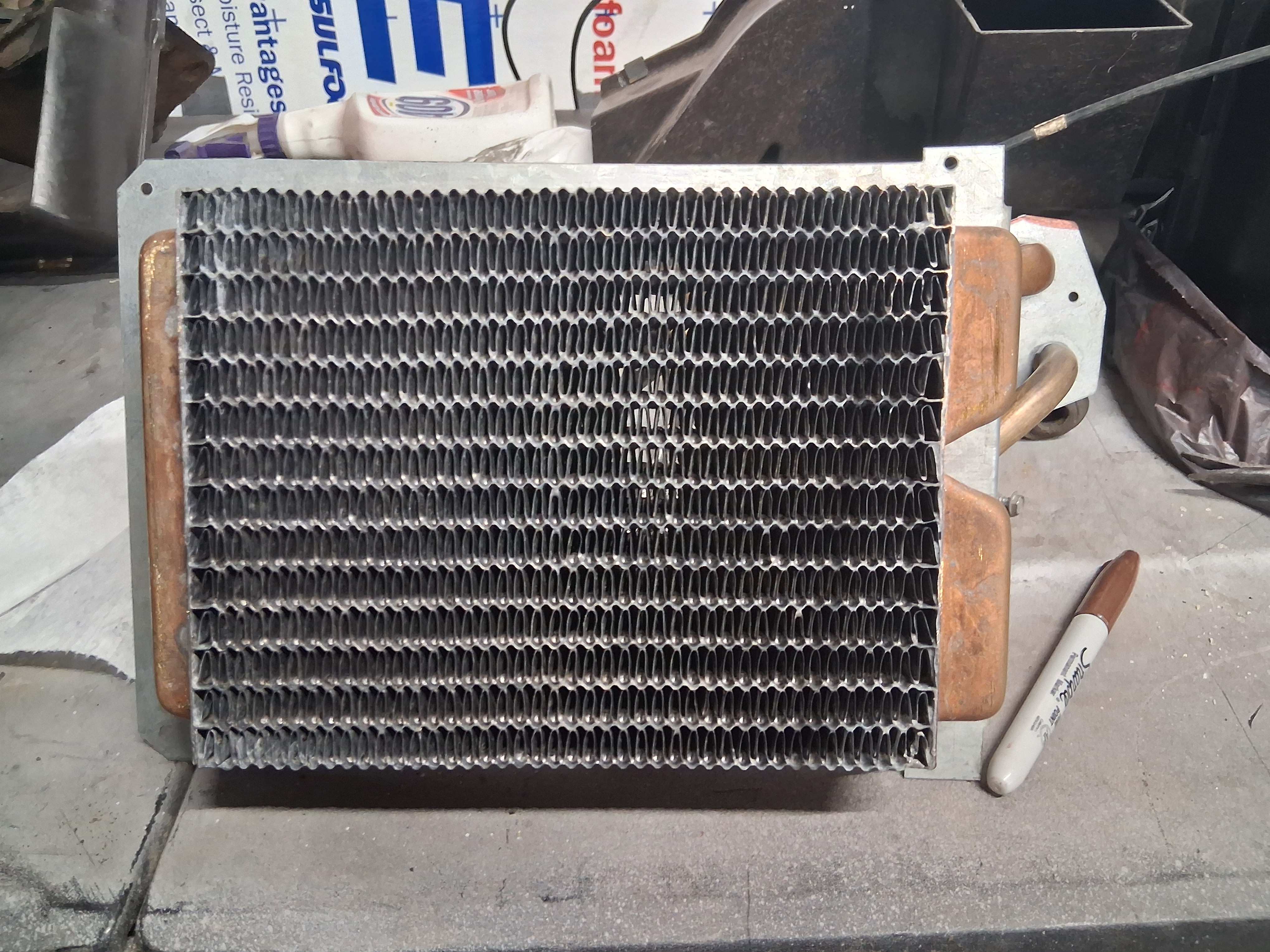

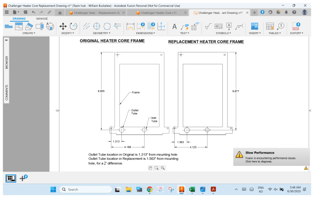

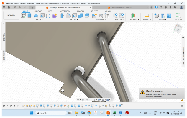

Here's the end result. It fits all the way around. I feel the Duralast core is okay but will require about 30 -45 minutes worth of work to get it to fit. I feel the Four Seasons core 91508 I got from Rock Auto required less work to fit although this wasn't bad. The Four Seasons core has a 12 month/12,000 mile warranty. The Duralast has a limited lifetime warranty. I'm glad @2bill70j shared his insights and started this topic. It gives some choices for those not doing a full restoration and have a driver. I don't think I would try to replace the heater core with the heater box in the car. I think that is what happened to my box and why a couple of the springs are missing, and I have to repair the heater box where they go. It not the first time I have to do this repair. Good info in this thread.
Terry W.
