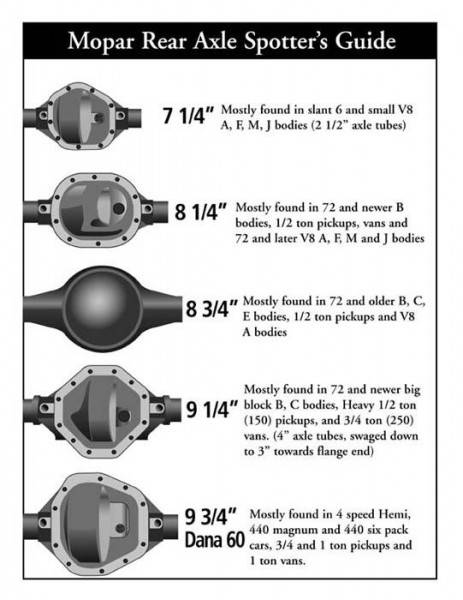

Should be a 727 and a 8 3/4. But you never know till you check.
Here is a way to ID your trans. http://www.forebodiesonly.com/forum/showthread.php?t=62
Here is a way to ID your rear end. To see if it is a sure grip or not. Jack up the back of the car then turn one tire. If the other tire turns the same way it is a sure grip. If it turns the opposite way then it is an open rear.

Would not hurt to check. After 40 years or so you never know what some of the previous owners have done to a car. The question was not should it have a 8 3/4 it was does it have an 8 3/4. Now he can check and know for sure.

I'll check to see tomorrow, but I'm pretty sure it's the third one down on the chart above. I'll ask the mechanic on Friday to tell me what I have.
