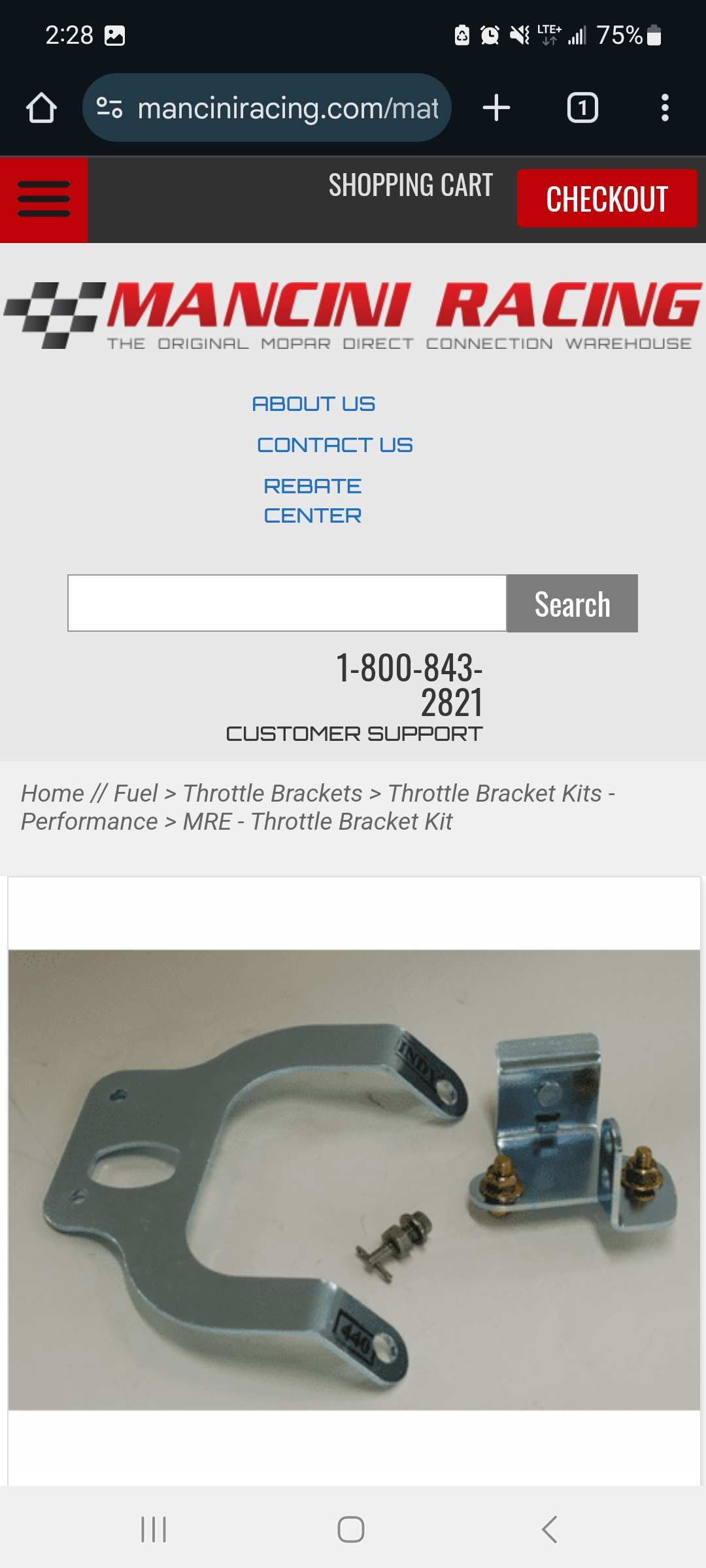

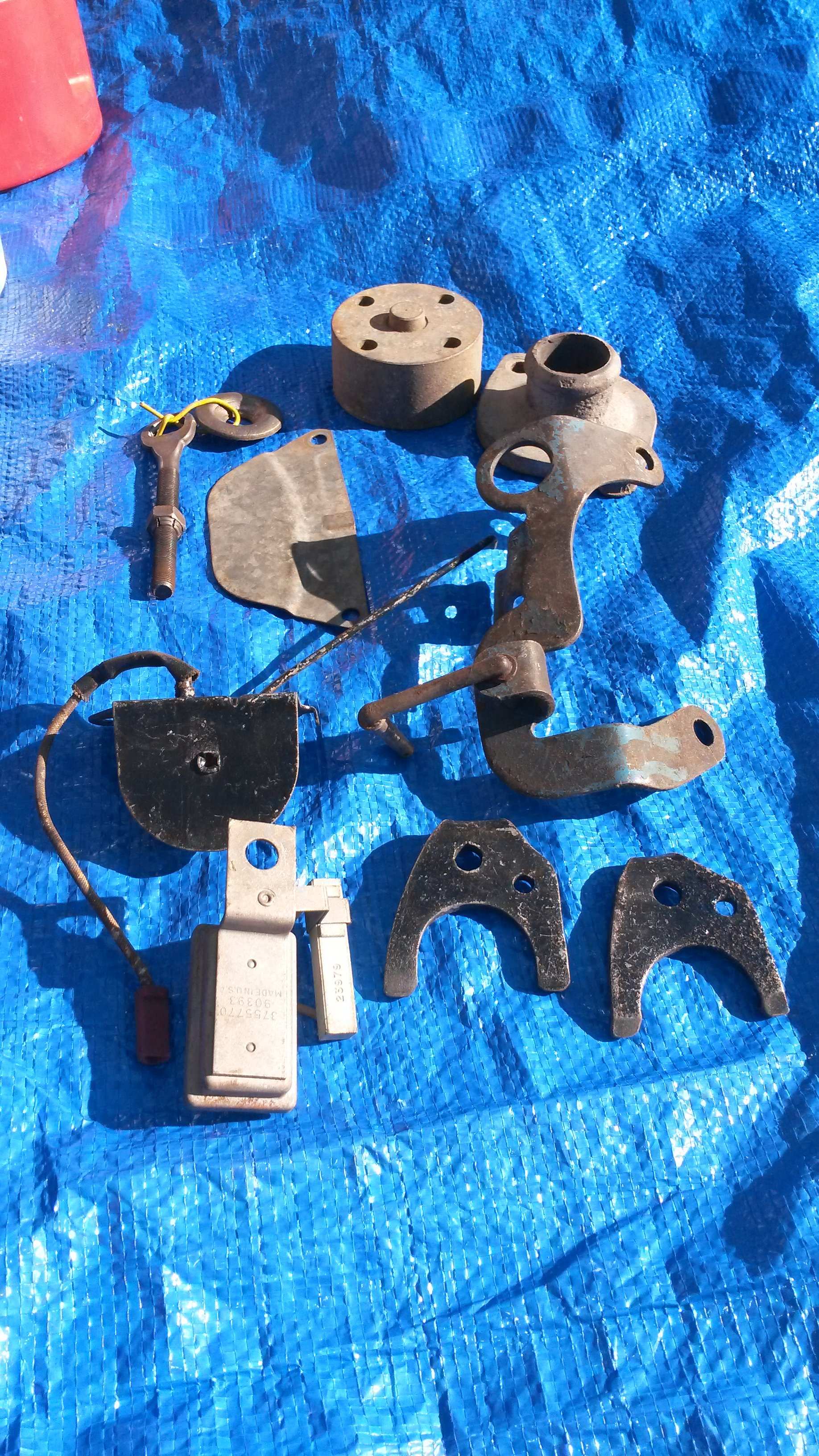

I have a throttle cable that is installed for the original 318/2BBL
-- This will work for a 4-BBl set-up, correct?
I do think the intake is higher for a 4 bbl than a 2 bbl. You could make it work by extending the mounts. Someone might correct me. I'm thinking this one is off a 318 or maybe a 400.
