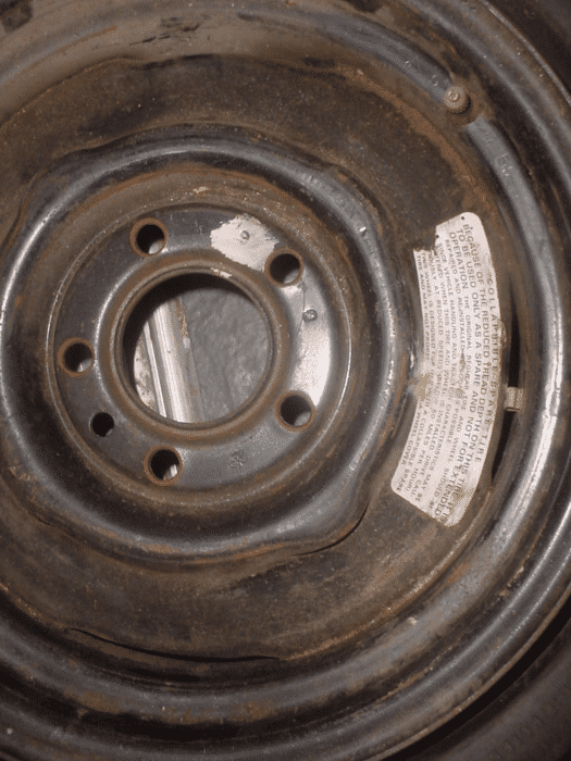

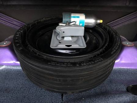

Is this the collapsable spare? Its the original 1.
Thanks

dj is right; they are rare! Yours is in better condition then mine.
Merlin, I see yours still has the original white sticker with the directions, the inflate bottle and the bracket that holds the bottle. All hard to find.
Originals should also have a white inspection paint dab. The original inflate bottles; they do sell empty reproductions now.

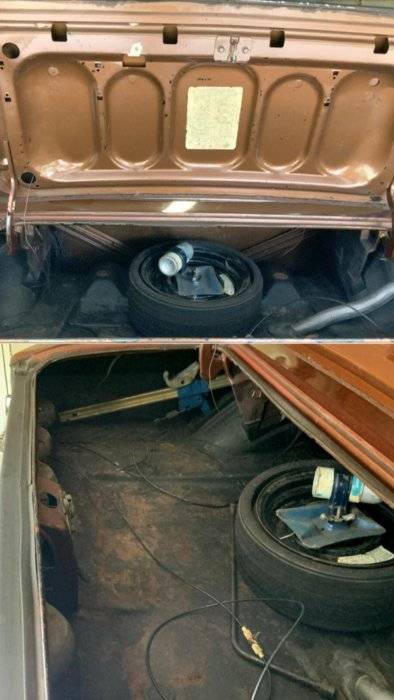

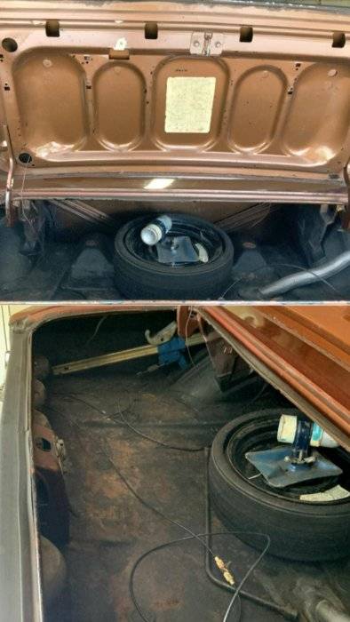

Pic of my original that has been sitting in the trunk for 50 years. (a 7.75 -14 BF Goodridge)
