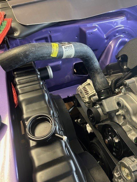

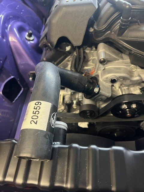

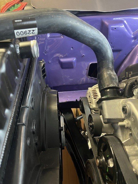

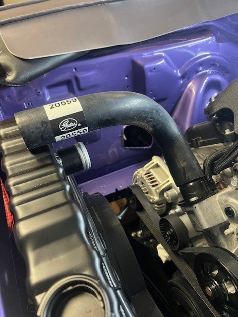

On your 5.7/6.4 Hemi Swap what upper and lower radiator hoses did you use? I have a Auto City Classic Radiator where both inlet and outlet is on the passenger side. If you used a Champion Rad or similar where the inlet and outlet are on the passenger side, it would be similar.
Well...not much response here. So in looking further I found that Gates has a molded hose catalog with some dimensions and a photo of the actual hoses. About page 110 is the hose pictures. The catalog is linked below. I looked through the catalog, found some that might work. I plugged those part numbers into Rockauto and they have a 360 spin view of the hose. I was able to scratch a few off the list based on that view. I ordered a few upper and lower hoses. The catalog beats wandering around the parts store. Give me a bit of time and I will reply back on what I found.
