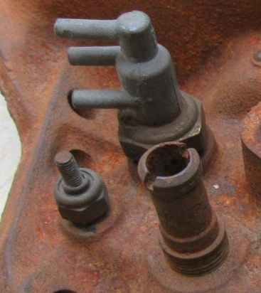

The "Z" suffix is on the earlier manifolds and may or may not have the boss for the temperature operated vacuum by-pass valve drilled and threaded. This boss/port is used for this valve if so equipped or plugged if not equipped. The following image shows this valve installed:

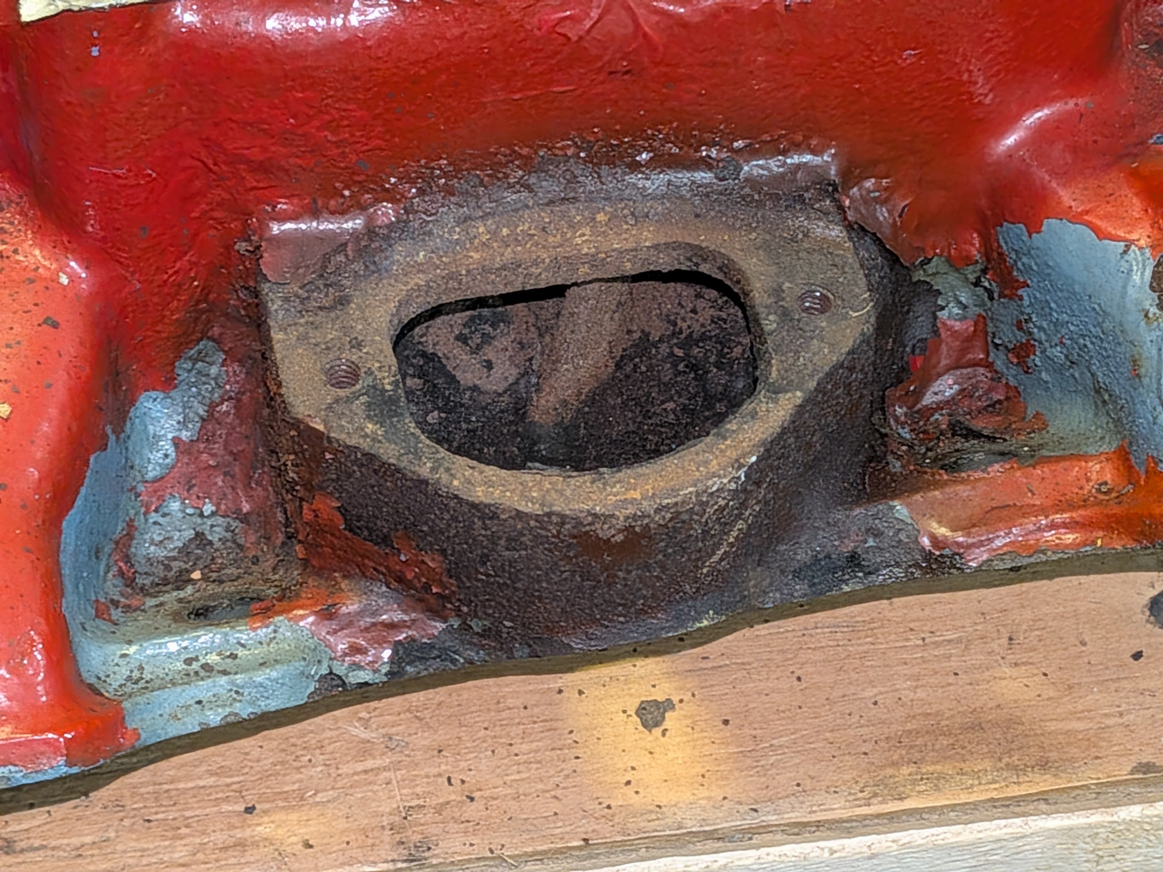

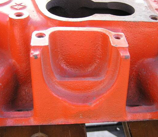

1973 introduced a new design choke well and electric assist choke thermostat. The following images show the 1973 well compared to the different 1972 well design which contained a cup installed in the well.
1973, and continued in use through 1984:
1972, also used in 1971:

The temperature operated vacuum by-pass valve, or thermostatic ignition control valve (TIC), was released for some 1973 engines, including the 340, typically based on region or accessories. The valve is used to reduce the possibility of engine over-heating under very high heat conditions. With the valve, if coolant temperature reaches 225 degrees Fahrenheit, the valve opens allowing full manifold vacuum to the distributor vacuum advance unit, bypassing the orifice spark advance control system (also introduced in 1973). Engine idle speed is increased, thus providing additional cooling until the engine coolant temperature drops and the valve closes, releasing the OSAC bypass.

The image of the example valve in my earlier post is on a 3671918A manifold, cast on March 7, 1973.
