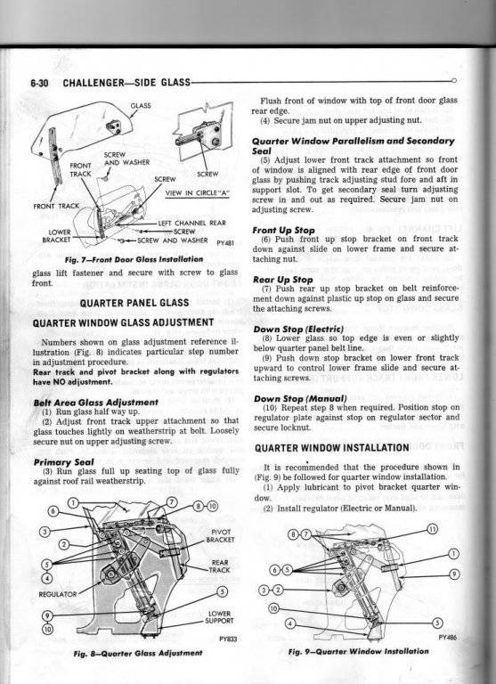

Hey guys, just replaced a bad driver's side regulator now the glass is out of adjustment. What is the correct way to align it? 70 Cuda.

what way do you need to go? up and down on the front and back of the glass are stops that have adjustments, were the regulater bolts on you can move the glass back and forth.

Seems ok until you get about 2" from full up, then it appears as if the glass need to rotate counter- clockwise. The top back of the glass sits about 3/8"over the metal of the back window. Where exactly are the stops?

It's been A while but at the back and t word the front of the glass there should be stops, also if the glass looks like it needs to go in or out on the bottom of the door it should be slotted on the door frame and 2 bolts to adjust it that direction.o and check and see if the front track might need to go forward.

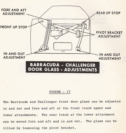

Pics to help.

Actually where you find these glass adjustment instructions and many other interior and exterior items is in the BSM (Body Service Manual).
72*birdman
May 5, 2013
54
16
I got way more out of that simple figure 17 drawing and instructions. Than the engineer nautical instructions in the manual that about made my head explode.
challenger6pak
Feb 27, 2011
4,092
924
LOL. That is why I posted both instruction sets.

Be sure and check the window alignment after opening and closing the door. A couple years ago I had to re align mine and thought I had it perfect. THEN I opened and closed the door and it was set way too far inwards. All adjustment areas will need moved. A little here and a little there. Have patience !!! :D
