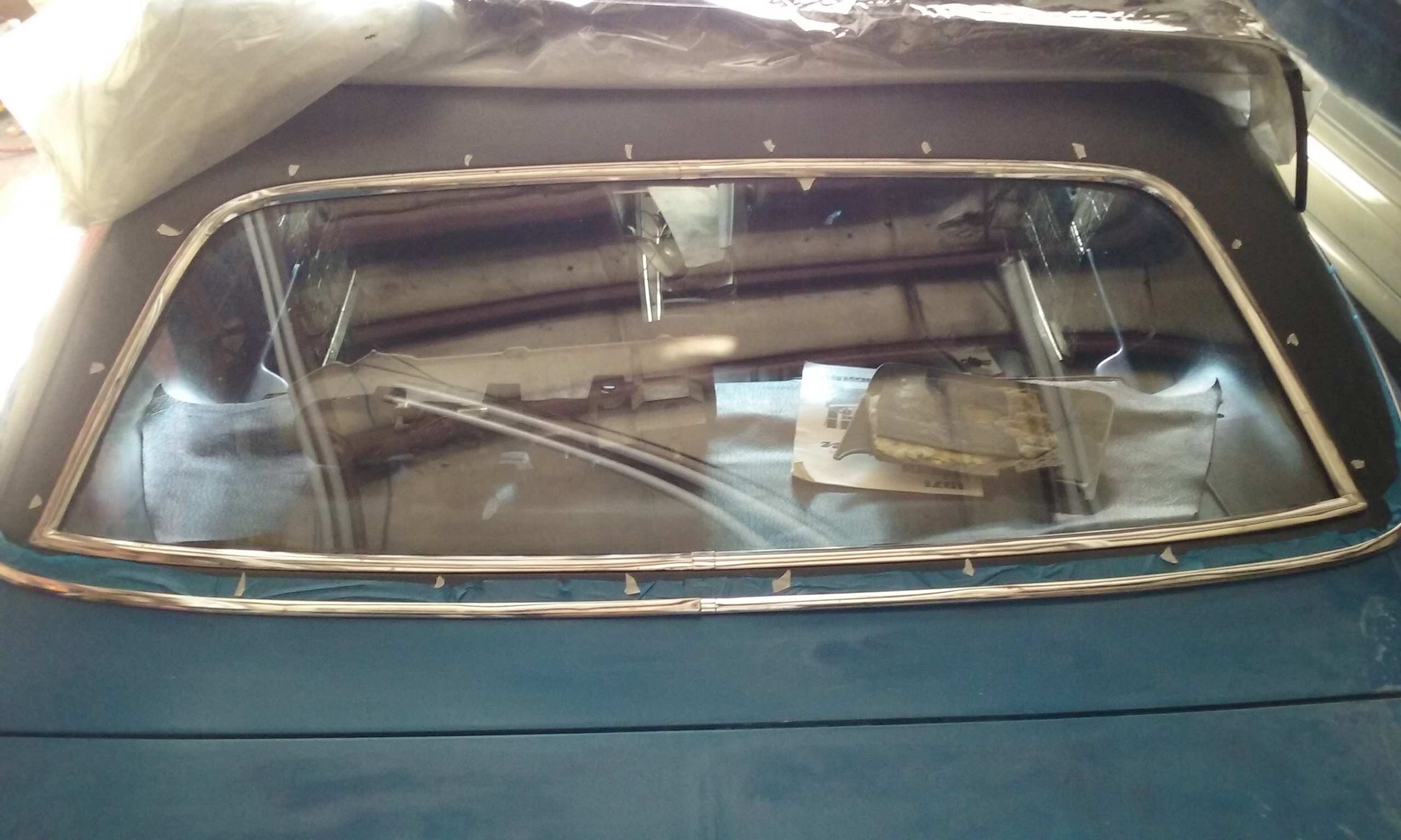

I'll have to look for the measurements. I do think I posted this before.
I put the tape there so I would know where the clips were. Only applying pressure where there at.

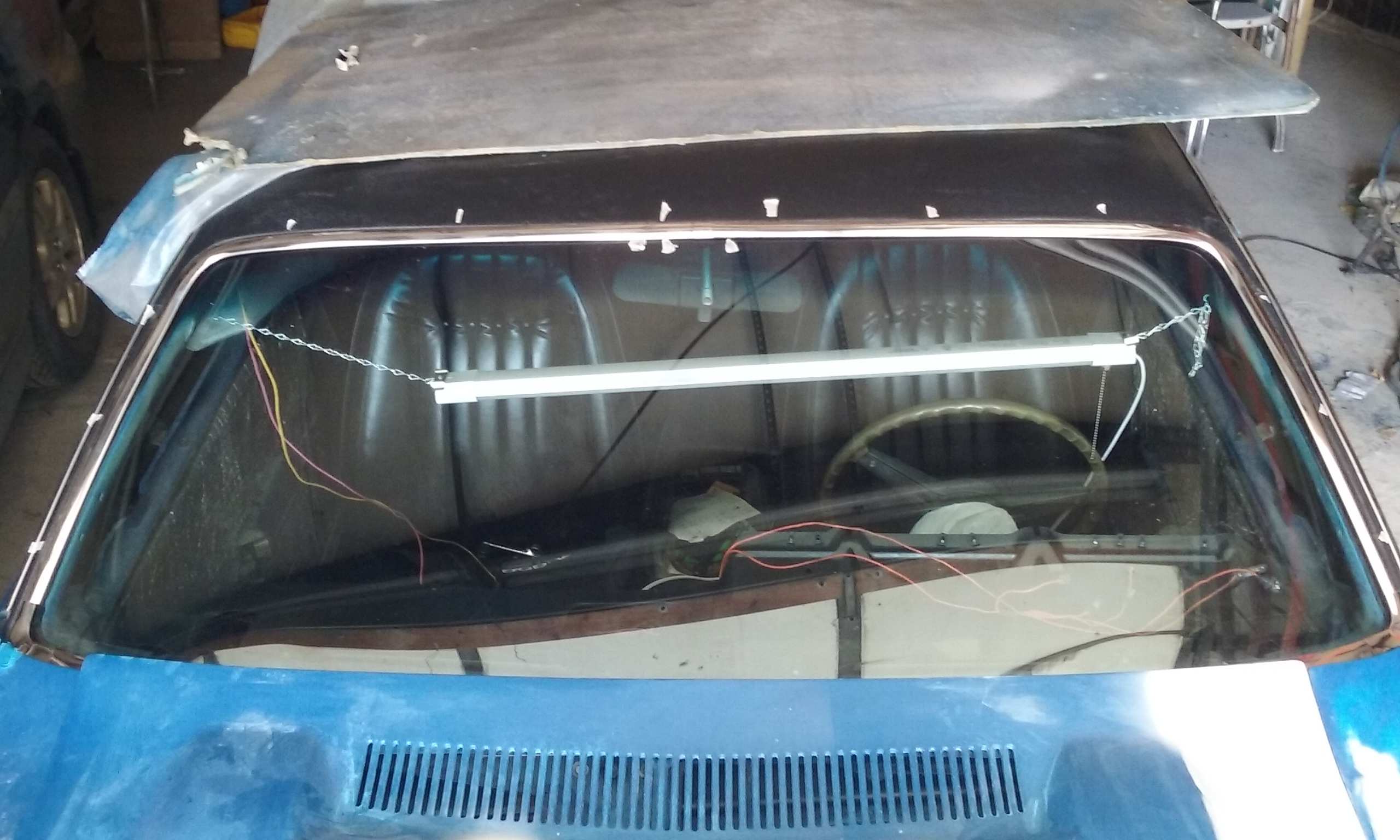

This is the back. still looking. Window trim:top were studs.Side 3 holes one each side,spaced from the bottom.1 1/2" 7 1/2" 12 1/2".

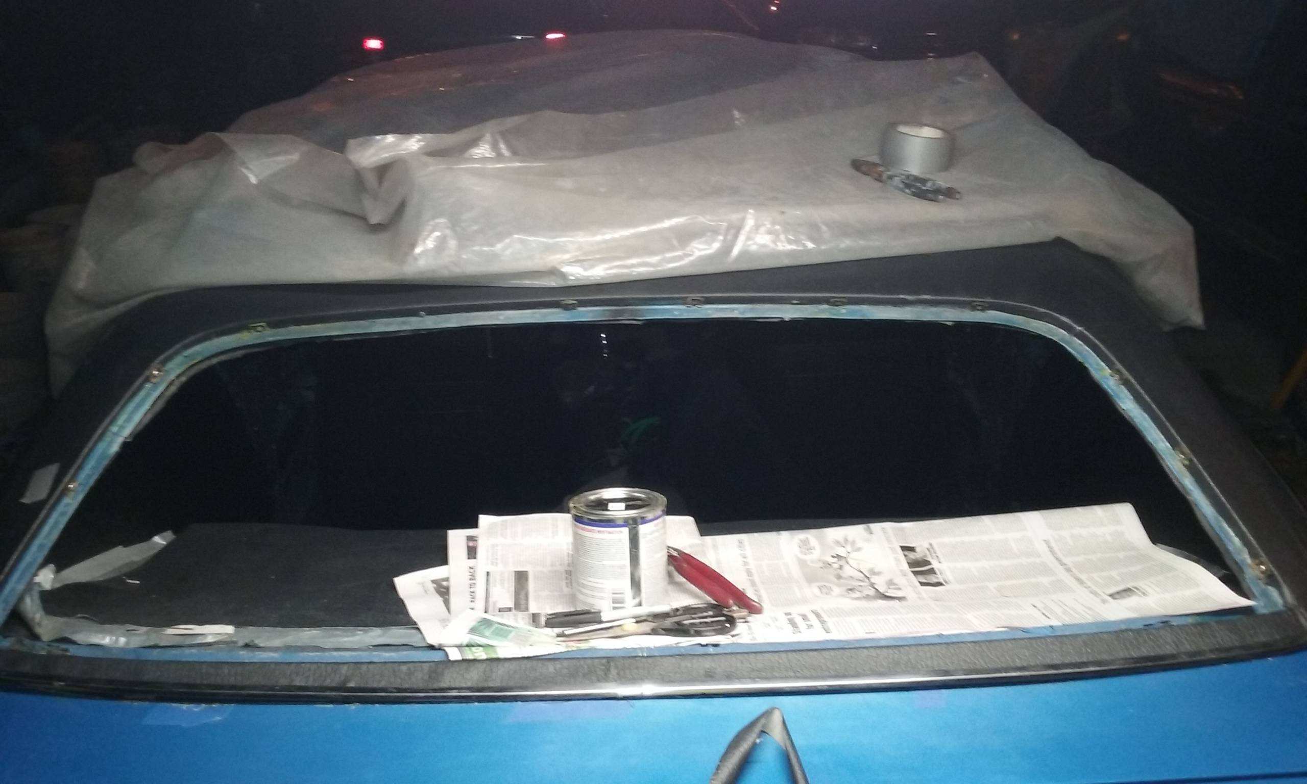

VINYL TOP INSTALL 4

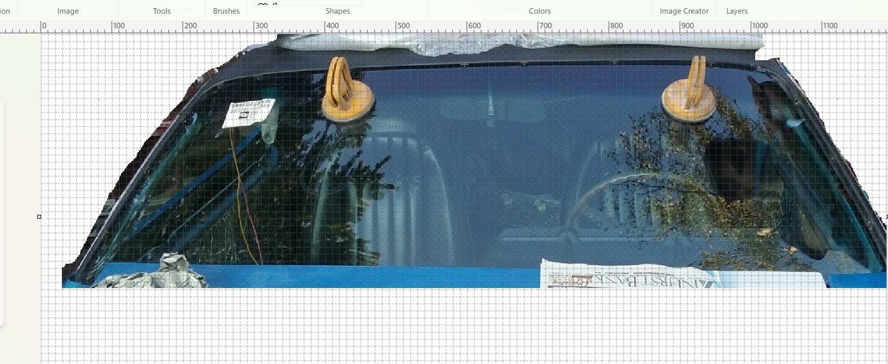

Front windshield clip locations. One picture with grid. Can make a calculated guess. I think I have the measurements. Just have to find them. Someone might come up with them.

This should work. Thanks guys for the speedy response, I should have clarified its a 70, I'm only missing the holes on the upper vertical areas of the roofline front and back. The pictures and measurements should be all I need.
Thanks fellas..
