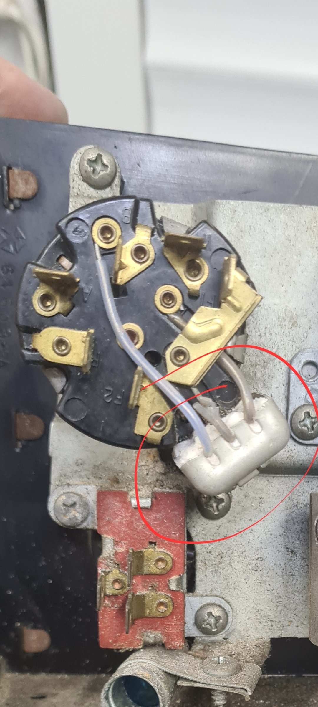

Hi all, I found my switch is not working. I never paid too much attention to it since I don't drive in the rain much.
So it's a 3 speed, but it won't change speed when turning the knob, all 3 positions will deliver the same speed.
Also it won't move to park.

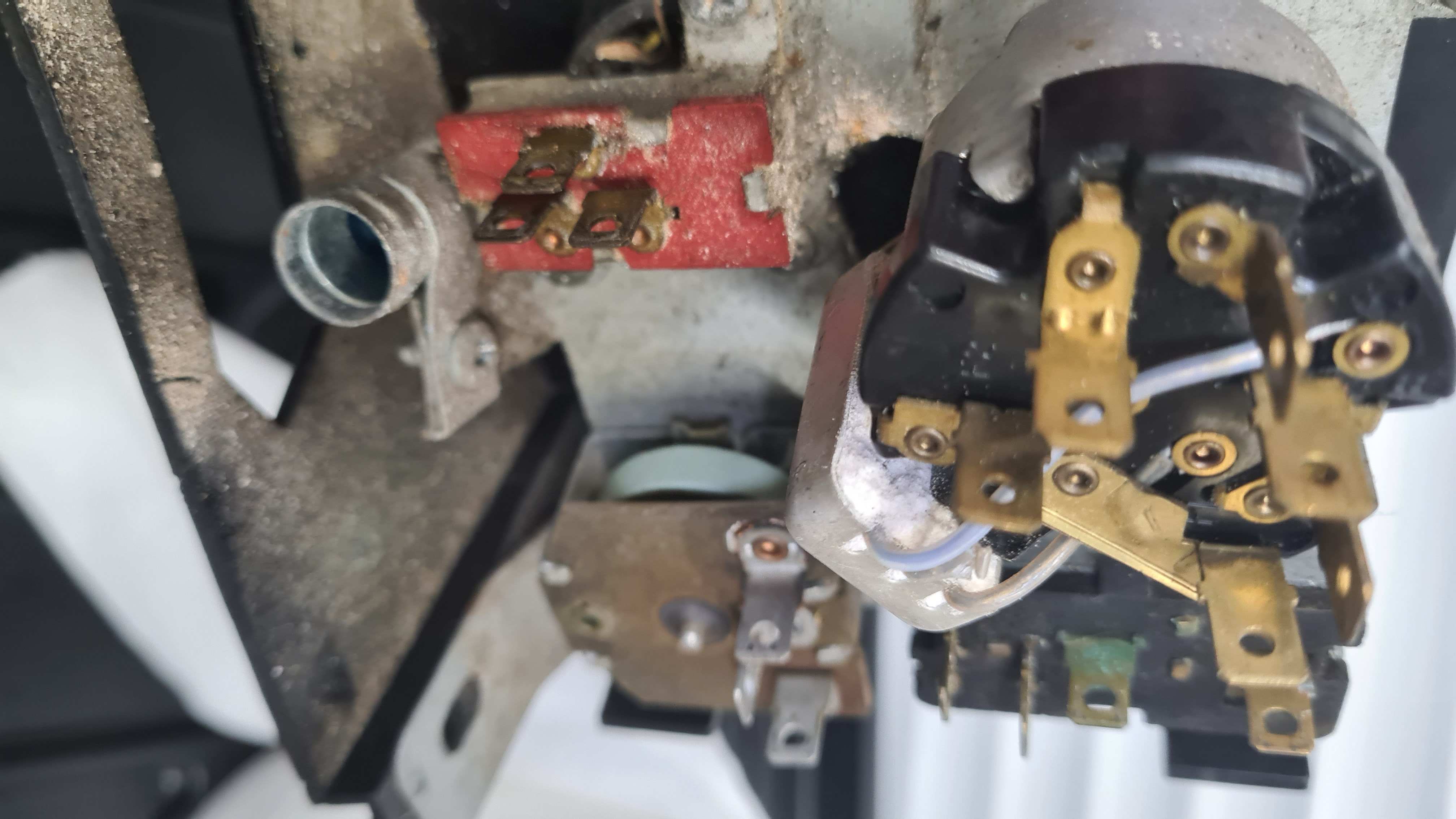

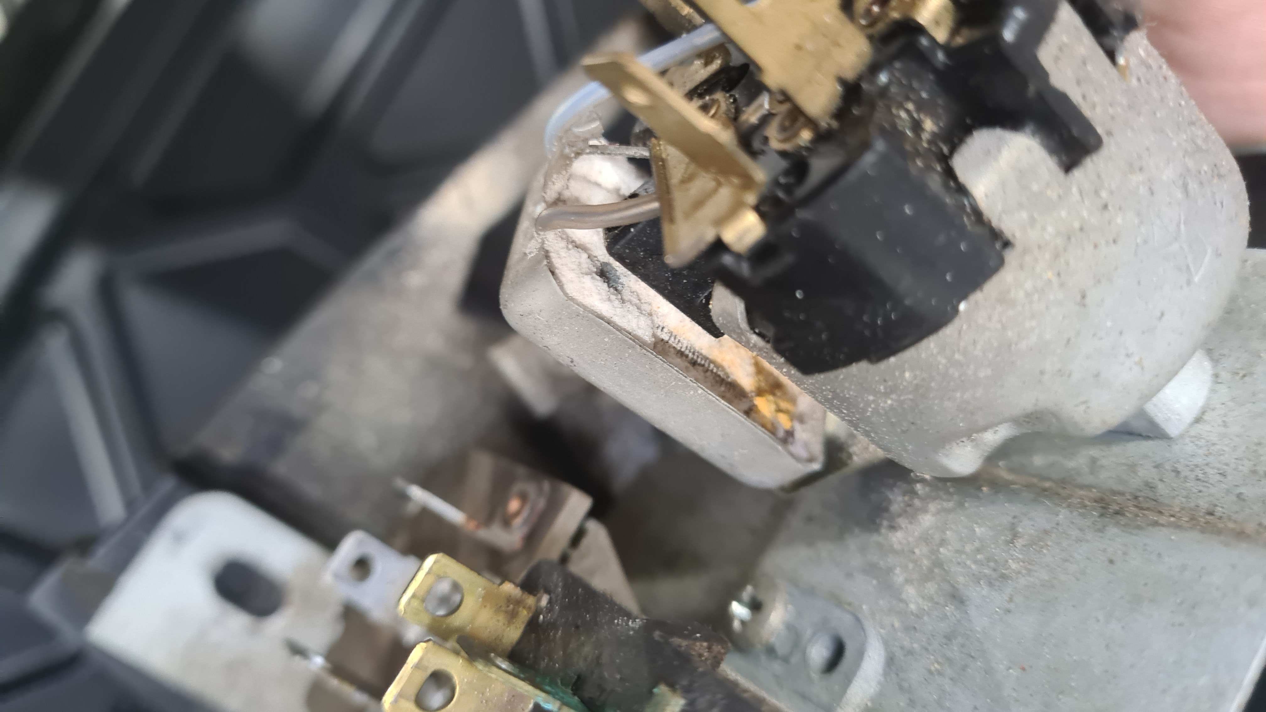

I removed it and saw that the ballast resistor(?) has crumbled spreading dust/grit everywhere. I cleaned it and can see 2 coils now.
Is it possible to fix it? And how?
73 Challenger
Thanks.

It looks like the issue is really that bit I highlighted, no idea how it's called, little resistor.
If I could bypass that, or connect any external one it might do the trick.

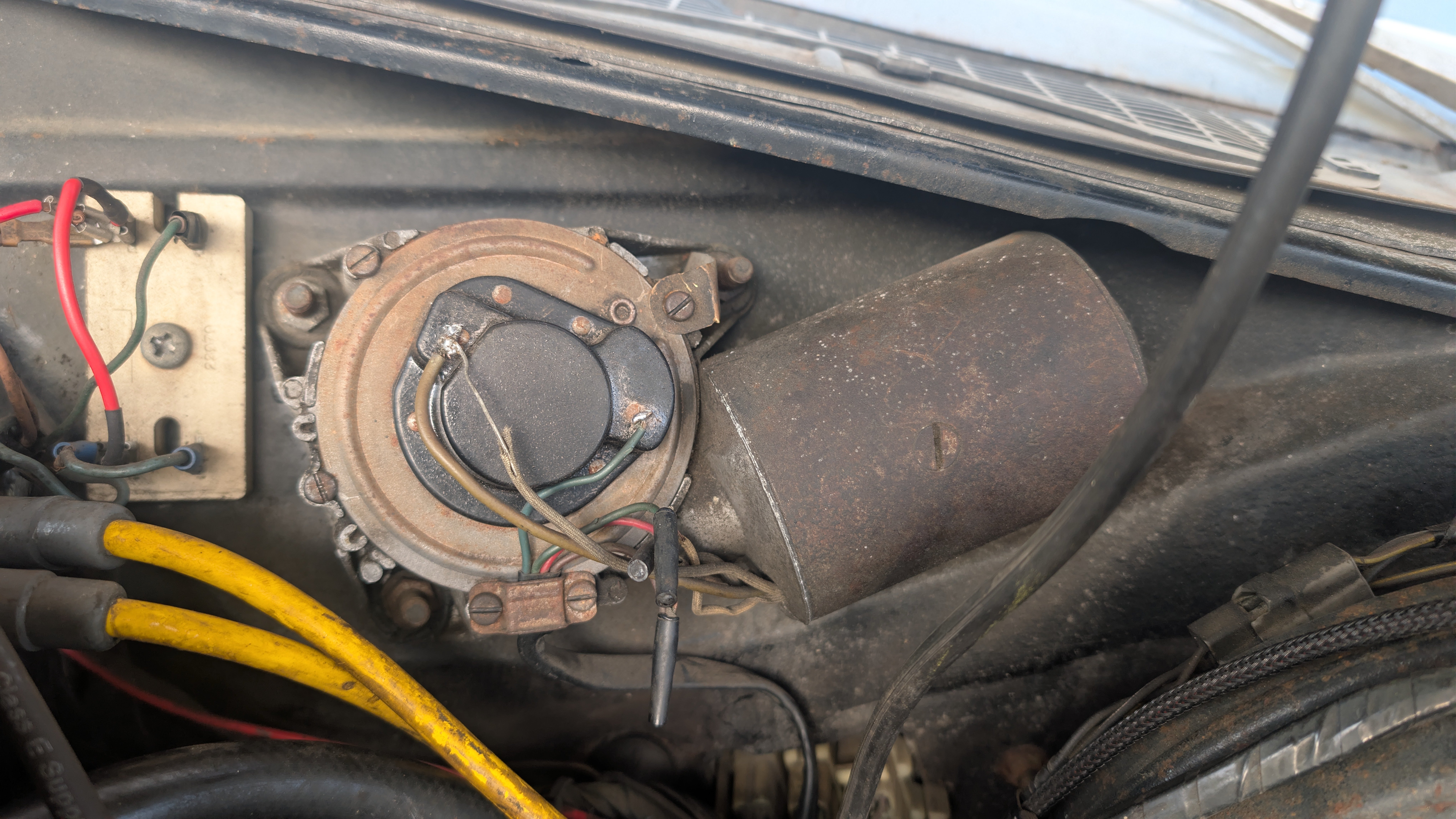

I tested the wiper motor straight to battery and it works as it should, including park position.
First off..... The switch case needs to have a good ground for everything to work correctly.
First off (again).... Confirm that you have a 3 speed motor (pic?)
