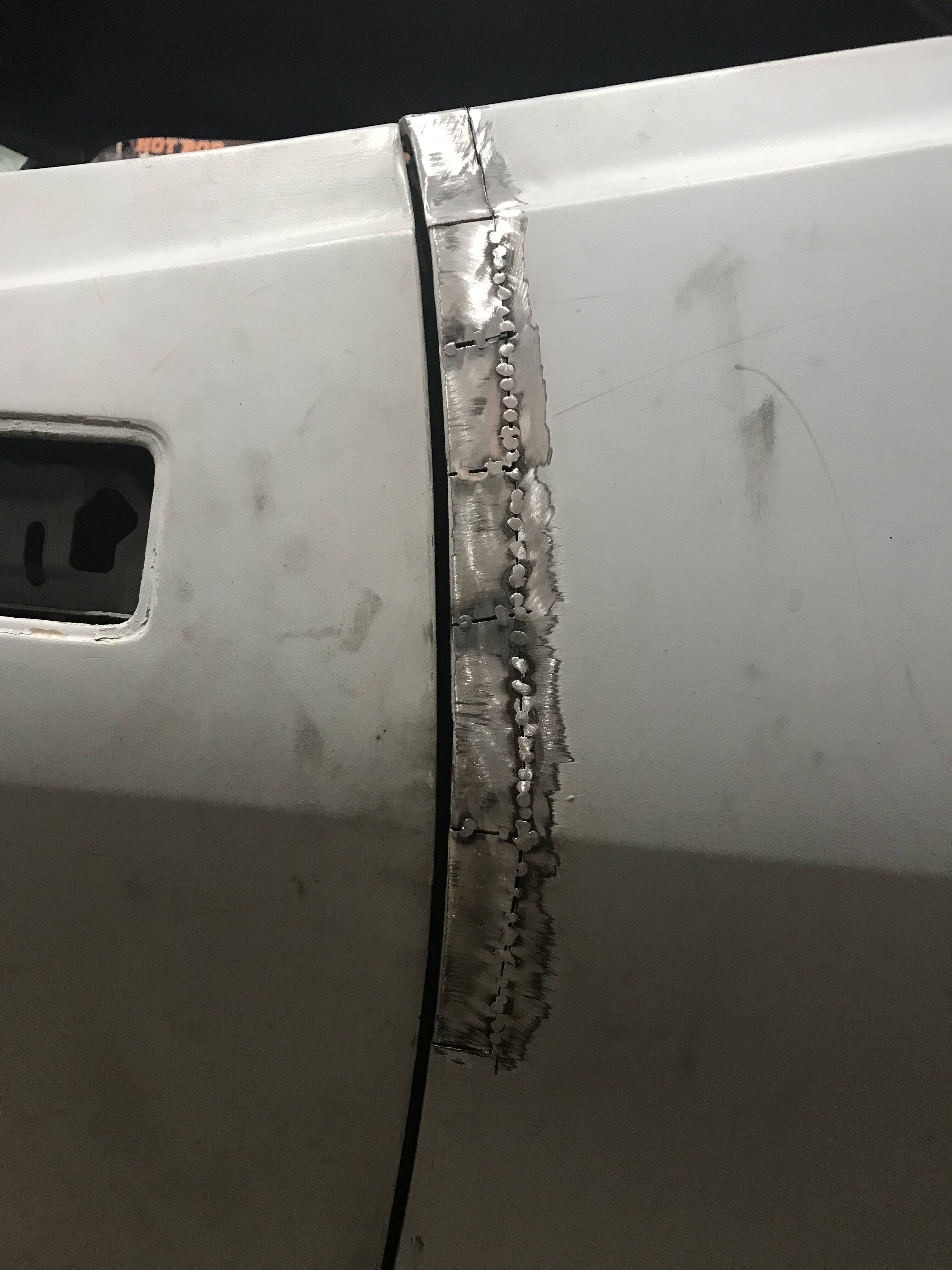

Good progress on my door gap adjustment.
Nice work. I was wondering why you haven’t painted it yet..
Make sure if your going to do any lead work that you .neutralize your finished work w/a soda wash . I’ve seen a top dollar paint job ,That had to be redone,it’s the acid that comes out underneath all that primer and paint
