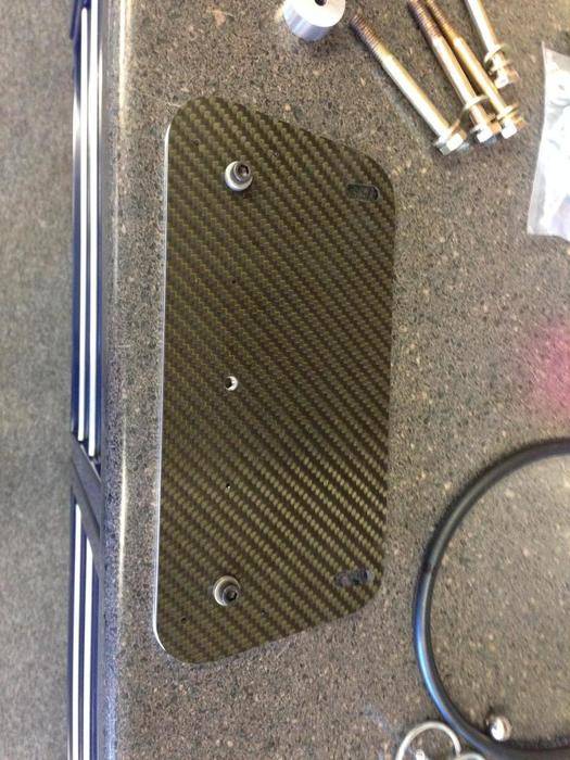

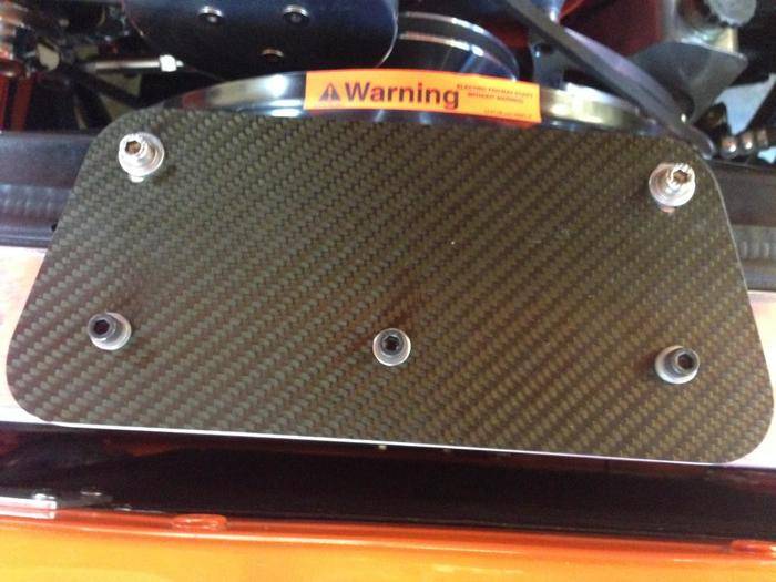

So,

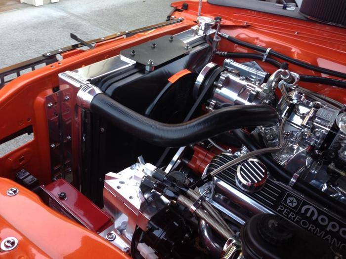

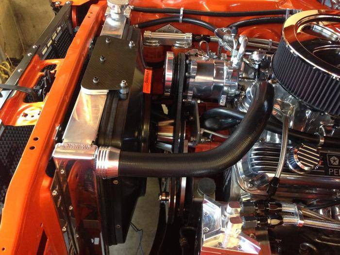

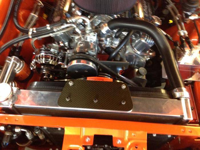

Still hunting my ignition gremlin....I think I have it fixed but time will tell! I finally found a few hours to work the
Electric Fan Swap....I have a BeCool Rad with Core measuremnts of 18" x 22". I used the Flex-188 or Black Magic
extreme Series fan from Sumitt.... Perfect fit... 2450 RPM and 3300 CFM. I had already done the wiring last winter...

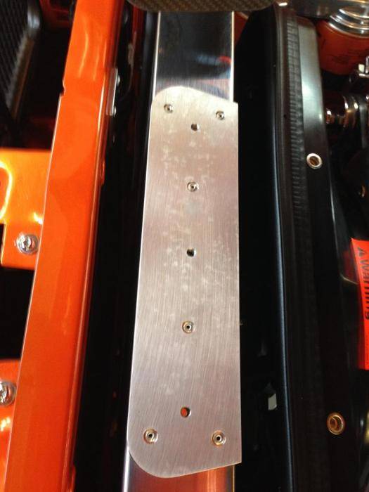

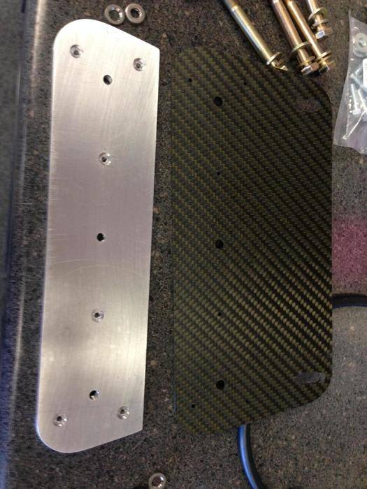

Sensor activated at 180 deg and run down to 160 Deg. I made (2) quick brackets out of graphite, a doubler plate
so I could make the brackets removable and (4) Spacers. Here's some pics....I still need to swap the bolts for some
stainless button heads....but you know Tacoma screw....never open on the weekends!
