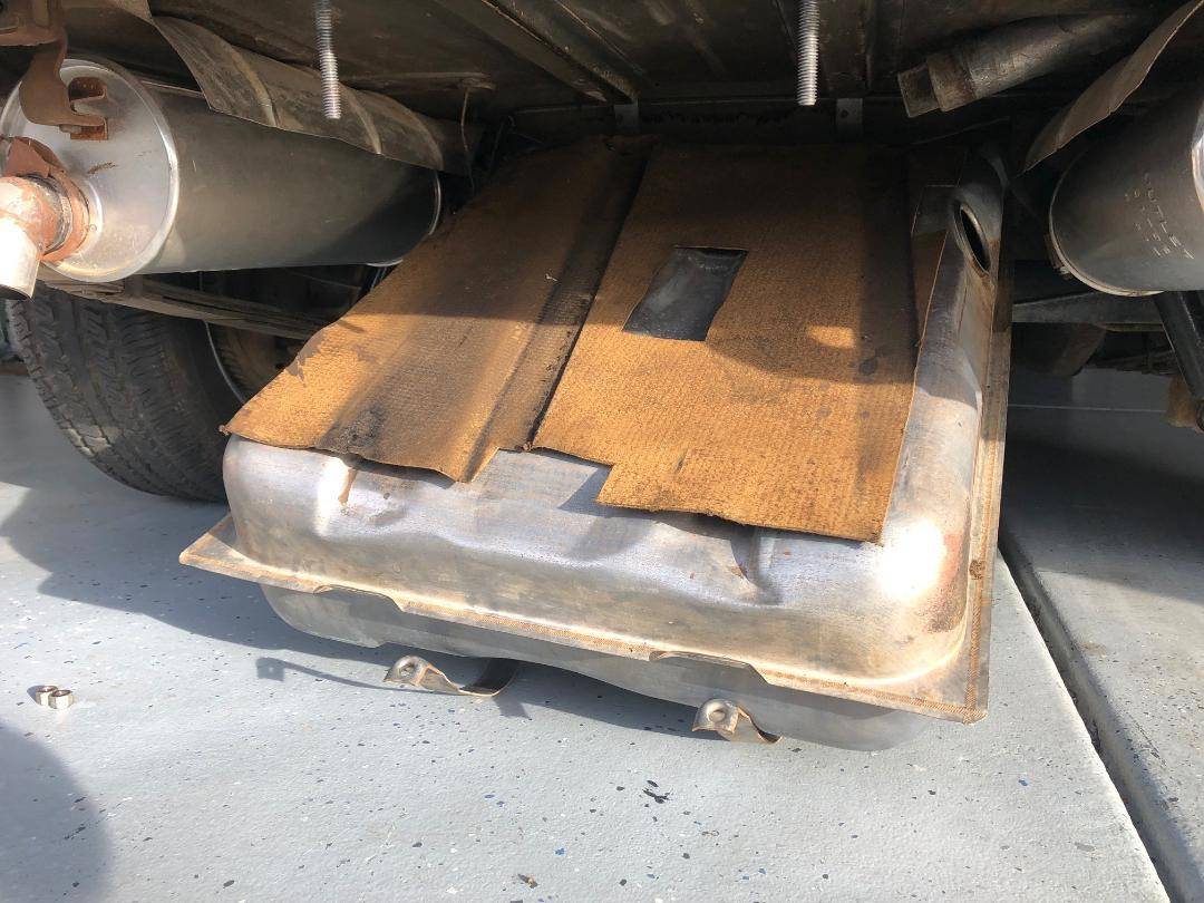

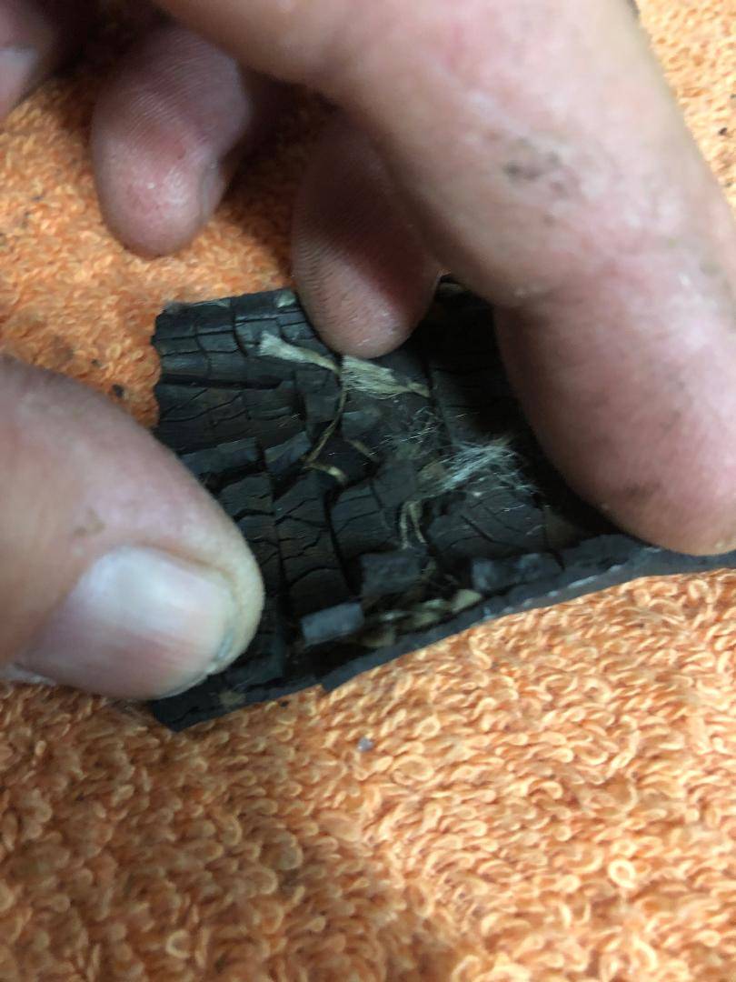

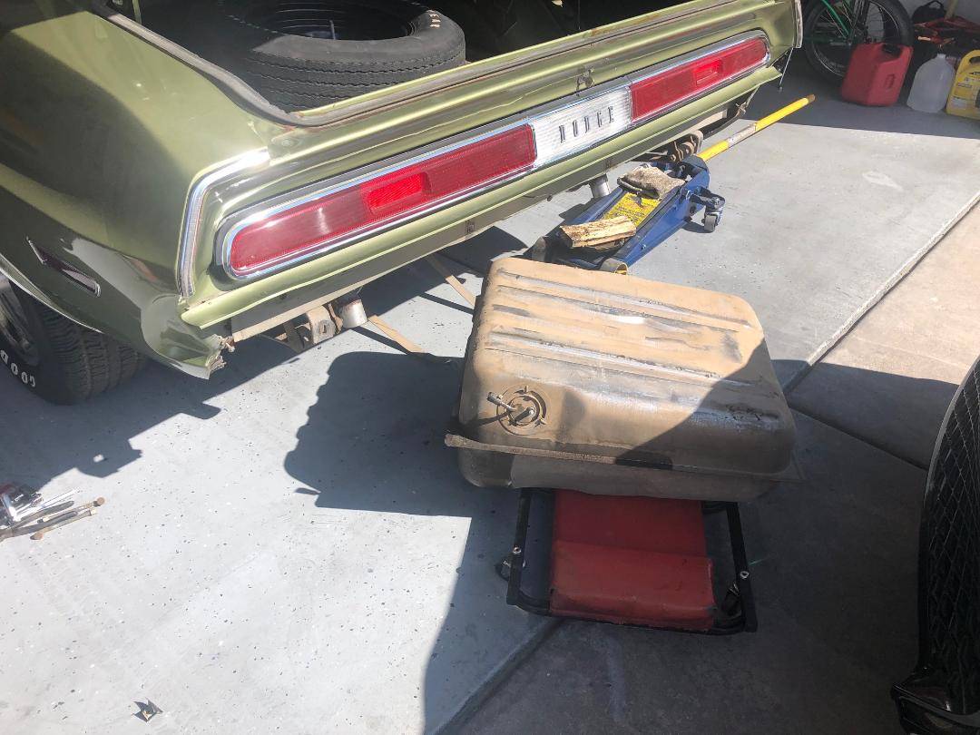

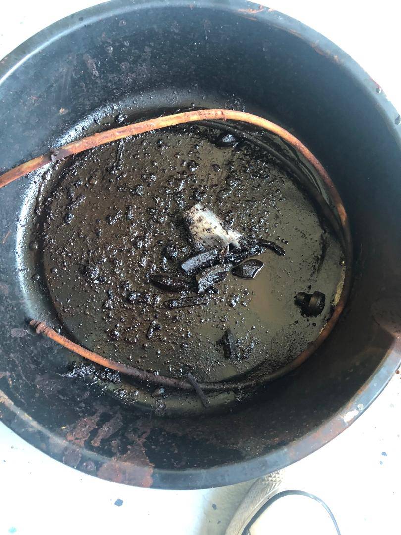

This is what was in the Tank the hose,duct tape all of what you see in the pan? lol

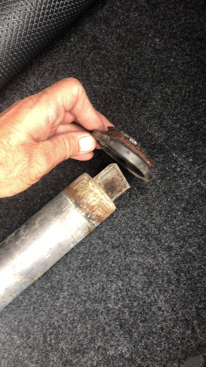

So i took the tank out! Ordered New Sender and grommet for Filler Tube and blew out line and changed rubber hoses at each end.

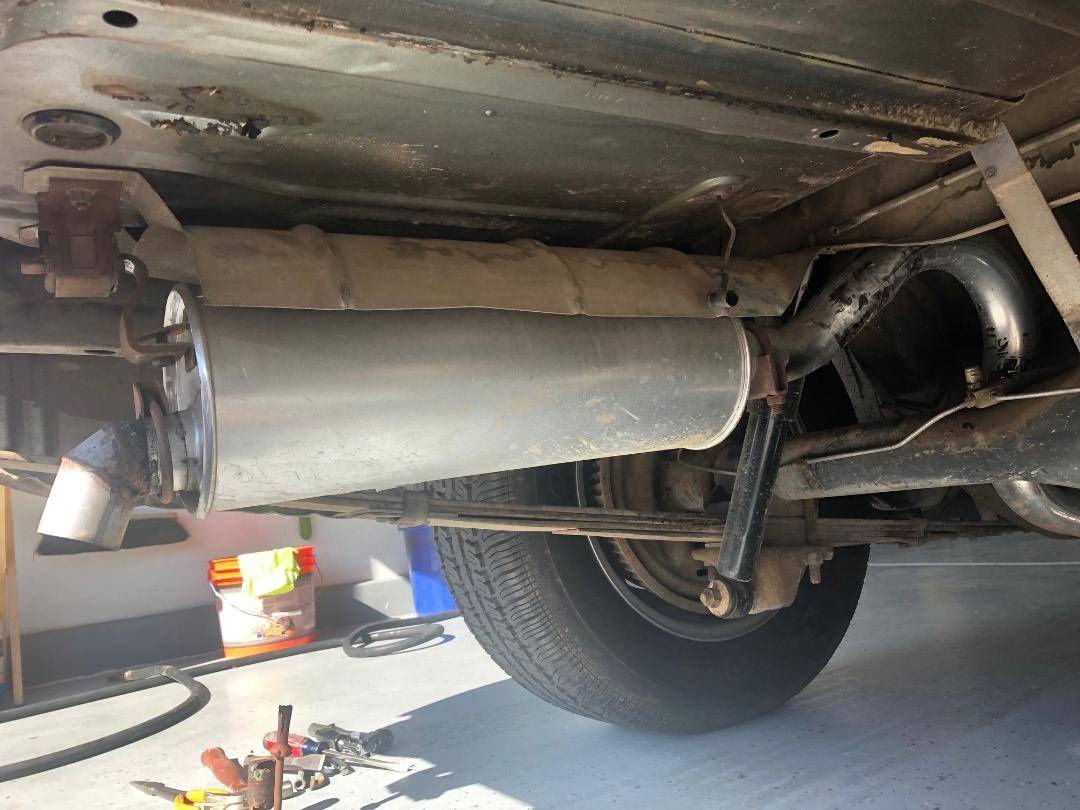

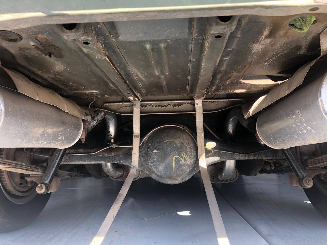

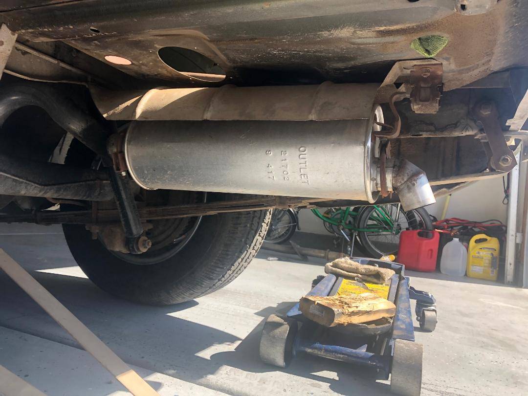

Not to jump ahead too much but do you guys think i can eliminate the resonators with pipe and dual tip with Valance maybe? for more Sound?

Oh, and P.S. - - by all means upgrade your exhaust and eliminate the round (actually mufflers, not resonators) at the rear and adapt to factory style tips thru dual-cutout valance. H.P. (383) Magnum would have likely had this as stock, but could have been ordered by original owner of your car. As you are discovering, even a very low mile E-body can experience deterioration - - due to age.
Pretty easy to replace those oval resonators with straight pipe (the ones before the rear axle) and keep the car looking original. That will give you a little more rumble but putting on the dual tips won't do anything.
IMO, keep those mufflers with the turn downs and keep the plain valance. You just don't see very many cars ordered with that configuration anymore.
True , i was either gonna leave it or do the valance with tips minus rear resonators.

Where is all that crud in the filter coming from?

Mine was so bad, it had rusted through from sitting and condensation. I replaced the tank and sending unit to eliminate issues.
Some remnants of a part number on top of the old tank.

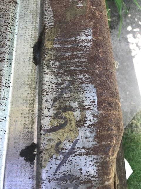

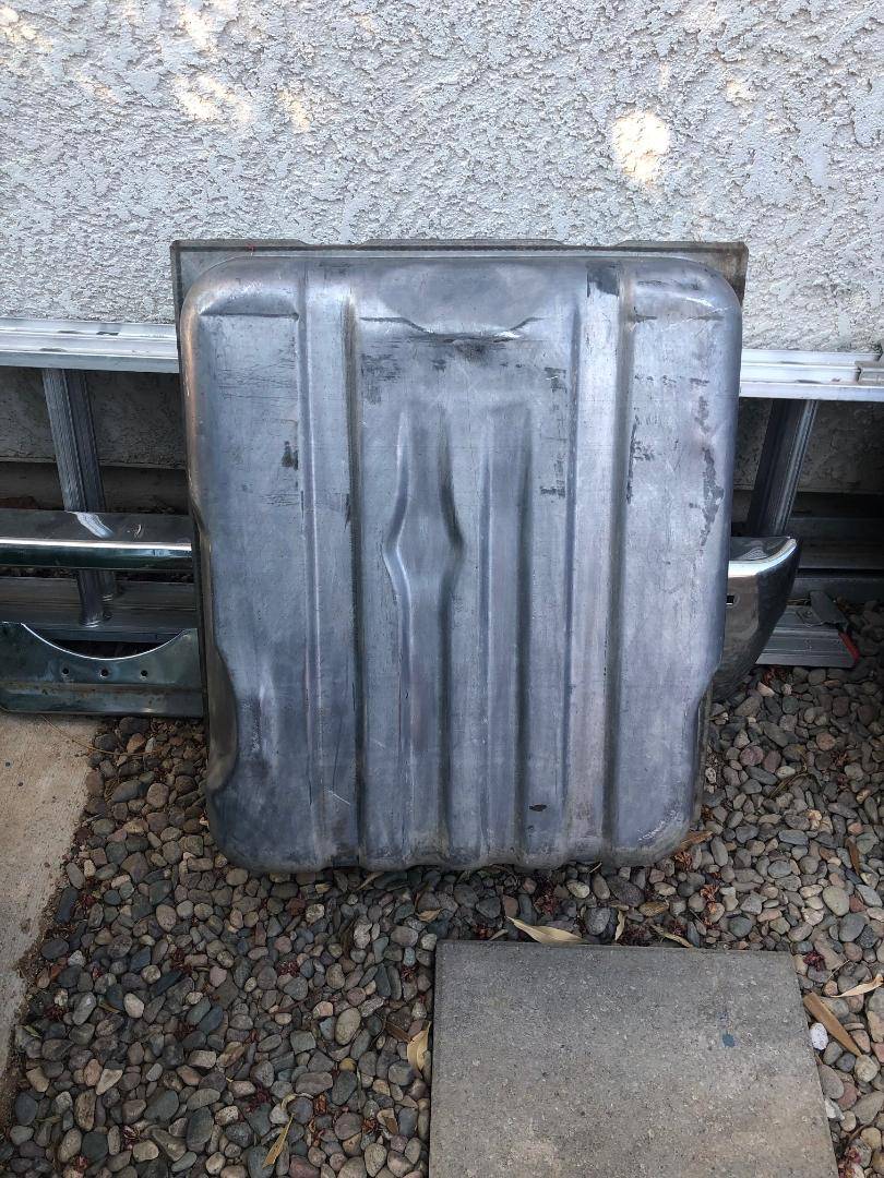

My tank was Not rusted inside it was cleaned out abd beautiful so please dont assume
Oh yes of course, that thing, so you knew about the source of the rust and still used the old tank?
Time to get a new one, change the lines as well.
Absolutly no reason to change the Tank or lines, The Tank cleaned up mint inside and out.
This car has 53k miles on it and ha been in AZ all its life. even the Tank pad is still perfect.

I do not know much about the car in question, however, 'generically speaking', I will offer more advice - based on failures and successes over the past 50 years of Mopar. Any 50 year old car is going to have deterioration issues - no matter how little the Odometer has turned. Original poster is on right track by going thru the entire fuel system. IF the inside components of the sending unit are perfectly clean and shiny then it's a good bet the rest of the tank is the same way. Once removed and residual fuel is carefully drained out, any brown color will of course indicate rust inside. A (battery) light ie: tac-lite can be pointed into fill pipe opening and then visual inspection done via the sending unit flange. I am sure O.P. already has done this. If tank is clean inside there is nothing to prevent its' continued use - providing new fill pipe grommet and sending unit seal are installed. Lines to the NEW fuel pump can be blown out easy enough.
No need to replace unless rusting from outside and judging from cleanliness of underbody, I'd expect the lines to be good. What I would suggest is to install a (metal) fuel filter before the NEW fuel pump - to complement the one already between pump and carb.
