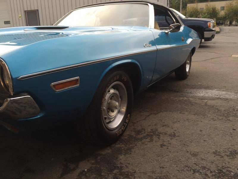

Hood did not have holes in it for bolted on emblem. Why were some decals vs emblems?

The A66 package was a late release from the Dodge camp, in fact they weren't going to even offer a 340 for the Challenger until they saw that the Cuda was going to have the 340. Since it was a late release the thought is that they couldn't get the emblem right away so the early cars had decals. I have a pair of NOS decals that I had reproductions made from so if you need a pair just let me know, they're 40 bucks a pair. Somewhere in the for sale forums there's a thread about them with pics.

You should also have a non crumple zone hood that the Challengers had if they were built before January of 1970. More pics is what we need. I personally love the 1970 340 Challengers, they're my favorite E bodies.

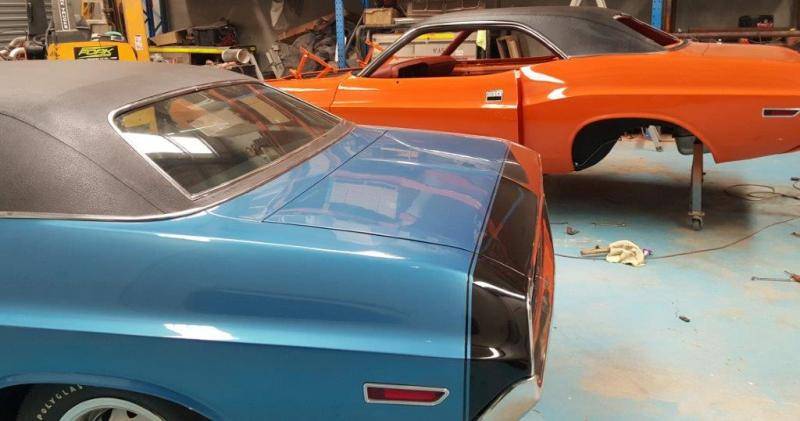

Nice car.
Do you have the mix for the paint looking at the door jam the body B5 is darker my A66 has the same look i notice on the paint sheet (No quantities just codes Pokerville Iron works) the main base used was Halo Blue

Thanks for the comment, no paint code available, but your paint looks extremely close to mine, That was called Halo Blue? my door jams when I lift the carpet show a darker blue so it was not a perfect match...however the color is Nice!

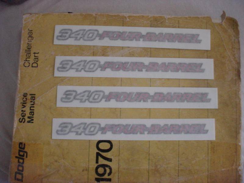

A66 340 Decals
Matt's 340 hood stickers are excellent quality and are exact duplicates of originals on the early cars.
I purchased a pair from him and they look great!
Needed for all the early A66 cars.
Pics show Matt's decals.

I've not heard of the multi colored engine and that hood will look great with the decals!

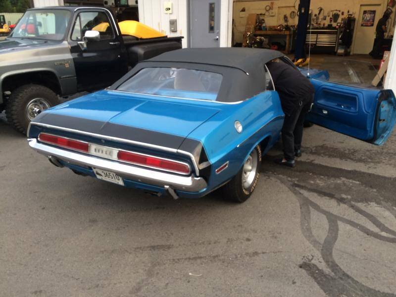

Sassy, very nice. I'm in CT as well so I'll look for your car at some shows next year. My first Challenger back in 1978 was an A66 convertible, FC7/D32. It is cool your car is out of New Haven. i went to school there.

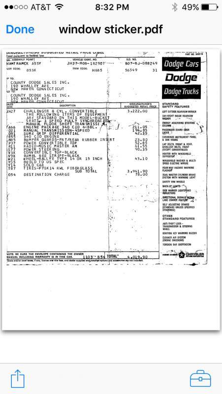

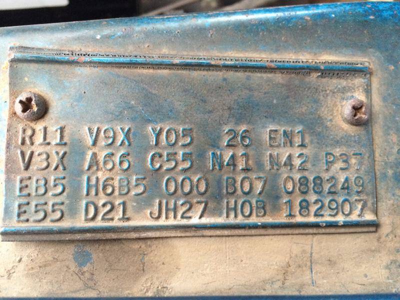

must have been a decal, no holes found on inside of hood, is there a reason some hoods had decals vs hole drilled emblems?
Early production 340 A66 Challengers: the decals were being put on hoods because the metal emblems were not yet ready. Cars had the emblems from early production through mabe December some time. Your car has a SBD of November 7, 1969, early enough to probably have the emblems. DetMatt1 has some really nice reproduction decals. I purchased two sets from him a while back for my own October built A66 Challenger vert.
