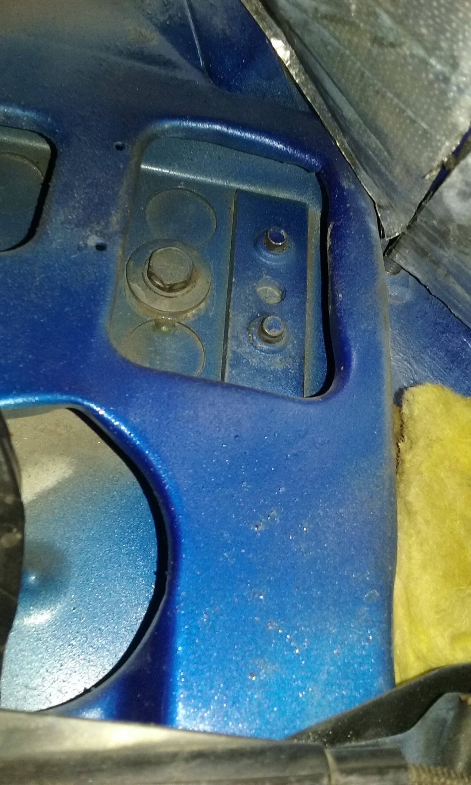

Thanks Rapidfire, the info will really help me do it myself. I read that there is a hinge bolt behind the kick panel and it is accessed from inside the car? Is that the case?
Challenger RTA
Oct 28, 2018
4,304
2,334
PA Flood city
Yes. The upper is right above it. Some go in and the others go out through.

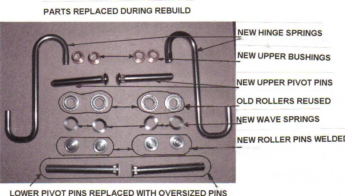

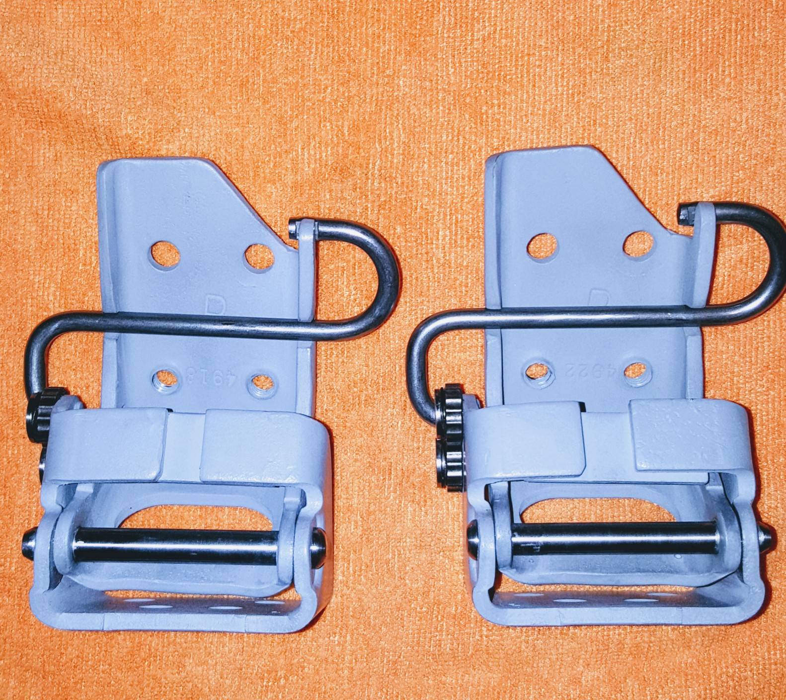

AMD makes good sheetmetal or should I say the company in Taiwan makes good stampings but the hinges are a different story. You may already have repros on the car. That should tell you something. Originals would be 50 years old now, repros less than 10 at the most and they don't even look like originals. I have been supplying Restoration and body shops for over 25 years. You can't buy a " rebuild kit" as there have never been anything other than a cheap GM pin and bushing that are bagged up with no instructions because there are none. I completely go through the entire hinge. All of the parts I use are custom made for me in the USA and I don't sell parts, never have.
