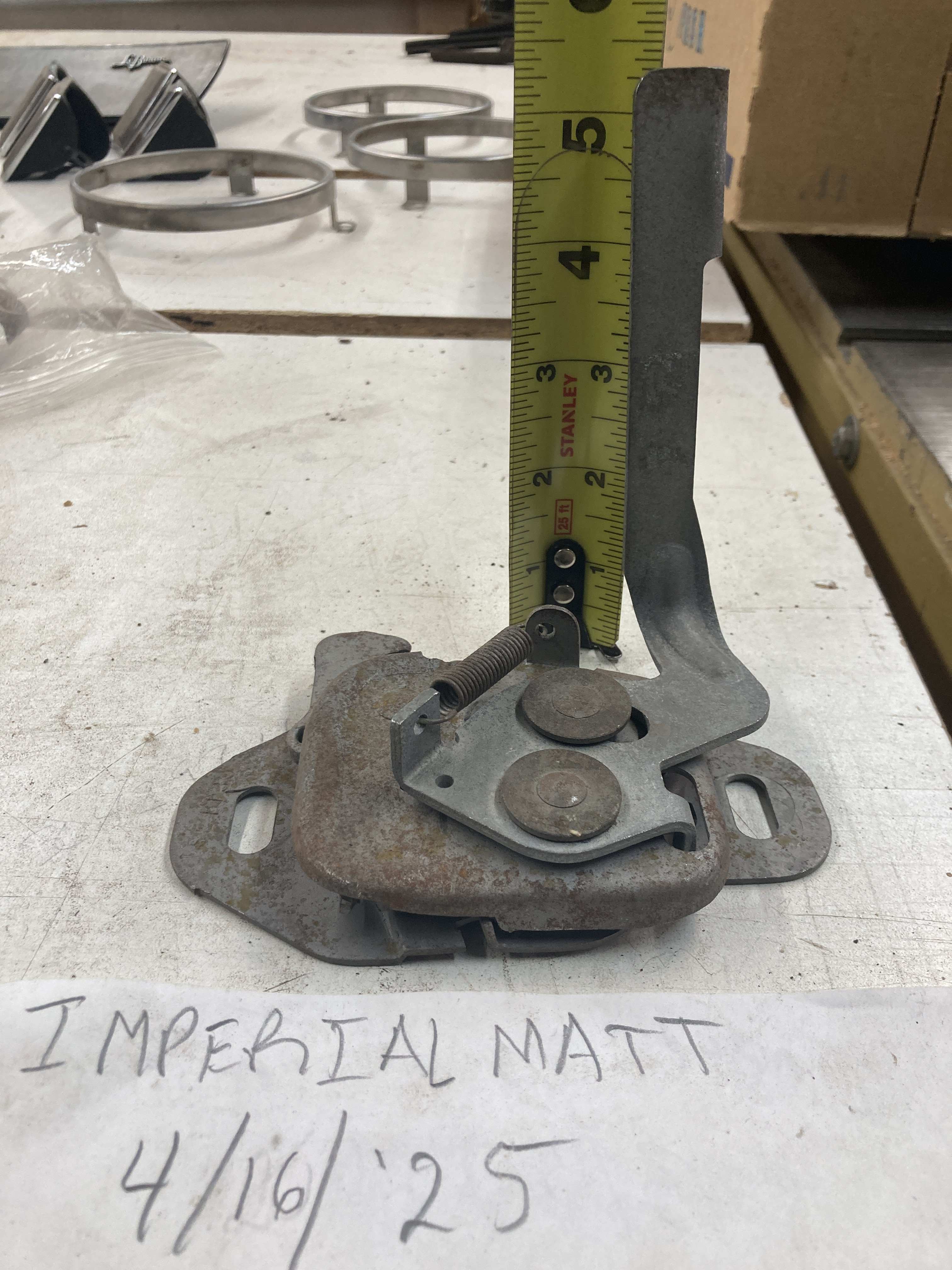

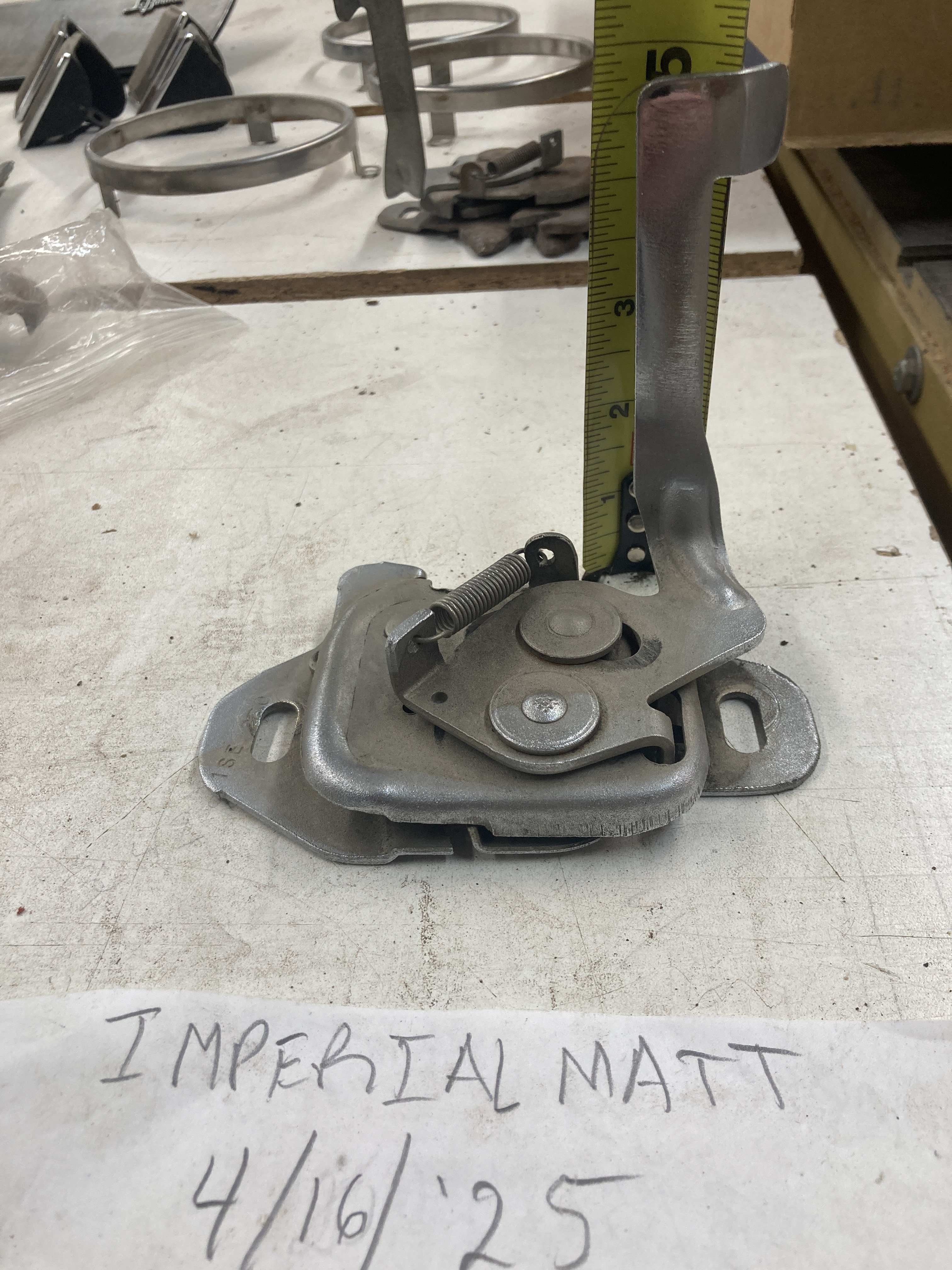

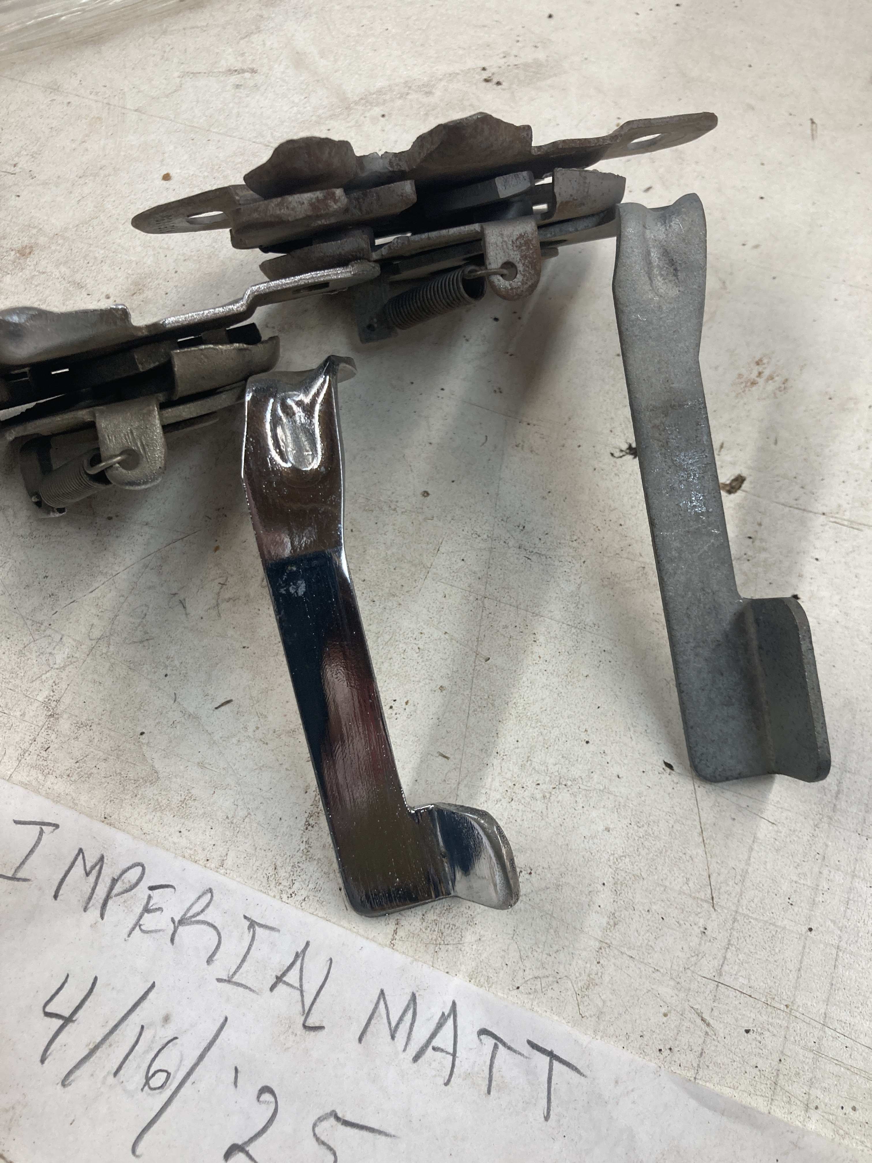

I’m having a hard time identifying the one on the left and I’m wondering if they are both for ‘70 Challenger even though the lever is different and a half inch shorter?

looking through my pictures for a challenger hood release.
I think, one of those is a 71 and the other is a 72-74. Don't quote me, yet.
This is a 70 Cuda hood release. 70 is one year only for cuda and challenger.
What are your part numbers on the release handle?

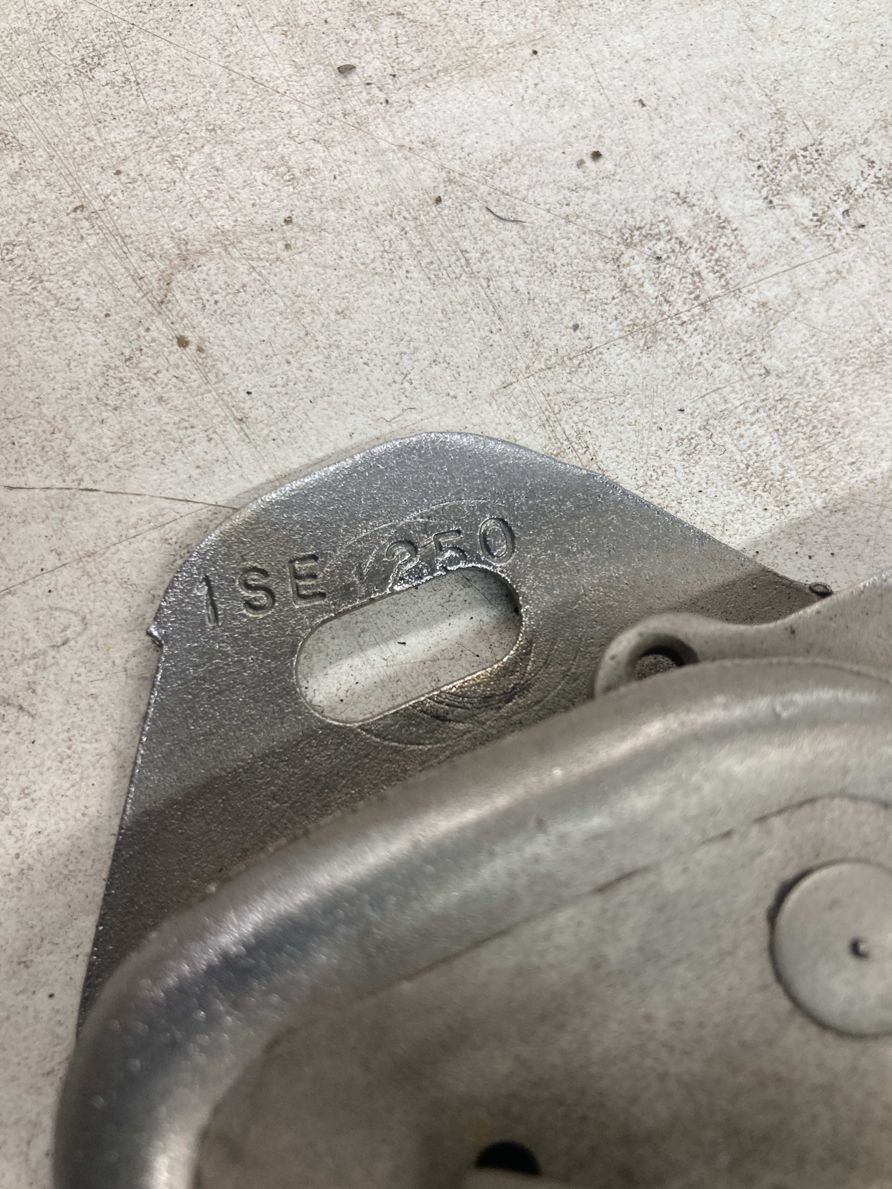

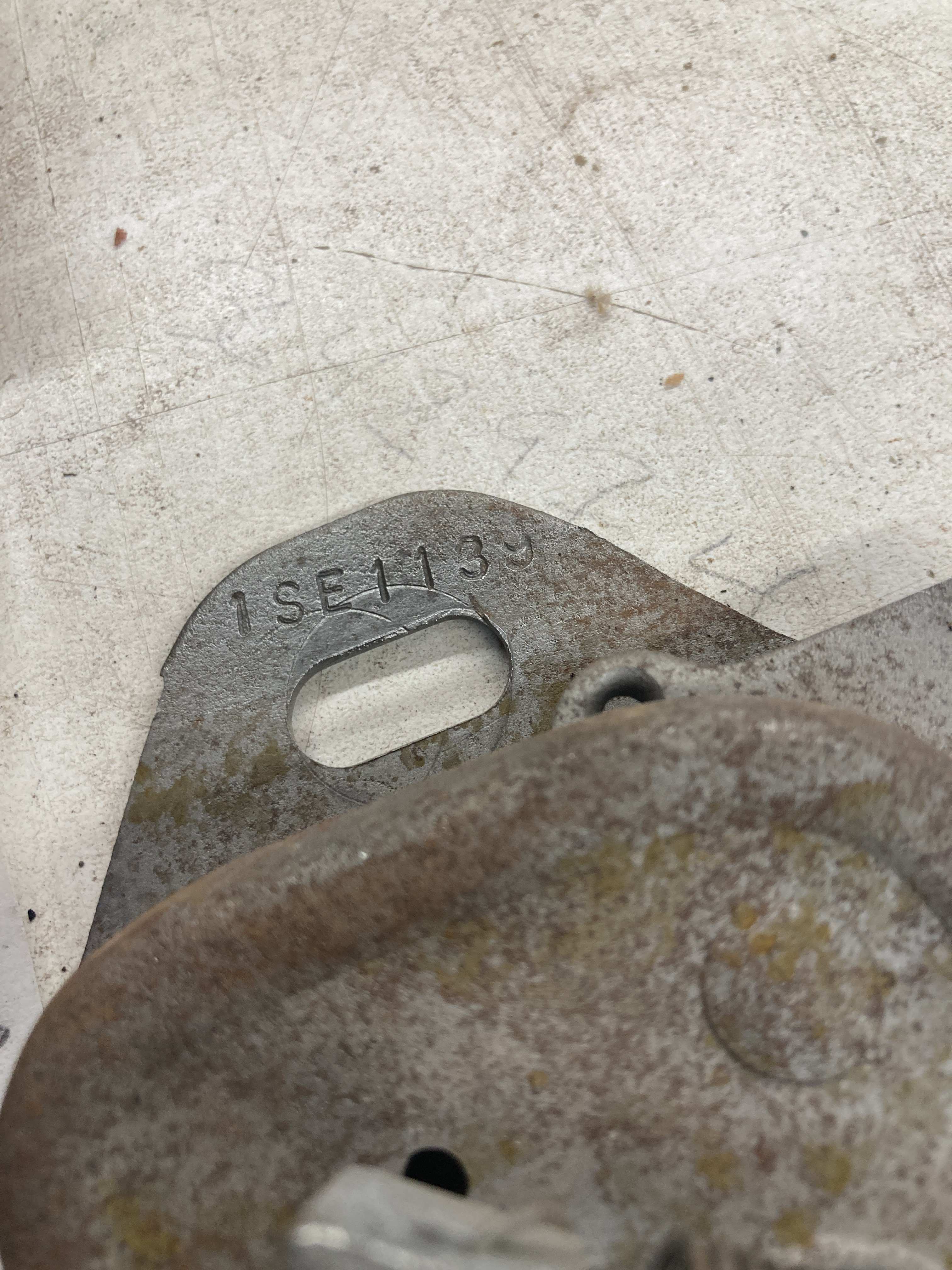

The one on the right in the middle pic I posted I know for sure is ‘70 Challenger and here is its date code.
113 day of 1969.

It’s the other one with the shorter tab on the end of the lever that has me scratching my head.
It’s dated 125th day of ‘70.

I am not a challenger expert.
71 is completely different. A trigger latch like 71 cuda.
Without going and looking at samples I have, I am worthless
