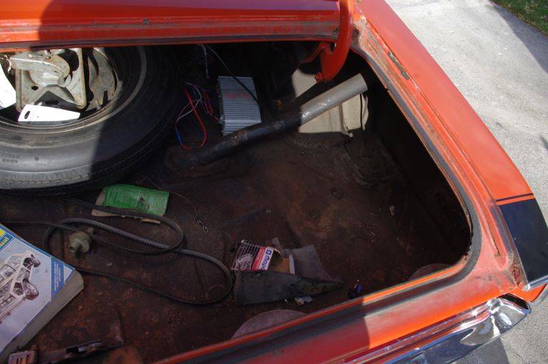

Told him I was walking and he came down to 8500, heh.
Still sounds like a mess. I'm the type of guy that's not above using Bondo in moderation. I don't mind the floor being rusty. I don't mind rust on the inner fender wells or a black spray bombed engine bay. I'll keep looking, but no car I get will get a royal treatment. It'll look good on the outside, and rust may hide in some places, waiting to emerge again.
Thanks all for the advice, you've given me a lot to think about.

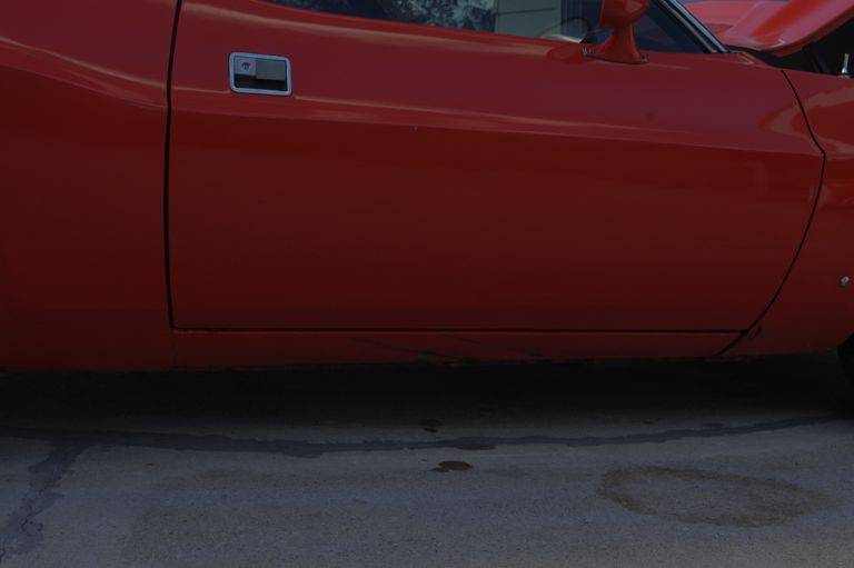

Against my better judgement...I drove out there to give the car another look. Poked around under the car while the guy was inside taking a phone call. Left many large piles of rust under the car. Frame members were basically disintegrated in many spots. Then, I left.
Phew, what a heap.
