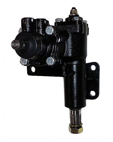

hello ,my WSS challenger has power steering and im looking for info on a replacing the box with a swap from something else -- maybe a police car ?

Firm feel rebuilds your core, and can put in A 16 to 1 ratio kit. there is A Pittman arm and idler arm kit to change the steering ratio as well.

Strongly recommend "FRIM FEEL" They come in different levels of resistance and made a tremendous difference in my 72' challenger. They are resized/rebuilt and a perfect addition to the car. www.firmfeel.com

I have the stage 3 firm feel. Its a little to firm but I'm getting use to it.

Same FF3 with fast ratio pitman & idler arm tuff wheel major improvement over the stock the other option is the Borgeson Delphi adapted for the e body basically a landcruiser box appears to have the mounting plate welded to the Delphi housing.
with the adapter hoses & Shaft coupler pushing close to $900

I put in a firm feel stage 3 box. It is tight like a modern car. No regrets at all.

Also, I do like the Borgenson ps box, but.. since I have a T/A ps box already I may as well keep it (even though the lighter weight is appealing to me with the Borgenson ps box).

I have the FF Stage 3 with fast ratio pitman/idler & Saginaw box. Works great!! I wouldn't go down to the stage 2.

firm feel satge 3 all the way with sector ceneter suppoert and idler roller bearing, hotchkis tvs, subframes and torsion bars and fox adjustables. car rides like a slot car..
