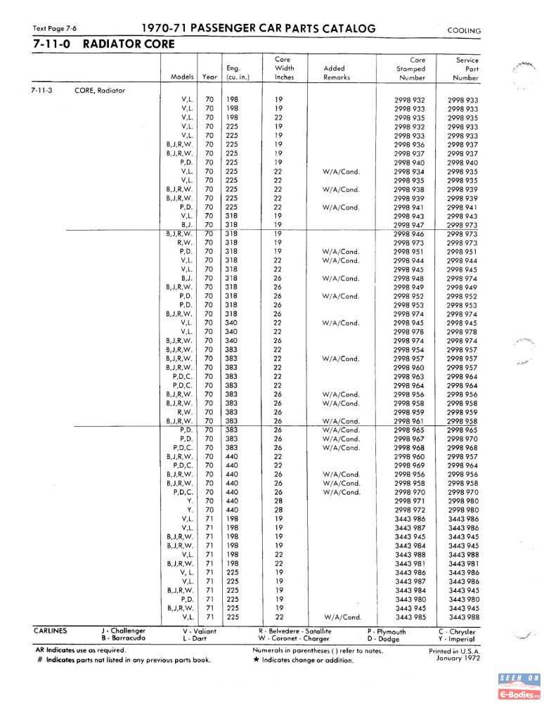

Hi everyone. Another question about my car thats not clear in the available data being a 4sp with A/C, what is the right radiator part number? Is it the 956 or the 961? The original radiator blew up the day I bought the in LA and drove it to Yuma Az in 1990. I was dumb then and threw it away.

1970 Cuda 383 with A/C had a 26" radiator. The radiator chart shows both the core stamped number 2998 958 & 2998 961 but the 961 is the 383-4 BBL radiator.
The 956 may also be correct as it is listed under Maximum Cooling. Glen-Ray Radiators has outstanding reproduction radiators that include the correct radiator cap and ribbed overflow hose.

Thanks Moparcarguy. Thats the first listing I have seen that is definitive to the 961 radiator. Other listings would have noted it was for Auto trans and why I was never sure. There is a 961 radiator on E-bay right now for $300 that needs to be re-cored but tanks appear to be nice. Not sure thats worth re-coring (actual cost) or just laying out cash for glen ray?

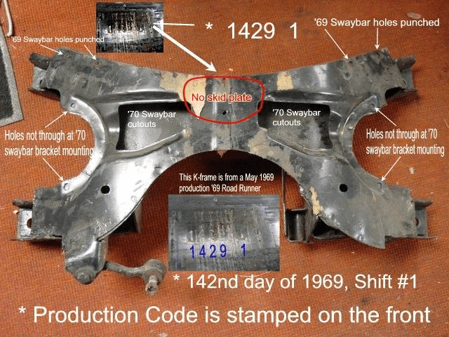

The K frame might have the date on it. Then you would have a time frame
It's an early production model, December 1969
Here again the K frame date.

Thanks for the breakdown Challenger RTA. I will see if I can pull a date code off the K frame. In summary, this car absolutely matches what the fender tag says without any evidence of modifications as I really really know well the build of an Ebody. My theory after this whole discussion is that it was in an accident in the left front and the left inner fender was replaced so that prompted the need for a reproduction tag. The only questions I have with respect to the tag says and what the car shows is the R21 code and the now the V4X code. Maybe there was a mistake on how they made up the tag and it really should have been R11 or R22 and maybe the V4X should’ve been a V1X. We will never know. A repro tag would’ve been manufacture probably in the late 80s so they weren’t very good at making it perfect and its really being attacked. This is my best theory based on what I see and I know it is not able to be proven, but it’s what I believe happened and really don’t care and just want to make the car as physically correct as I can as to what I believe it was delivered. I know the wheels I’ll never know what they were but everyone always seems to put rally wheels on it anyway. This is the direction I took and I am going to stick with it and I will not try to pass on anything but what my theory is. Could care less on the value of the car. I just love E-bodies since I was 15 years old when I got my first 1973 Challenger for $100 in 1981. It was towed to my house put in the backyard and the first thing I ever did on my own was put a timing chain on a 318. I do want to thank everybody for helping me get the story straight and best way to represent the car.
