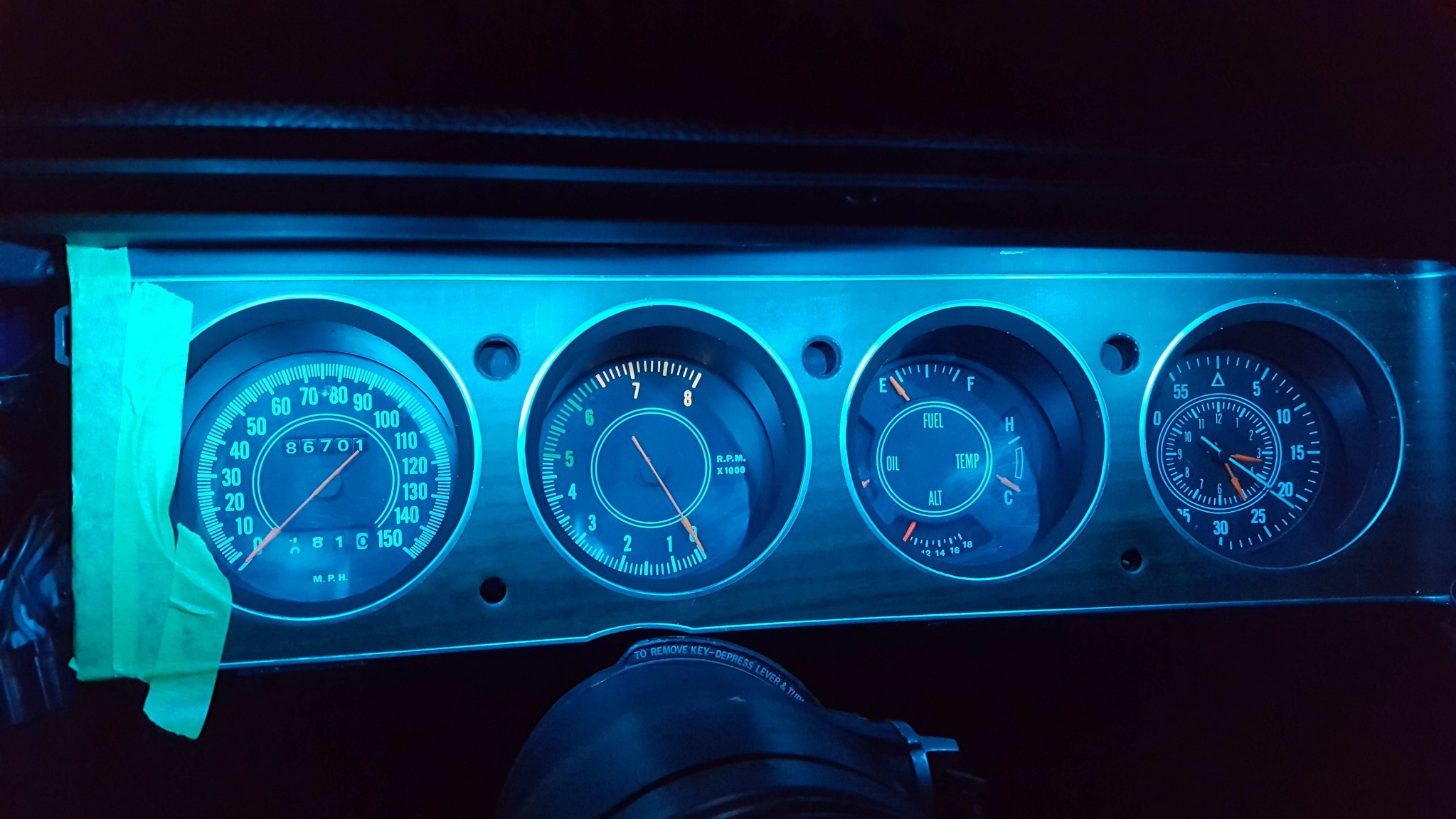

No. But dull the tape where it is put on the cluster to protect it.

be sure to protect the left edge of the cluster like @Challenger RTA says. 90% or more of the rally clusters for sale at swamp meats show scratches on the edge mating to the left switch panel. As we're putting the switch panel back in, the back side has some metal edges exposed that will scratch up the wood grain rally instrument bezel.

Recommend using low tack tape for protecting the edge. I had to swap out a dimmer switch. The blue 3M masking tape took some of the paint/printed woodgrain off the reproduction PCG. Very minor but slightly tragic. I do have some good recommendations for matching the various browns with model paint.

@cudanoob if you're super, super careful, you don't need to tape up the end of the rally dash. But one slip up, and presuming there were no scratches already in place, you may wish you had. I've done it without protection. But I took my time, listened to jazz, and it was chill. some dashes are already scratched up, there, so it may be less of an issue for some.
