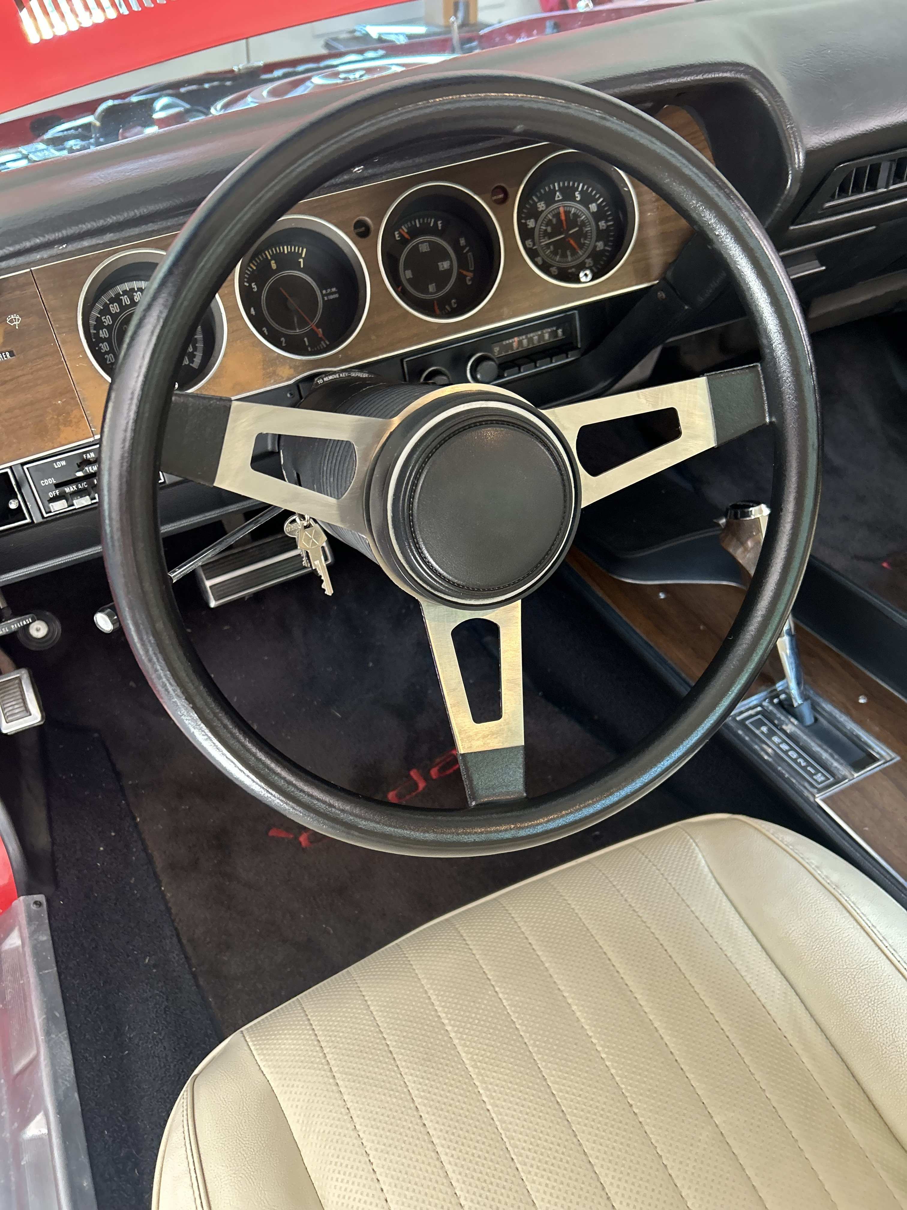

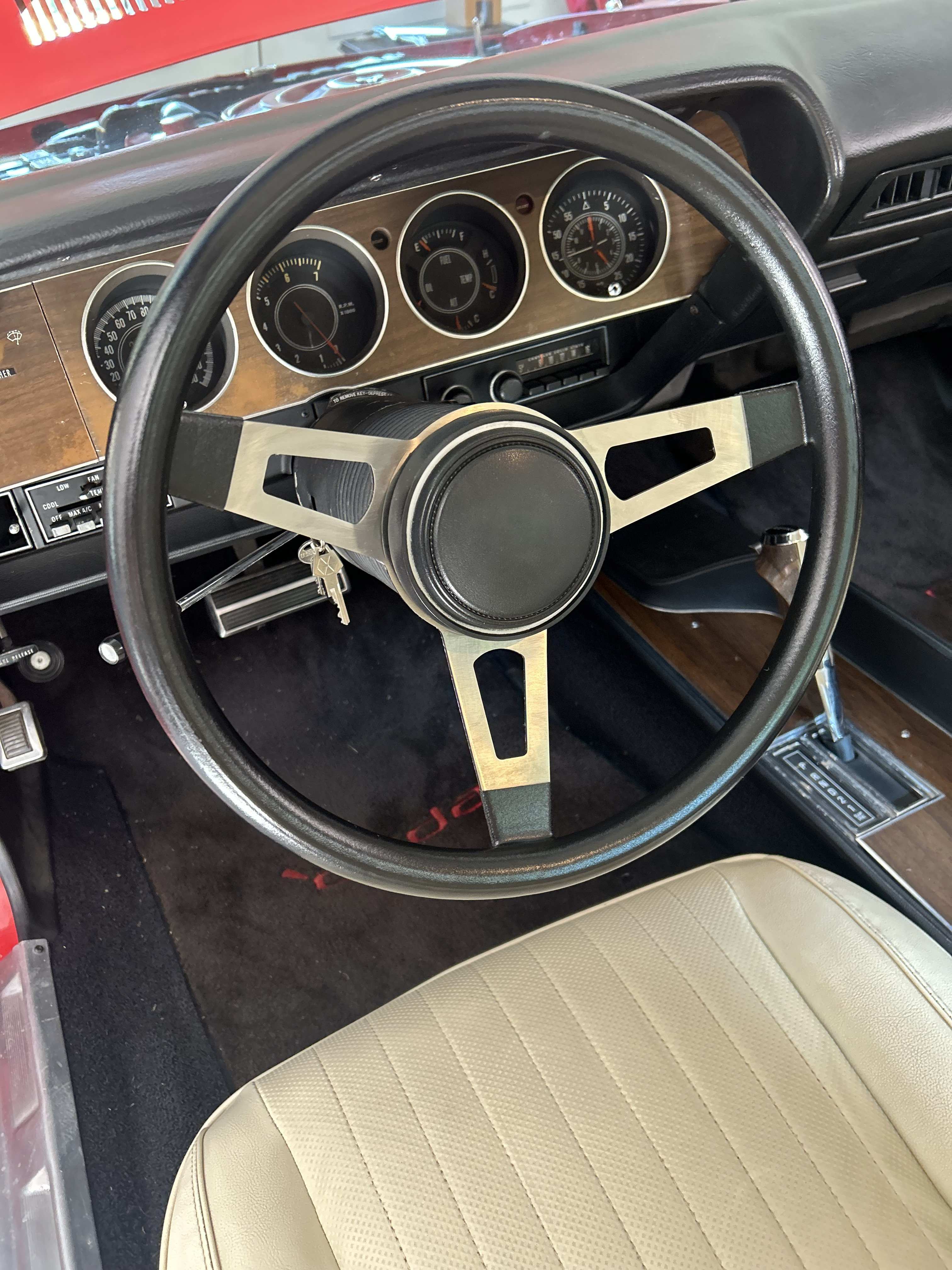

I have a 1970 Cuda that is in its stock trim. It’s got bucket seats. I’m trying to get some more leg room, which I know has always been a topic of discussion for e bodies. Currently the wheel is touching the top of my legs and working the clutch or gas is impossible without having to spread my legs. I’m 6’ and I’ve heard lots of guys say they fit fine and they are over 6’. Not sure what set up they have to accomplish that.
I have the regular seat sliders (not 6 way) and currently have the seat as far back as it will go. I notice my limiting factor seems to be the fact that the hinge for the seat back contacts the belt retractor. If it wasn’t there, I’d be able to get a bit more room. I used to have a Tuff wheel on the car, but thanks to Texas heat, it disintegrated. I like the look, but I don’t think it will hold up too well.
Any suggestions on some ways to get more leg room?
I’m thinking of swapping out the belt retractors for a slimmer one or even just a fixed belt. That should hopefully get me a little further back to straighten on my legs. I’ll also get a smaller diameter wheel, which I may just make one to keep a similar look to the Tuff wheel.

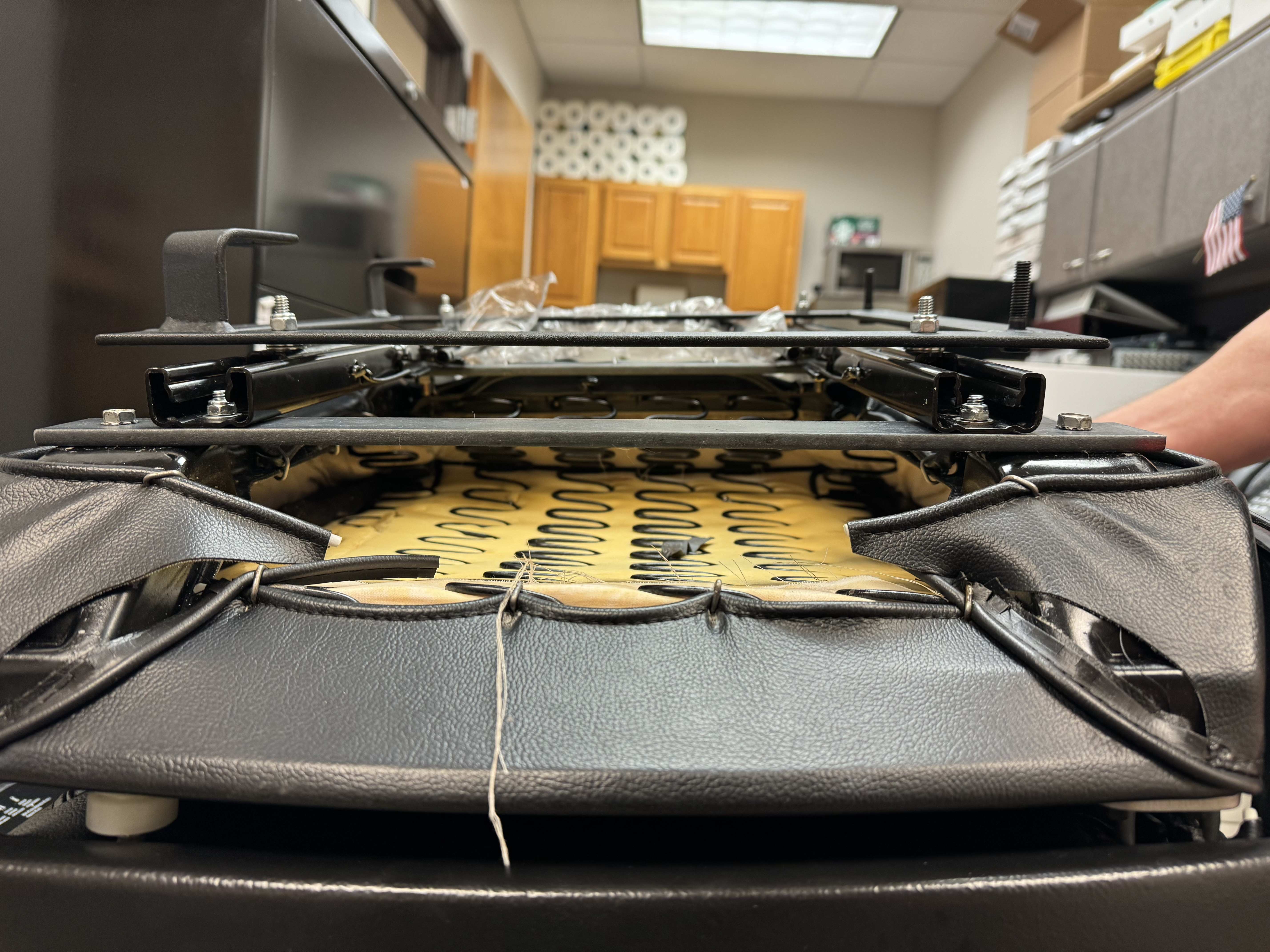

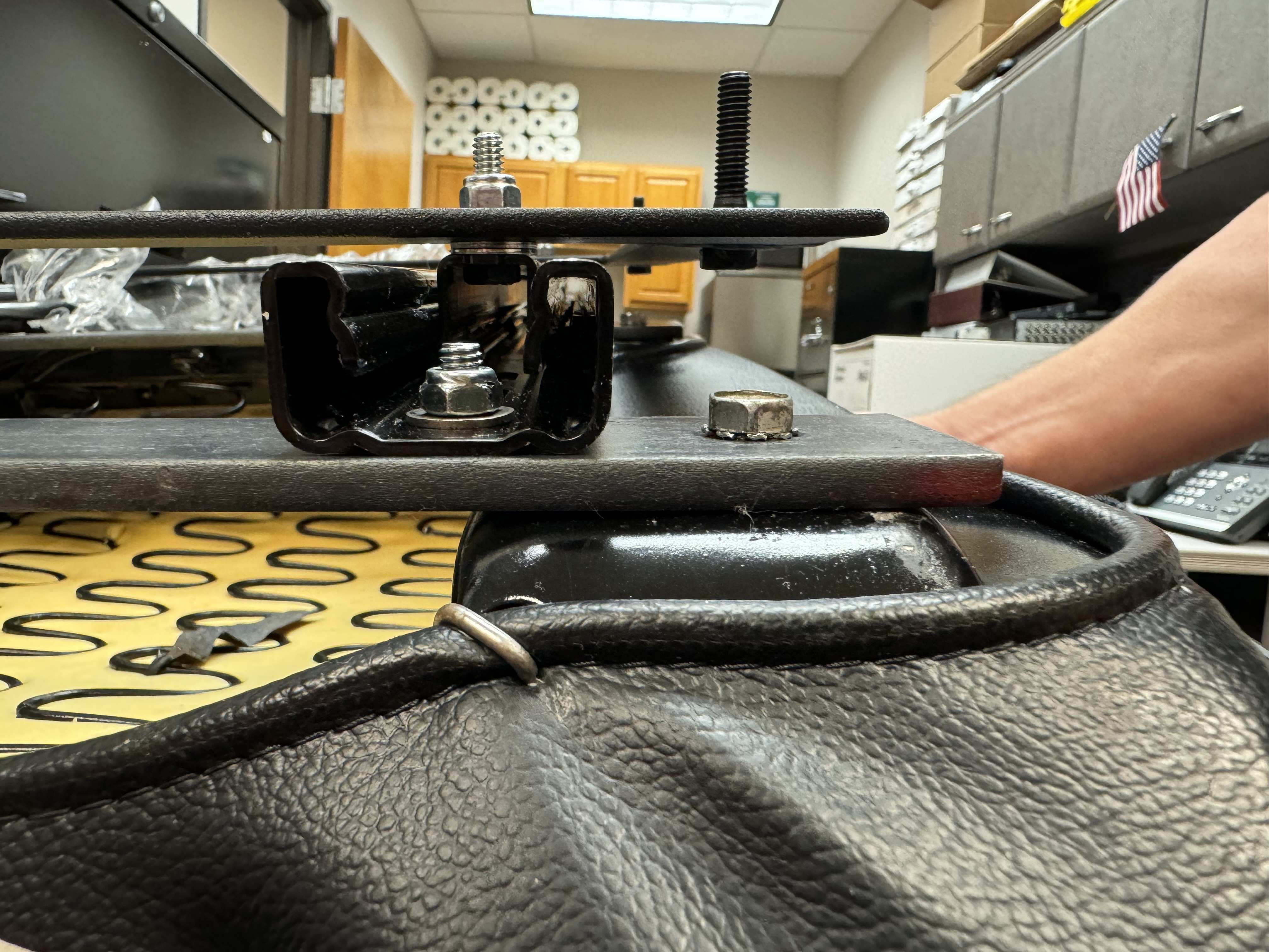

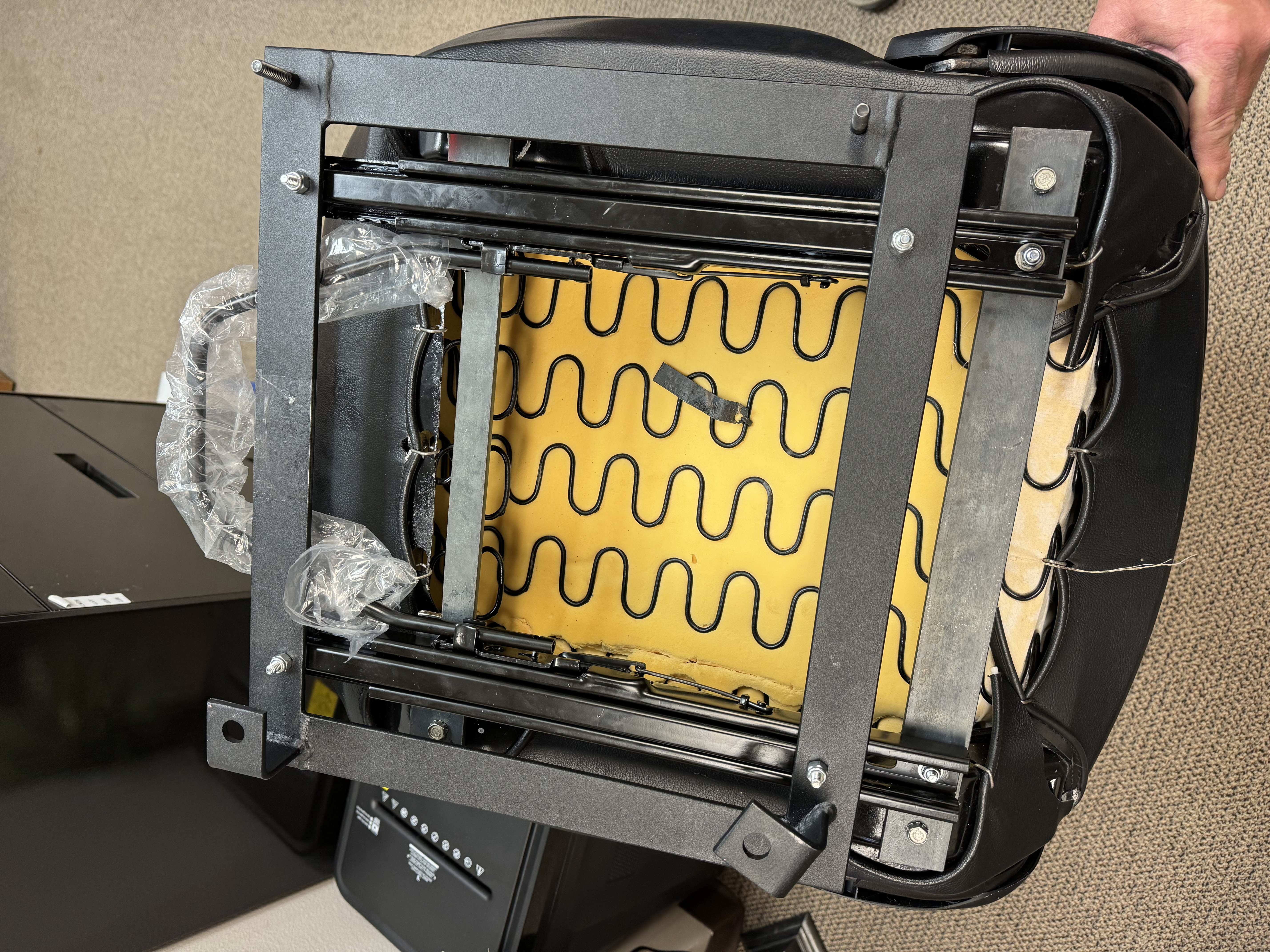

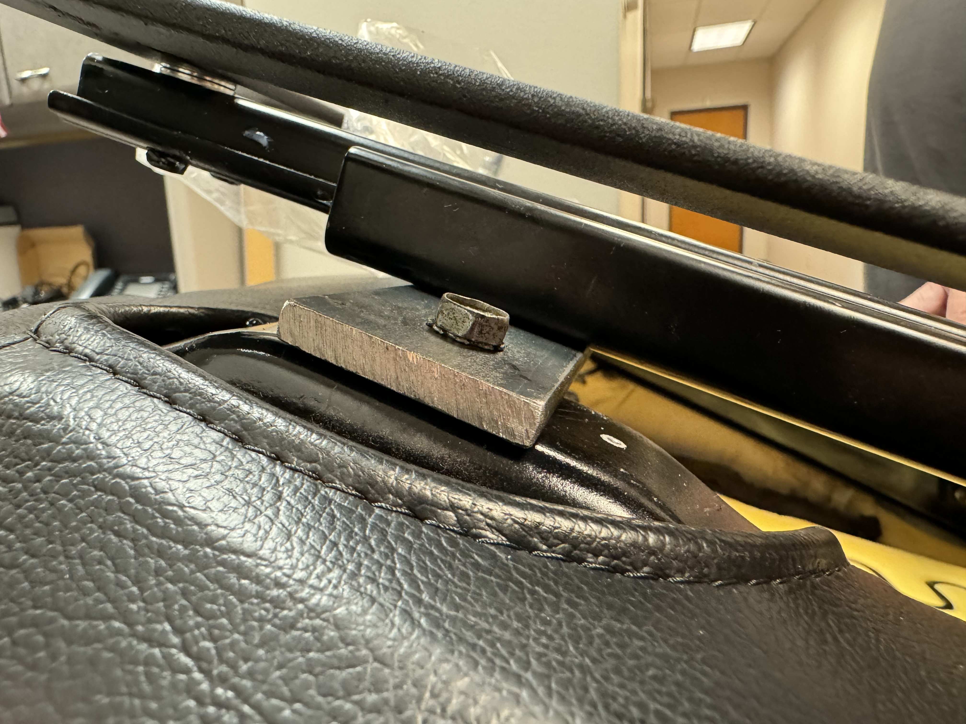

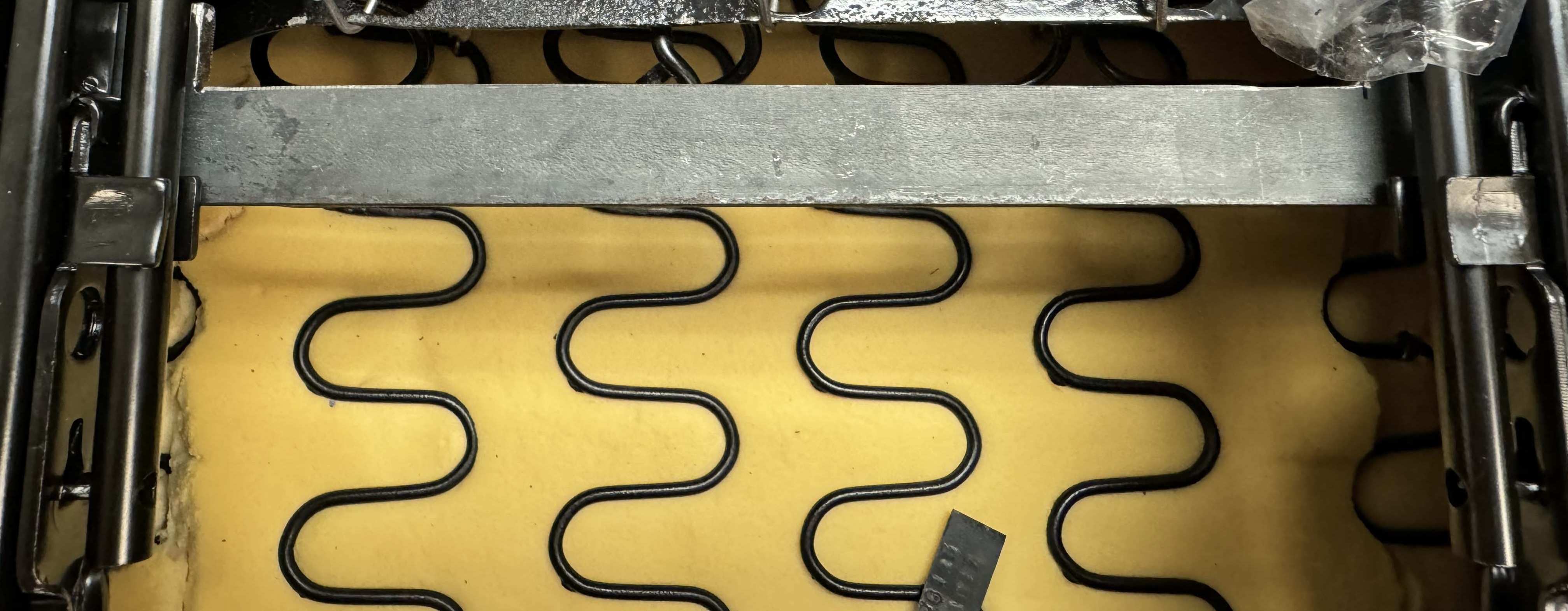

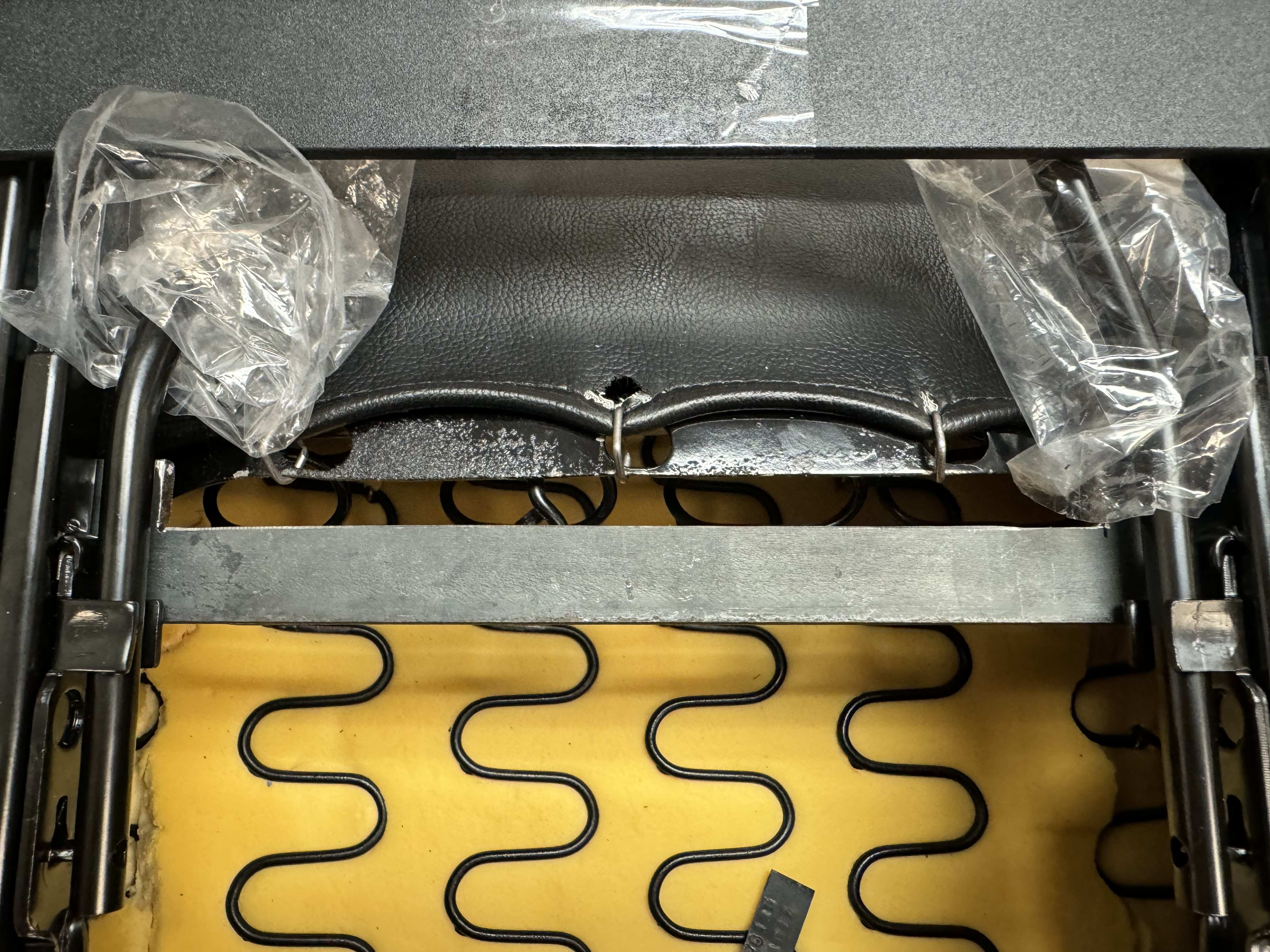

Alright, apologies for the lateness in a response here. I got busy and also went on a journey coming up with a fix.
In my endeavors to offset the seat, I ended up breaking the seat sliders. I will admit, this is due to a combination of ignorance and frustration. I ended up buying a new seat slider from Corbeau (Plymouth Barracuda 70-75 Seat Brackets). The seat slider is much more robust than the originals. It also slides super smooth. I will note, it comes with captive bolts on the two closest to the door. The two mounting points near the transmission tunnel are just holes, so you will have to supply those. It is a touch inconvenient but not a showstopper. The sliders appear to have the same amount of adjustment as the originals.
Here is the main kicker on the Corbeau seat frame/sliders. They are designed to match up with their own seats, not the factory bucket seats. The sliders are a bit narrower (cross-car) than the seat bolt holes. The sliders also don’t have a holes that line up with the seat in the fore/aft direction. I overcame this by making a flat steel (1/4” thick) bracket to bolt to my seat and the Corbeau seat slider.
For those who may be more handy, this Corbeau product is not very novel. It’s literally flat steel welded in a square shape. The side nearest the door just has bolts welded in place for the front and rear mount. On the side nearest the transmission tunnel, they just have two brackets welded to the square frame to make up for the change in height of the seat pan. The seat sliders are literally just bolted to that welded together frame. If you can weld, you can easily recreate the frame and then try to find some seat sliders off a modern car that may be a more direct fit to the factory bucket seats.
As far as my not so elegant method, I just had to notch the front steel bar I bolted on in order to clear a portion of the seat frame where the vinyl seat cover is stretched and attached to. I have added some pictures to show what I did. Please let me know if you see any major issues or see something that would’ve been easier. All this is a learning experience and I’m always open to some constructive criticism!
As far as results go, the seat slides super easy and I definitely gained more leg room. I’m still a bit close to the steering wheel, but a smaller wheel as mentioned in previous replies will definitely help. I also may take a look and see if the column itself has any ability to be pushed up a touch higher. If I do end up looking through that, I can update my findings in here further.
As for everyone who pitched in their two cents, thank you very much! It’s always appreciated especially for someone who is still trying to figure it all out, if that’s even possible 😆
