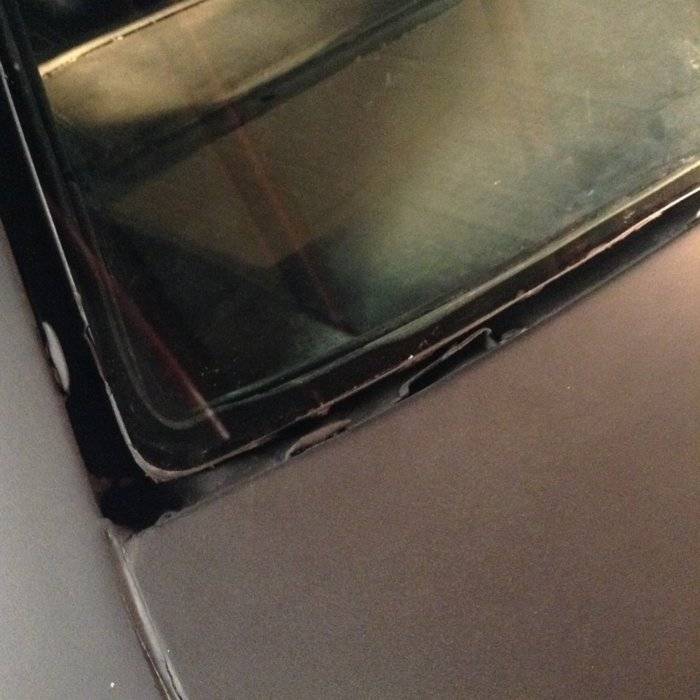

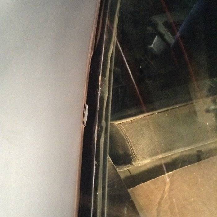

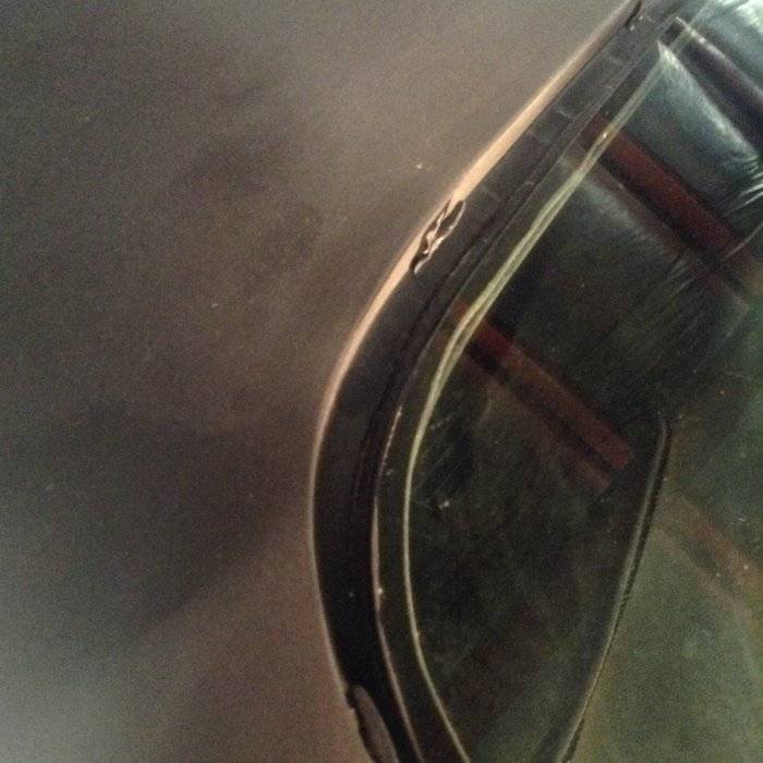

70-74 should all be the same size. I just resealed my 70 challenger with the original glass. What are you 1/2 short from? There are gaps around 1/2 on the top from the edge of the glass to the roof. Here are some pics of my glass on my 70 as I still have my trim off. My rubber spacers were no good so I put a wood spacer to get the gap right on the bottom.

How thick is the glass? there should be some type of markings on it somewhere! Maybe it's for a cudA? The rear window is different for challenger and cuda! If it's new made glass they could of cut it short somehow. I could measure my rear window and you could check with what you have?
