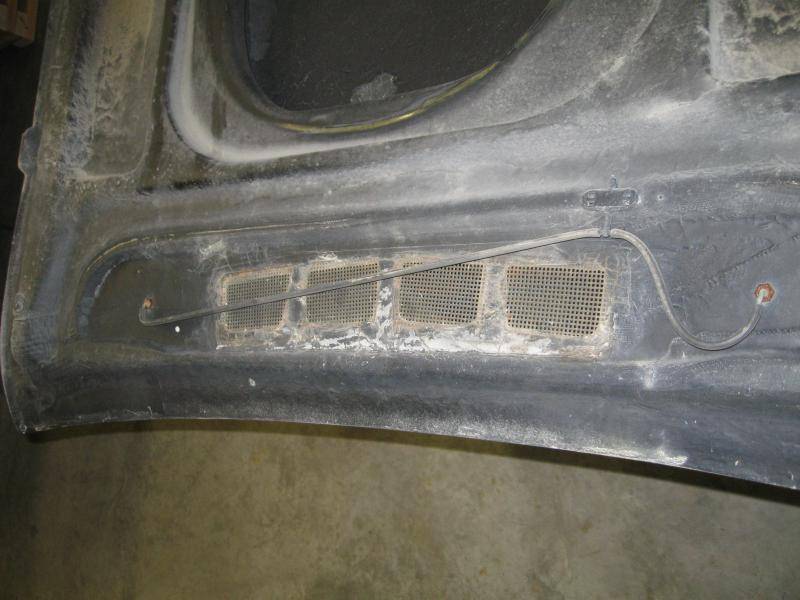

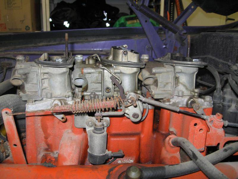

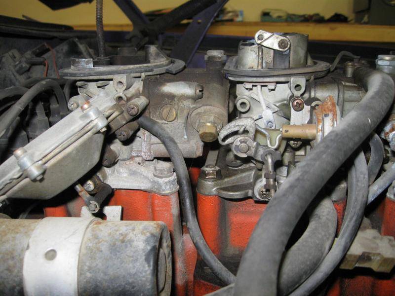

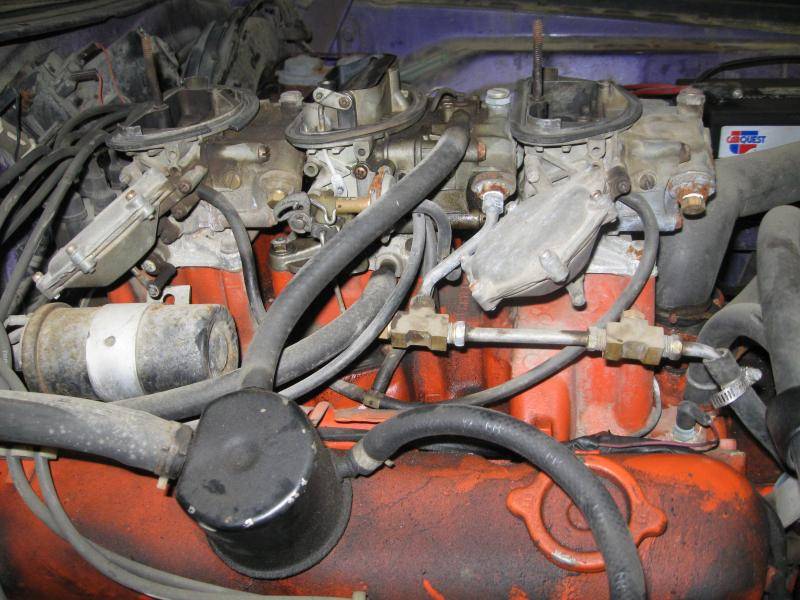

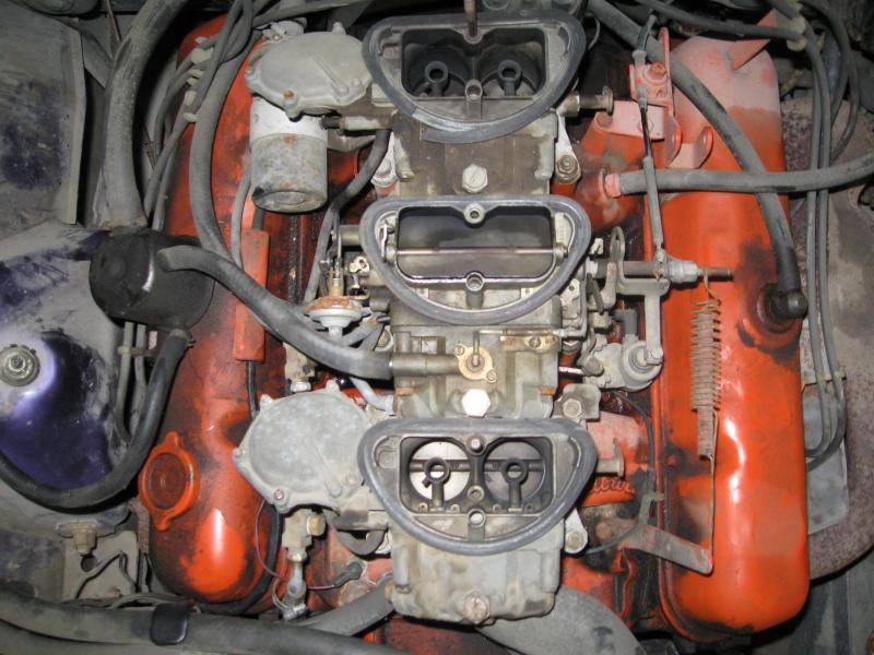

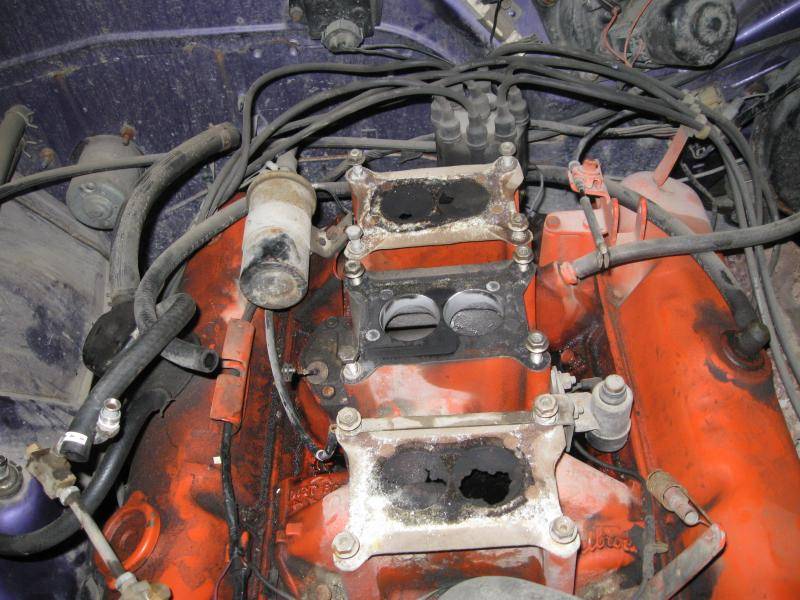

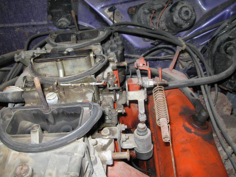

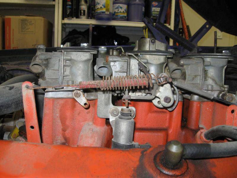

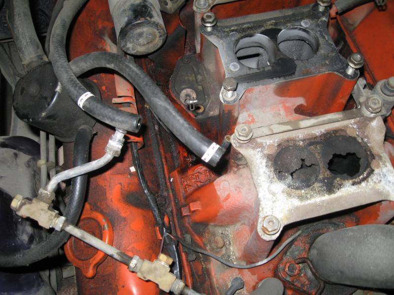

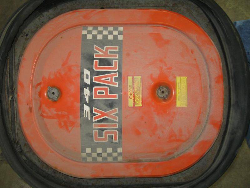

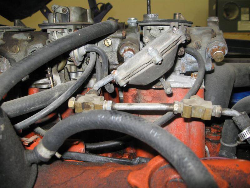

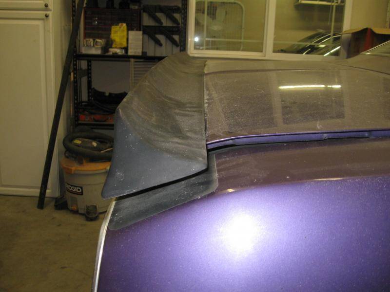

Hey everyone!! Been awhile, Ive done a bit of work on the car, but had some other stuff come up. I'm back in action now! I'll post some pics soon, but currently I got my 6 pack carbs back frome Eric at Vintage Muscle Car Parts in Ohio.WOW is all I can say, turned out perfect! Second, took the hood and spoiler to body shop, should get those back in the future... Timeline unknown. I'm done with the transmission, I'll post pics of it tommarow, and now im working on the rear suspension, wheels, brakes, ect. Also ordering up the parts for a 408 stroker motor build, and going to slide the original engine under the bench. Hoping to be in the neighborhood of 475-500 hp. Lots of progress, and more to come!

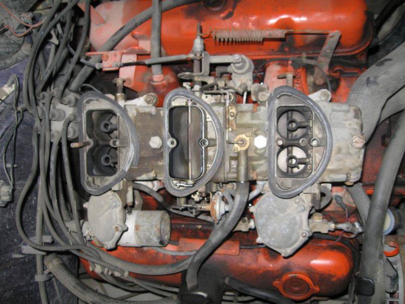

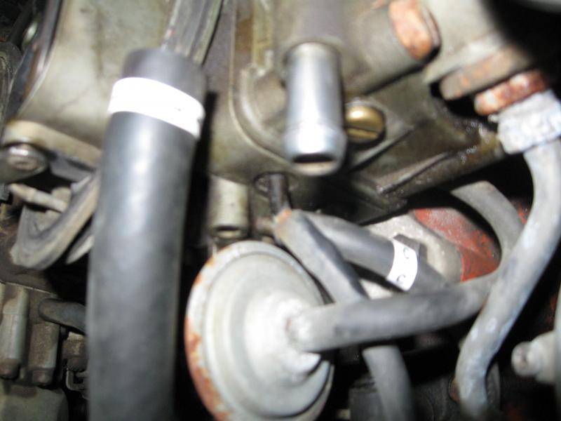

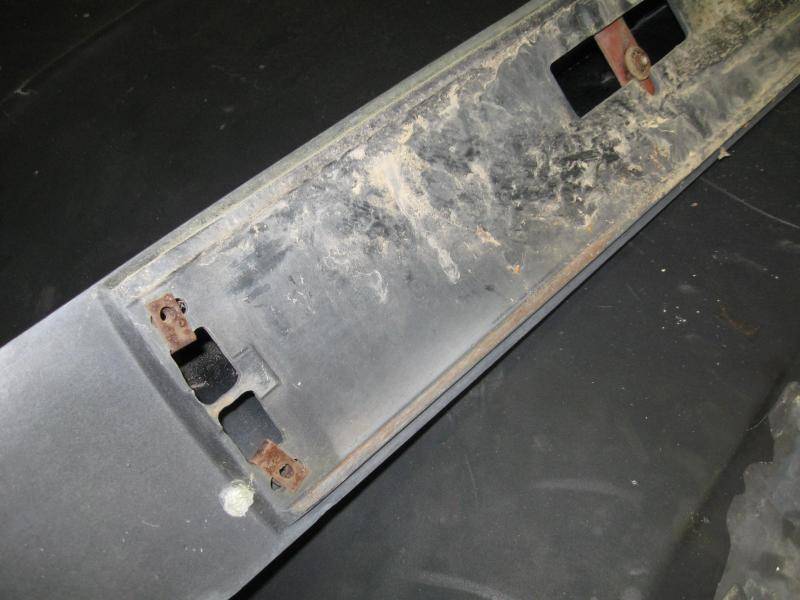

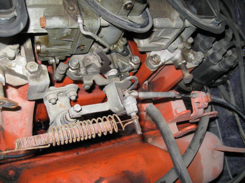

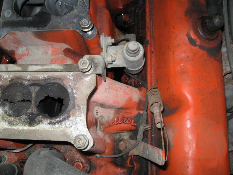

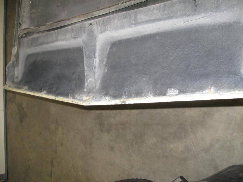

Jalaska907
Oct 23, 2014
72
24
Kenai, Alaska

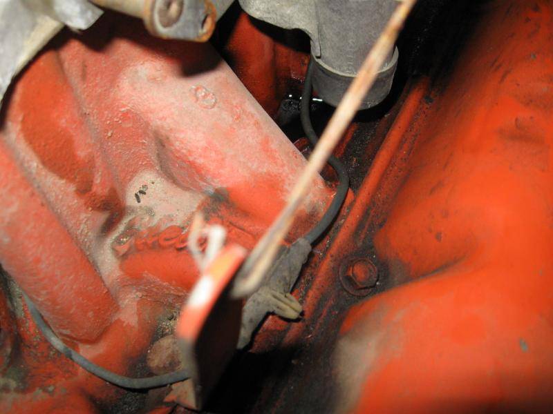

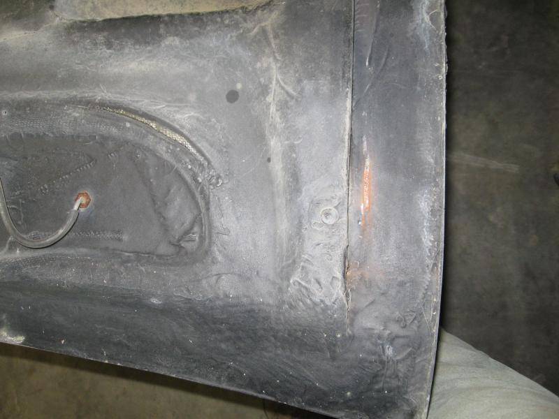

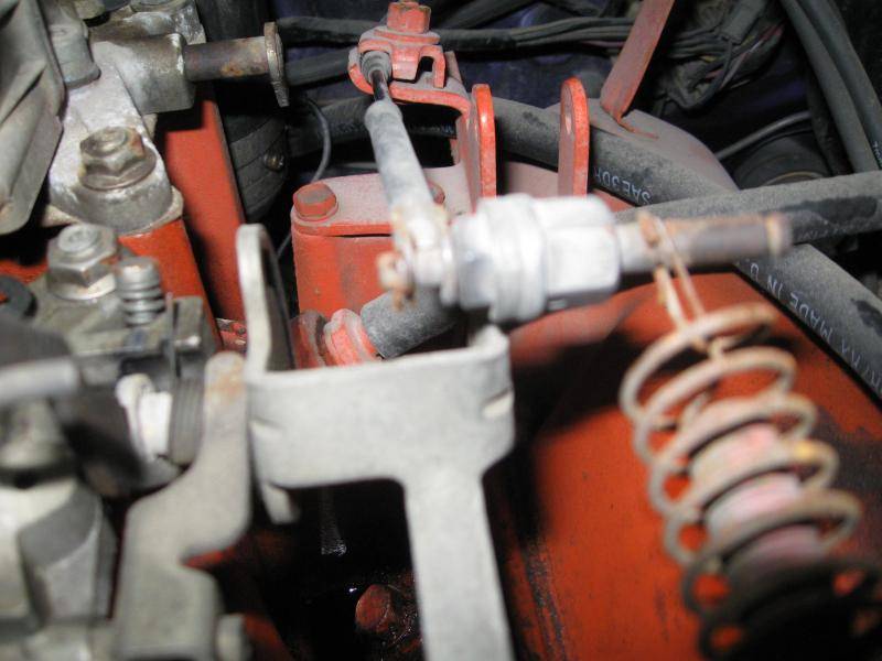

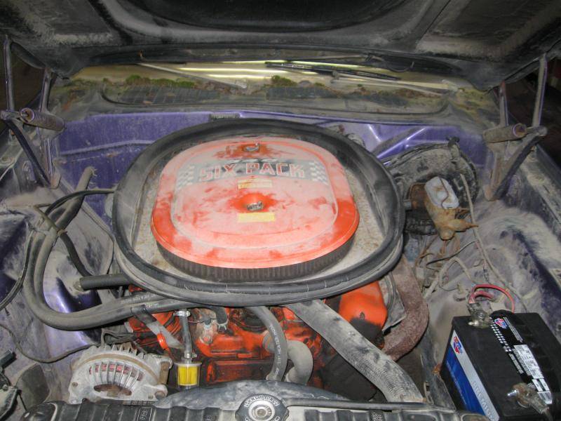

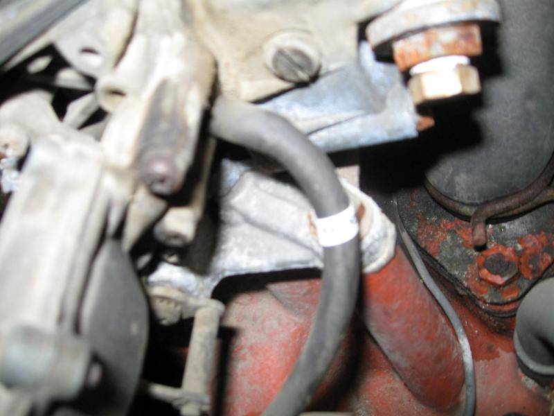

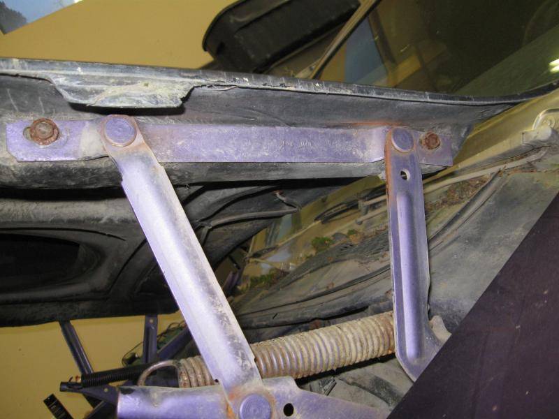

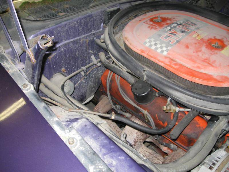

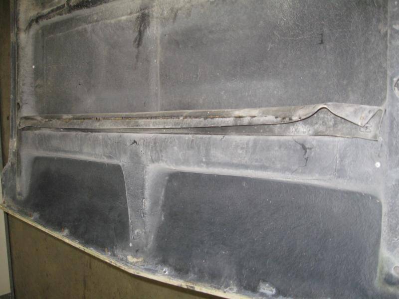

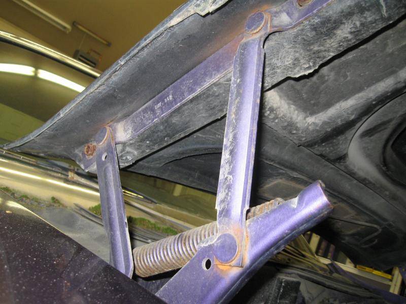

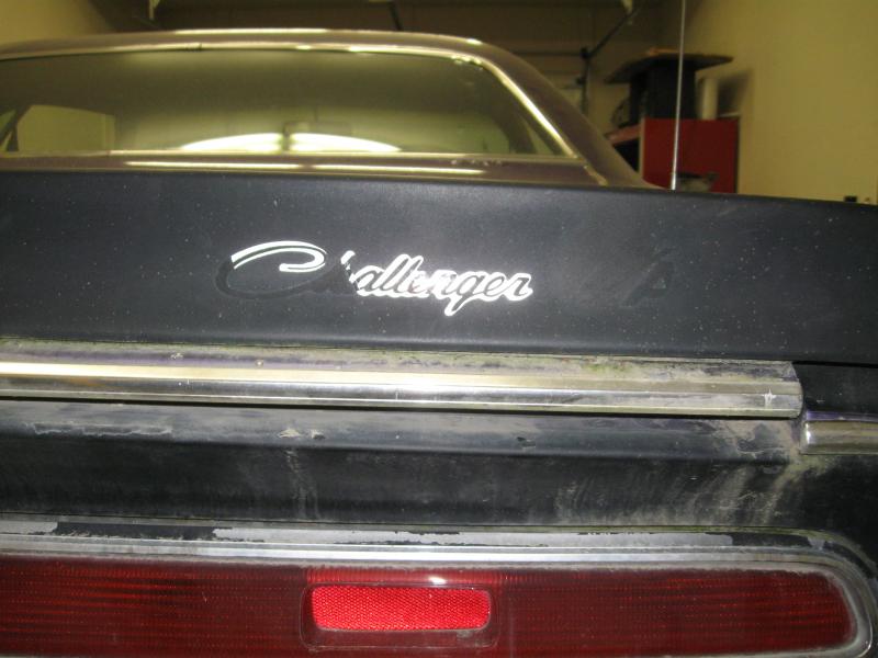

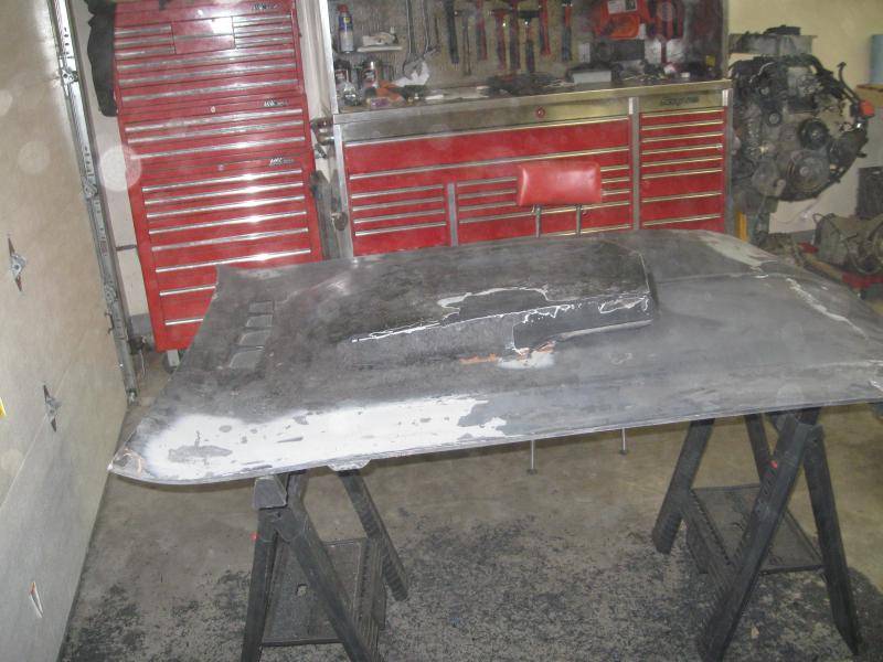

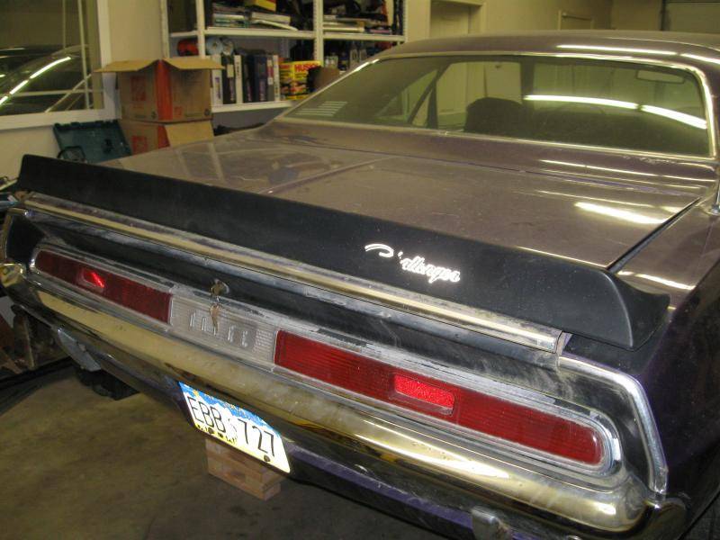

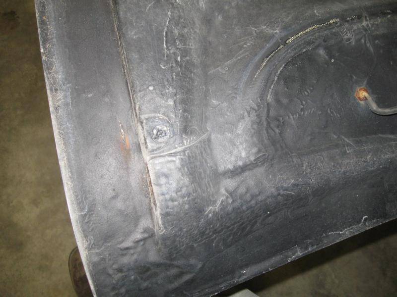

Here is those pics I promised DSCN0224.jpgDSCN0221.jpgDSCN0222.jpgDSCN0223.jpgDSCN0225.jpgDSCN0226.jpgDSCN0227.jpgDSCN0228.jpg
