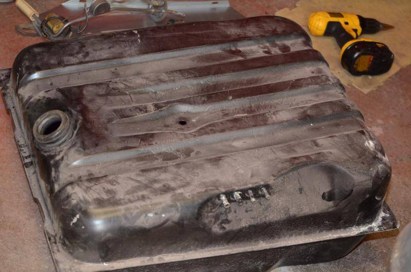

Hi all, my resto on my 71 barracuda, I bought it in 1984, wrapped it on a pole in the middle of winter when I was 22 years old then decided to restore it, now I'm getting it back together and have a question or 10.... ok the fuel tank I have it figured out except one major issue, on the top of the tank there is a hole 12 inches from the filler, I know the tank is vented from the cap and cant figure out y this hole is there, im thinking it was just covered by a piece of metal tape but doesn't compute, I have the 5 line
evap tube in the trunk..... does it need a fuel resistant plug or is it a vent to the right rail?

ahhh just got a manual from a friend in ont Canada there is a plug for it.....good luck too me to find it ..sorry not taking my original tank to a pro!!!!! im the pro!!! anyhow buying a 70 ta challenger tomorrow luv the e body

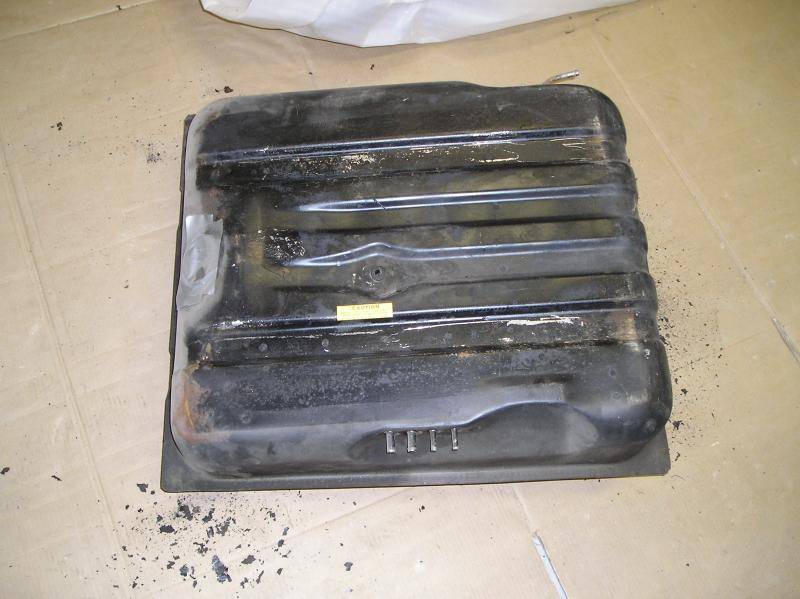

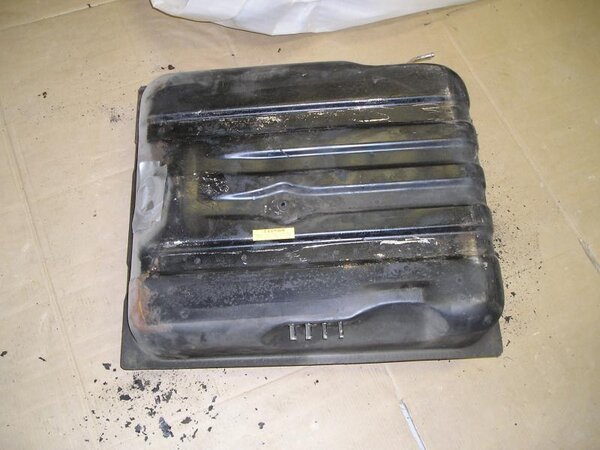

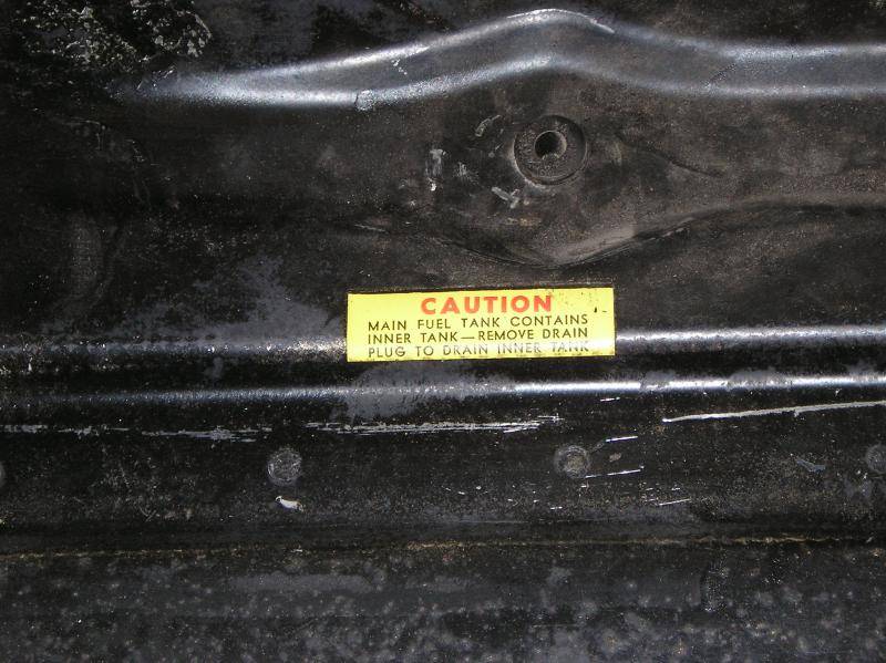

My original 1971 gas tank had a plastic plug in the hole and a "Caution" label next to it. The hole is meant to be there and is a drain for the thermal expansion volume tank on the top of the gas tank.
The repop tanks have the same hole as the original US built tanks.

Ahh that is awesome thanks all! So with it being a thermal xpantion plug I have to wonder is it calibrated to relieve at a certain pressure. ....it shouldn't I'm Thinkin as stated it's a drain for the xpantion tank not a relief. I'm liking this site!!!! Now the restoration will resume!
