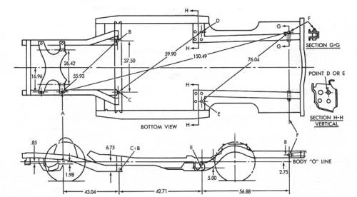

I need alignment specs for my Cuda.
Challenger RTA
Oct 28, 2018
4,301
2,331
PA Flood city
Frame
CUDA
Challenger RTA
Oct 28, 2018
4,301
2,331
PA Flood city
Frame

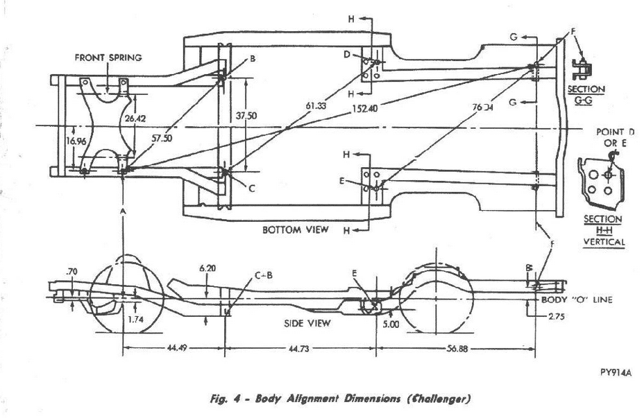

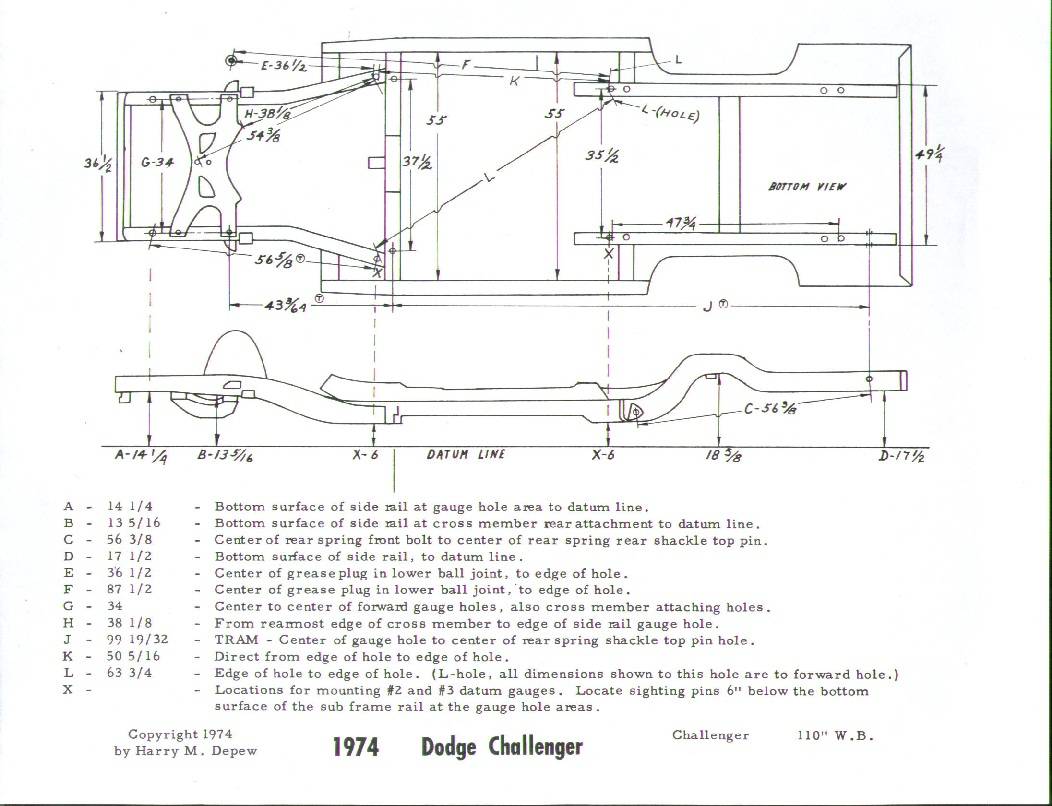

Challenger: For cuda don't use measurements that cross center section.
Screenshot 2023-04-23 at 12-45-39 Body Allinment Dimensions (Challenger).bmp (BMP Image 994 × ...png
Chuck
Apr 23, 2023
11
2
17776

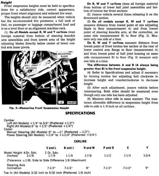

Frame alignment or front end?
Wow, Thank you Challenger RTA, only if I could spell alignment!! I need The front end alignment specs to get it aligned.
I see you have provided them below. I have to complete my welcome page to tell you guys about my car.
Thank you again, Chuck
