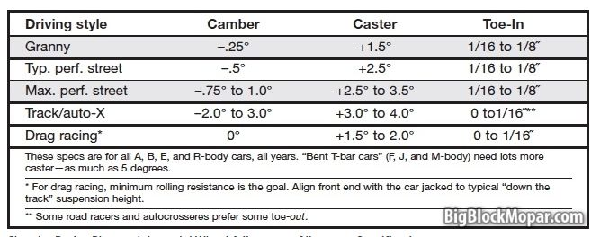

I just do them myself , turn the front upper control are eccentric all the way out & the rear all the way inward , using a digital level or your smart phone adjust the upper control arm until you have 1/2 * of neg camber & set the toe in 1/16 using a tape measure
Did you give them specs to use or trust them to find the specs?
I've heard of shops saying this because old cars aren't in their "toe-n-go" database. Which also highlights the fact that if they can't align it by twisting a single rod end, they may be claiming they can't get spec because it actually require analysis of what they are doing.
Try doing it yourself as Chryco suggested. Or, ask around at the next car show to see who others are using.
