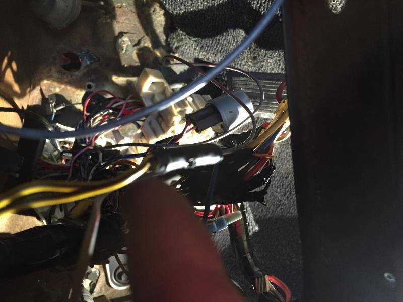

Mar 30, 2015 #1 B BoomerSoonerVA Well-Known Member Joined May 18, 2014 Messages 93 Reaction score 0 Does anyone know where this double yellow wire goes to I know book say time delay relay and courtesy lamp
Mar 30, 2015 #2 72RoadRunnerGTX Well-Known Member Joined Jan 8, 2013 Messages 294 Reaction score 202 Location Shoreline. Washington That is the tap into the door pin switch circuit, if equipped with an ignition switch light, the timer relay harness connects there. If not so equipped, disregard.
