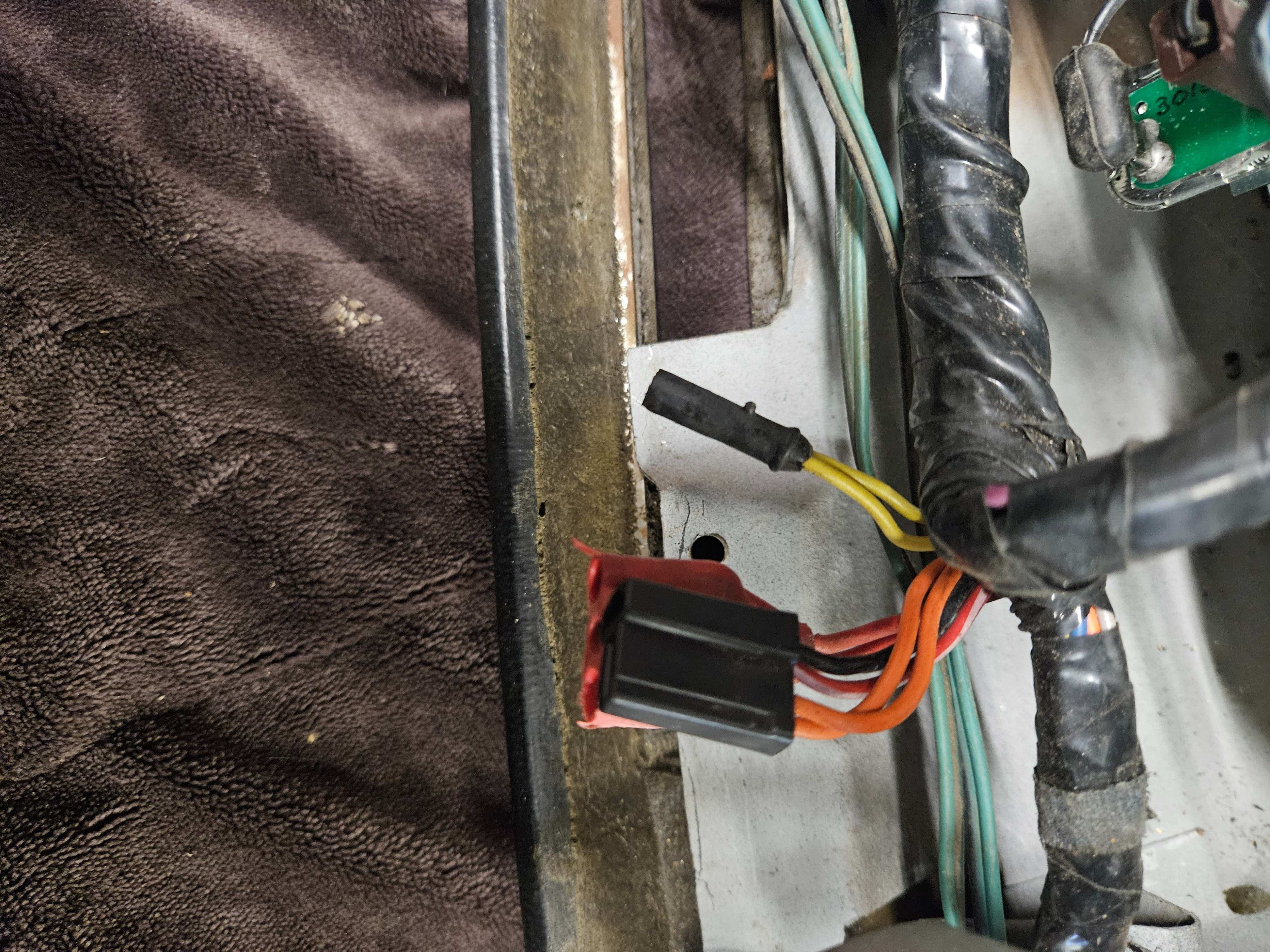

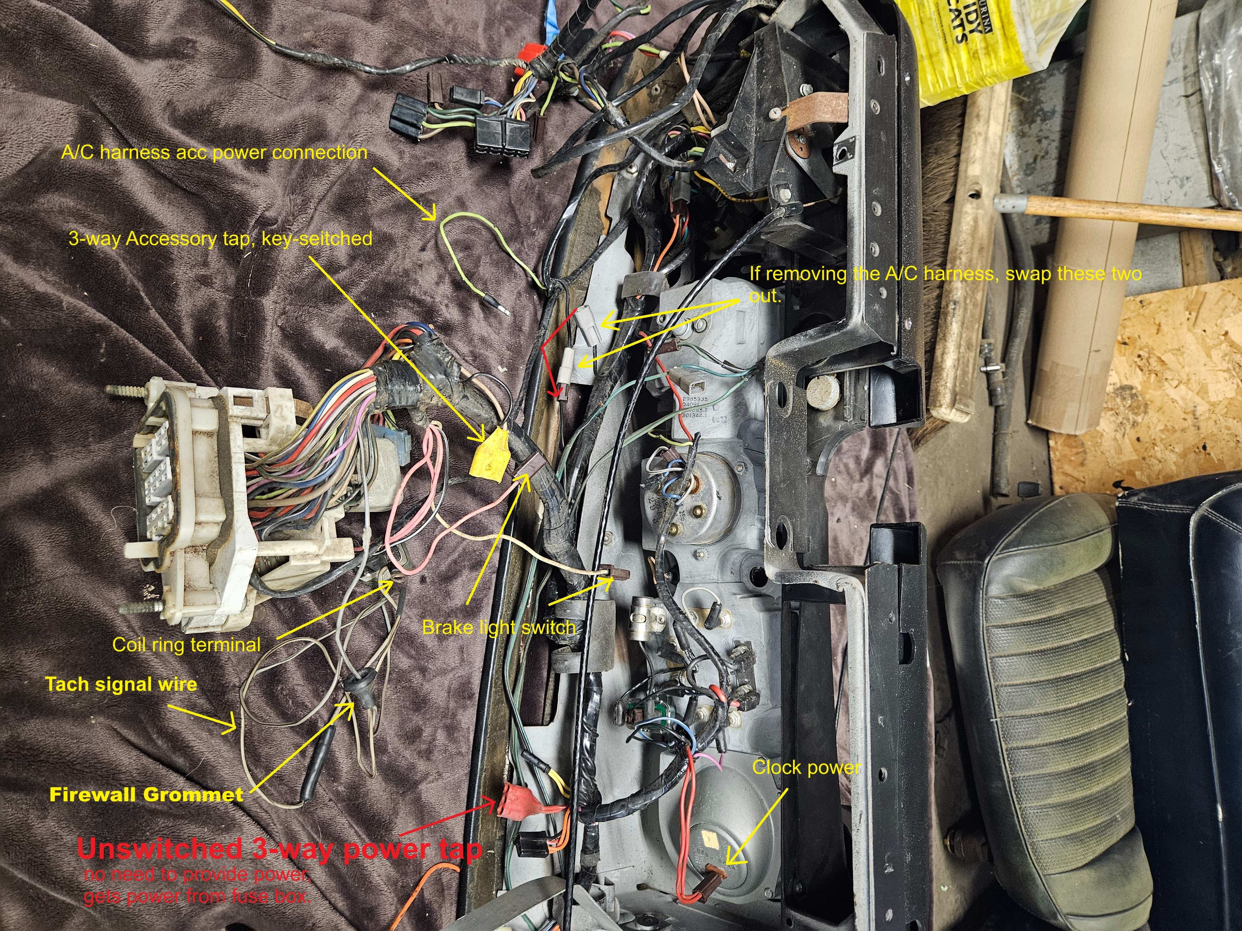

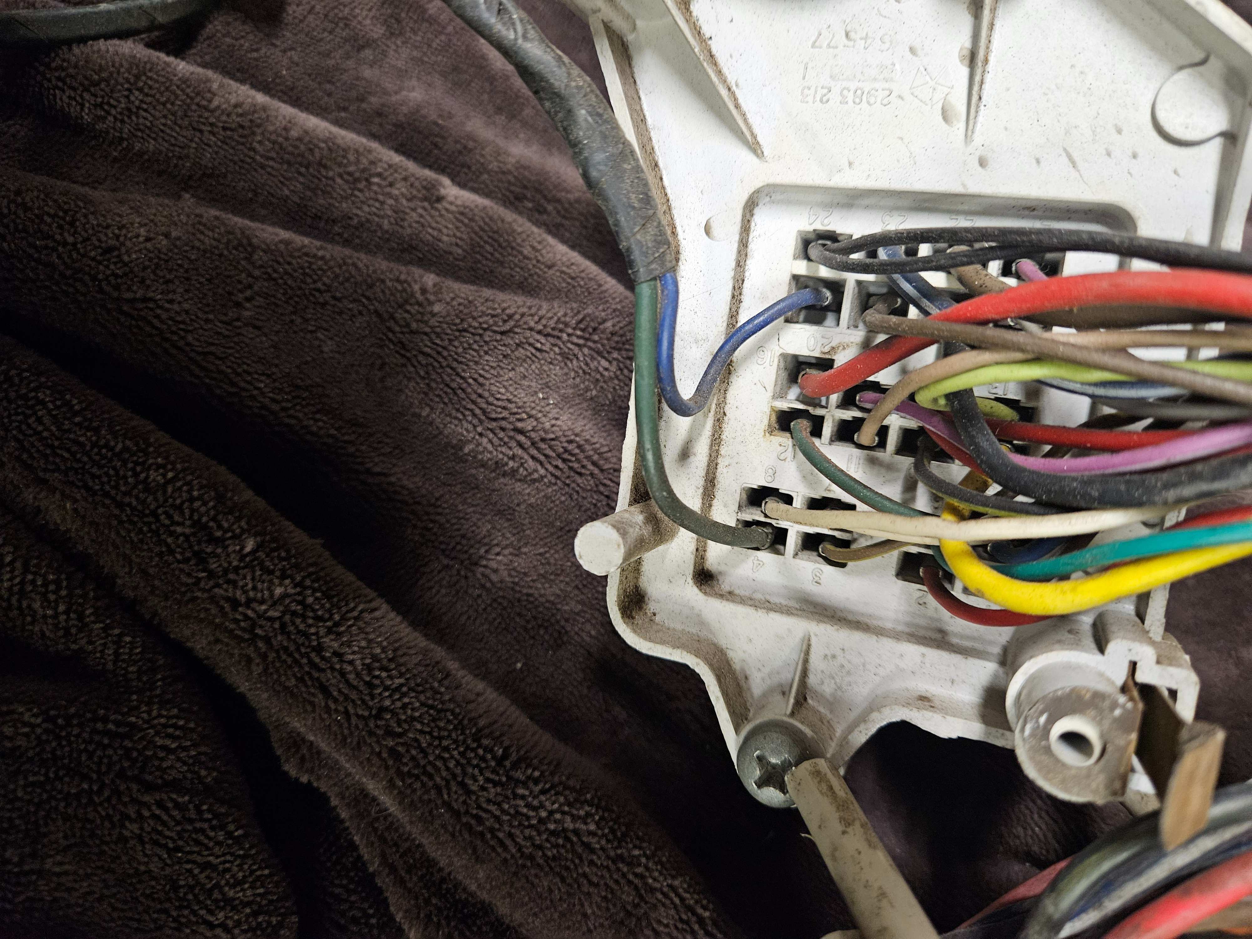

Here is the red connector I think you are talking about... Do I supply volts to that red connector..looks like the red wire go to the clock like you said... I\nHave this light green wire?I'm not sure about\nAnd a black wire connector... And it looks like a yellow connector a pink wire and a white wire with brown plugs...
correction, that's "key-switched" on that accessory tap
