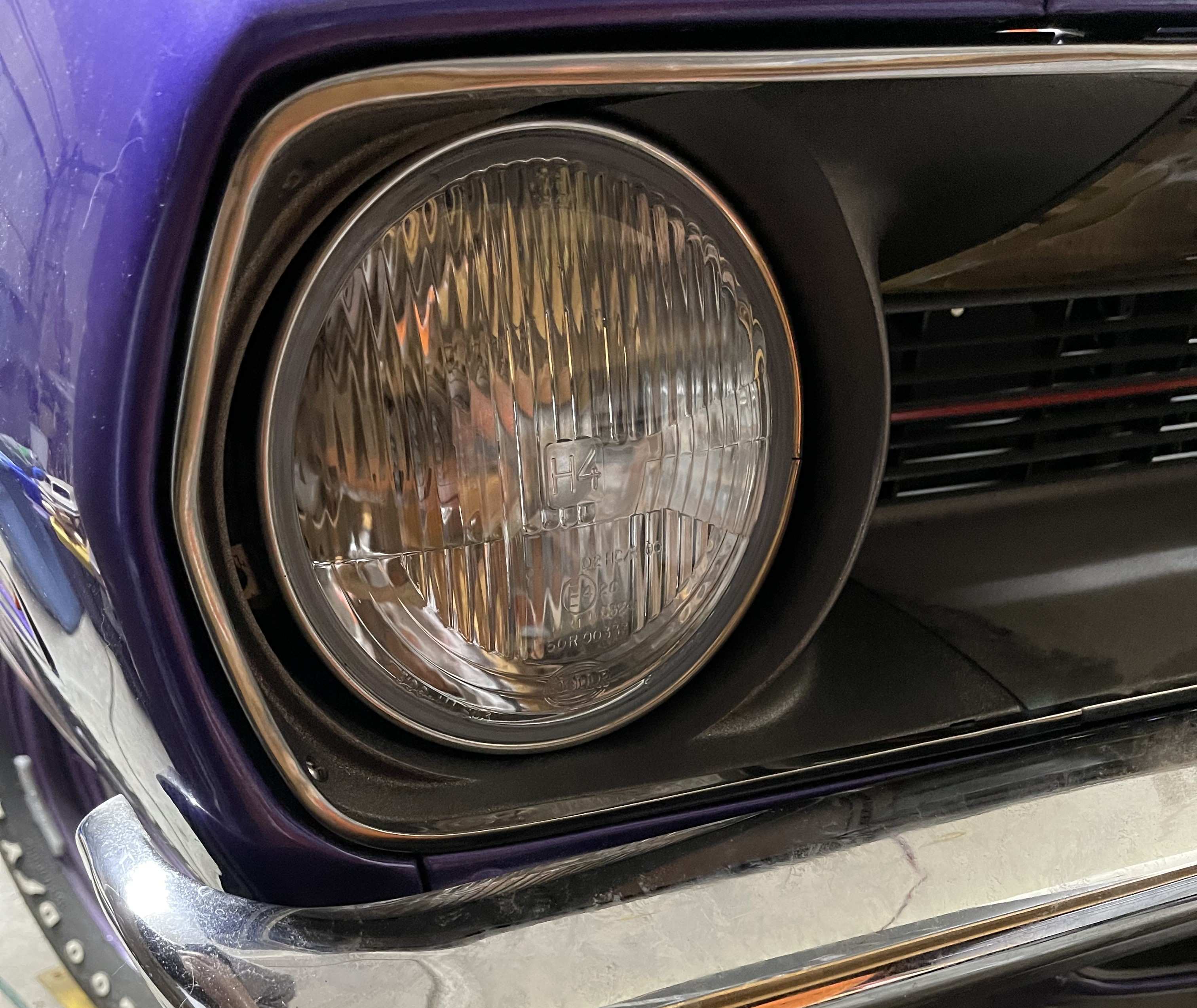

Please let me know, hope I didn't get a faulty pair.
Yea, Mine is the same as yours, an odd approach, I dont drive at night very much so ??
Just the top half is lit on high beam WTF
send em back if you want, too late for me

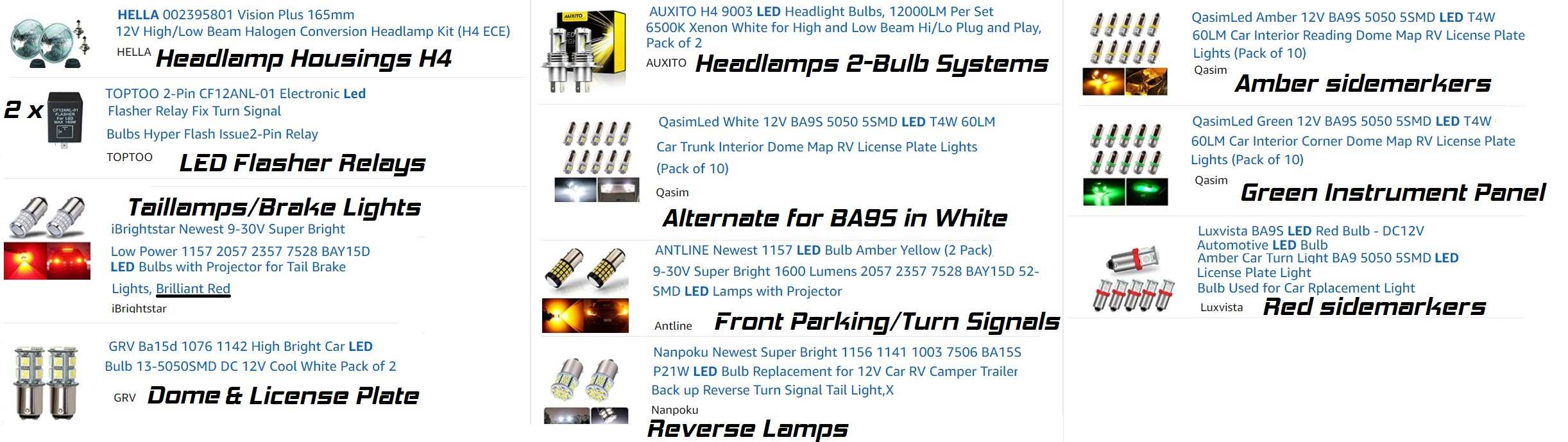

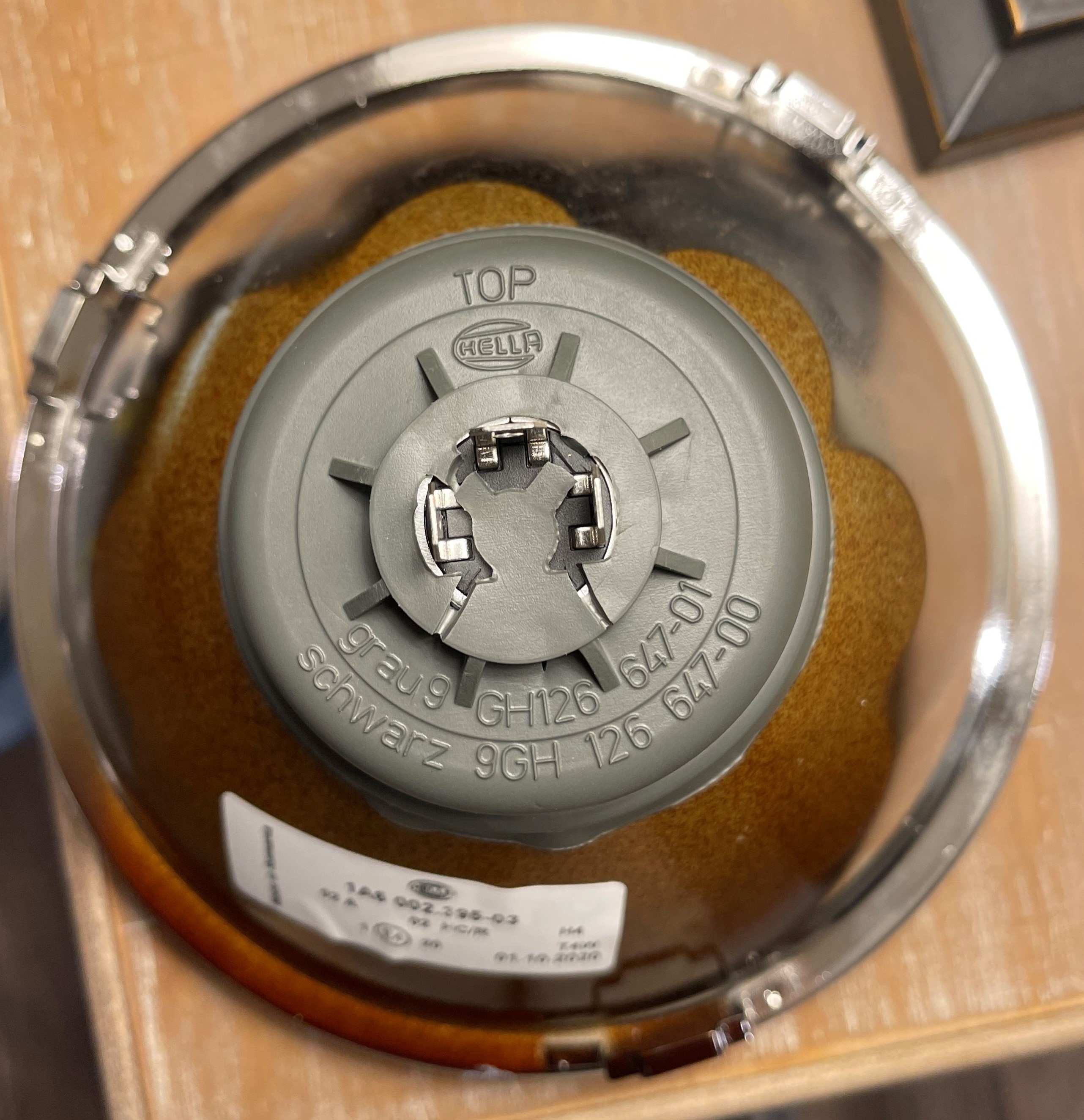

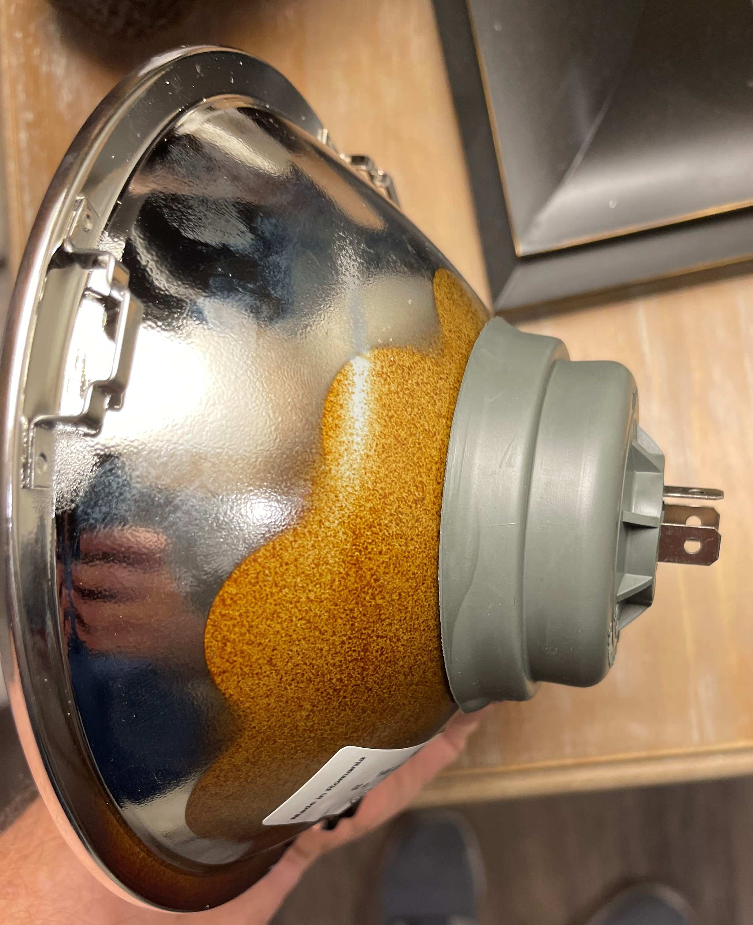

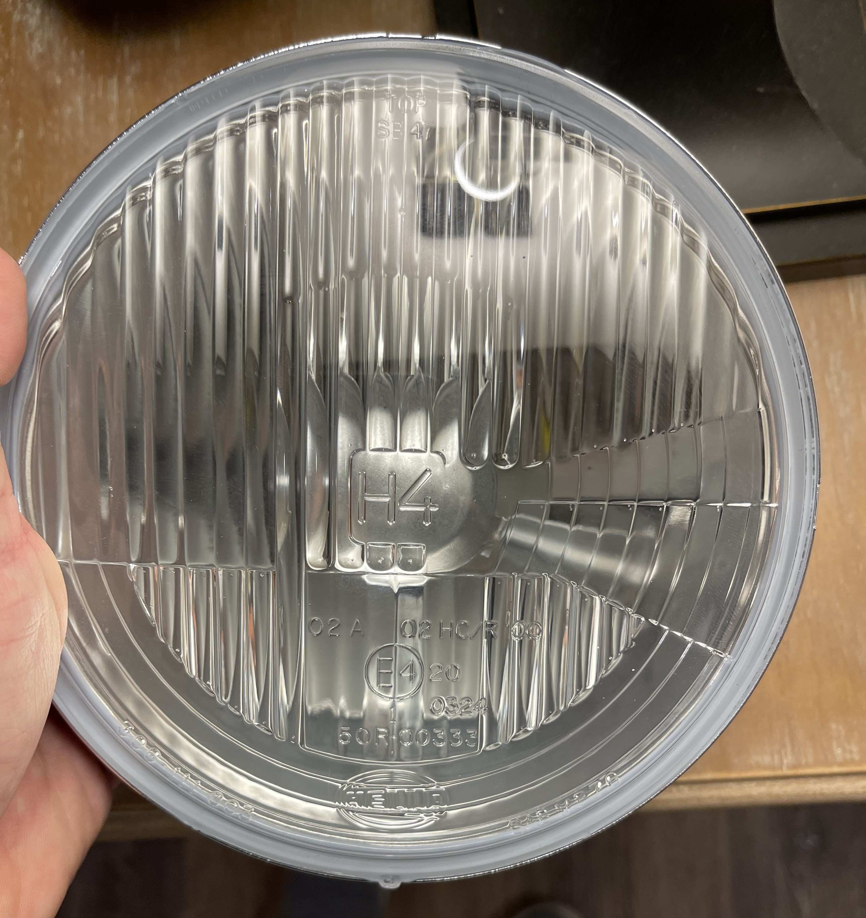

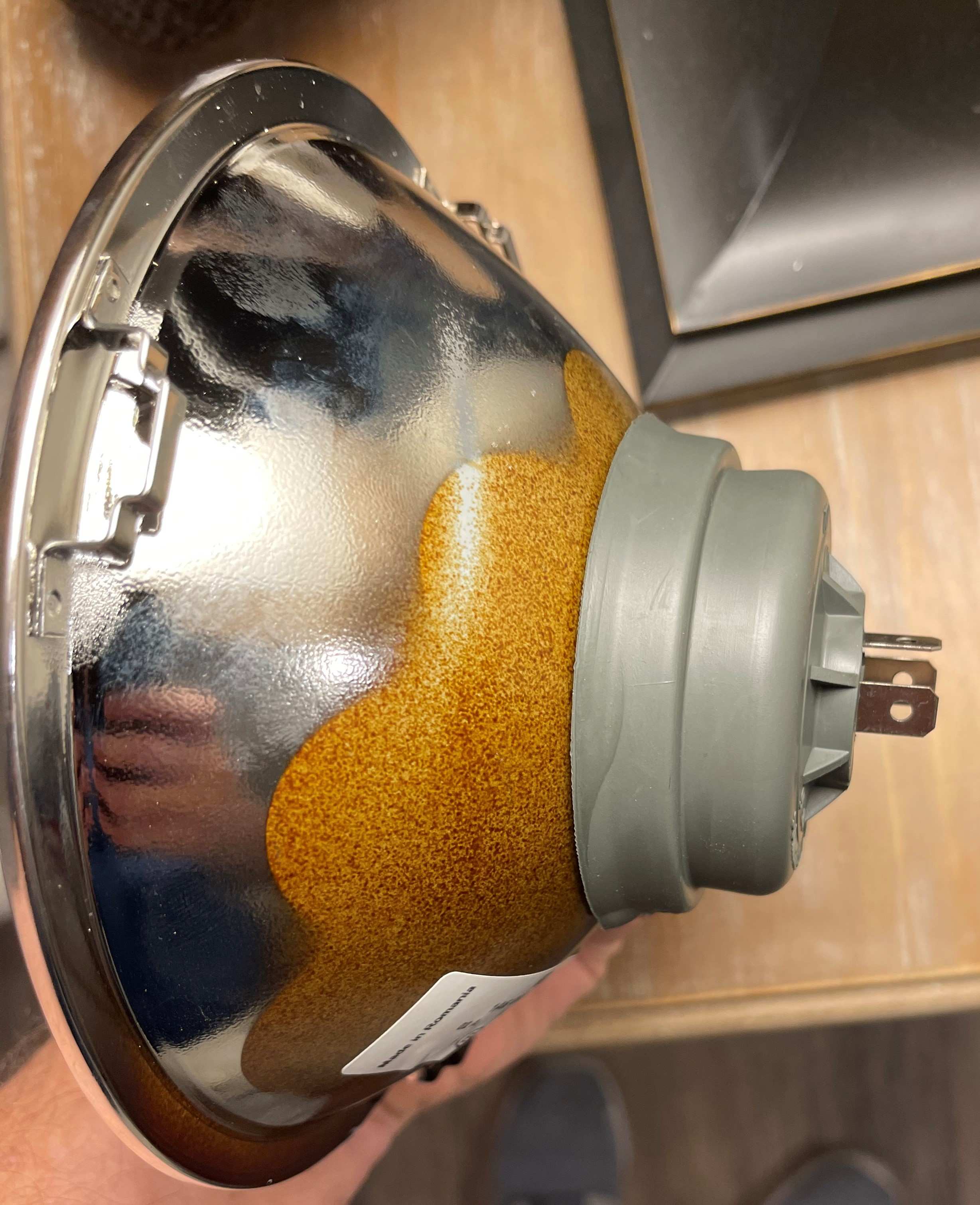

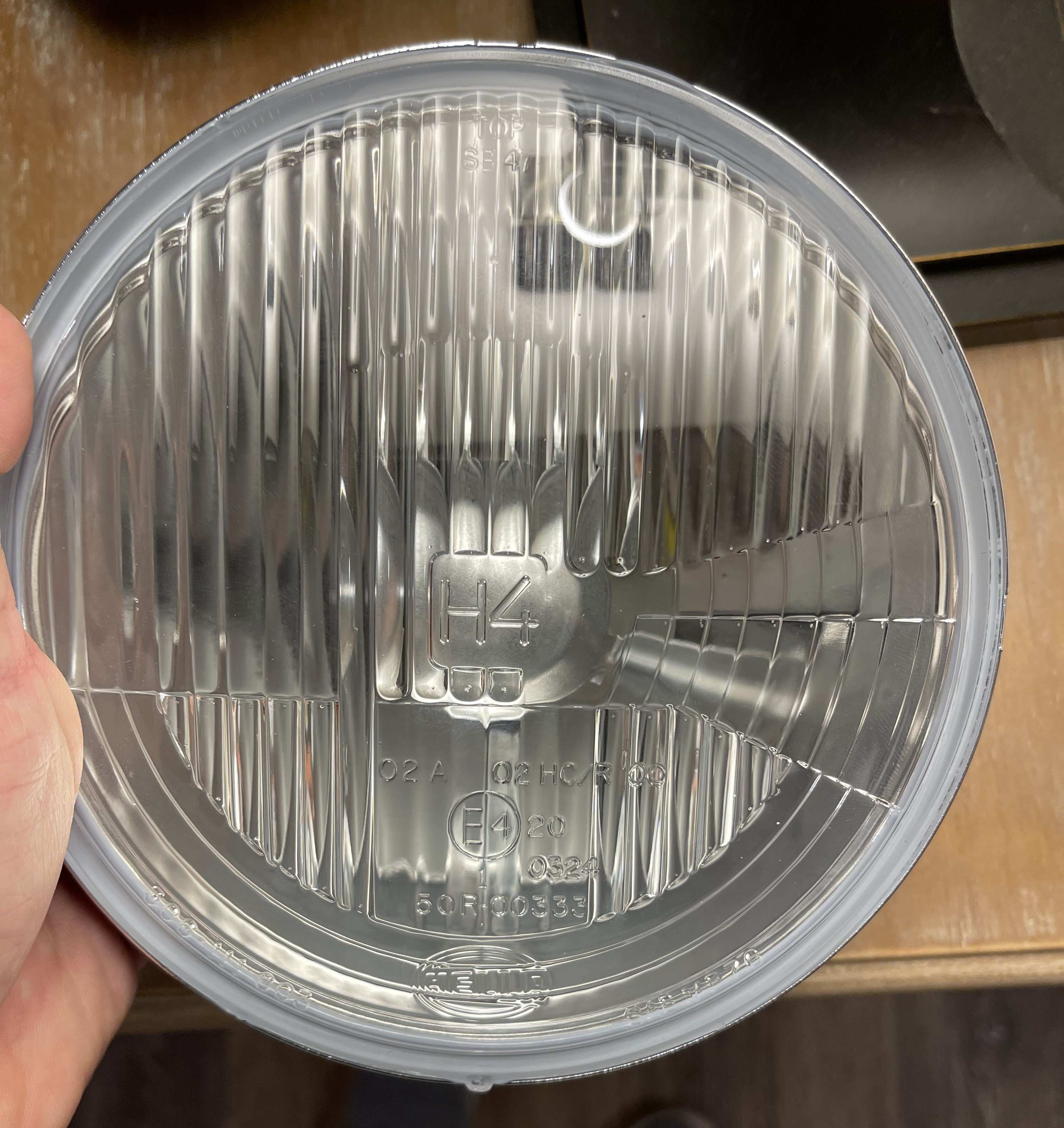

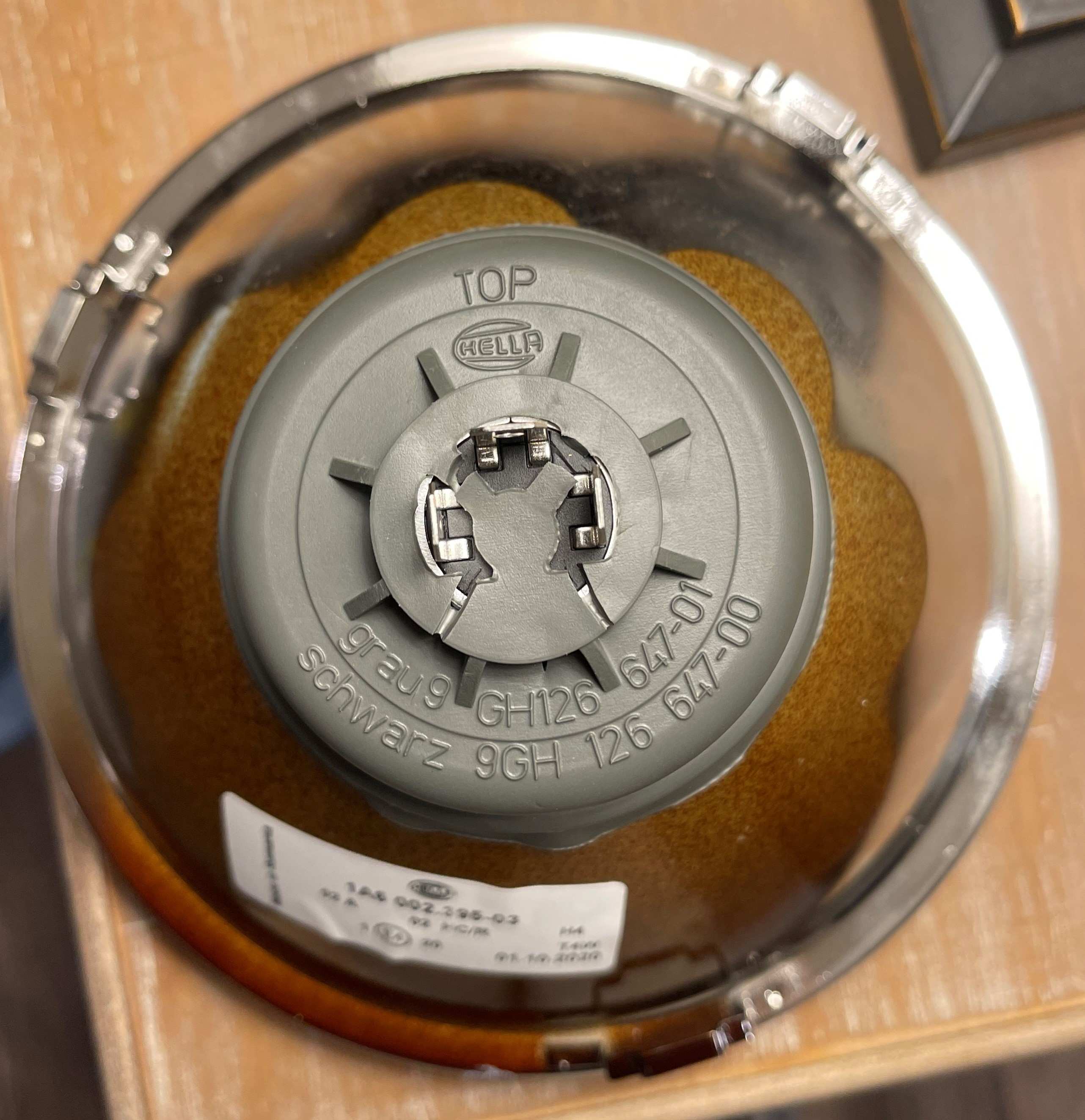

Another option for LED bulbs with H4 housings plus a chart of LED bulbs. The gray rubber boot can be discarded or trimmed.
LED Bulbs: AUXITO H4 9003 HB2 LED Headlight Bulbs 15000lm 6500K Hi-Lo Beam (search Amazon).
H4 Housings: Hella 002395801 Hella Vision Plus Conversion Headlights with H4 Bulbs (swap for LED bulbs).

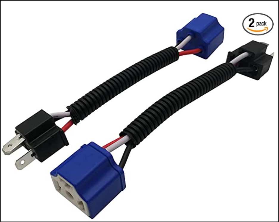

Harness adapters: Ceramic adapters for higher heat (some say not needed but why risk it). Audak 2Pcs H4 9003 HB2 Heavy Duty Ceramic Wiring Harness Sockets Male & Female Connector For Headlights

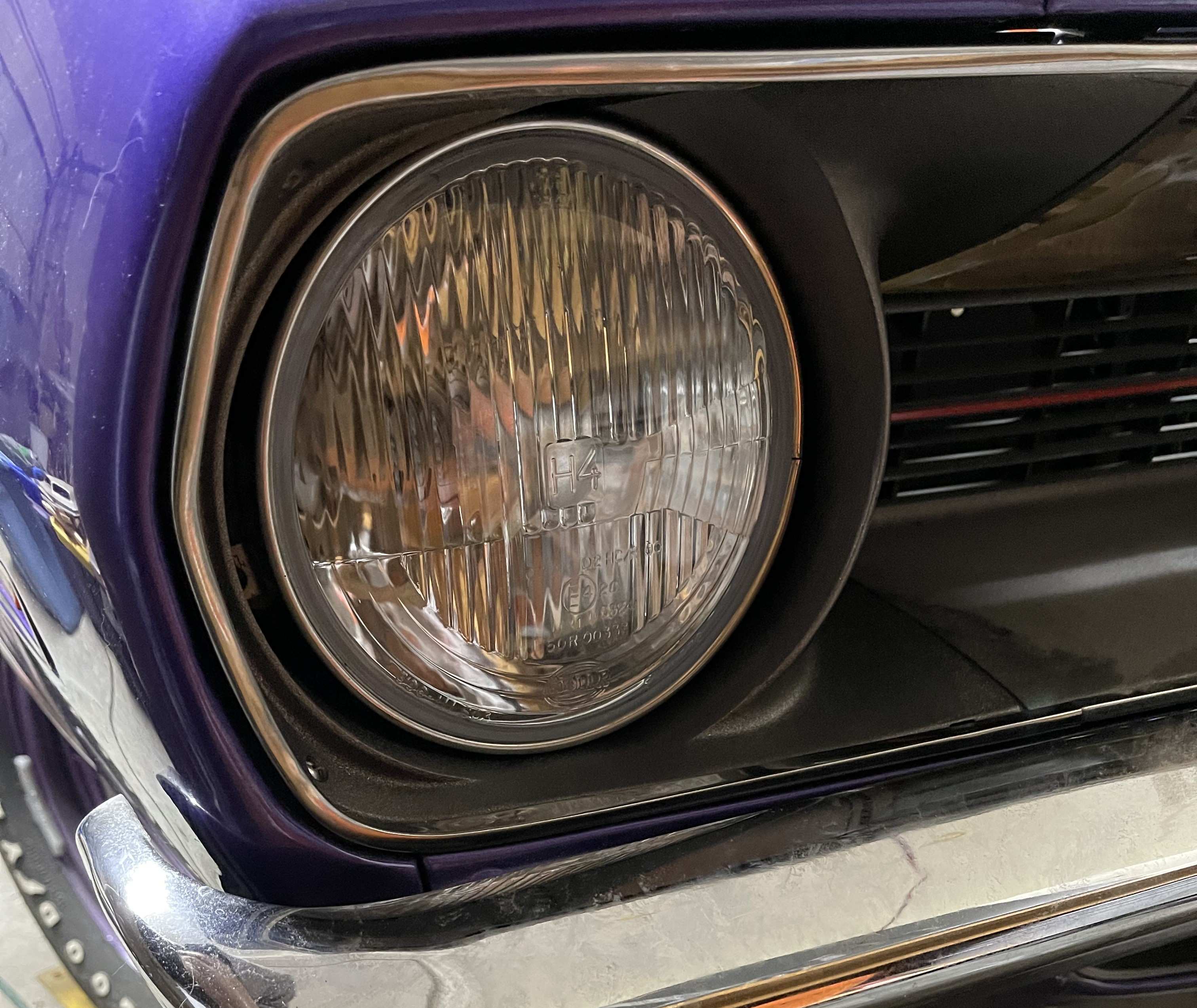

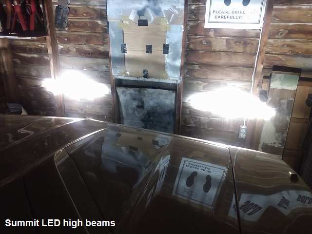

Too late for me to send them back too, bought them on Oct. 25, 2024. If the illumination driving at night is as good as you say I'll be more or less content. Here's the high beam pictures I took this morning.

I did this as well... and I am loving it so far, great light and lower draw on the system. I also replaced ALL other lights in the car with LED (dash, marker, turn signal/brake, reverse). everything is much brighter, especially the dash lights. I can actually see the gauges at night now
