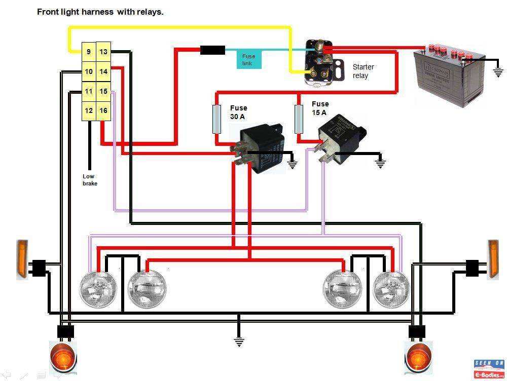

For better lighting the first step is to install a headlight relay circuit. The connections and switches degrade over time and use. Check the foot dimmer sw , headlight plug connections and the bulkhead connectors That is an easy fix and will make a better connection.
The diagram below is an in general diagram. The connections need not be a at the bulkhead connector. The connections can be pick up at one of the headlight plugs. The relays can be mounted by the battery or what works for you.The power should be connected to the load side of the amp gauge or directly to the alternator stud with overload protection. Doing this way is the least invasive way.
There are other things that should check but this is the big one. Everyone wants brighter headlight and they think "I'll just put in a higher wattage bulb". The wiring can not handle it for a long time. I myself have 1 and only 1 100 watt Aircraft landing light on the passenger high beam side. Believe me that's all that is needed. It is on a relay circuit. There is a 300 watt but it will set the road side on fire.

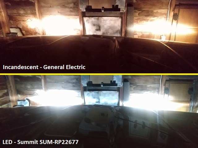

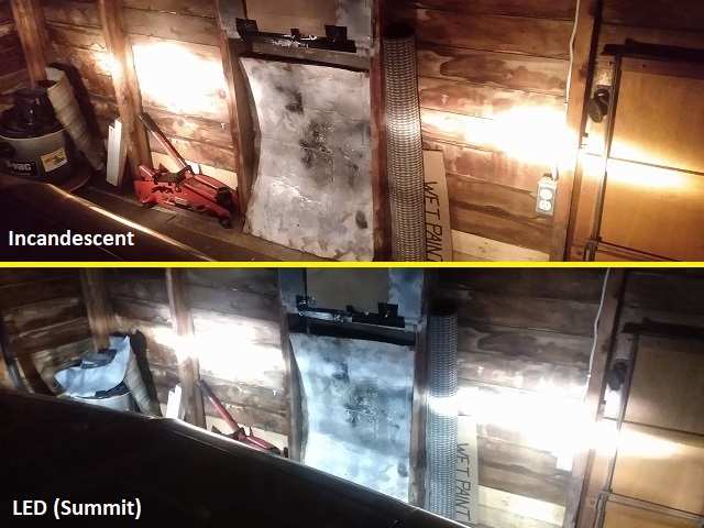

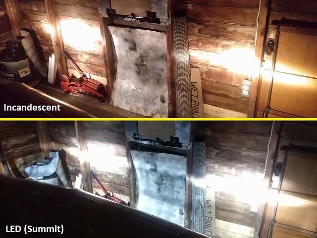

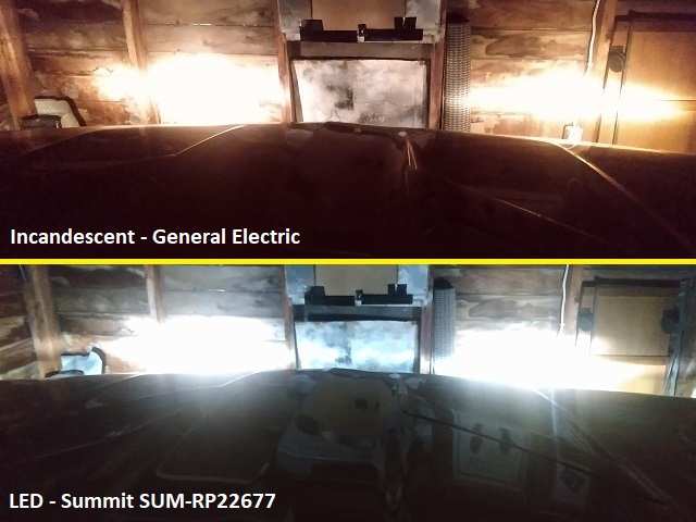

My new Summit SUM-RP22677 LED headlights are in. Fit perfectly, just like my old GE's. I haven't driven the car yet let alone at night but took some pictures while it's in the garage. These are just some, the wall is 44 inches from the headlights. I imagine on the road the difference will be phenomenal. So far, I'm very impressed and I don't think the pictures do them justice.
I bought the Summit LED lights and LOVE them, forgive the pun but Night and Day difference
I know, remember I asked you about fit.

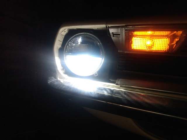

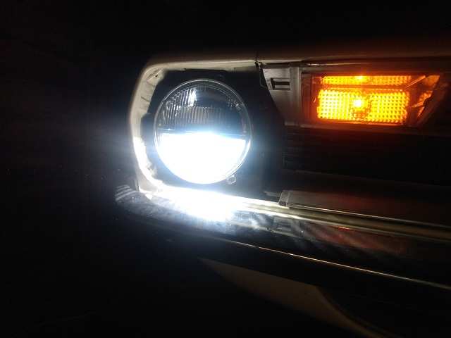

I wonder what oncoming traffic will see, wasn't expecting them to be 1/2 lit. I haven't tried the high beams but I'm guessing they'll be full lit for those.

Half-lit and no replaceable LED bulb for the Summit RP22677' at $99 each?
Hard pass on those.

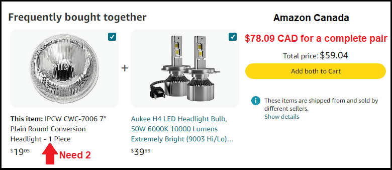

I "might" have passed too had I known. FYI, mine where on sale for $89 and the Canadian dollar was stronger w/free shipping to Georgia. The other option I was contemplating was the set-up in the picture.

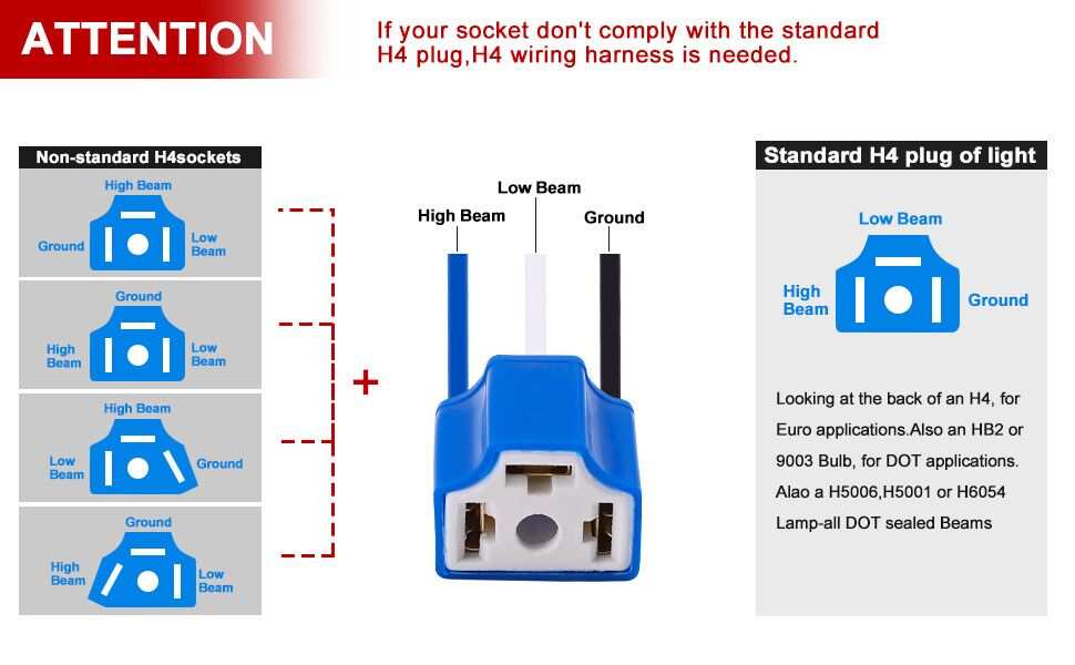

I'm thinking there are two filaments. One for low and one for hi. The 9004 and the 9007 the grounds are on a different pin. Not sure about the ground on a 9003 have to look. Check you wiring? There are headlight that have a shutter in them for hi and low. Do they have a shutter.
