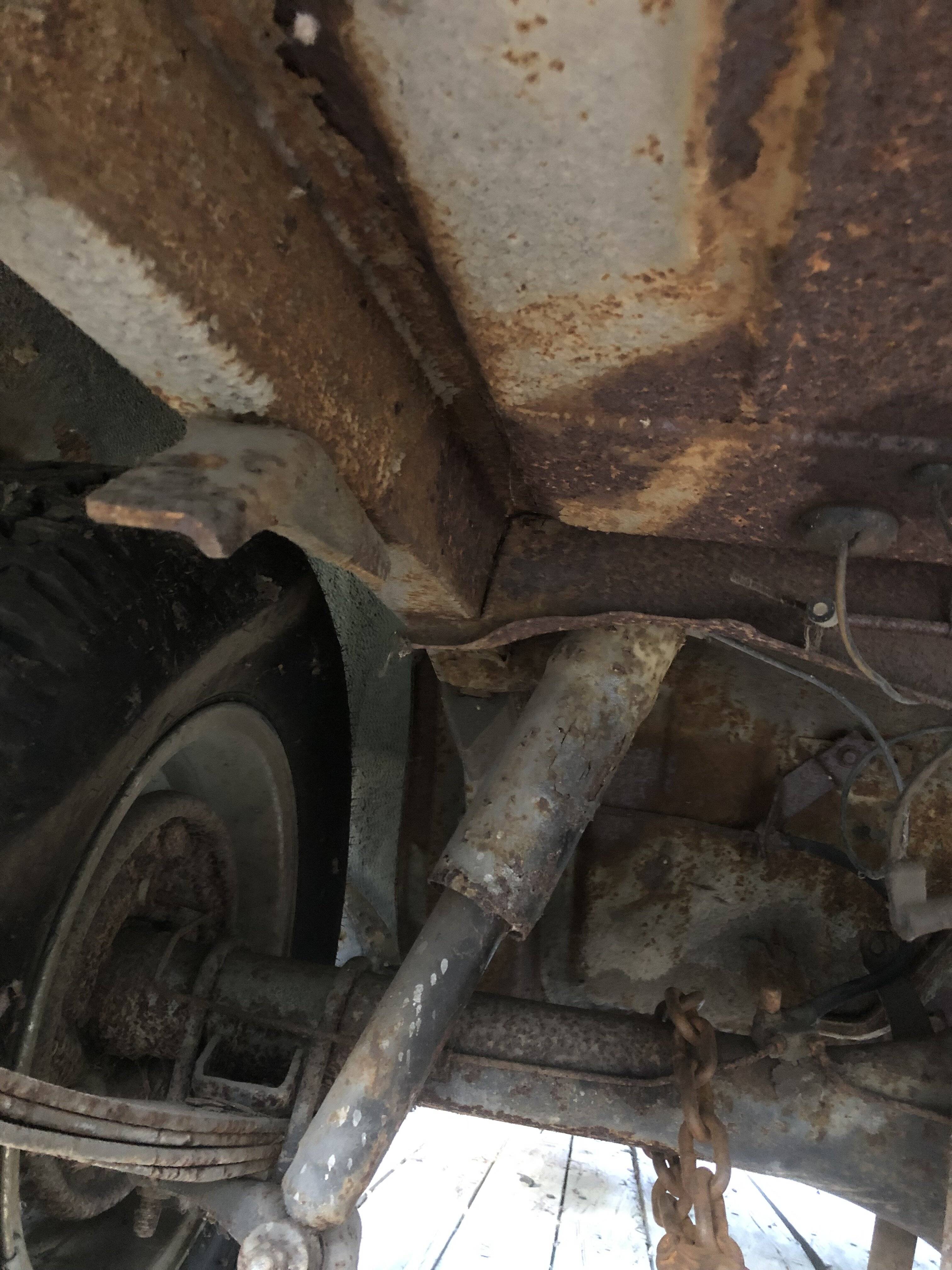

Is this the bracket that the exhaust mount bolts to? This is on the passenger side of the car at the back of the trunk pan and this is the only one. The driver's side doesn't have the two holes drilled in it where this bracket would be

Often the drivers bracket is different but there would be 2 hangars near the fuel tank / rear valence also.
If there is nothing on the drivers side probably a 318 car

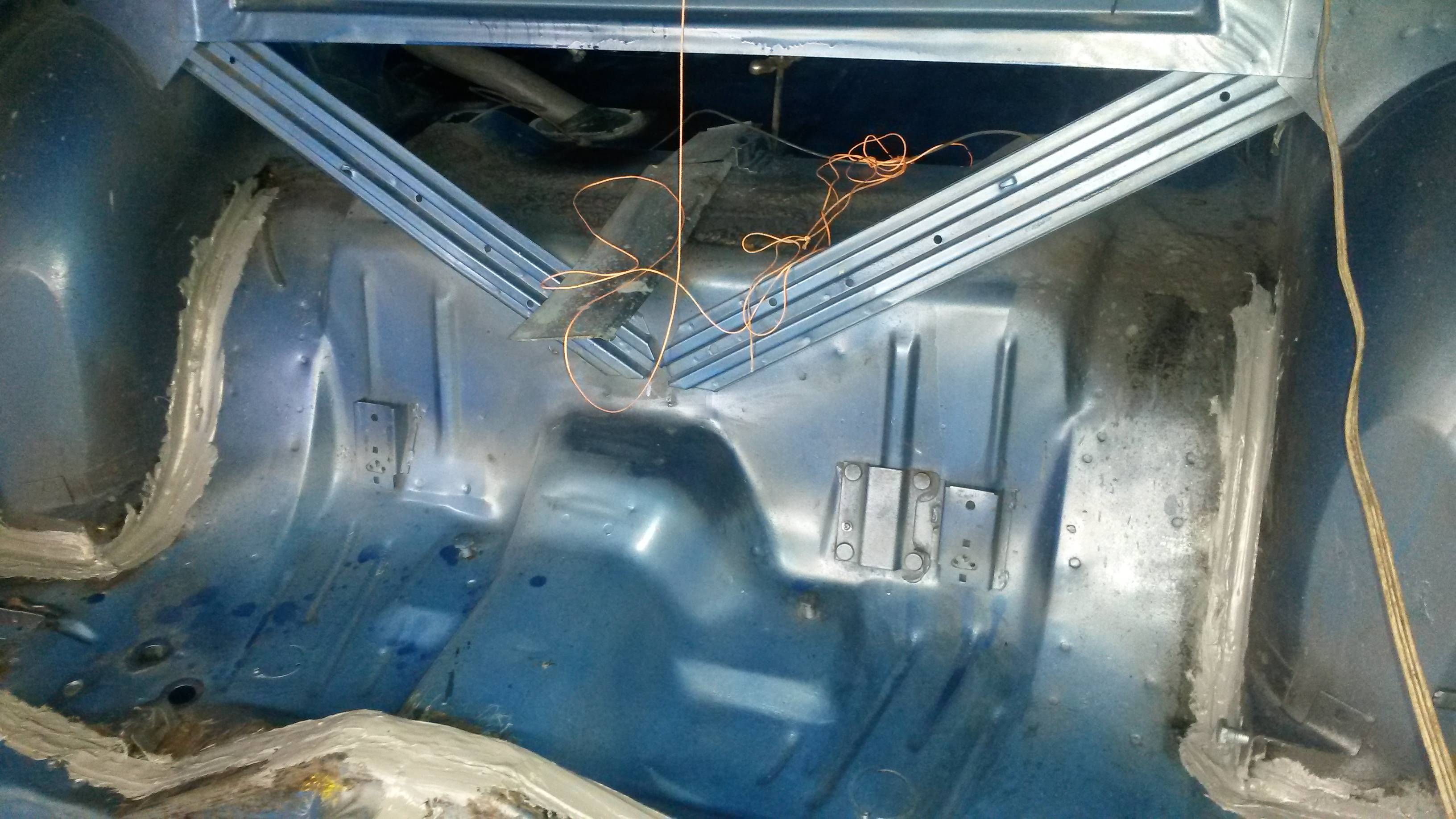

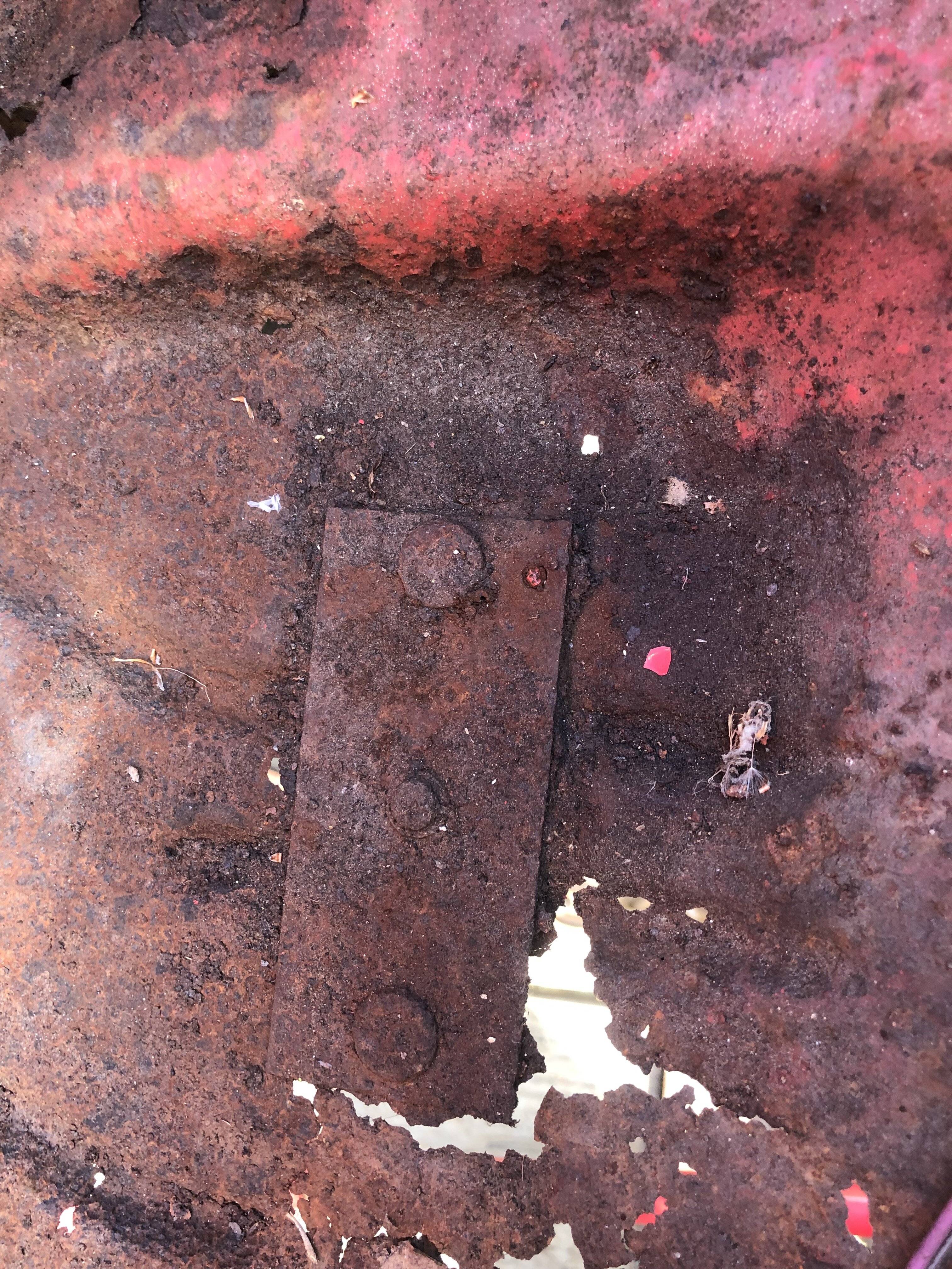

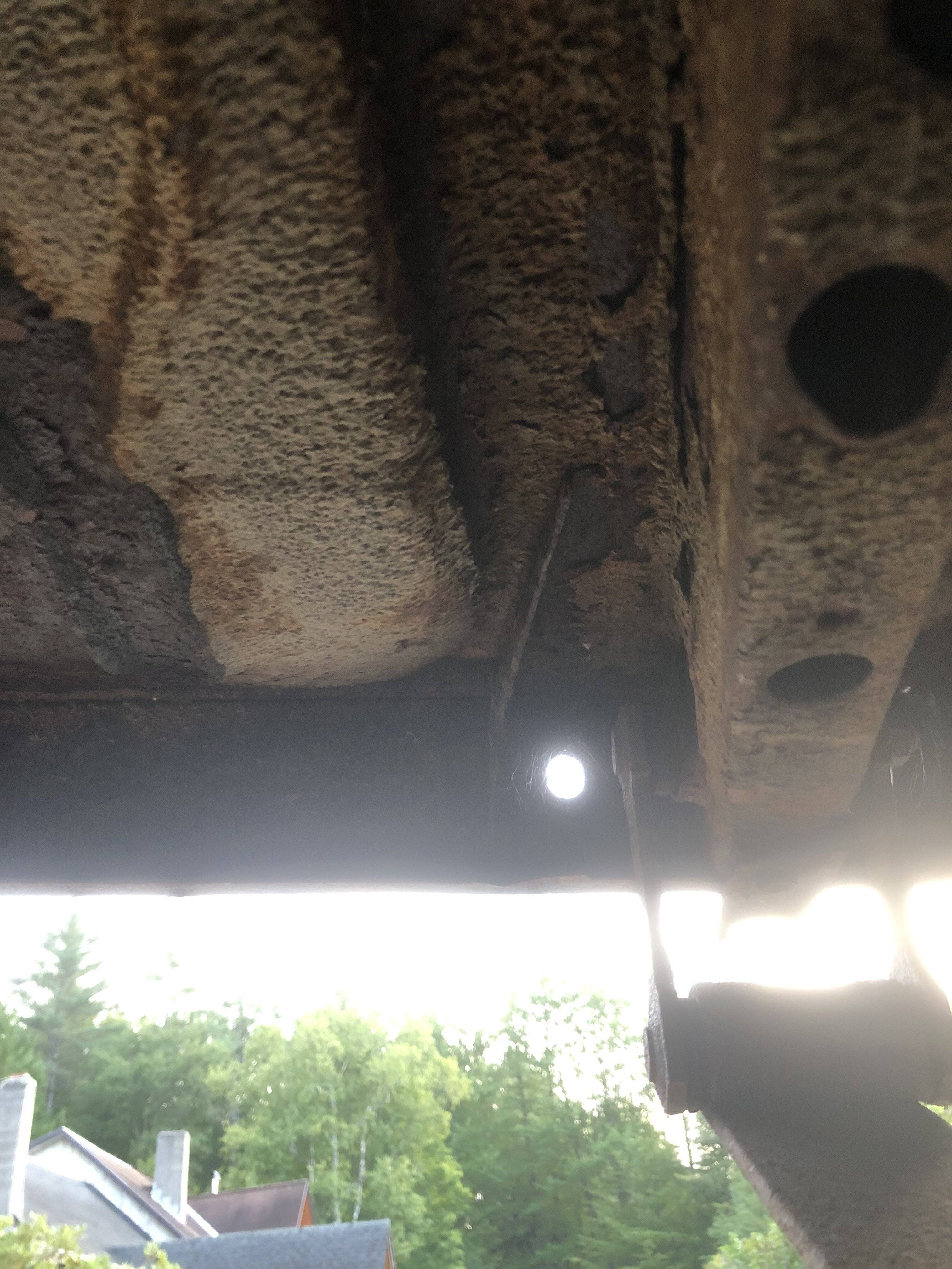

The rear valance and the fuel tank have been removed out of the car before I bought it, and the only brackets that I can see are the tie-down brackets on the frame rails and the one I mentioned before in the trunk floor. The second picture is the trunk floor on the inside of the frame rail on the driver's side where it meets up with the rear cross rail.

Somewhat hard to tell but I don't see a bracket on the floor pan on the drivers side .
