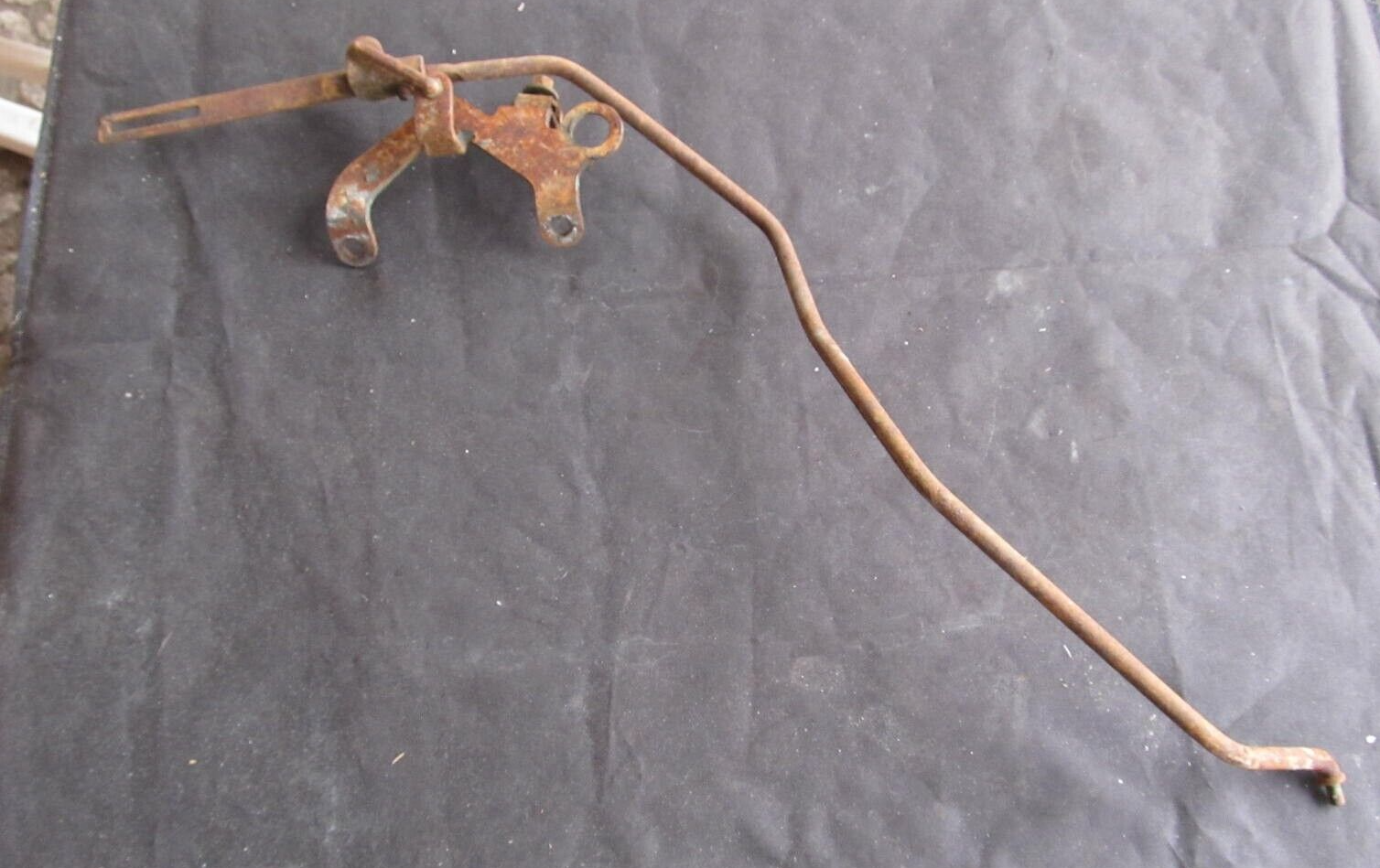

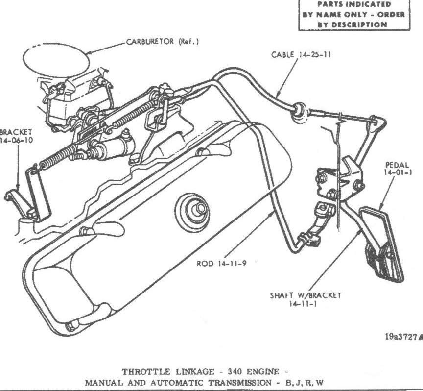

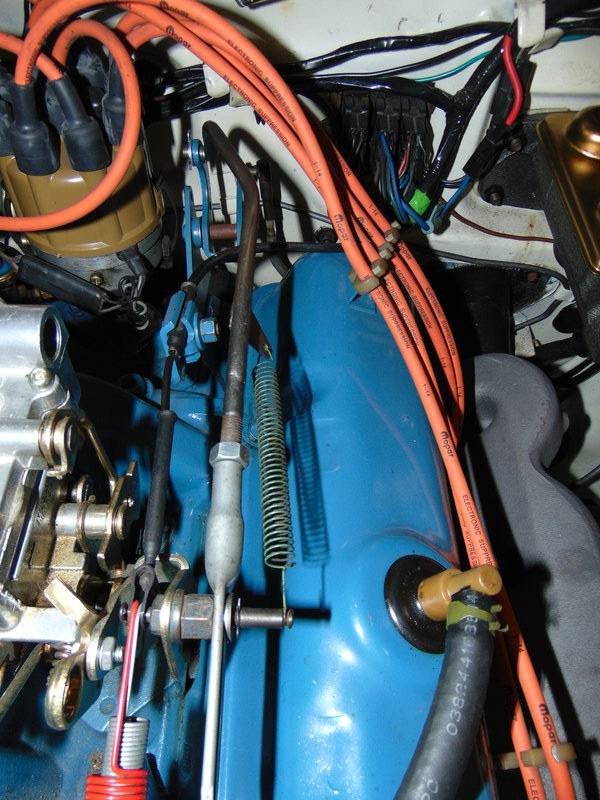

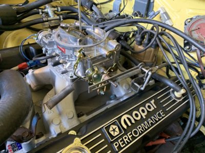

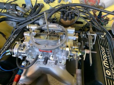

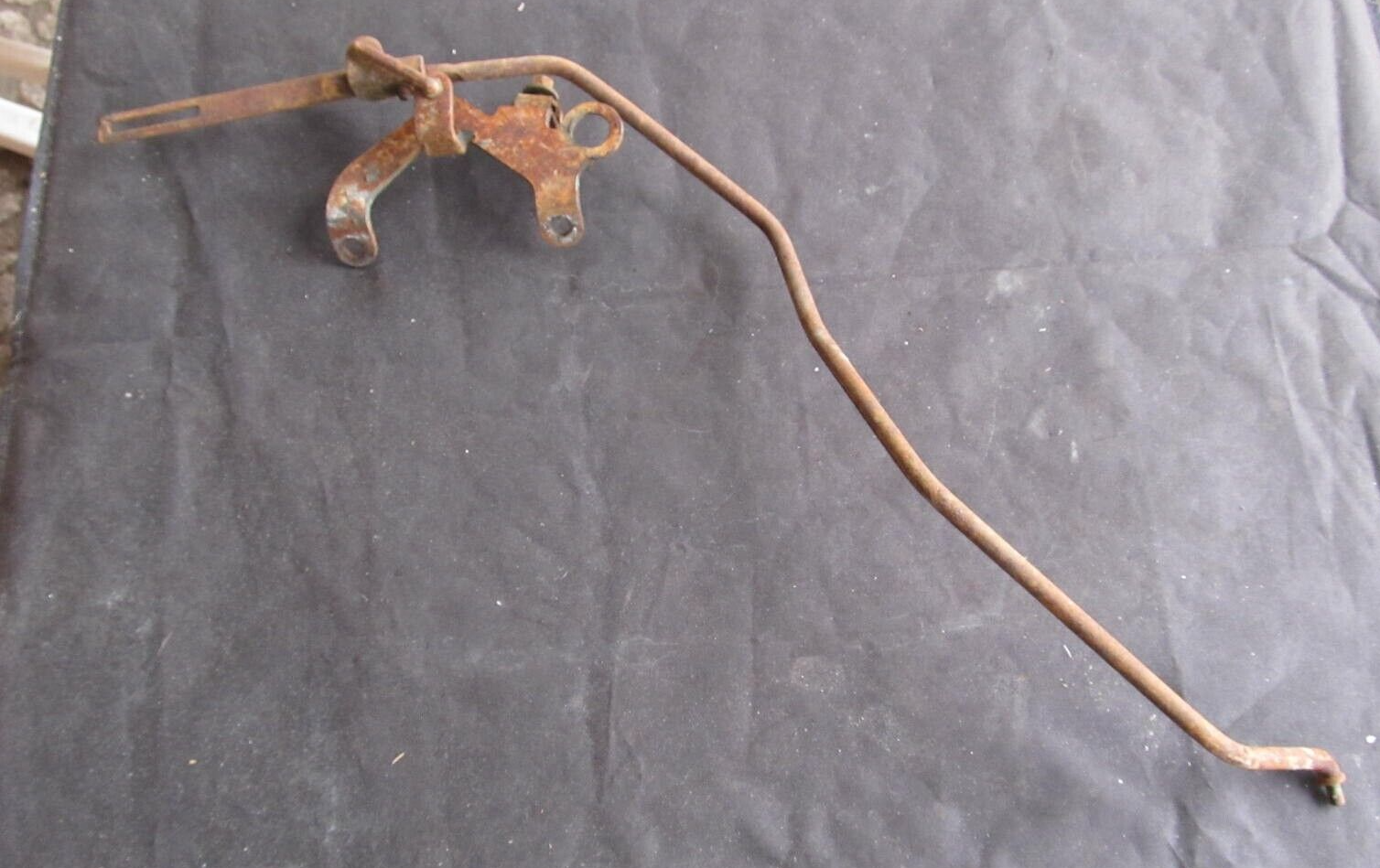

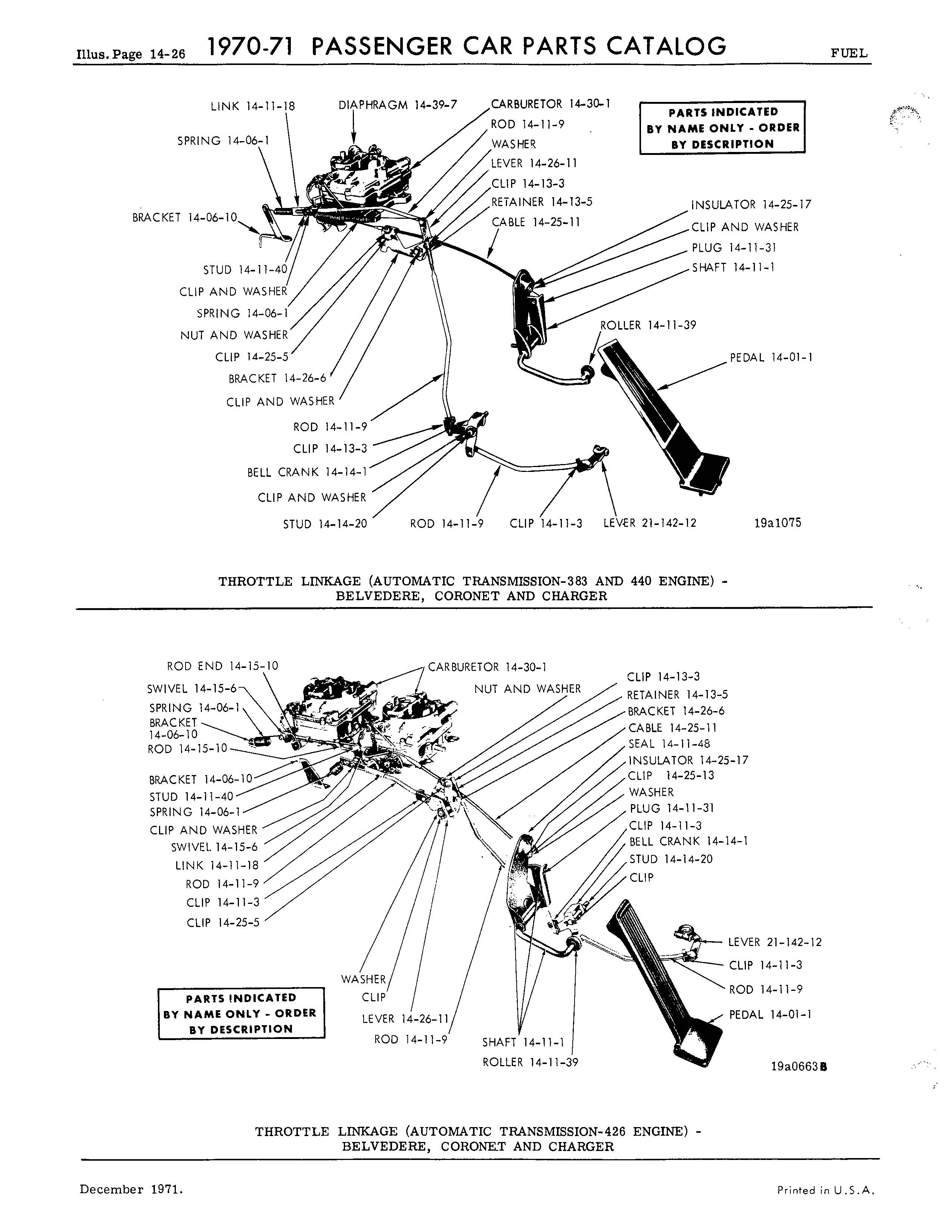

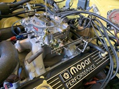

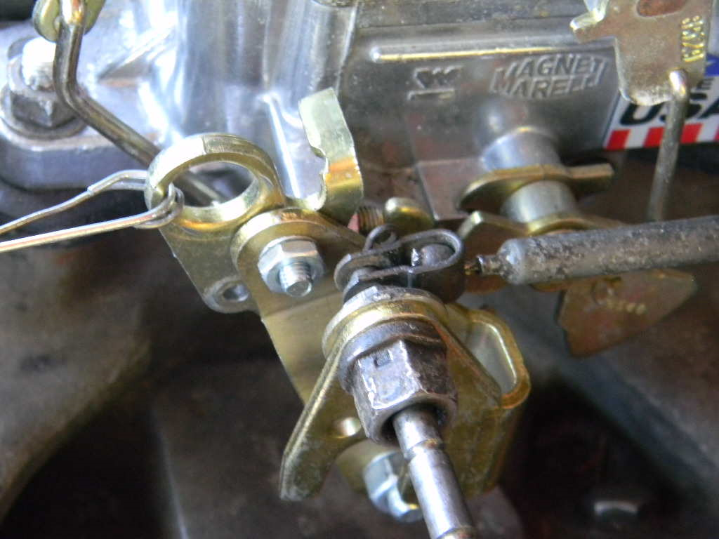

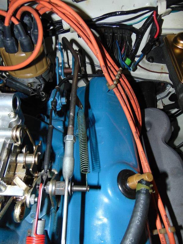

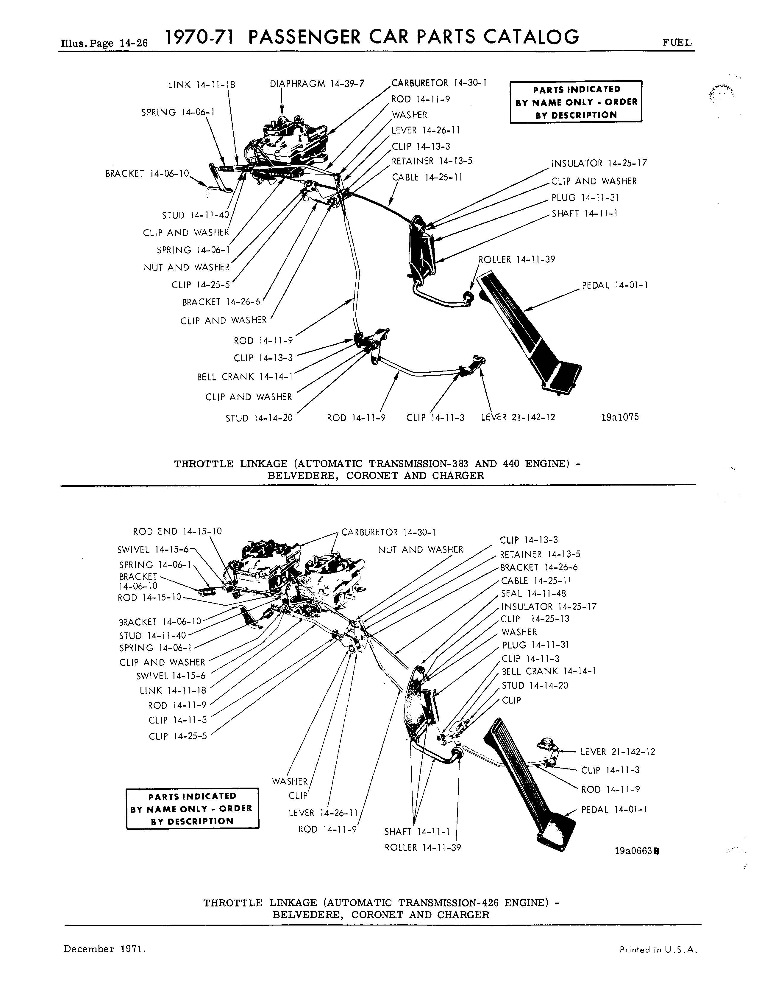

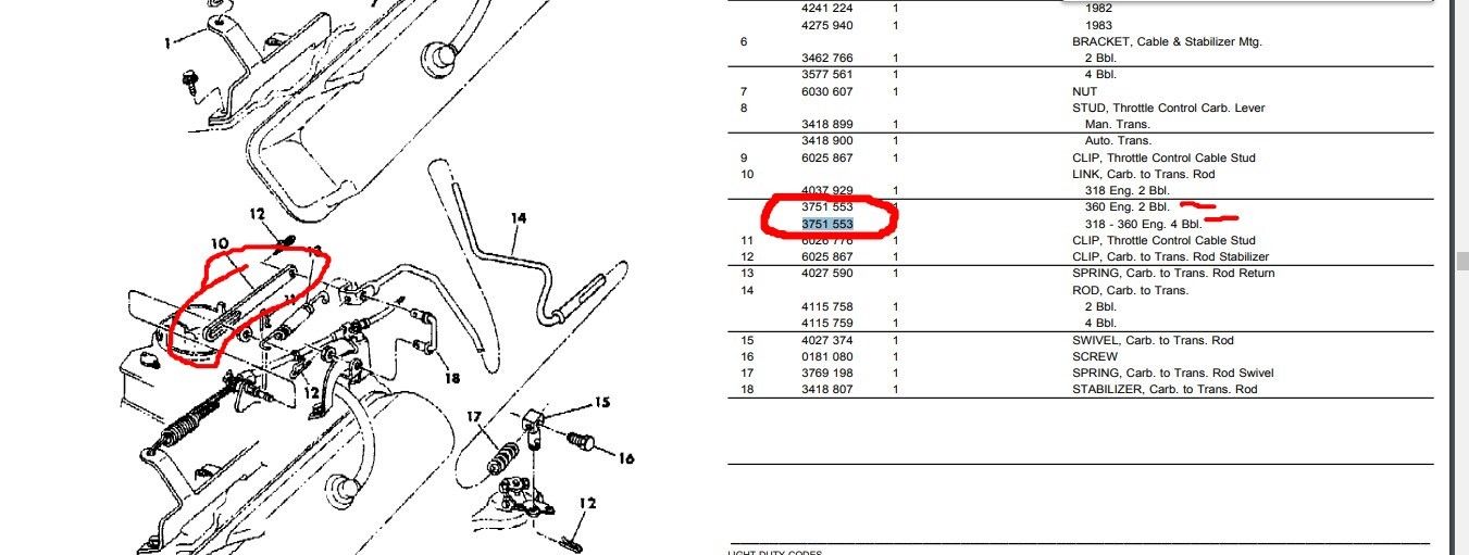

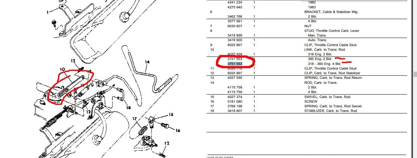

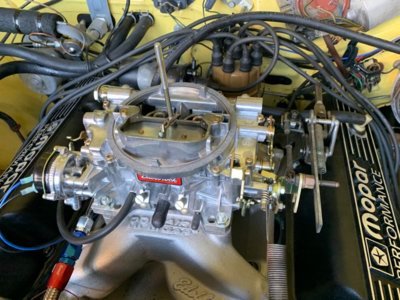

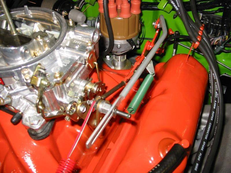

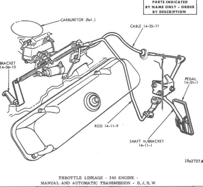

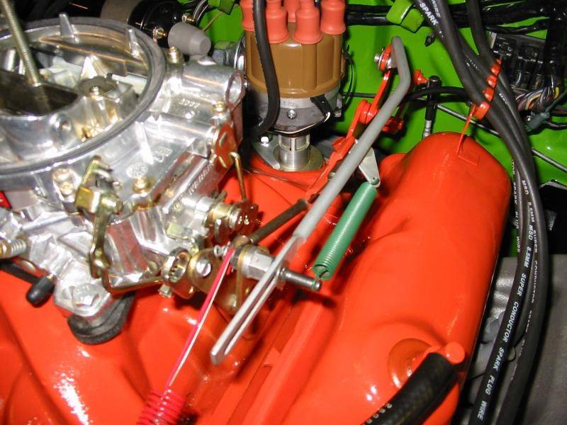

Sent many pictures of how guys have done this at home. A few were done properly but not all.
The most important hing to remember is that linkage alignment is based on proper angles.
Everything should align in a straight line. in both planes.
Pictures six with the blue valve covers and the last picture, show that everything is parallel to each other and also level.
The most important thing to remember is that linkage alignment is based on proper angles.
Picrues six with the blue valve covers and the last picture, show that everything is parallel to each other and also level.
