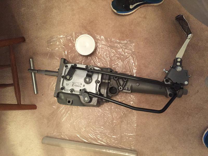

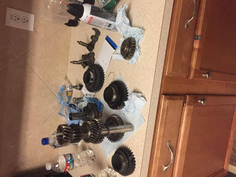

4 Speed Guru Help needed
I have rebuilt the 4 speed transmission, but I have encountered an issue while checking shift function. I'll get right to it... when the side cover is torqued down shifting into or out of reverse is impossible. if the side cover is loosened slightly, it will shift very well into all gears. This is while it's on the bench. I think the reverse lever is interfering with the 1st - 2nd lever or vice versa... Please help so that I can check this item off the list.

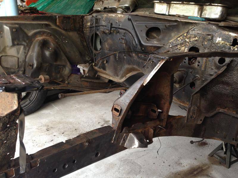

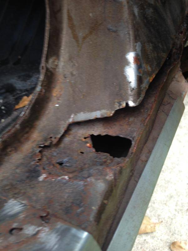

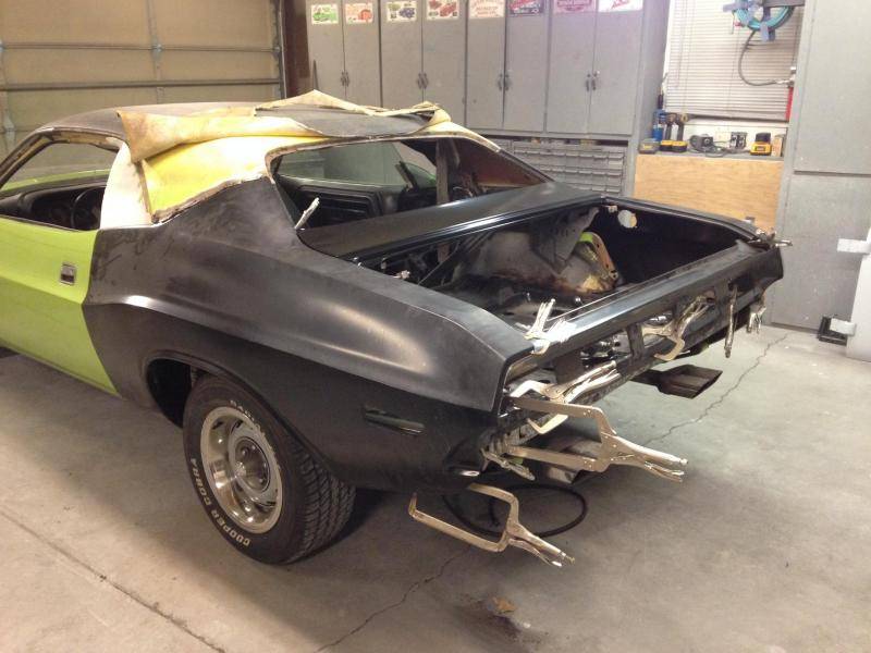

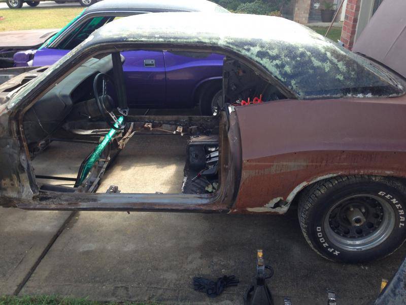

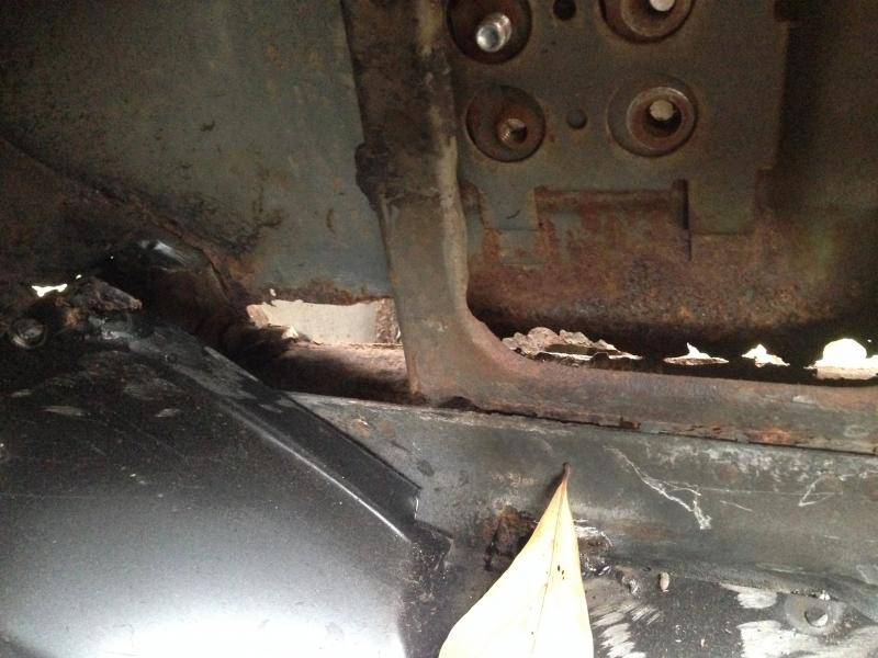

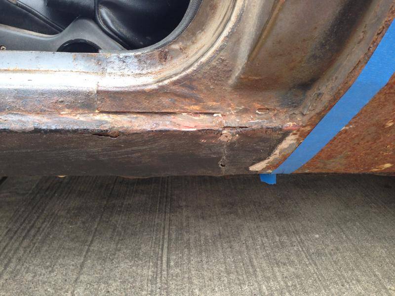

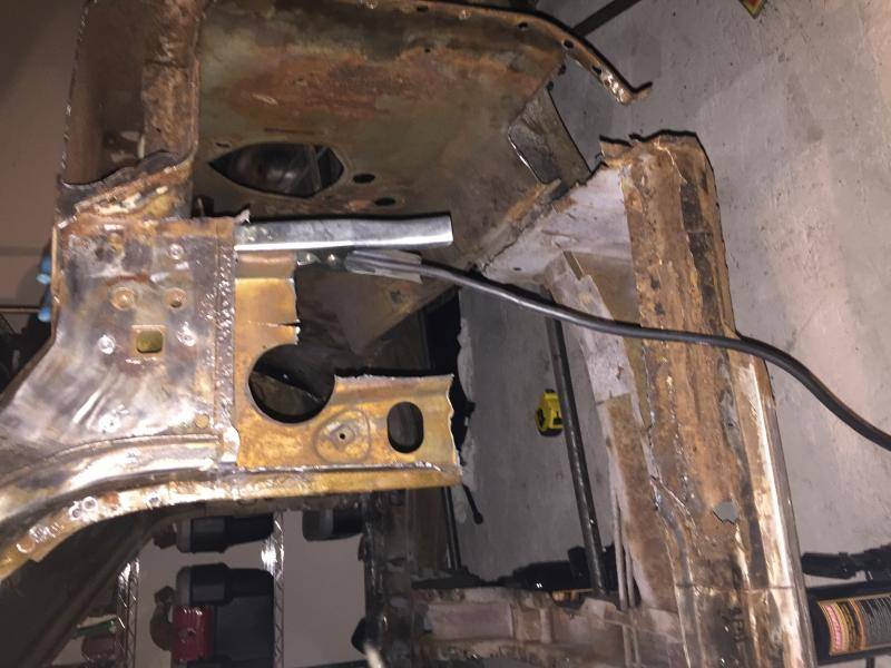

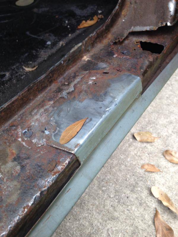

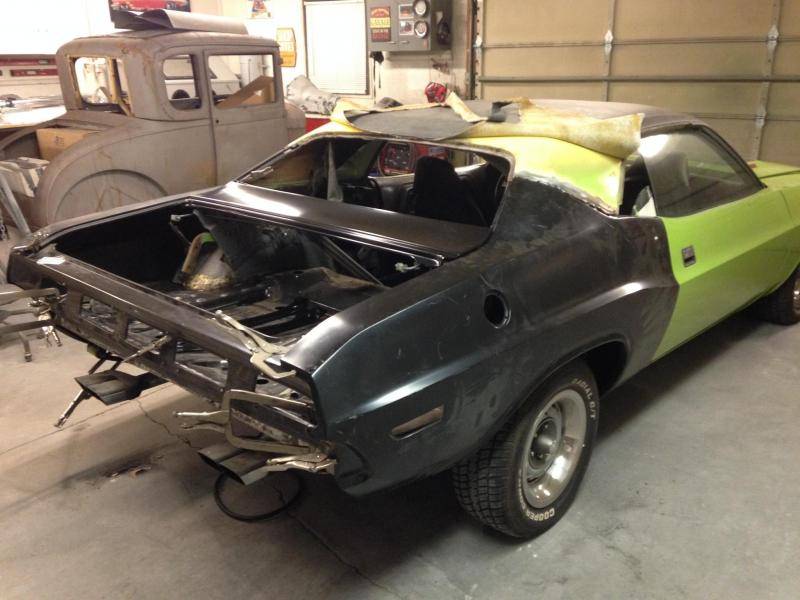

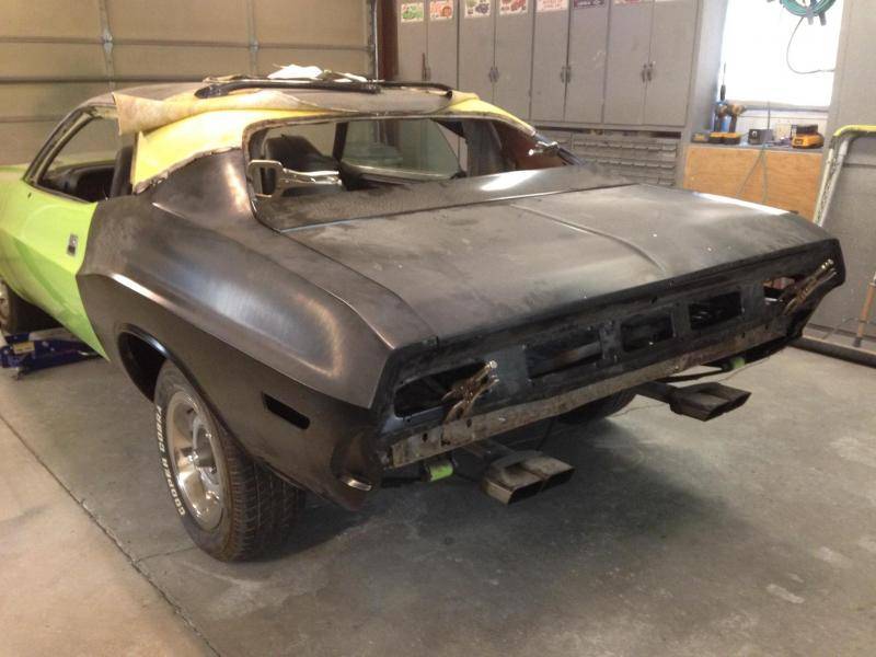

The four speed which is a 2.47 close ratio thanks to parts from Passon Performance. Started tearing into the metal work and hoping to get the inner rocker, outer rocker, lower cowl, and door hinge panels in on the passenger side tomorrow.
saderbaseball1145
Feb 24, 2014
97
22

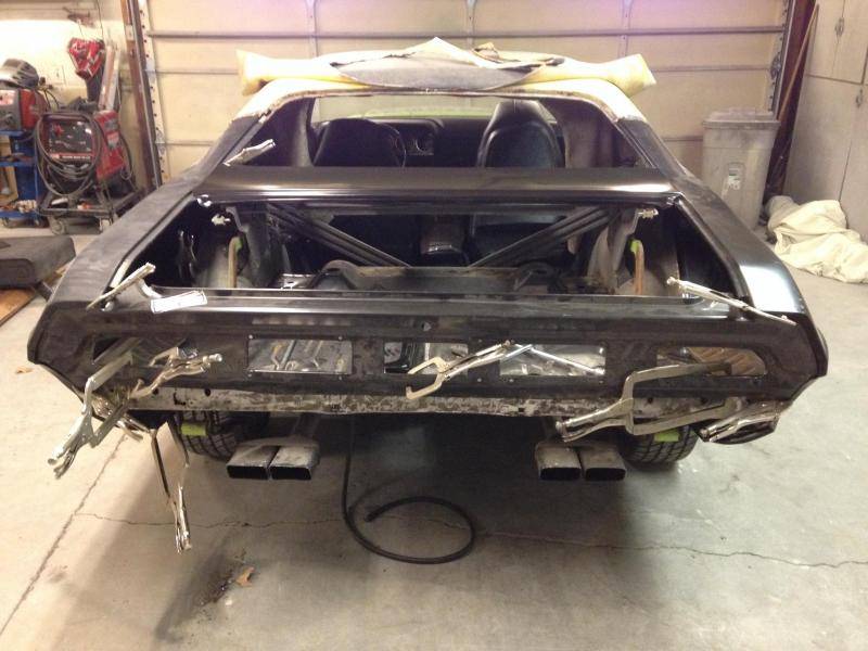

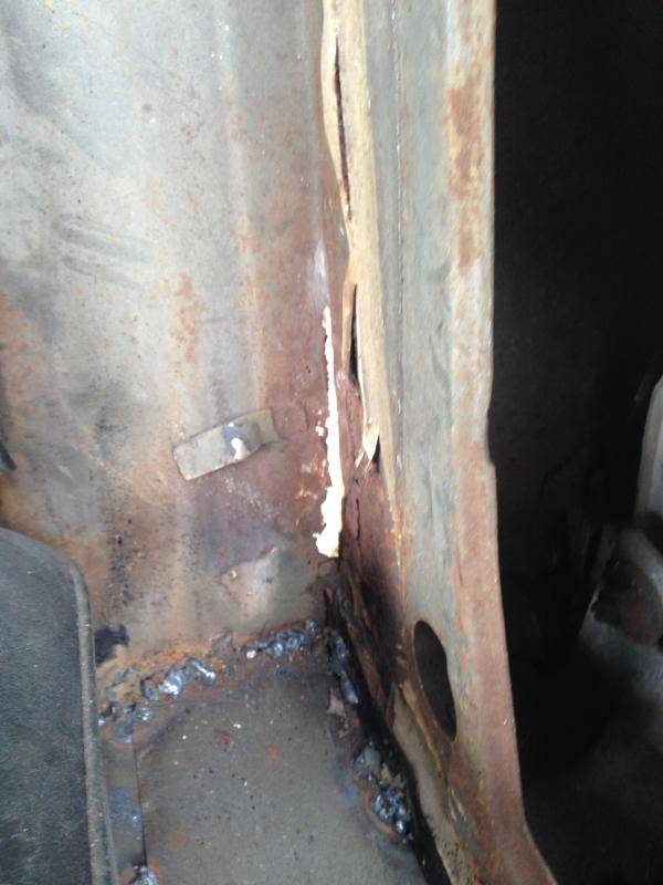

Got one side done now working on he fitment of the second side. Hopefully will get the other rocker done and also the cross member.

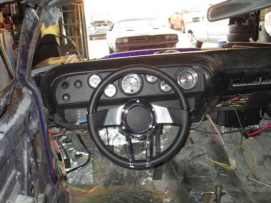

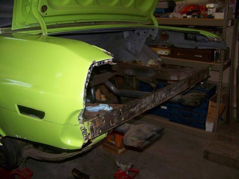

Mines finally coming together also. Slow but sure, already forgetting where things go. Take God for the shop manual and pictures!IMG_1578.jpgIMG_5309.jpgIMG_5605.jpgIMG_5606.jpgIMG_9871.jpg

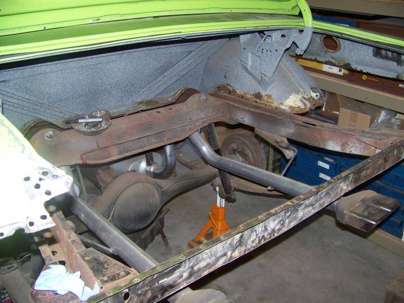

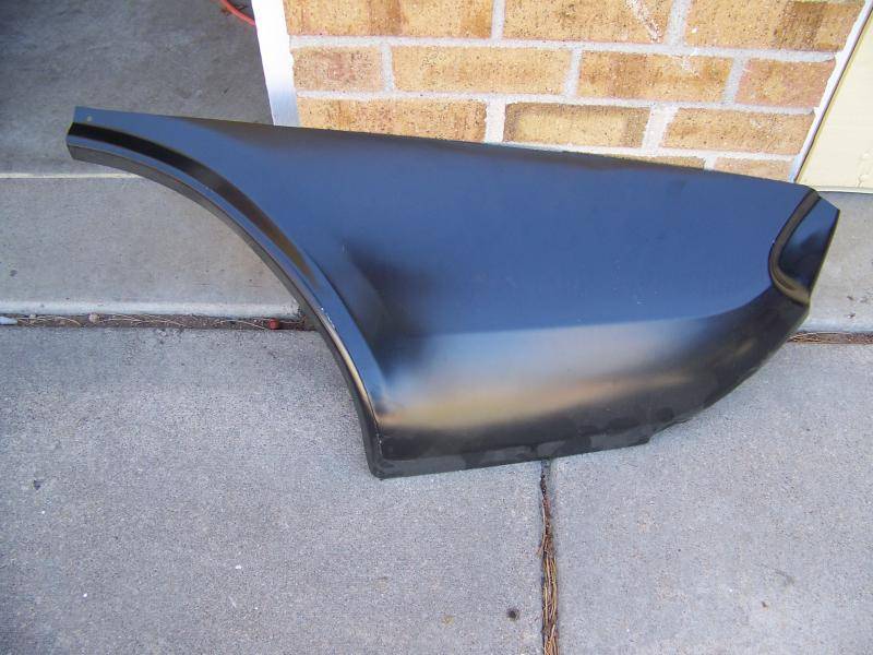

Oh remember I said I had that skin and lower quarters. Lookee here Still available.100_2647.jpg100_2648.jpg

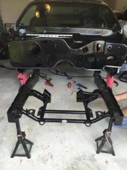

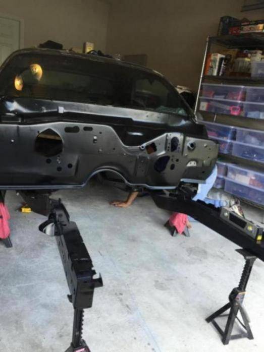

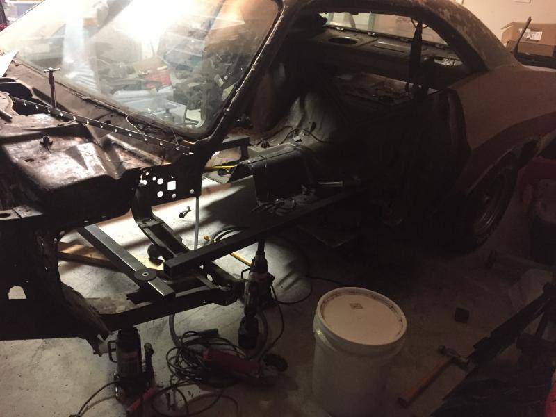

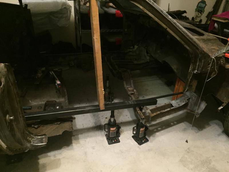

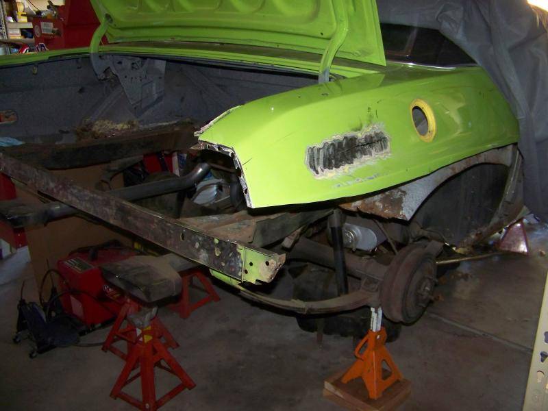

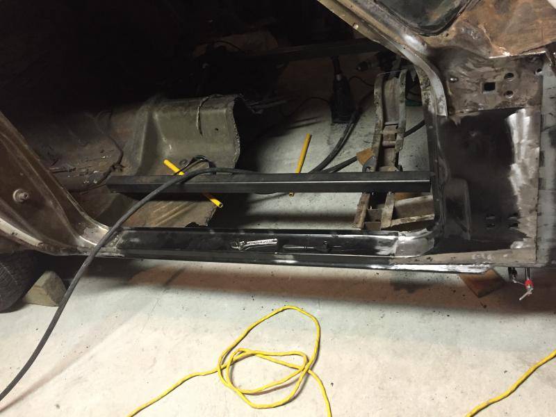

Got the crossmember in took some measuring but got it back. Now time to work on the upper and lower firewall.
saderbaseball1145
Feb 24, 2014
97
22

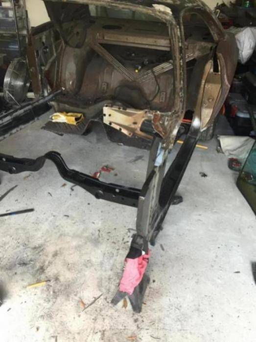

Getting the firewall back in today then hopefully getting the frame rails in tomorrow.

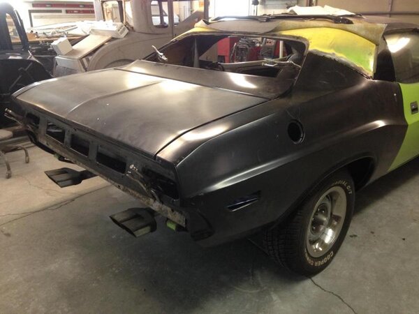

Very nice progress and looks really good. How is the new sheet metal fitting together for you?
saderbaseball1145
Feb 24, 2014
97
22
It takes a some massaging and trimming but nothing major. After we get the metal to fit together it's great. We are using my dads 70 challenger as a guide to double check the measurements.
