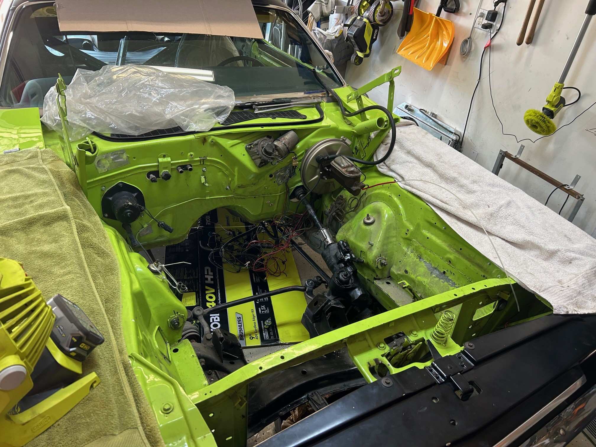

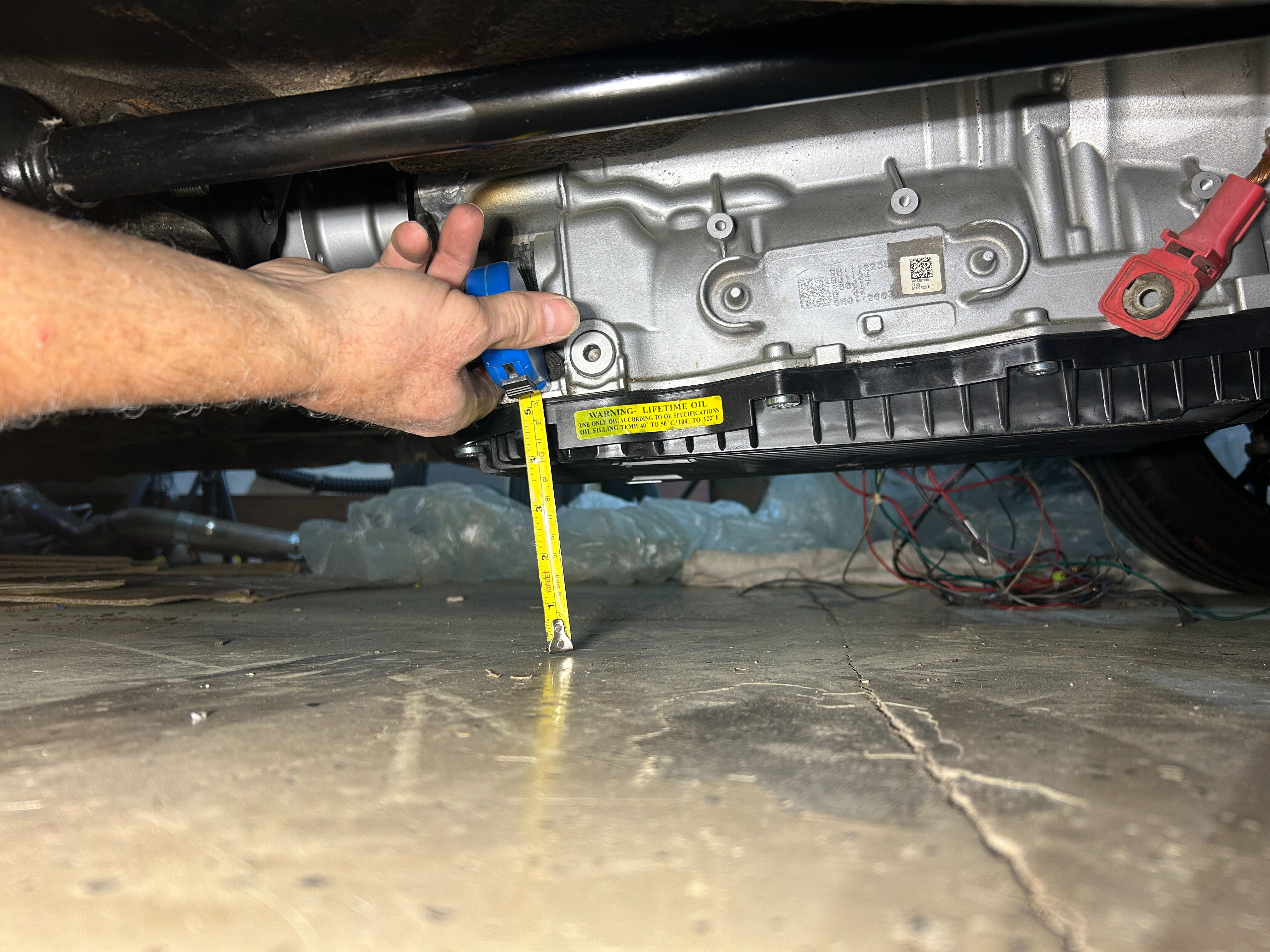

Good Morning all. I started a new forum post as I haven't seen some of the issues I'm encountering posted so I figured I'd share my experiences with you so you can hopefully learn without having to do this the hard way.
First off, there are a lot of different combinations out there, so here is the combination I'm using.
2006 5.7L Hemi. stock
2013 8HP70 transmission. stock
Holley Blackheart Engine mounts BHS566
Holley Blackheart transmission mount BHS567
Holley Transmission mount 71223029HKR
Holley cast iron manifolds BHS582

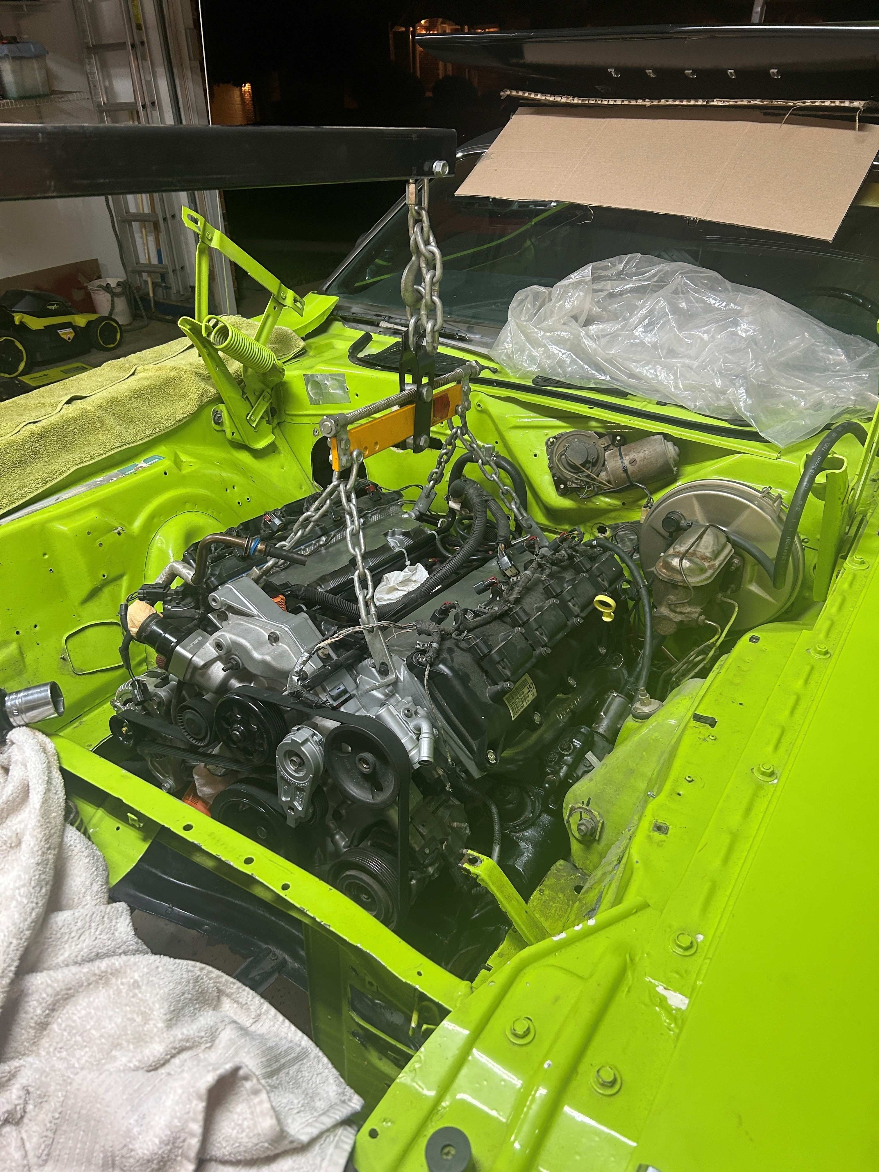

I chose this combination since it was supposed to minimize the need to modify the transmission tunnel.

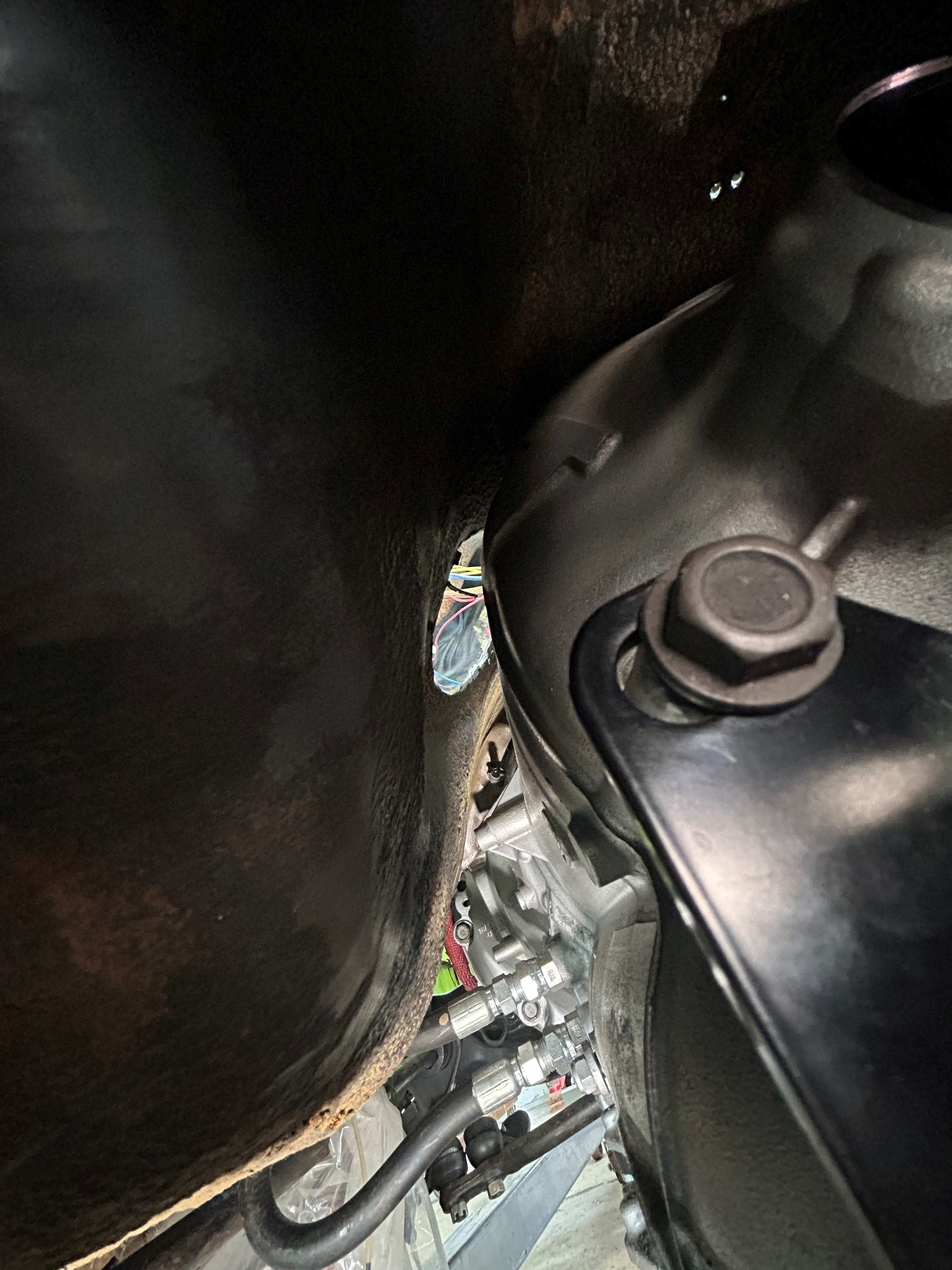

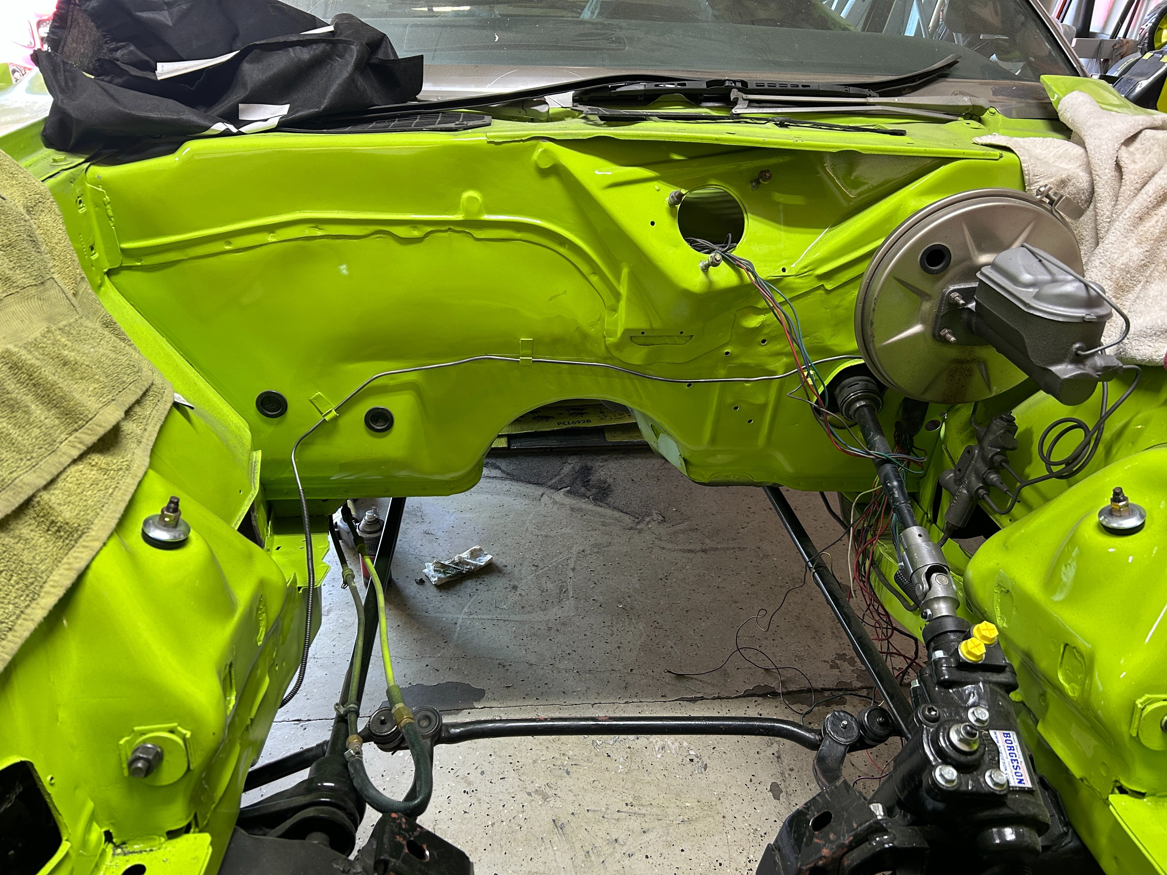

I was planning on using the stock steering box, since i had it rebuilt by Steer and Gear and it is fantastic. However, it hit's the exhaust. I picked up a set of Jeep manifolds from the junkyard, since they were supposed to be the lowest profile smallest option as a backup. However both hit the manifold. I have ordered a Borgeson steering box, to try. On Holley's site, it does not mention that it will fit with the factory PS box. However in the instructions in one view it shows the factory box, then with the engine in, it does not show the PS box.

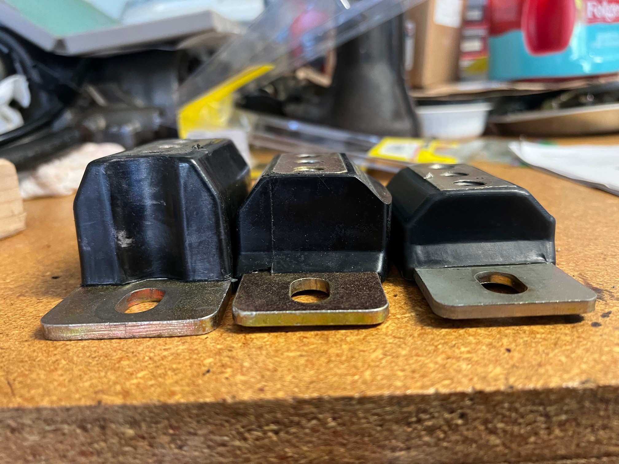

The notes are extensive about how to trim the suggested factory motor mounts, and having done that, they fit fine. The other thing that has conflicting information is the Hemi AC unit. In one spot it mentions having to clearance the K-frame. This is required. However, it does not say which units will fit. I have on the compressor I have a mount for a bolt at the back of the compressor. I had to remove that off the compressor for it to fit with the motor mount. Keep that in mind as your brand new compressor will have to be modified. I got mine out of a fully working car, so I was not as concerned since there was no warranty.
Those are my notes so far. As I uncover more, I'll post if you guys are interested. I plan on cleaning up the engine compartment once all the trial fitting is done, FYI.
