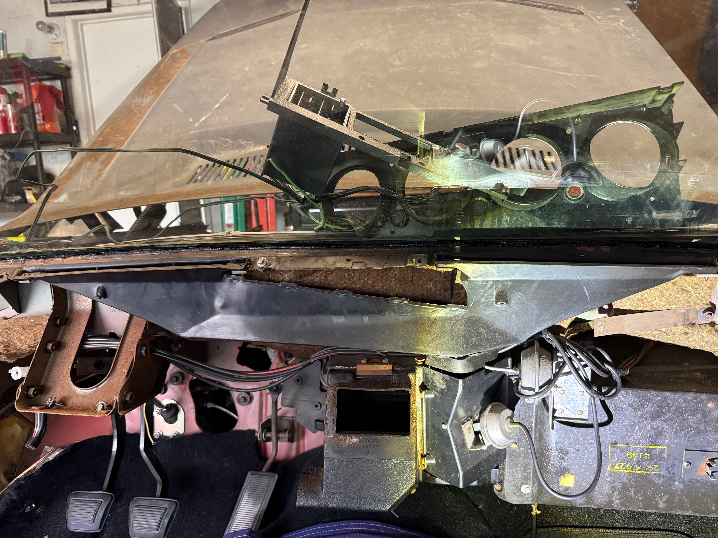

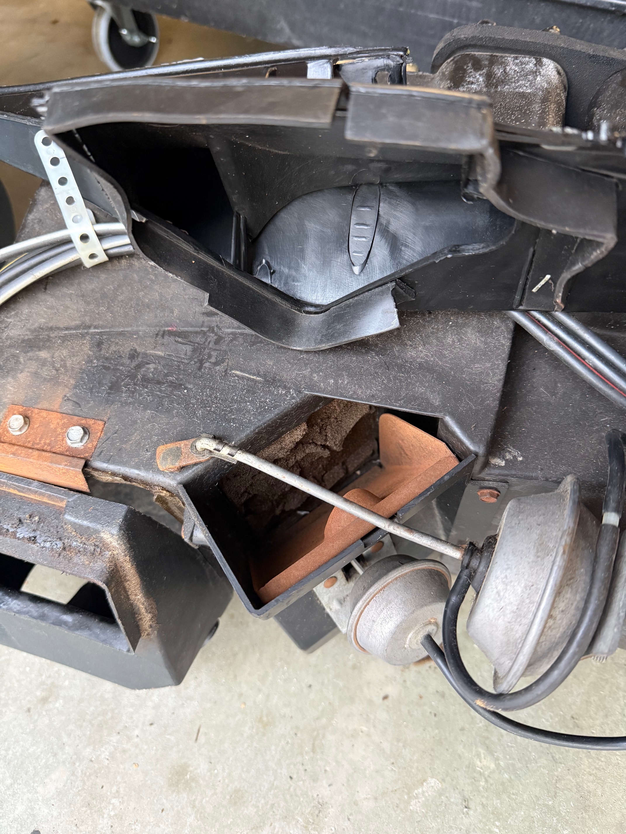

I know the defroster duct is bolted on with screws and the lower portion hovers over the AC box. since an actuator bar goes between the duct and AC box, is it just the rubber seal that semi connects the duct or is something missing?

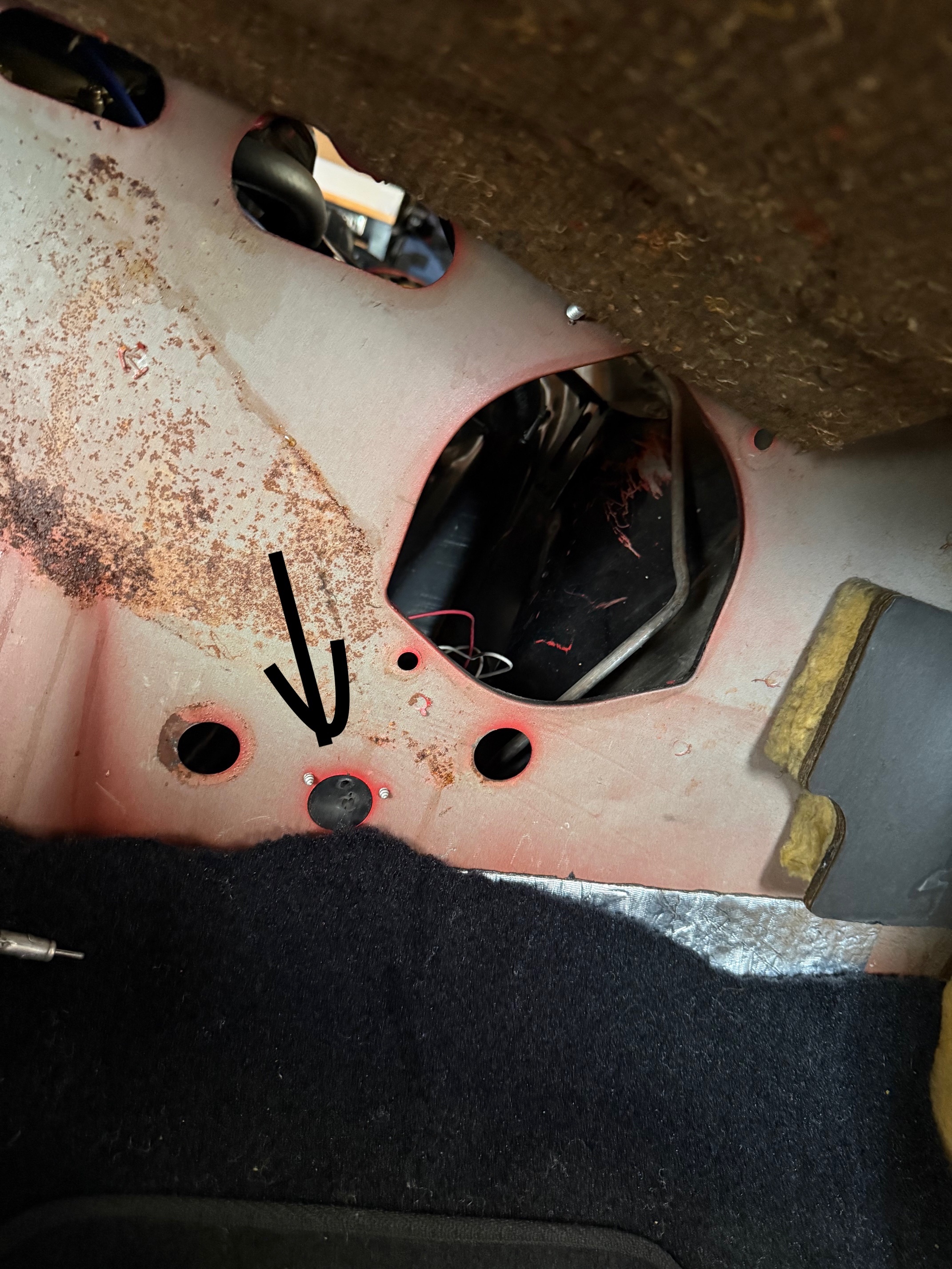

Also is one the vacuum hoses from the AC box supposed to go through the firewall's AC vacuum grommet? if so, does it end there or continue somewhere in the engine?
Thank in advance!
The line that goes through the firewall to the engine is connected at the rear of the intake manifold. There should be a vacuum fitting threaded into the manifold facing the firewall with a port for the heater box vacuum. If you have power brakes then there will be two ports on the vacuum fitting.
There is no seal, just plastic fitted into plastic. The awesome guys above answered your vacuum question.
Do you or anybody have an extra firewall grommet? Seems impossible to find.
Try this website. James at Detroit Muscle Technologies is a great guy and I have had no problem with anything I have bought from him. They may have it. Email or call them if you can't find it online.
Detroit Muscle Technologies, LLC Mopar & AMC muscle car restoration gaskets
If they don't have them a salvage yard, will have them. Other body styles may use the same grommet
If you're not worried about originality, you can just use a regular body plug and punch the holes through you need.
