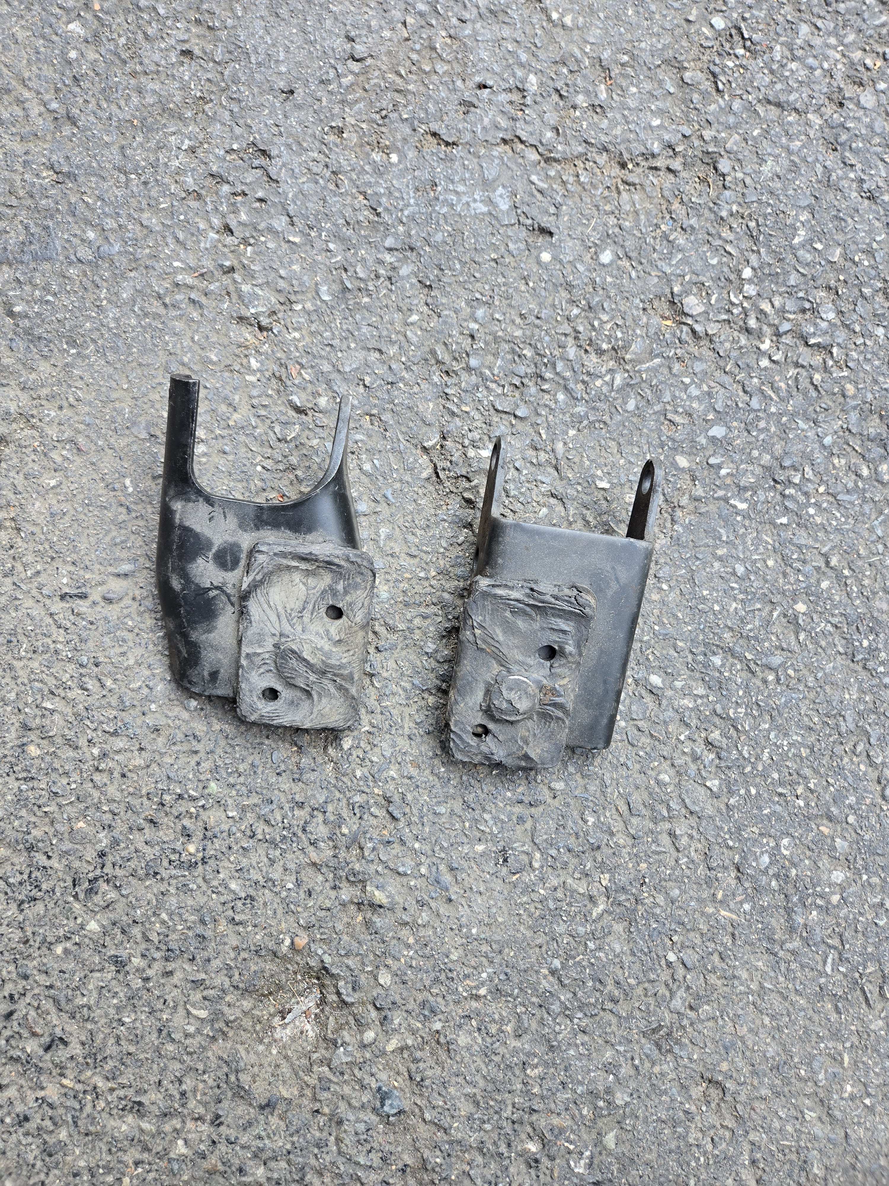

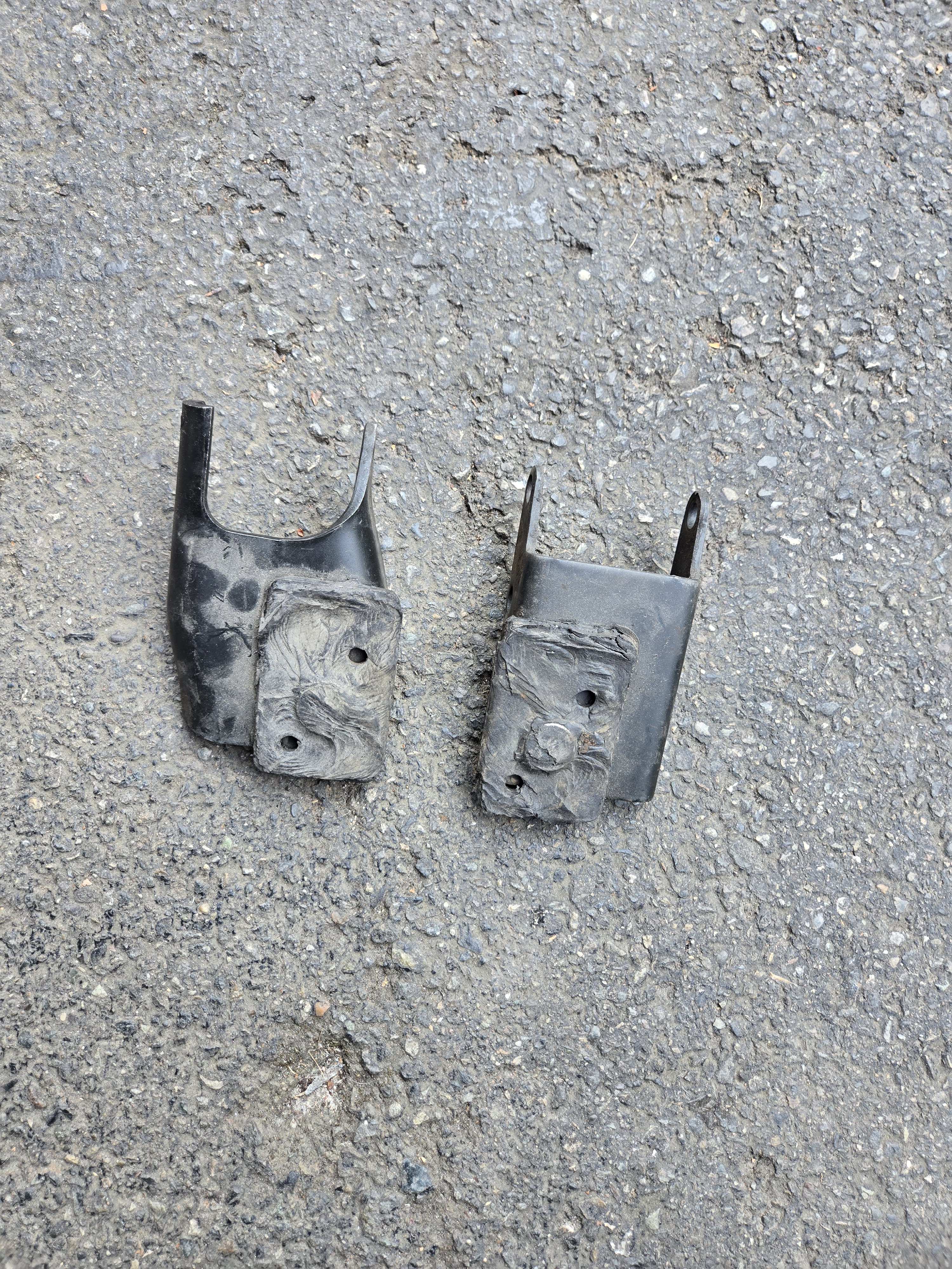

Deal of the week.
Mounts, and I will provide factory k member through bolts, and 6 mount to block bolts.
Plates have the mount to plate nuts.
$80 shipped usps flat rate.
($60 + 18.95)
