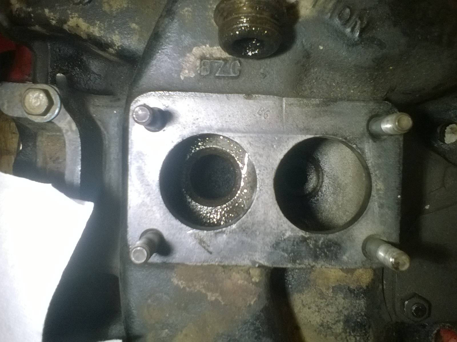

Hi Guys!
I have rebuilt my engine and noticed these two plugs were removed by the previous owner. Does anyone know the size of these plugs? I was thinking of just closing them up.
Any thoughts? (the pic isnt mine but it shows the same holes I have)
challenger6pak
Feb 27, 2011
4,092
924
Close them up. I believe it is 3/4 pipe thread. They are part of the early EGR system. They let exhaust back into the intake.
Rapidfire
Aug 7, 2019
1,260
819
Culbertson Nebraska
Just run the appropriate size pipe thread tap in and put a plug like the other side. That's what I did on my stock big block manifold.
