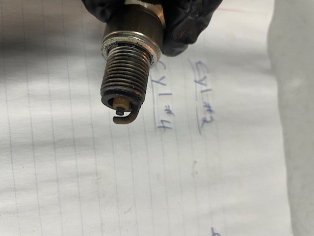

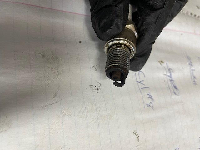

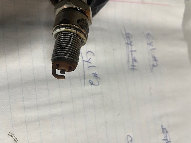

-Just performed a full compression test (engine slightly warm) and checked the color of all plugs.(see pics)

5) My lowest compression cylinder (#2) is low enough to cause this erratic stumble? (I included a pic of the #2 spark plug along with a few others for comparison. #2 was one of the lightest brown in color but none were black or oily which I believe tells me that the bottom end/rings are in good shape.)
