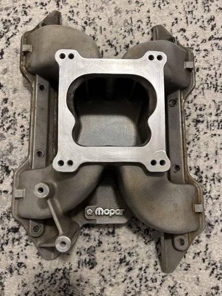

Thinking about running g a Max Wedge crossram on my new 512 build.
Now my questions:
What horsepower and torque differences would I expect over a big, modern, single plane intake with a 1250 or bigger Dominator carb.
Are there any out there for sale and for how much?
I have read that the earlier ones were prone to cracking around the bolt holes. True or ?
If there are some cracks there, are the cracks repairable and where should I inspect for them?
What are these intakes worth un modified?
I have seen one that has been polished "back in the day" by what I could only categorize as a moron, that ground off all of the casting and date code numbers.
So lastly, what is a serviceable unmodified intake worth?
Depending on the price, what would the polished, no numbers intake be worth and is it worth chasing down?
My car is a 72 Challenger, 512, 727 with a brake, relocated Super Stock springs, Max Wedge ported aluminum heads, TTI step headers, dual 3" exhaust, 4.10 gears, drag radials, solid roller cam approximately 270 @ .050, high 600 lift, (haven't ordered it yet), and I have 5 convertors
from 2500 to 5200 stall on the shelf.
Limited street and once a month or so track use and it better haul a☆☆!
Has anyone actually compared the Max Wedge intake to modern big single planes on the dyno or track?
I have my opinions, but no firm data.
I have several Dominators and a Super Victor, so is the Max Wedge intake gonna actually run faster, or just have it for cool points?
I haven't even heard of anyone having the linkage for a Max Wedge deal either, but I can fab it in my shop if I find an intake.
THANKS FOR ANY INFO!!!
Looking for hi 9s on the motor, and will prolly see what it will run with a plate (or two) system if my huevos hold up!

@TIMINATOR , A&A transmissions (yes, that's correct) used to fabricate the Max Wedge crossram intake. I believe they still sale a lot of the bits and pieces. Certainly the Max Wedge intake would have it for the "cool" factor. And the intake did help with the supercharging effect above 5,500 rpm. Which is between your planned maximum torque and horsepower range
To this day, I firmly believe the Max Wedge engines made more horsepower than Chrysler admitted to. But the Ramchargers pretty much abandoned them once the Hemi was built in '64 with good reason.
I have no first hand experience with an actual Max Wedge (or 426 Hemi). Too rich for me as I opted to retire early and enjoy life sooner. But in my humble opinion with what I have worked with successfully over the years, I think other than the "cool" factor, you'd be better off with the aforementioned single plain highrise intake and big four barrel. They have served me well. With the crossram, you're seriously looking at $3500 to $4000 for the setup and I'm not convinced you'd make any more horsepower. Certainly not enough to offset the cost to benefit ratio.
But I see your intrigue and love your thinking, it sure would look very COOL! I'm eagerly waiting other racer's opinions! 😀
