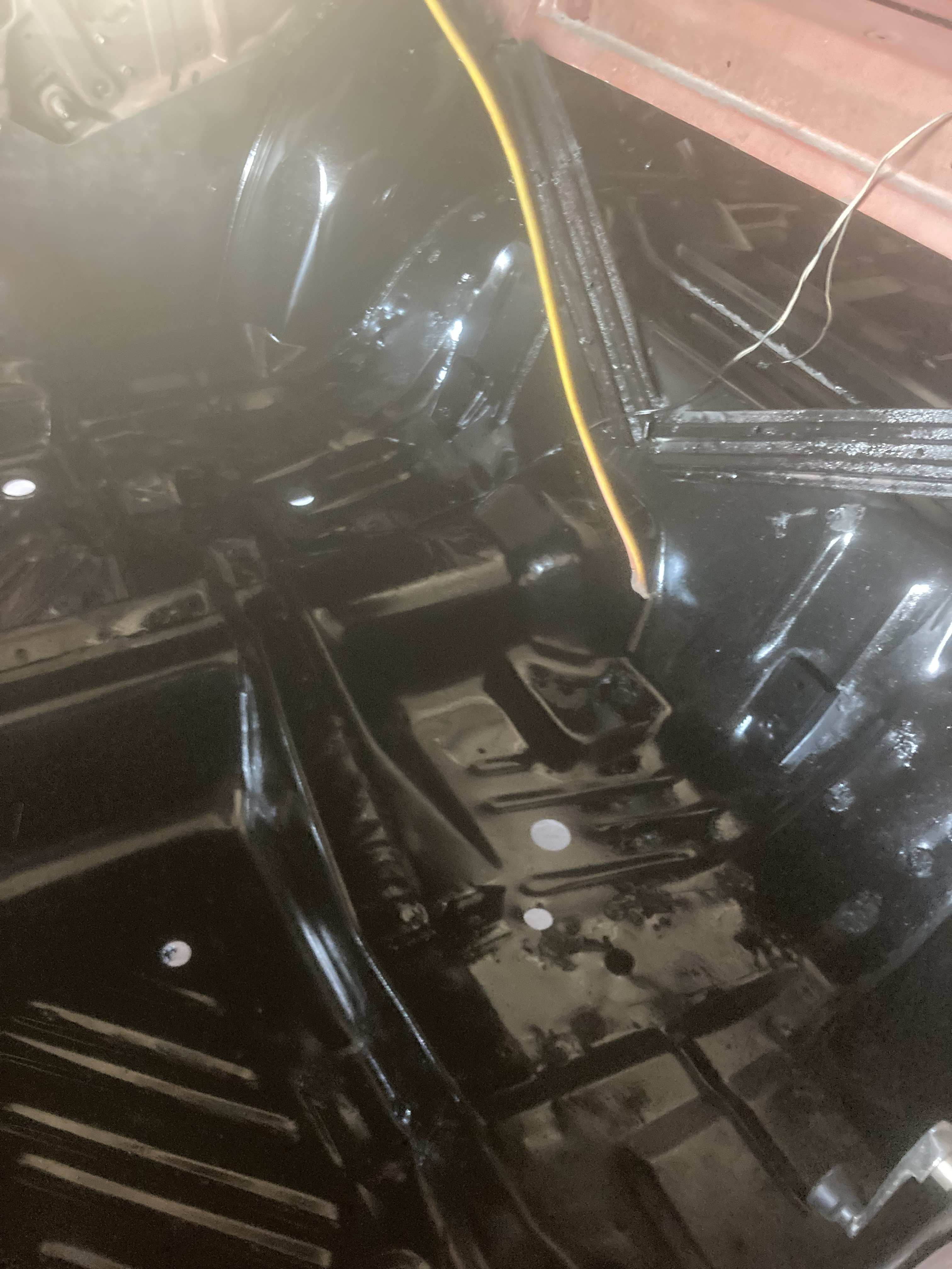

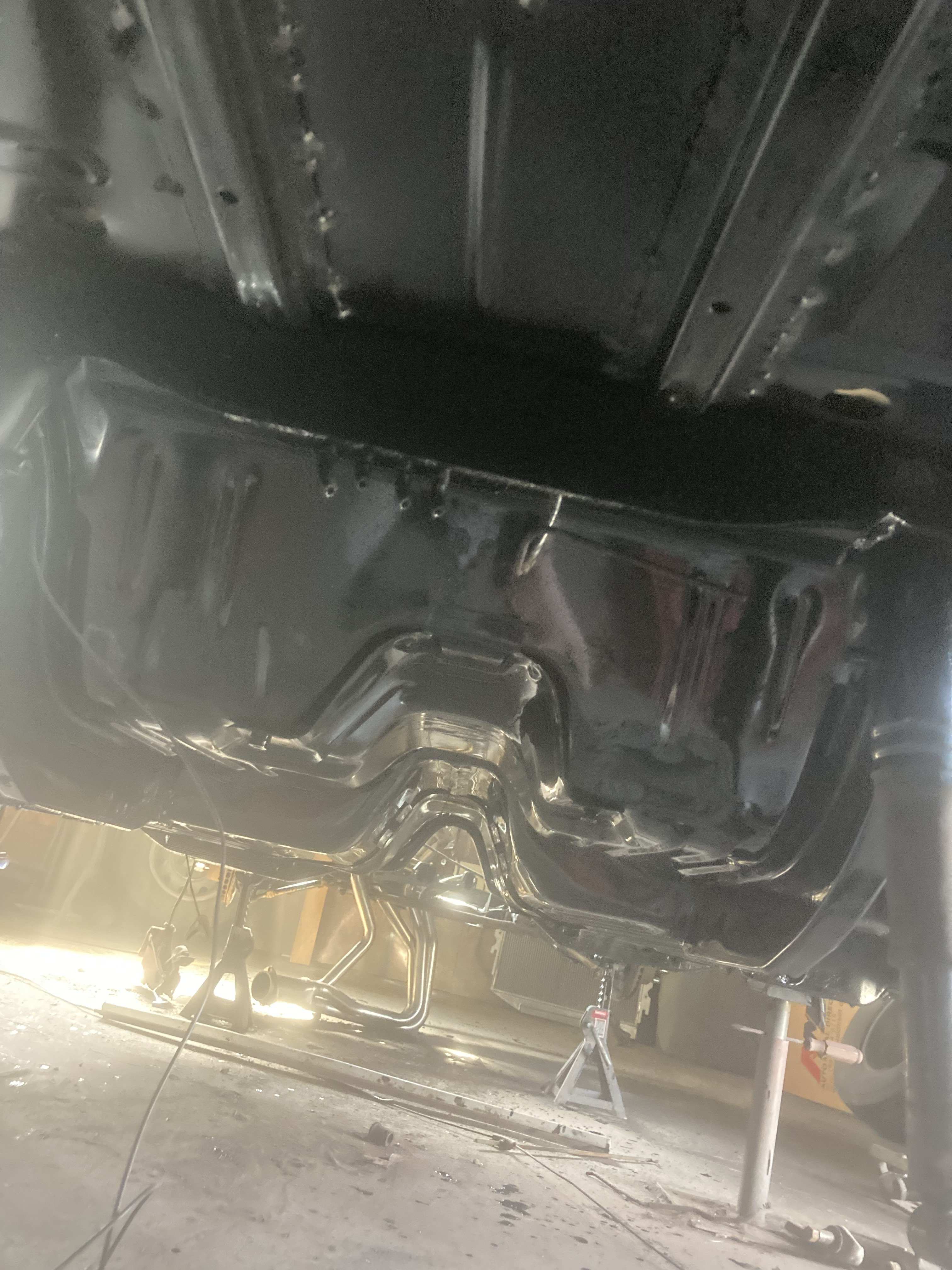

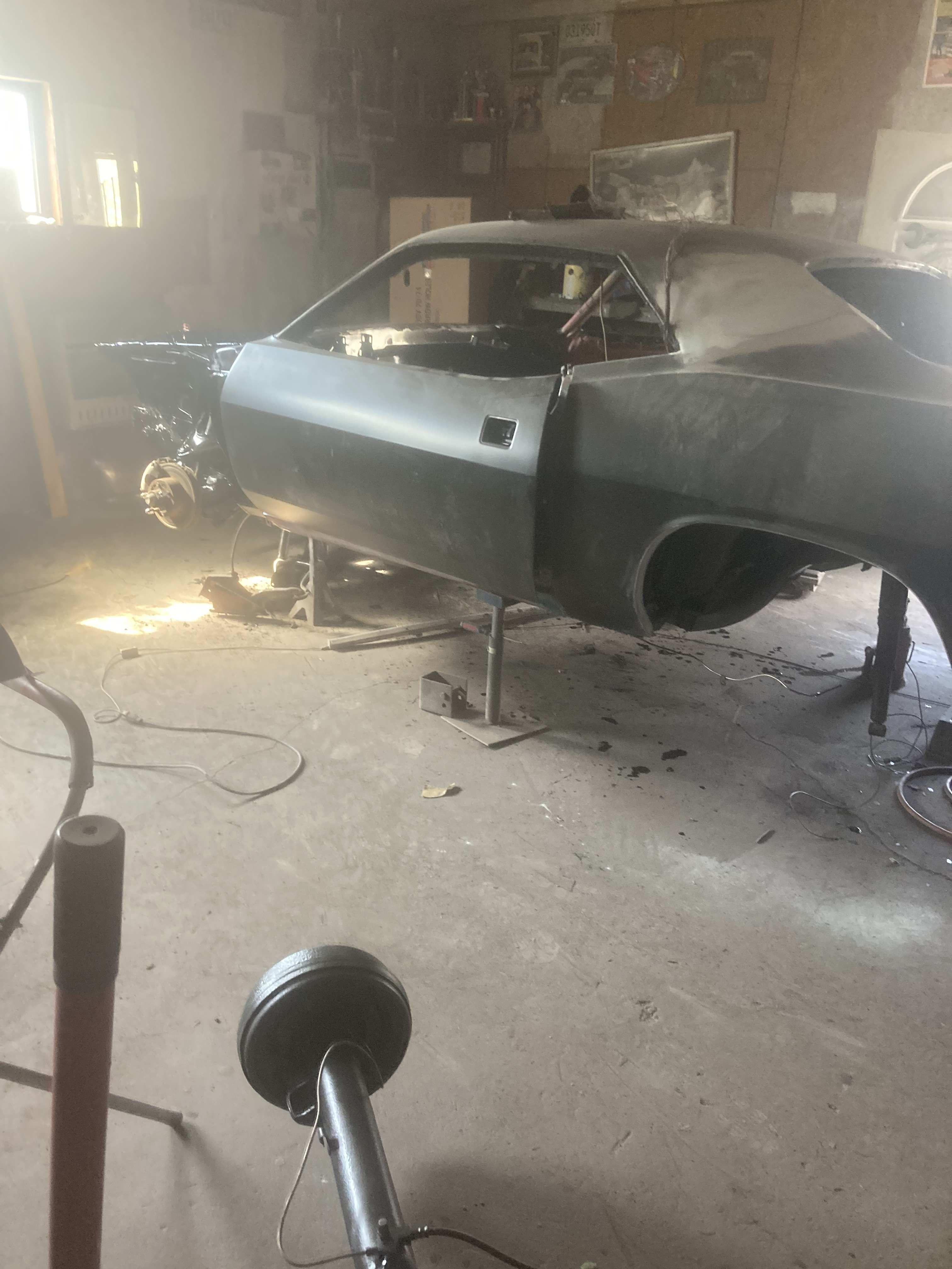

After we got done with the quarters, next it was time to move on to the door skins. I don’t think I took any pics of the passenger side but you guys understand. Then we proceeded to prime the underside and the inside.the primer really shows off any splatter from the spot welds etc. we went back in a cleaned up everything we missed the first time, cleaned everything up again and gave it another coat. Now we are almost ready for paint.

Constructive criticism. I can't see everything. The way you have the the car up could be a safety problem. Induvial jack can move unexpectedly with very little force. Now that the floor is mostly complete. I would be more secure with a 4x4 or 6x6 under the rockers with jack stands or cribbing on each side.

Good catch. We had it like you mentioned. We felt good about it and it actually felt solid but anything could happen at any time. It didn’t stay like that for long as we moved on to installing the rear axle and springs. When we did that we actually bolted the bumper brackets back on the rear and put stands under that also to keep from falling on us.

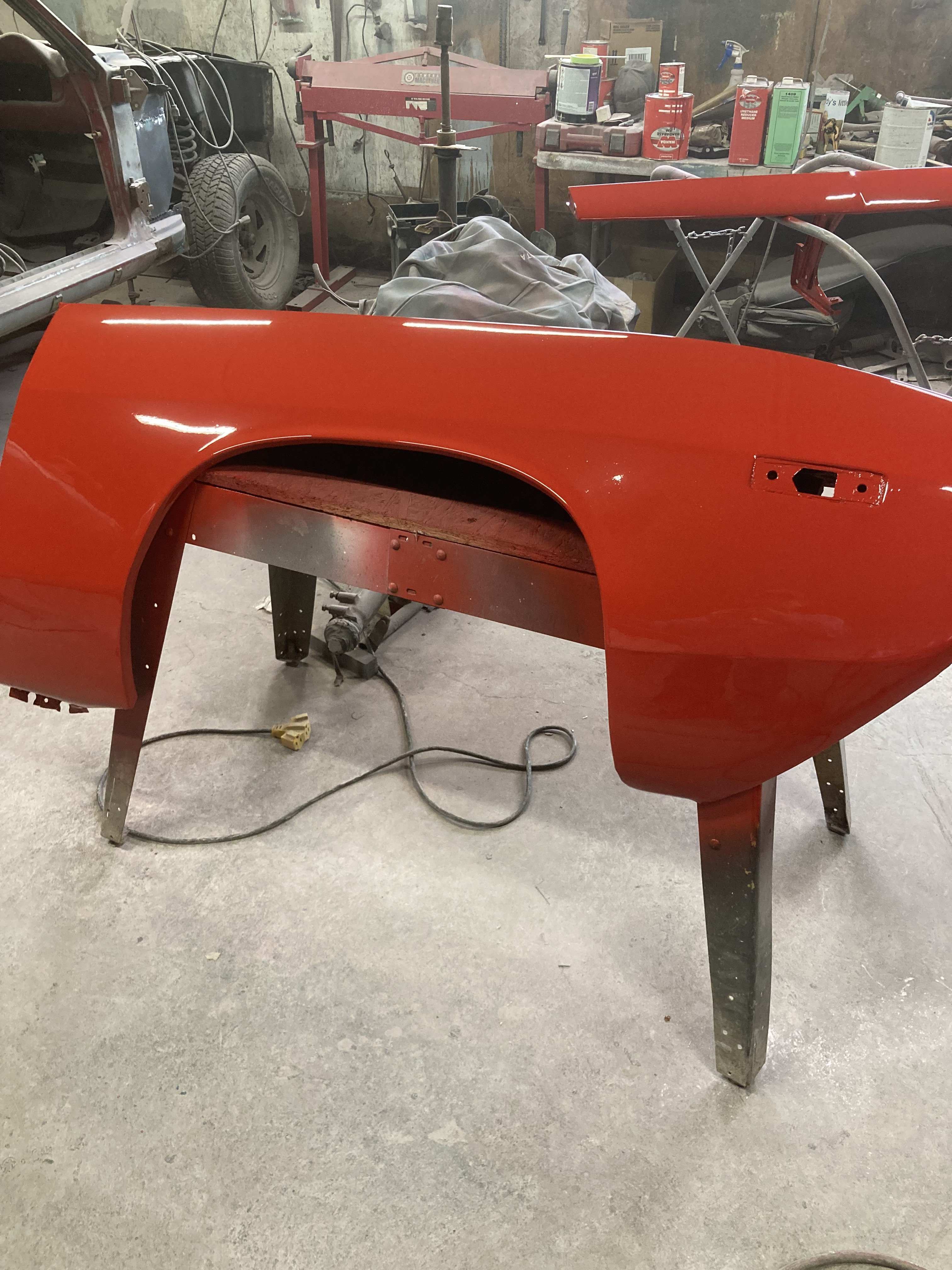

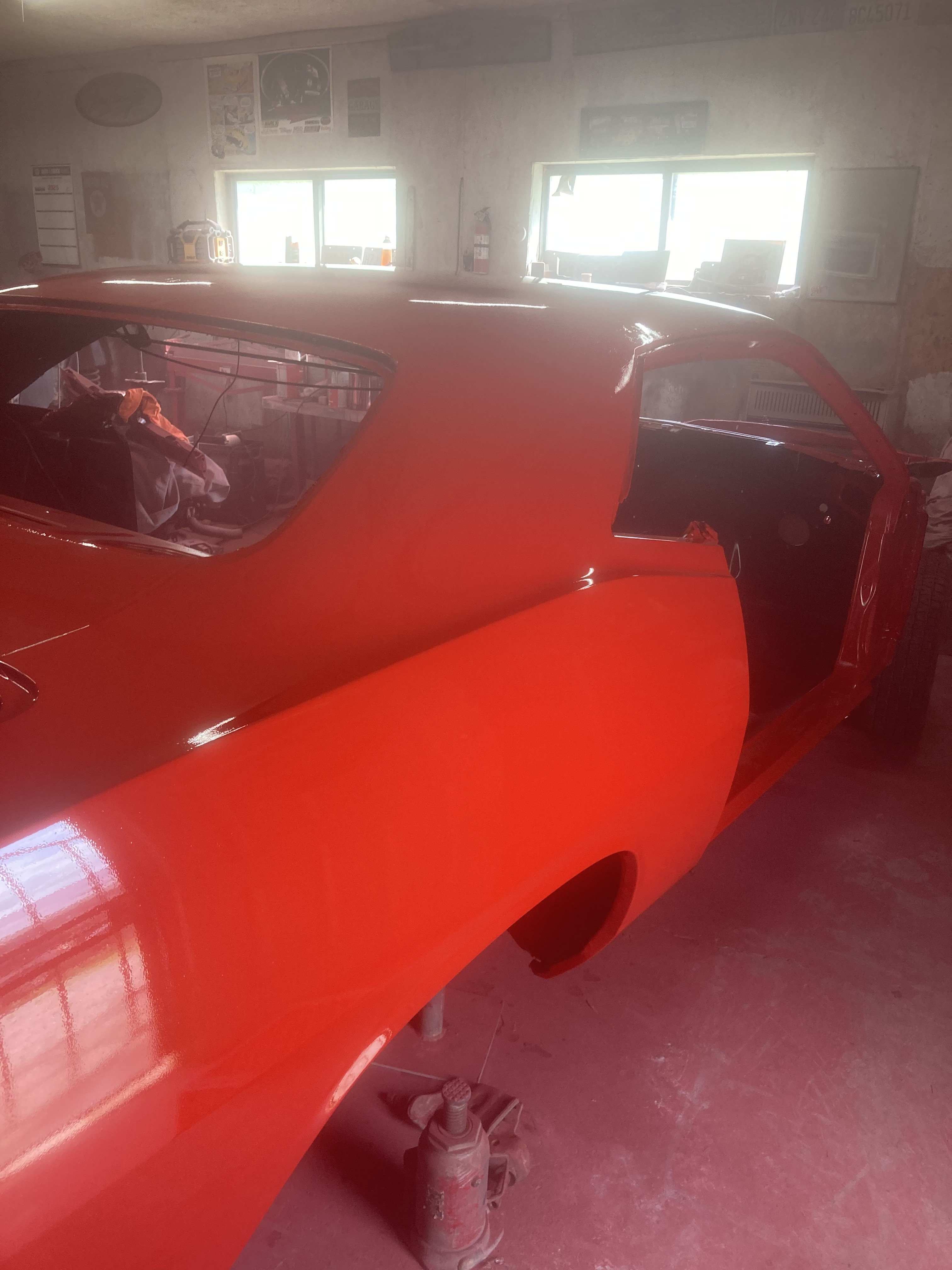

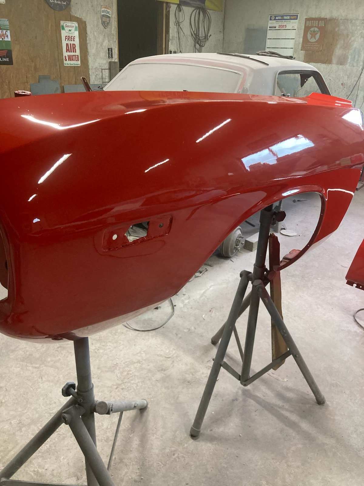

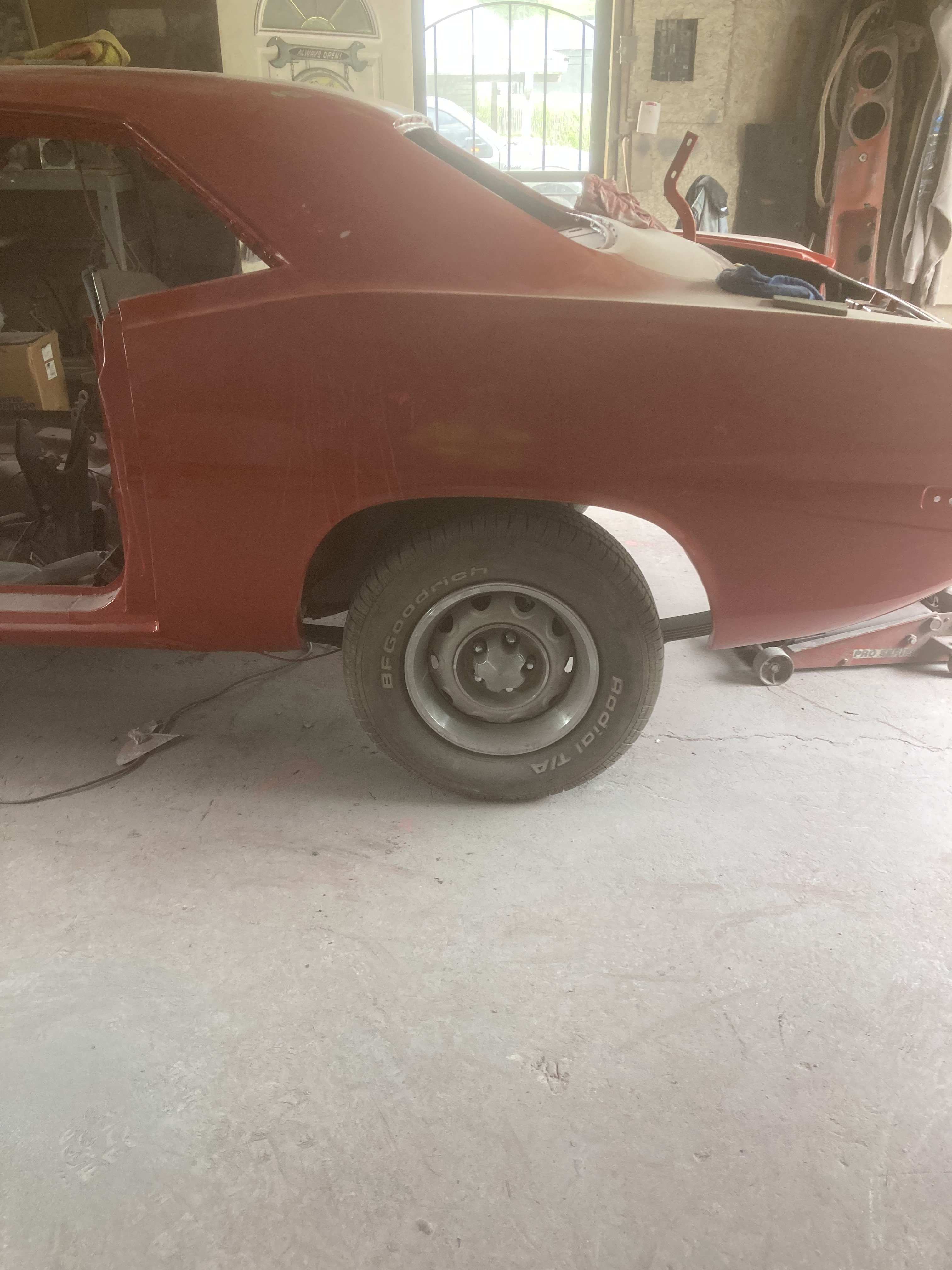

Next it was time to primer the out side, block the outside and add a coat of paint. I’m not a painter but my buddy is old school. He likes to apply a coat of paint and then sand any imperfections out of the car than give it its final coat. Is it the correct way to do it idk? Is it a 15k paint job no, but it’s about as good as it when it came off the assembly line.

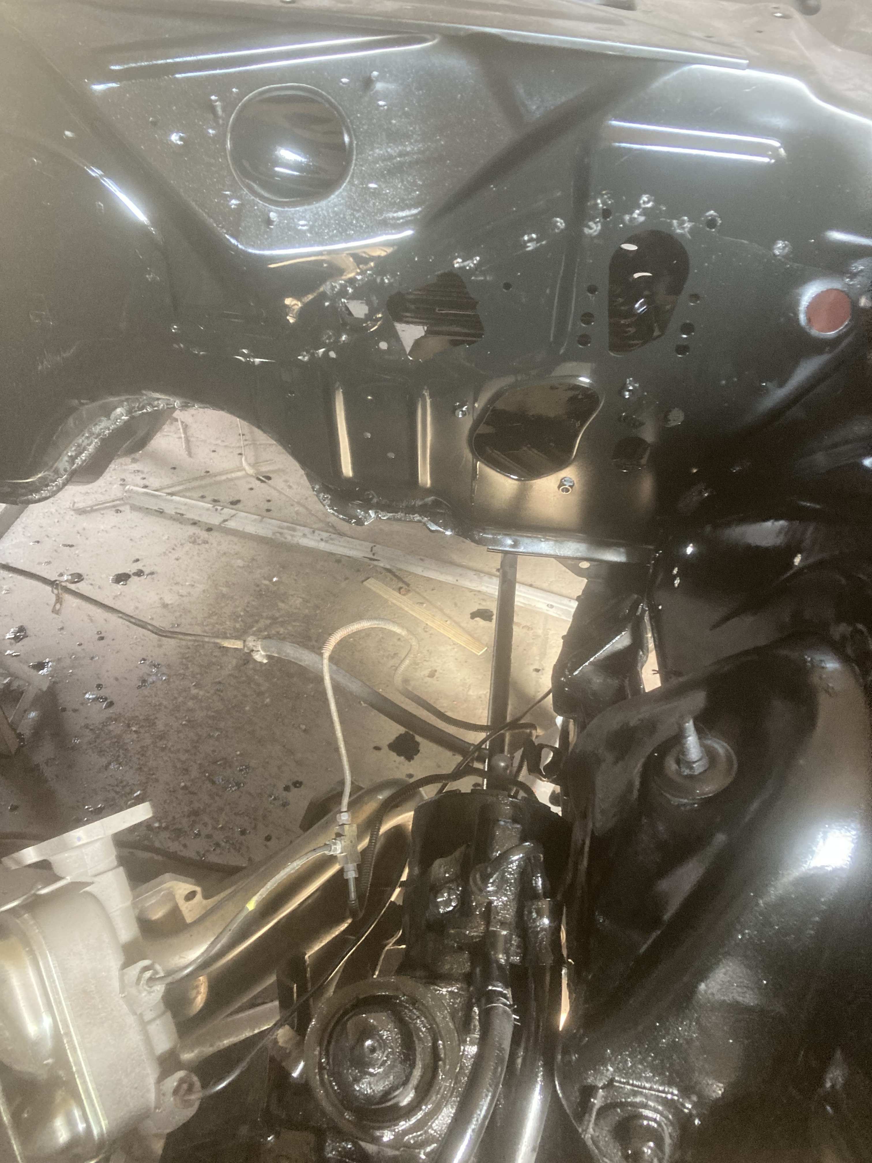

Well I didn’t figure it would go so easy. Ran into a problem. If you go back to post #42 and the next to last picture. Laying by the jackstand you’ll notice the front spring hanger bracket laying by the jackstand. You’ll also notice it has two holes in it. Now I’m not sure if this was a direct connect item from back in the day or it was taken out and drilled in a shop a long time ago. I know from my old Mopar chassis books they wanted you to have a spring hanger bracket with multiple vertical holes to set the height of the springs and therefore make the car hook harder or looser depending on what you needed. My leaf spring packs on both sides looked horrible, plus someone, maybe it was my dad put 9 leafs on the righy sideand 7 on the left side. I completely understand what they trying to accomplish. I was going to redo the whole packs but after some miss communication with a vendor on front spring eye bushing diameter, etc. I decided to order a set of Mopar super stick leaf springs since there still being manufactured. When you put it all together, this is what you get. A rear axle slide about 2.5” to 3” further back in the car.

So after a little research I came to the conclusion that my front spring hangers are either a direct connect item or they was homemade. Whoever made them if that’s the case done a good job, because the holes for the studs and the bolt pattern are done perfectly. I went and crawled under my other and then realized they only had one hole in each bracket for the spring eye. So I got me a set of those coming. After measuring the original to the car ones and the other set, I figured out it did indeed push the leaf spring back about 2.75’’ so we put the news to me set on and it brought the rear tire back into the center of the wheel well. The funny part about all this is that there was no fight to get either bracket installed etc. both sets went smoothly together.

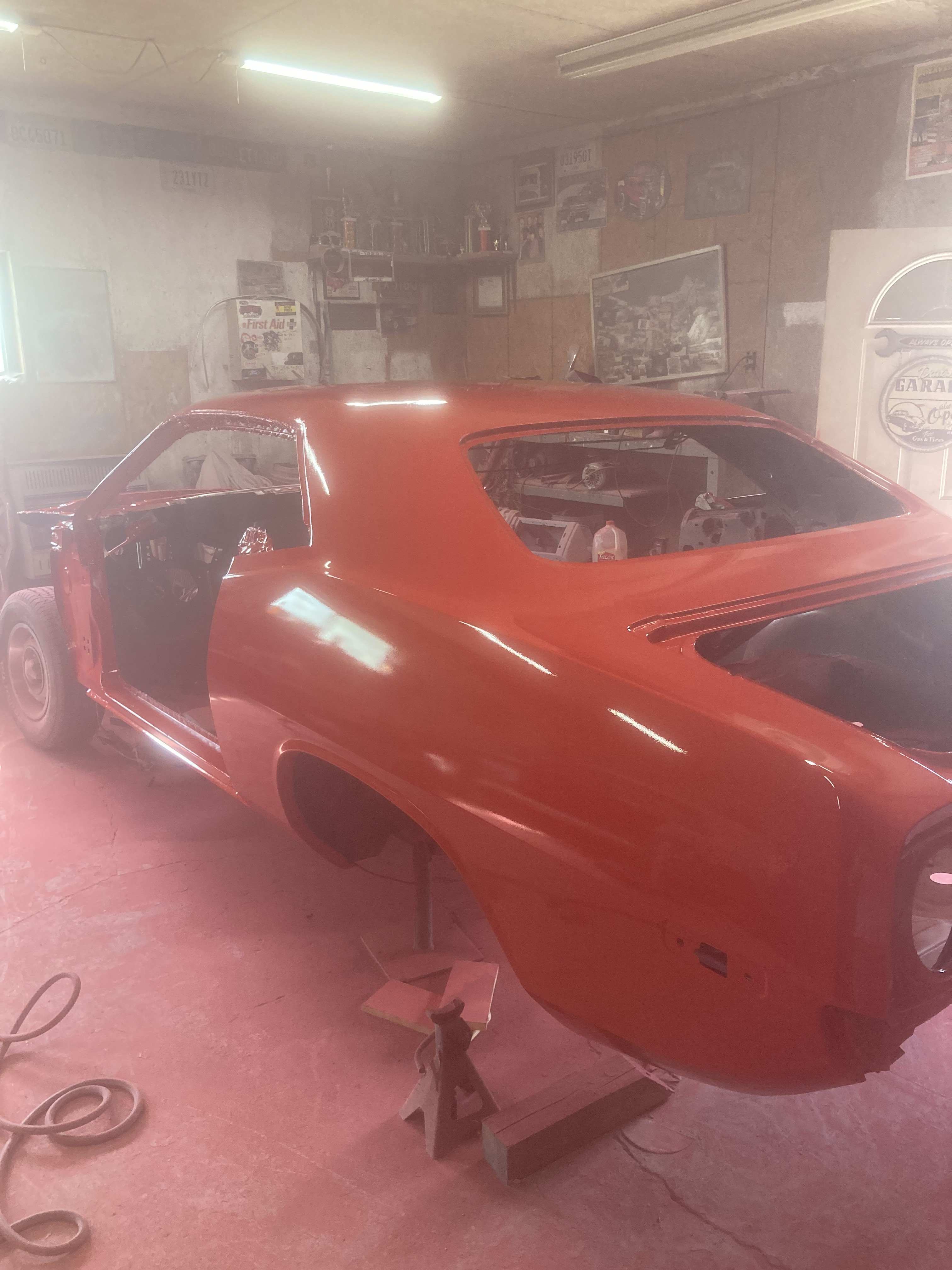

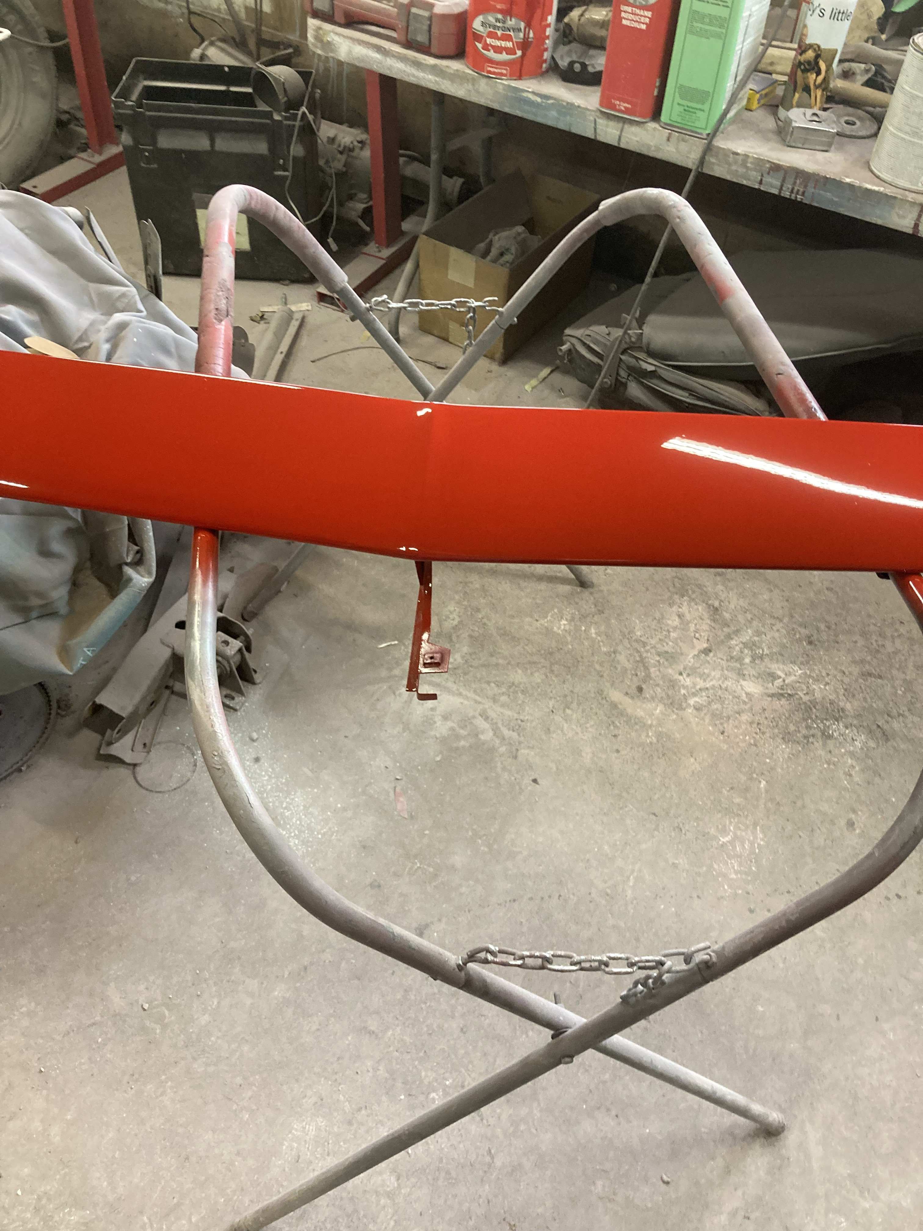

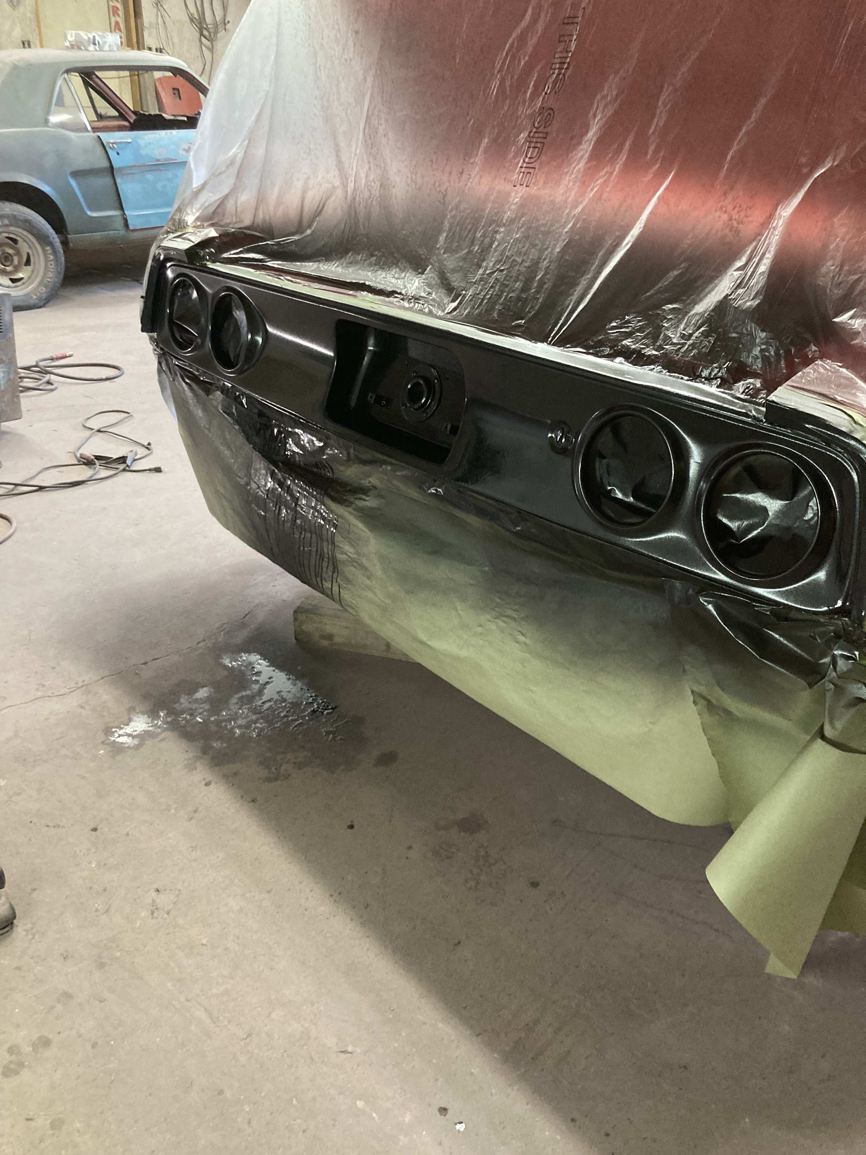

Here is the tail panel complete. It is of course painted in a copy of the original organosol formula.

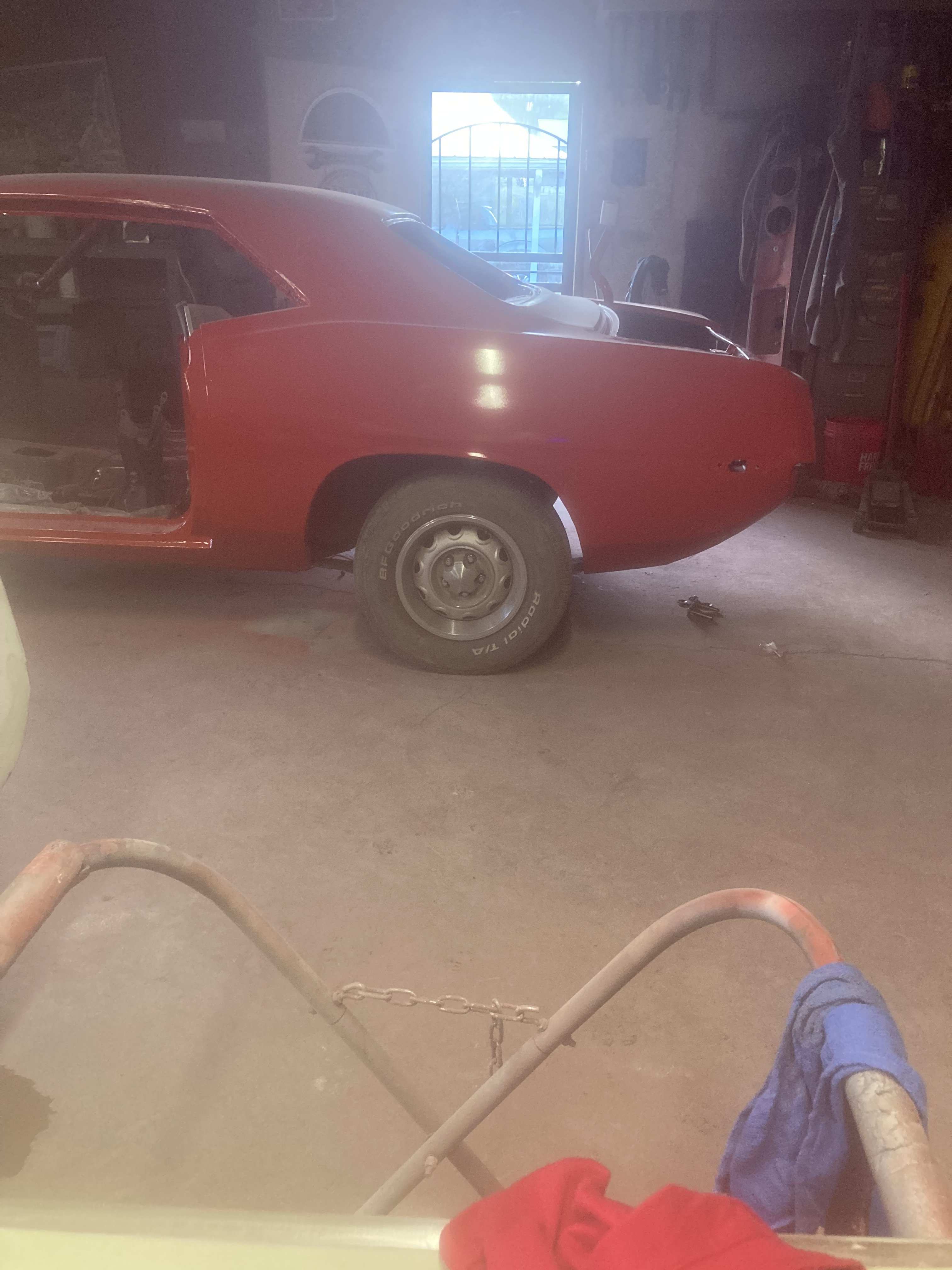

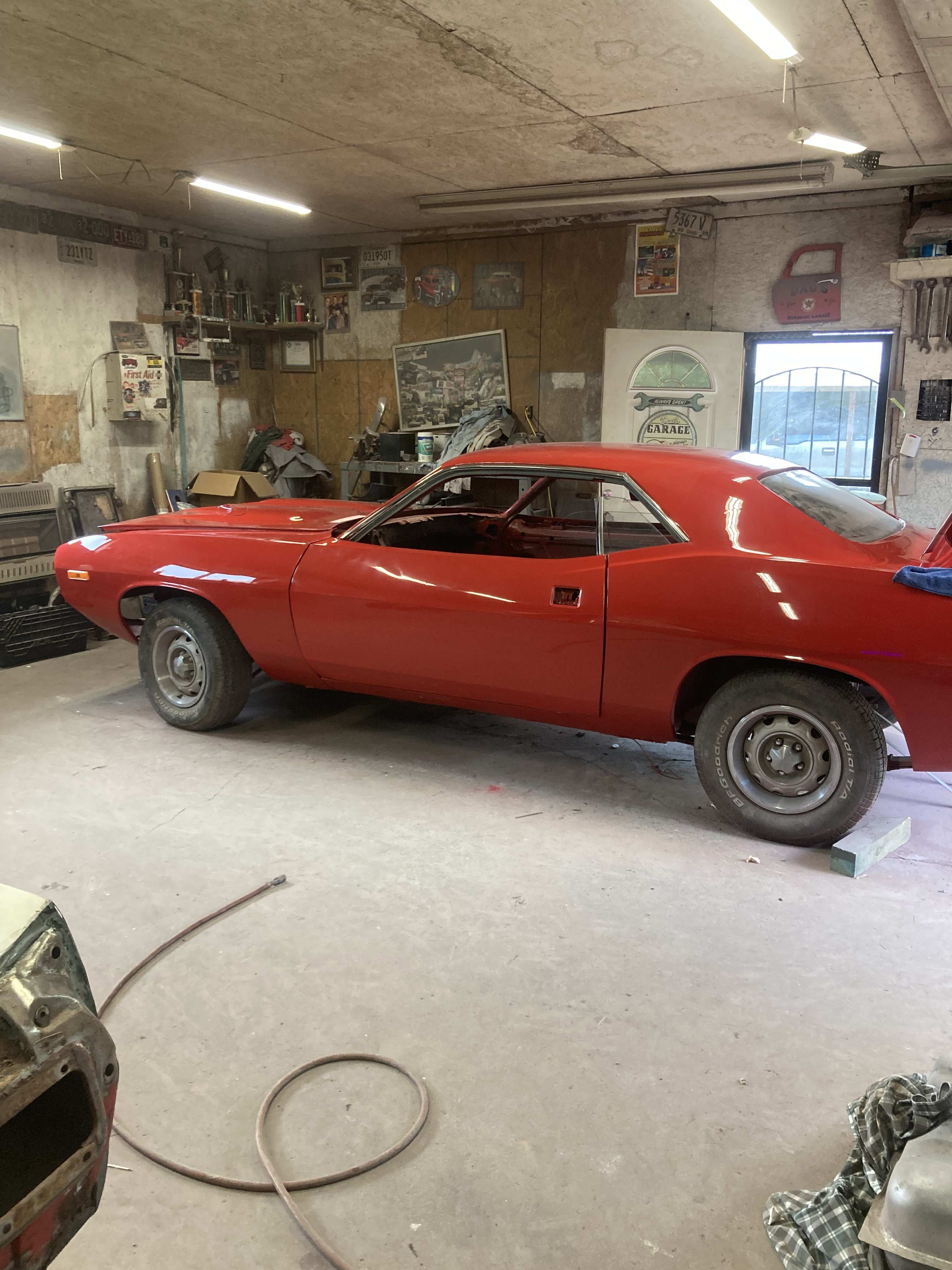

Thank you. Progress has kind of stalled for the moment. I’m out of parts. I didn’t think we would be this far along so I delayed shipping on a ton of parts in favor of having them delivered to the mopar nationals. So not much progress has been made in about three weeks or so. Here it sits in its current form.

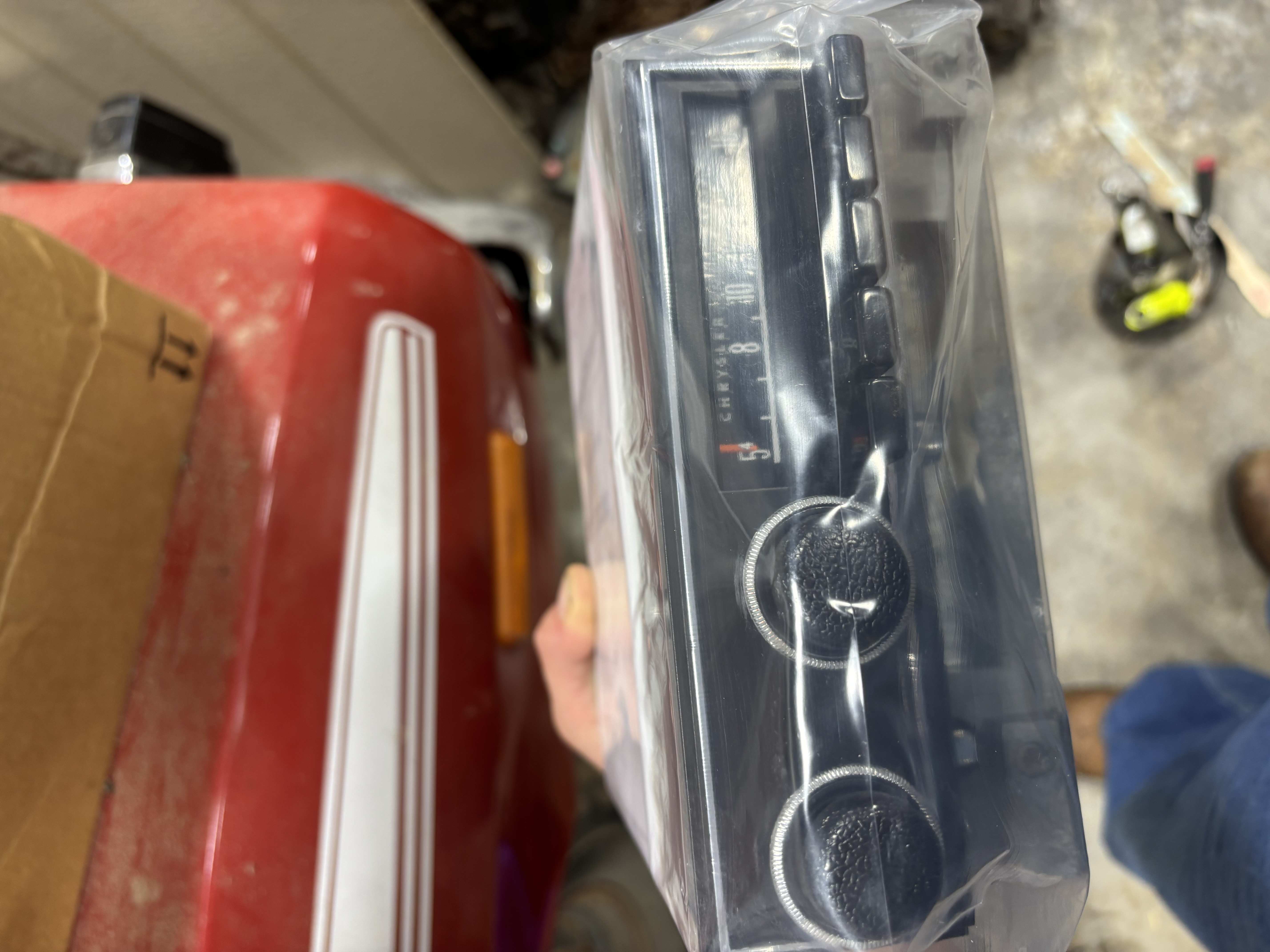

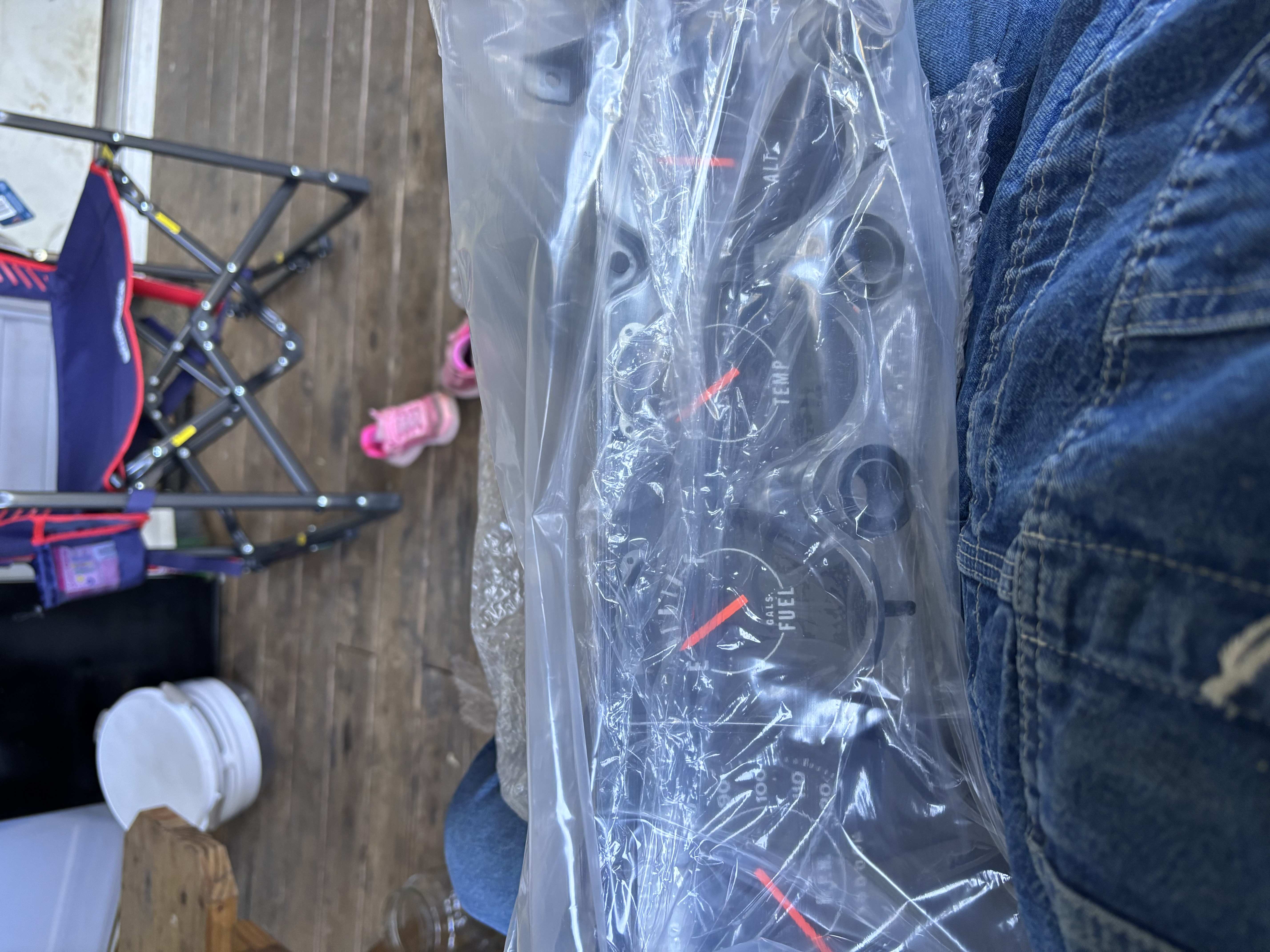

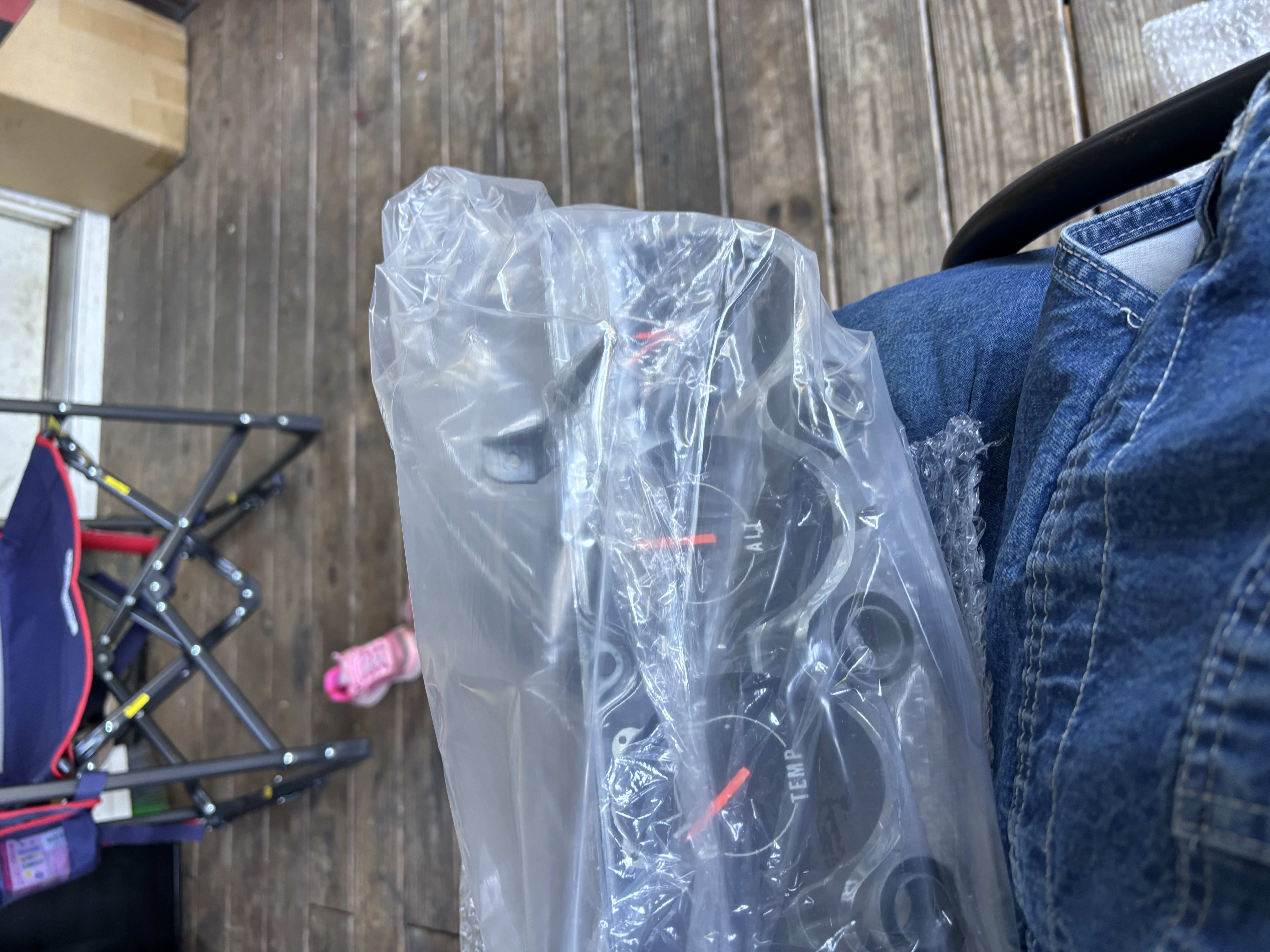

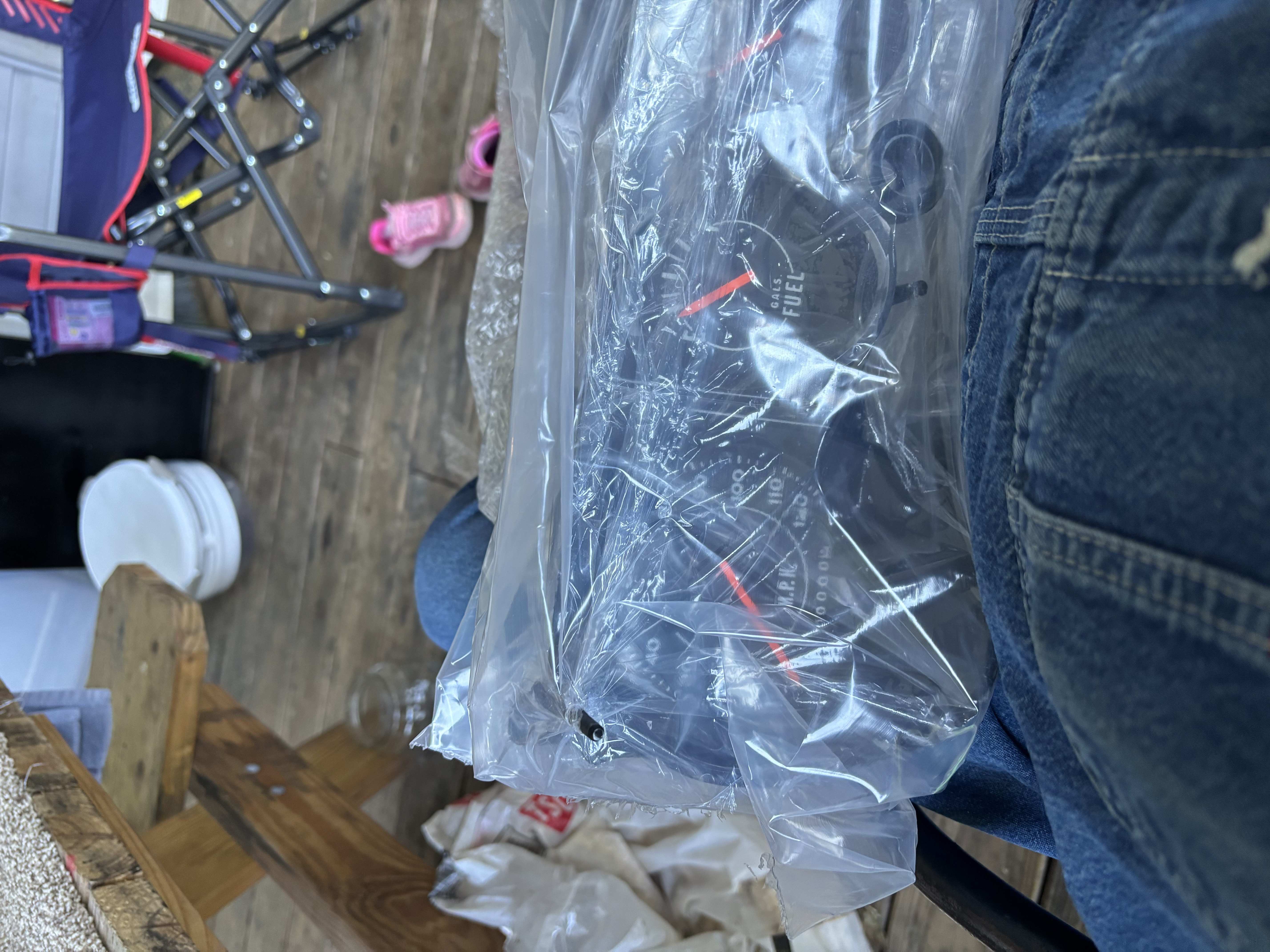

I think we will be at a standstill again about a week or so after the nationals. The big hold up is the instrument cluster, radio and dash pad. I should have sent these items off as soon as I took them out of the car, but instead I waited till end of May to ship them out. The dash pad has a five month wait which puts it being complete in October. The interior I’m not so much worried about as my buddy’s son has an interior shop. He done my last one and done a good job on the car. Once it goes in his shop, he will roll it out in in two-three weeks.
