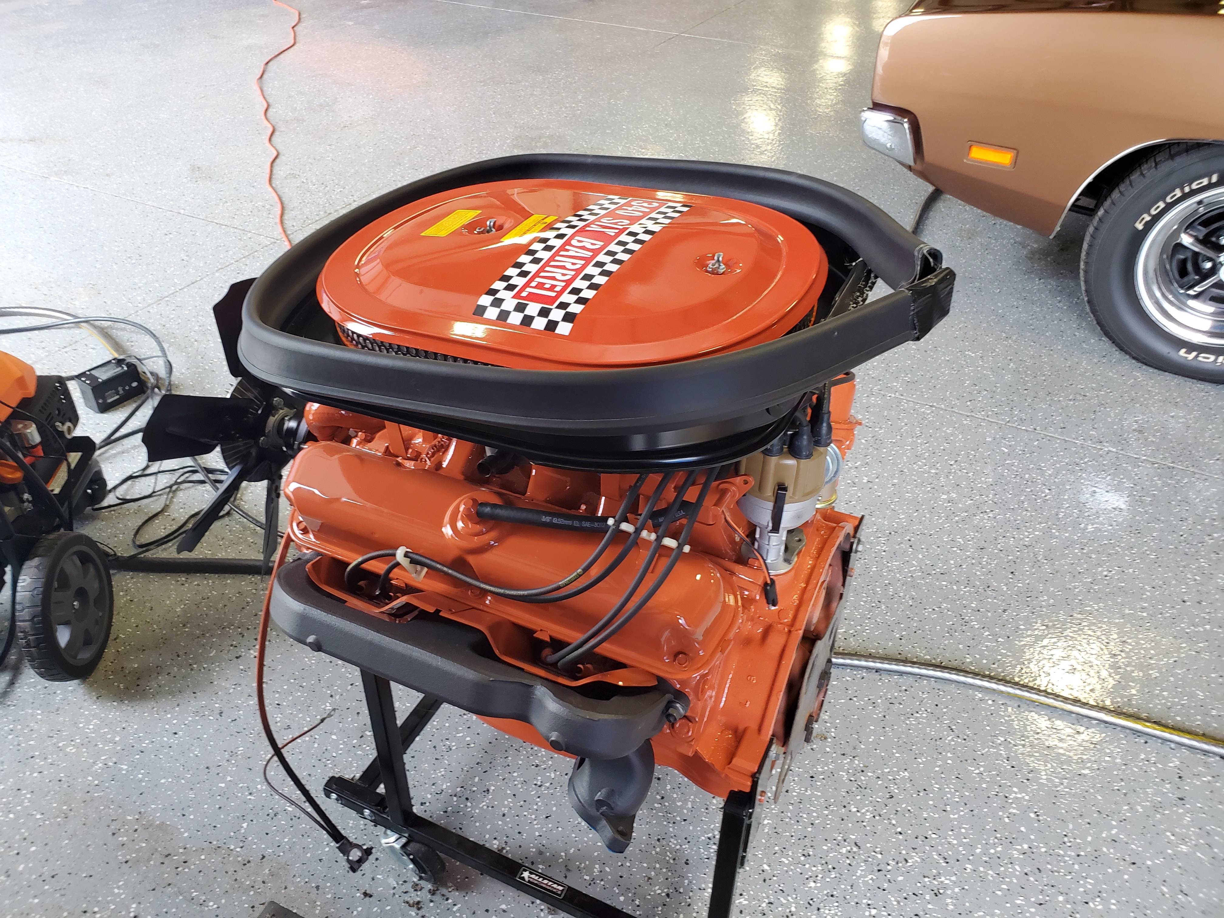

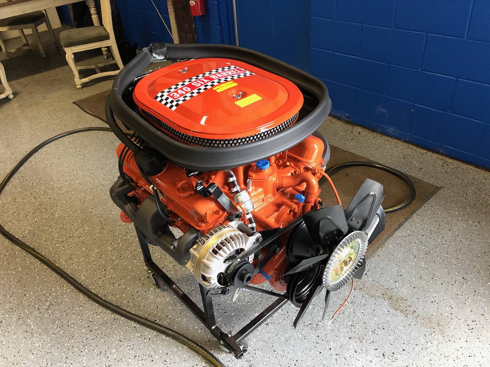

Well I wound up contacting Brewer's and he fixed me up with the complete assembly unique for this 340. For those interested the 440 six bbl currently in the car is coming out and the original 340 six bbl is going in an AAR Cuda this weekend.

Now we get the rest of the story... A 440? to a six barrel 340. Not a 440 to a 340.

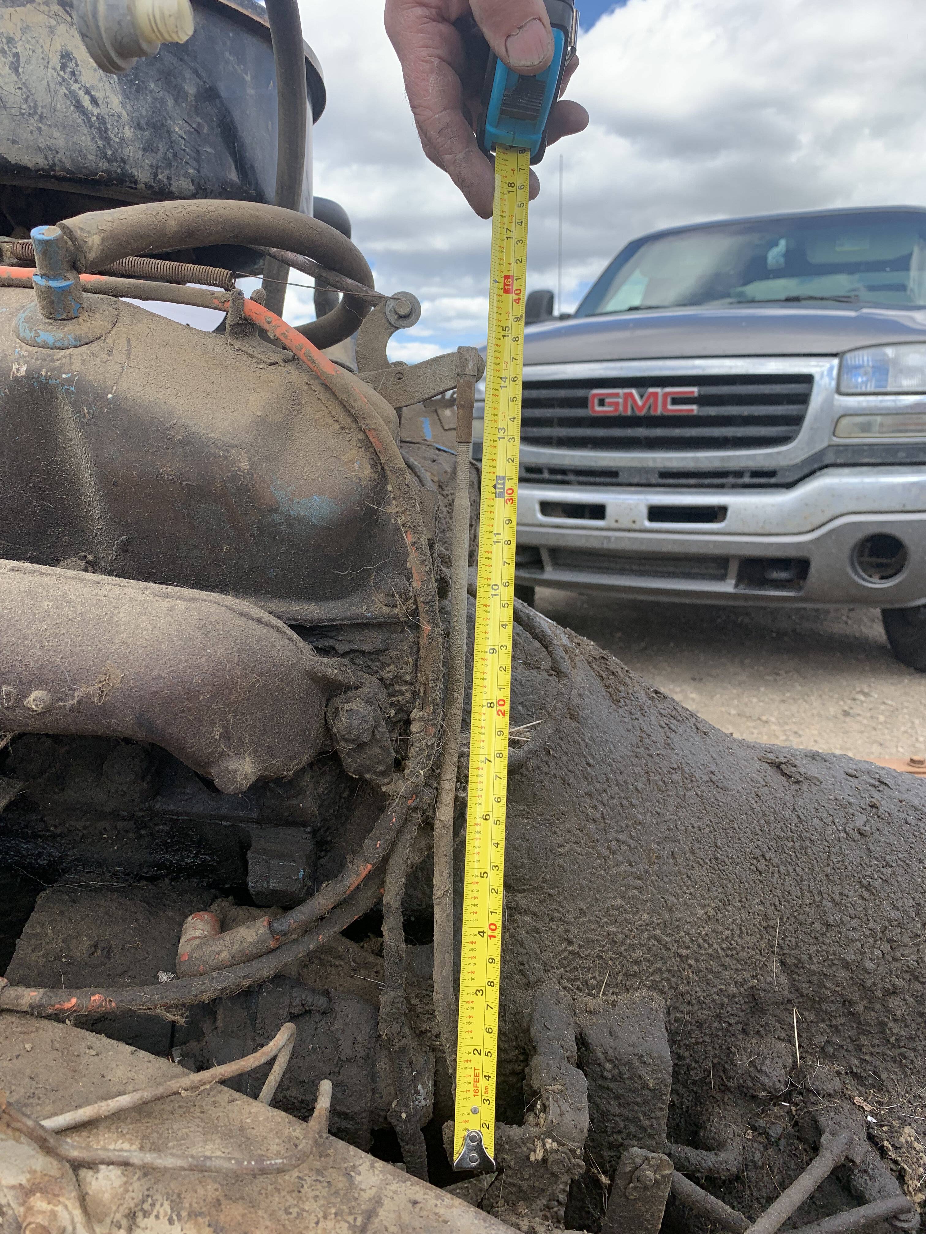

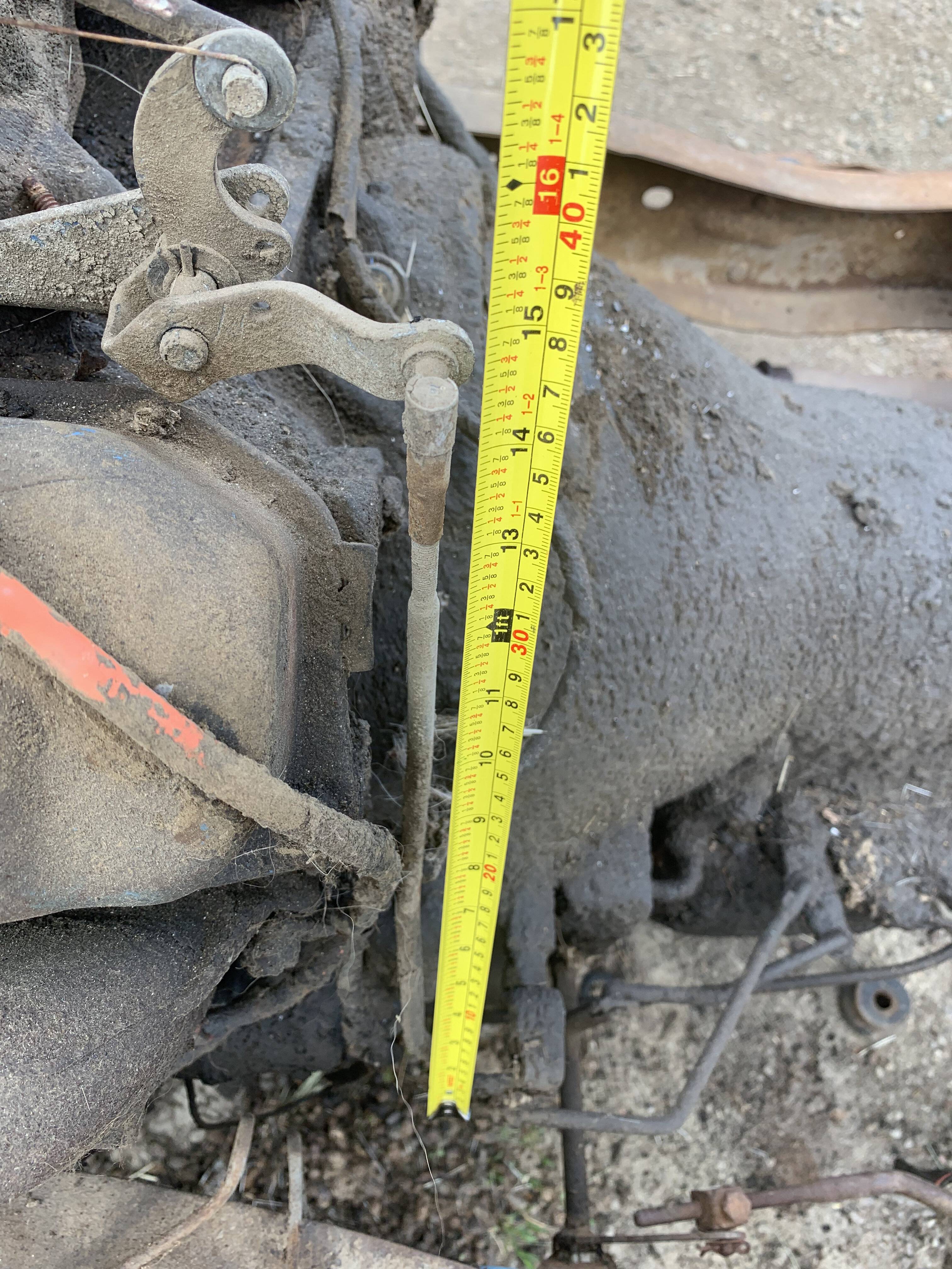

If it’s the 3 piece system the up down rod needs to be 13 /3/4 - 14 inches without the screw on part. I may have a couple left. U need the 440 bracket also as it’s different than a 373 bracket. Top rod is different also. Kim
Here is a pic. Kim

Can't thank you enough (oldkimmer) for getting those pics, much appreciated.
