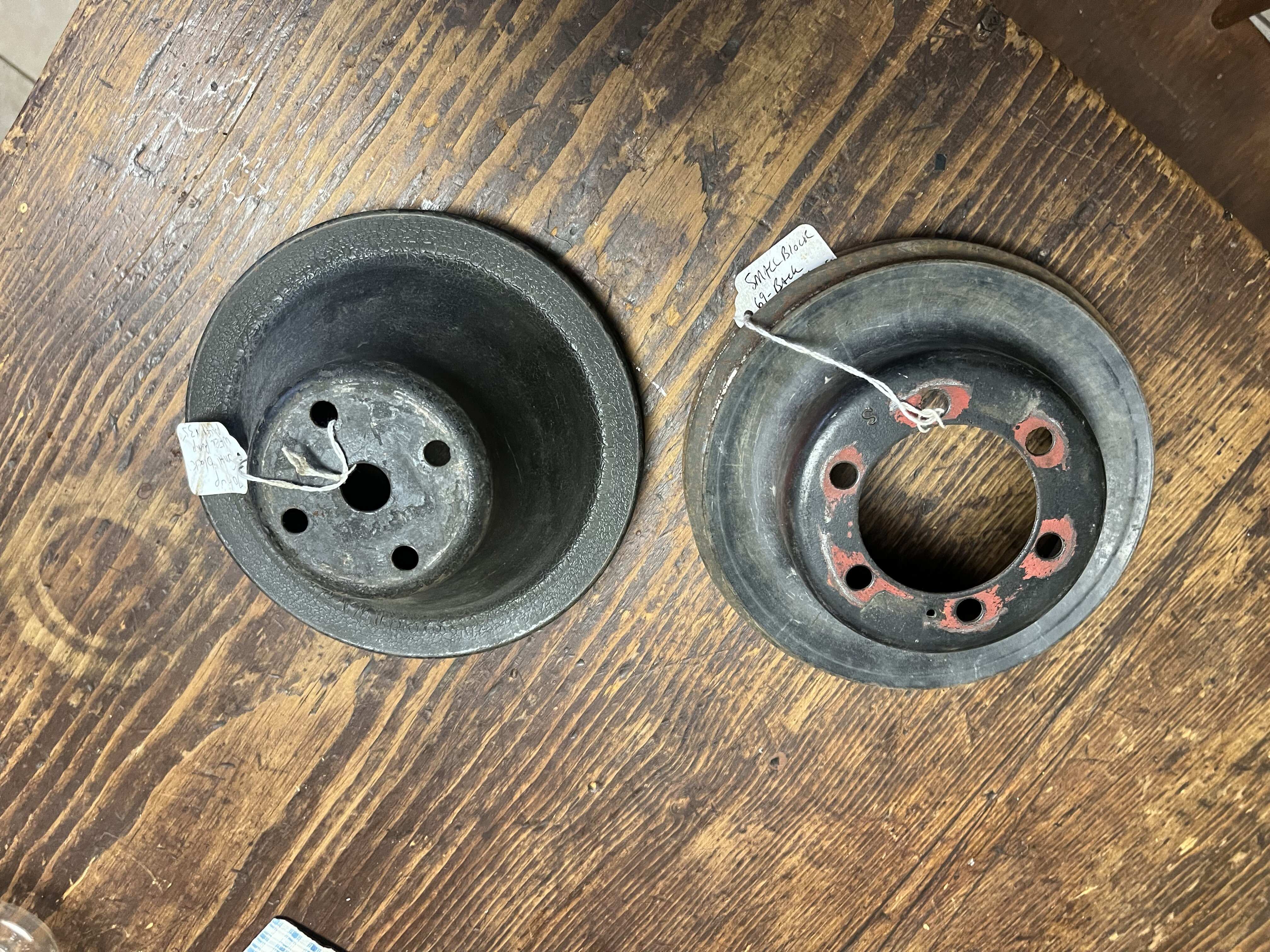

Here they are. The water pump pulley is clean just like the bottom but the paint on it is raised and crinkled probably had oil on it decades ago when it was painted. It’s not rusty/pitted both will glass bead like new. Crank pulley is still original paint.

I mentioned that to him when he pm’d me and that is corrected easily by oblonging one hole.

Don't you hate it when people get involved in your sale?
That crank pulley is offset bolt pattern, but backspace looks short.
Your tag says 69 back so iron water pump.

Especially when they are wrong as the pulleys were/are measured and marked. The lower pulley is correct as his is a 69 340 with an aluminum pump. The water pump pulley is the different size. I will make sure he gets the right parts. Also are you not the guy who tried to get me recently on the trunk torsion spring for the convertible? When I asked for a number to call never heard from you again…

Looks like Big block water pump pulley or could be a cast iron pulley for a SB they look very similar would need to measure it. In 71 the crank pulley was the same big and small block maybe 70 too but I don't know for sure. You can tell by the smaller inner groove..

No Problem. That crank pulley you have is the same as '70 so you only need the water pump pulley as the BB one will not fit.... Let me know if you want that.
