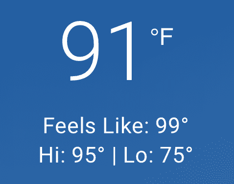

My conclusion is 90+°F days with “feels like” temps over 100°F are taxing the system at idle and in traffic with the A/C on Max.
Tomorrow, I am changing the coolant ratio to a 70/30 water/antifreeze mix. I will take some CTS temp photos afterward and laser thermometer temps of the water pump housing, intake, heads, etc.

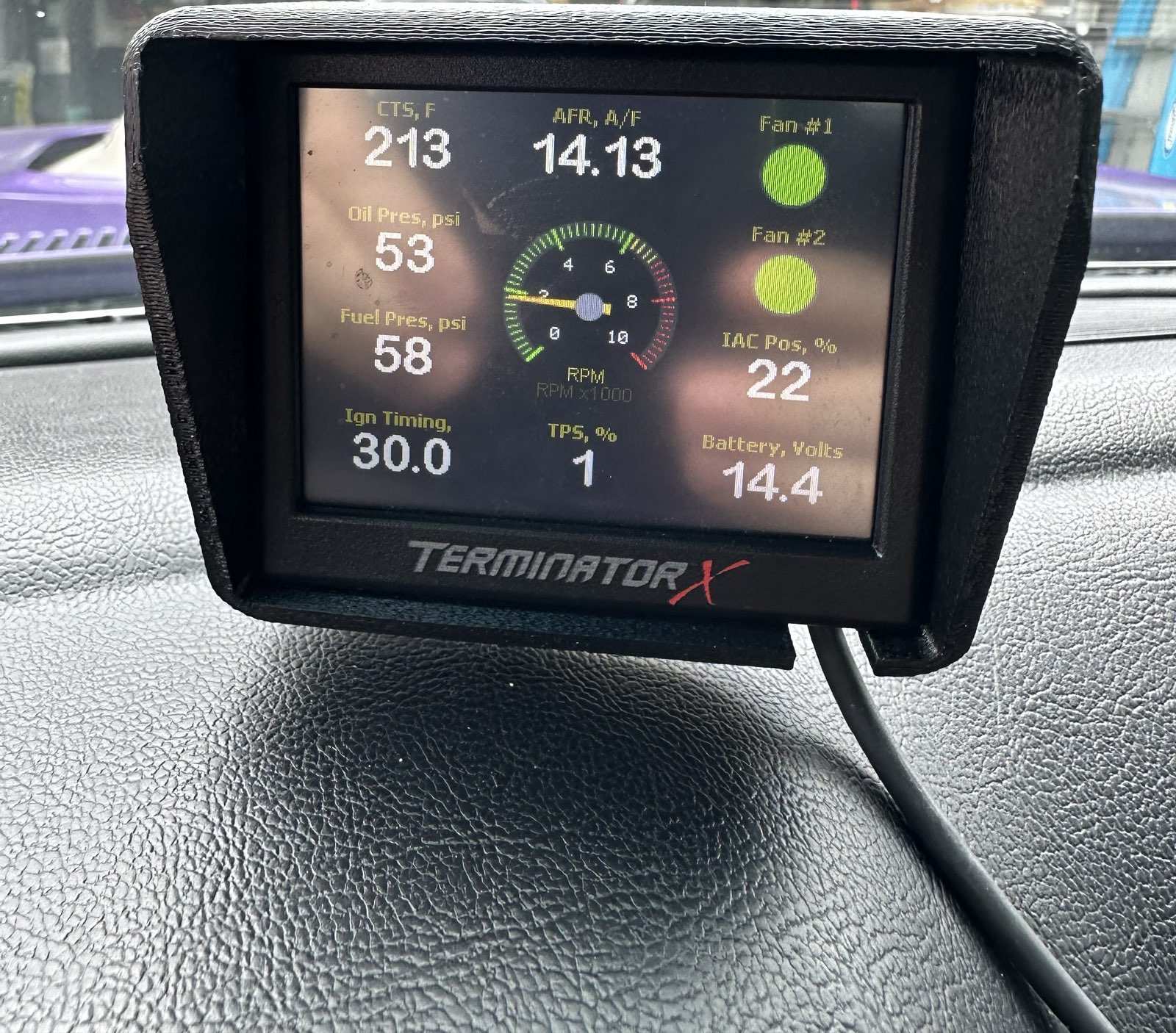

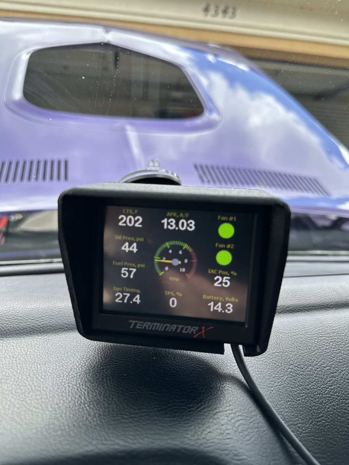

Test Drive

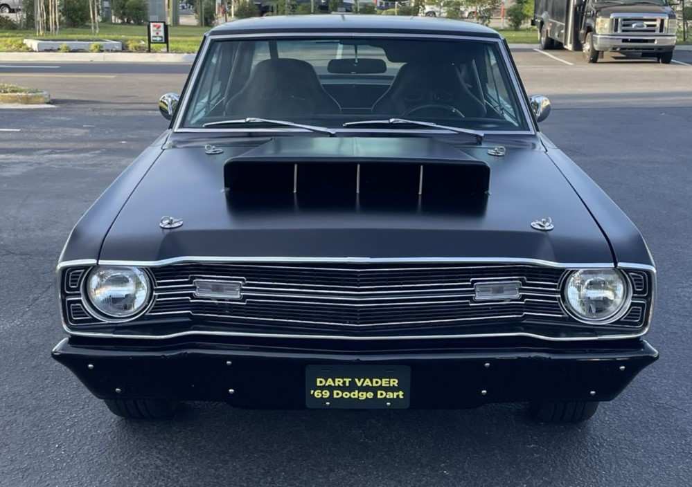

I headed over to a buddy's house to check out his `69 Dart with a MP crate motor 392HEMI, dubbed "Dart Vader" (pic below), and the temp did not reach 195°F. I did not run the A/C on the way over. His place is only a mile or so away and the speed limit is 30 mph so ambient temp was around 82°F at 10AM. The 195°F thermostat never opened (reached about 185°F when I arrived at his house) so I hung out at his place until around 12:30PM and then headed back home. The ambient temp was up to 91°F and felt like 101°F so I ran the A/C on High on my way back home.
Coolant Temp reached 195°F as I pulled into my driveway and I figured I would let it run standing still with the A/C still on High. The peak temp on the EFI display was 215°F and stable for well over 5 minutes and this was with both 9" electric fans turned OFF (disabled by dash-mounted switches). I decided to try a theory to increase water pump speed/flow and rev'd up the RPMs to about 1800. The temp fell about 2°F. More water flow seemed to help. I then re-enabled the electric fans and the temp fell to 202°F. That was better than I expected.
I took a temp reading of the water outlet when the thermostat opened and it was 195°F as would be expected.
I also took a reading of the lower radiator hose temp and it was 183°F which seemed to show the radiator was dropping the coolant temp by about 12°F before it entered the water pump inlet.
Everything seemed to be very stable and no signs of going above 215°F with the A/C running without the electric fans AND approximately 202°F with the A/C running with the electric fans. All in all not bad for the Florida heat.

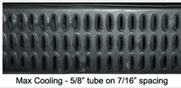

I will likely plan on getting a Glen-Ray reproduction radiator with their Max Cooling option which is brass with 5/8" tubes & 7/16" spacing.
My preference is also stock-appearing and the durability of brass. I do not have an original 2998956 radiator to send to Glen-Ray for restoration.

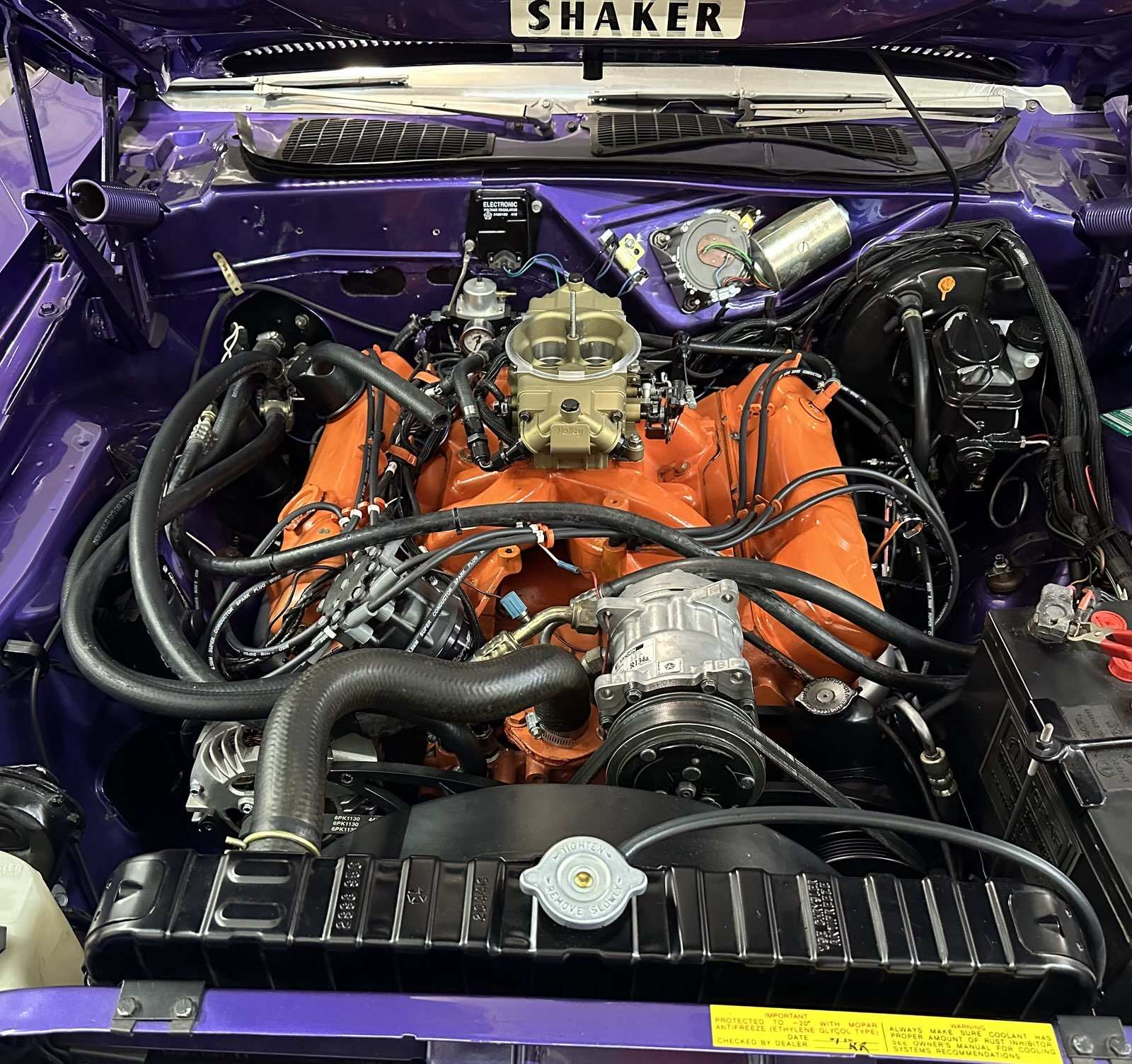

Update to this thread. I began an auto-to-manual conversion in DEC2024 and installed a TKX 5-speed with hydraulic clutch. During the project I also installed new TTI 1-7/8" headers, a Borgeson power steering box, and a new Glen-Ray 956 radiator.
There have been zero cooling issues even during this past June and this month July and the coolant temps are in the 180's - 190's without using the auxiliary electric fans. The entire project has gone perfectly. The previous Terminator X Stealth EFI conversion along with the above changes has made my Cuda the best it has ever been and that is with 41 years of ownership!
