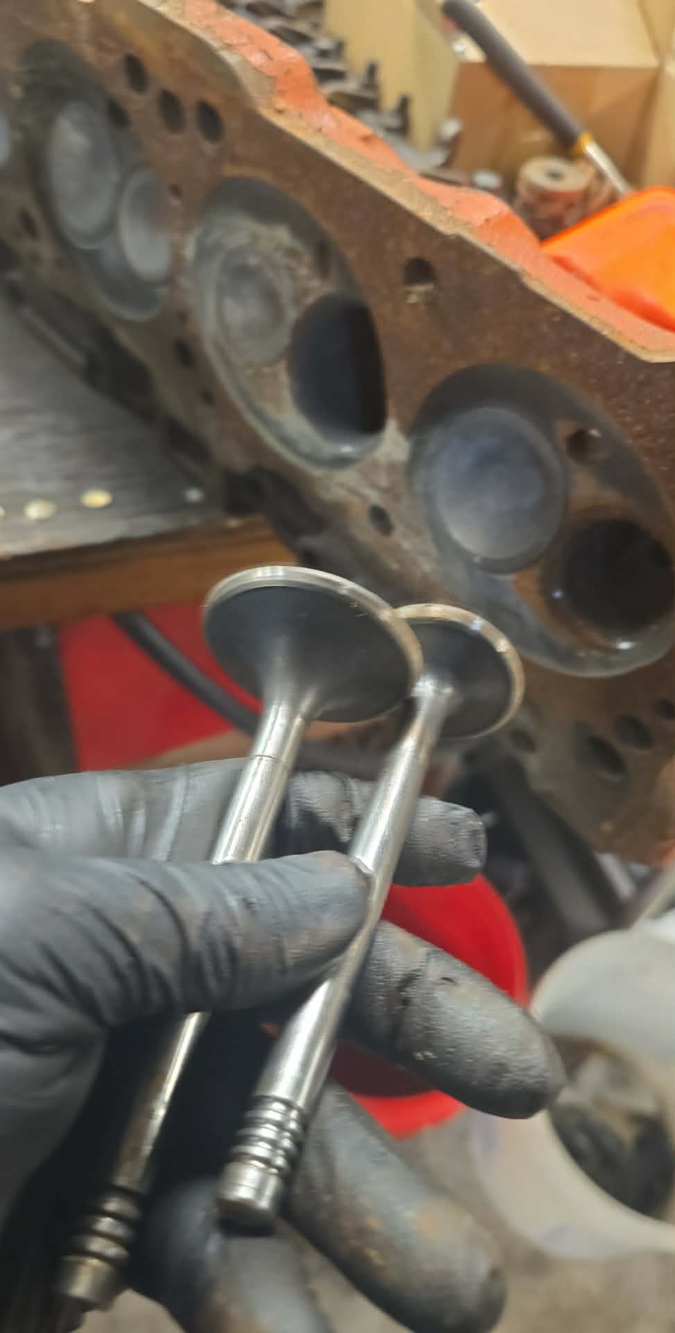

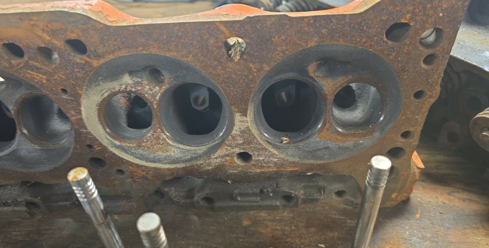

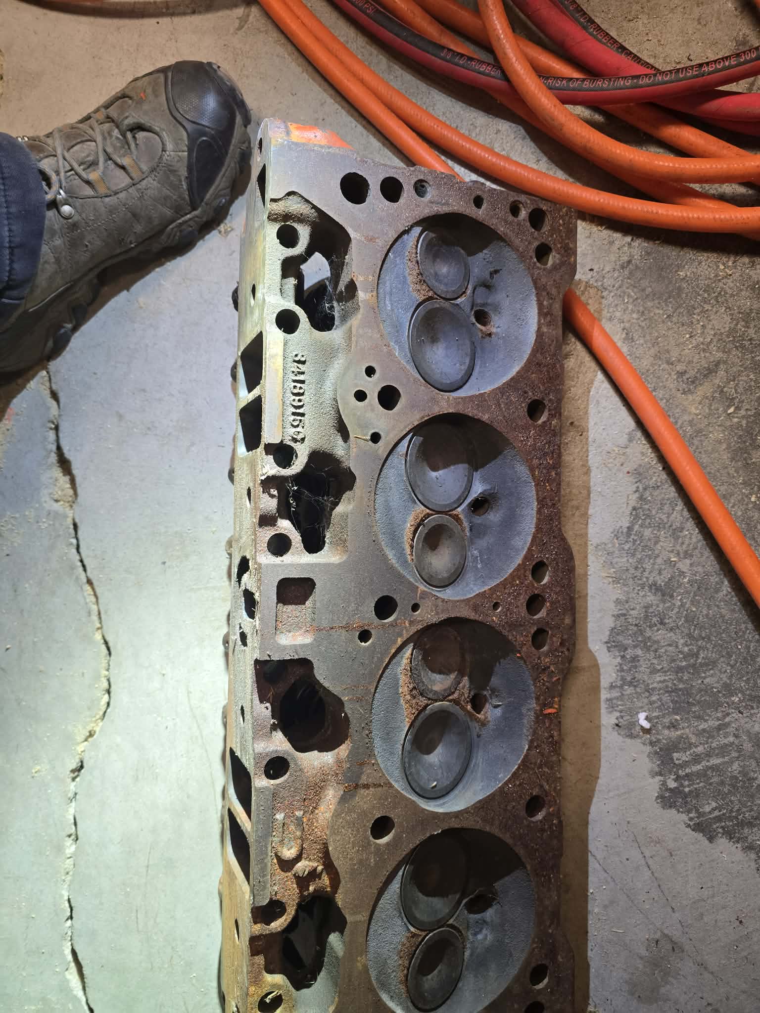

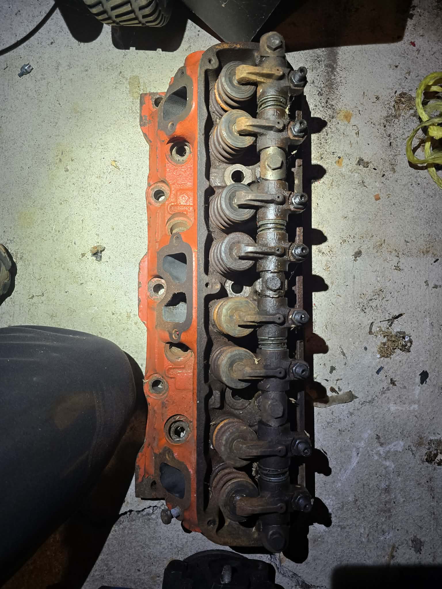

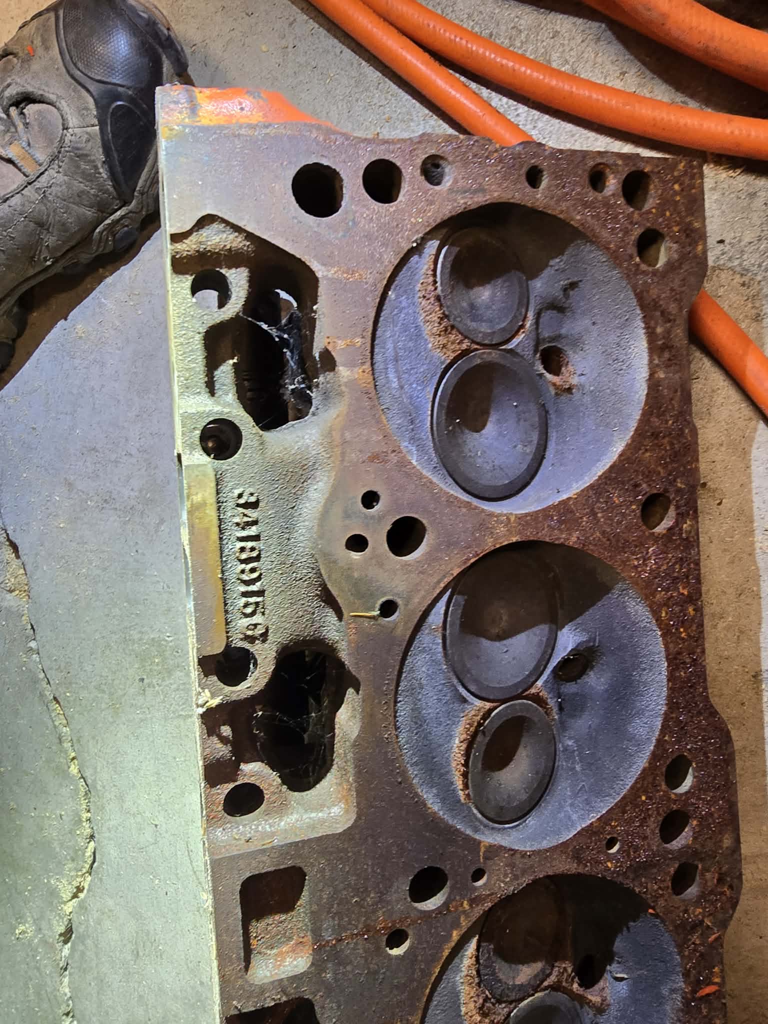

Yesterday at 10:54 AM #21 A aussiemark Well-Known Member Joined Nov 29, 2014 Messages 1,230 Reaction score 340 Location Perth Western Australia Don't have valve seat inserts fitted to the intakes if you do you won't be able to fit them to the exhaust which you should do. Have them crack tested before you spend any money on them.
