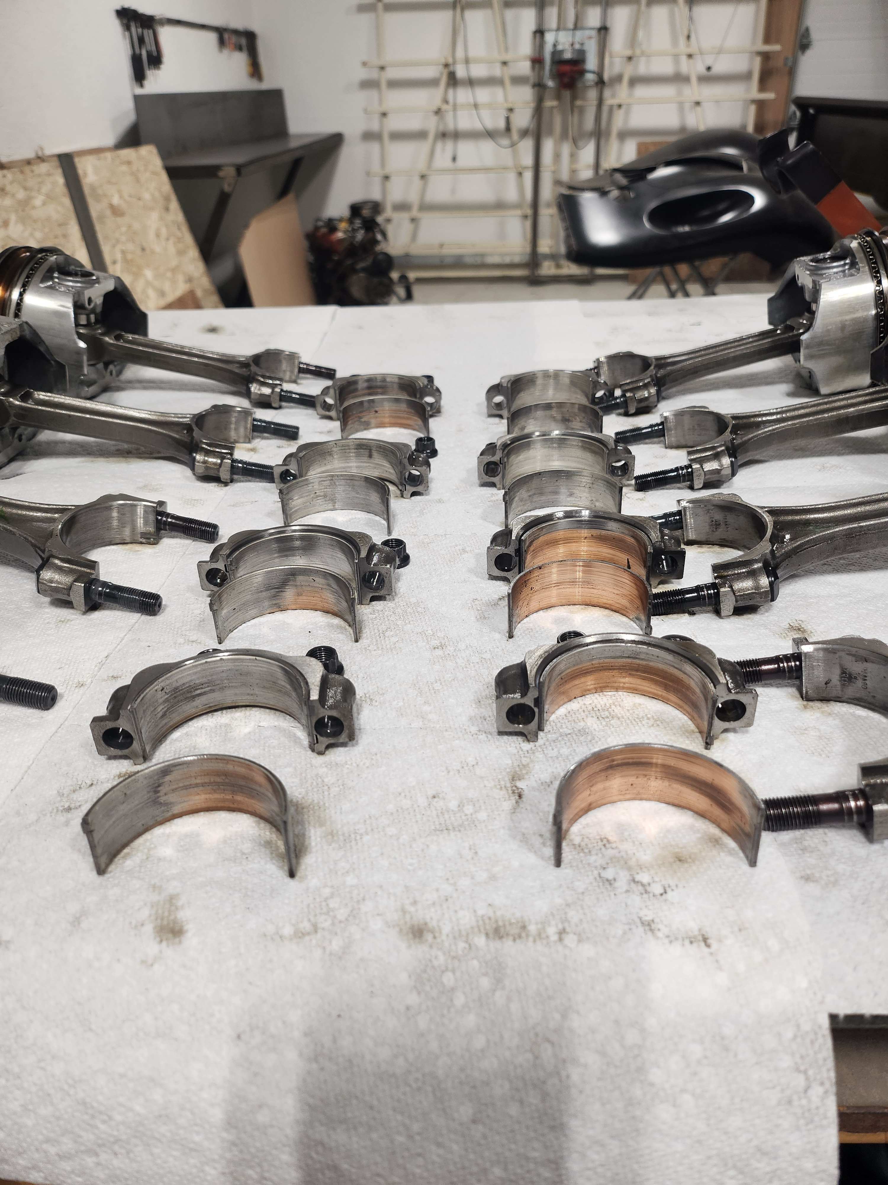

Dang! That's a lot of copper showing on the bearings! The 70 413 I recently rebuilt (quickly shade tree job) didn't have any copper showing! Lots of grooves in the throw in your picture. Tell the machinist you want the crankshaft "indexed ground"! This insures all rod journals are 90 degrees from each other! Mopar cranks I've ground have been damn close, but ask for it and pay the difference. That's one of the ways to make real power!
yes trusted a guy I went to school with to do this, the son of the guy I bought the car from, a head tec at a dealership up the road, and a mopar guy that has raced for 35 years. thought I was safe. It was at his house to be reassembled when I bought the car thought it would be easier to just pay him than to gather the parts and take them to another guy I trust, mistake. oh well Like I said gonna have it hot tanked and mangnafluxed first then redo everything and add some horsepower to it
