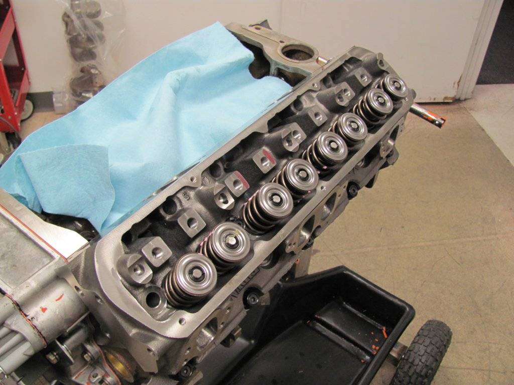

I've used both the LAX heads and the Edelbrock aluminum. I prefer the Edelbrock RPM heads with the 2.02" intakes replaced with 2.055" intakes and then ported. On 91 octane pump gas we used the LAX 1.94/1.62 heads to make 468HP with a 292ci/273 engine and the Edelbrock 2.02/1.60 to make 601HP with a 360 stroker.
Here are our LAX heads set up with Chevrolet rockers..........
And yes they are the LAX heads not the Magnums. I used the LA rocker shaft stands to anchor the stud girdle after I installed rocker arm studs in the LAX heads. Used this system to run to 8,200 rpm. Here are the airflows with the 1.94 intakes and the 2.055 intakes in the LAX heads.

So, I guess I'll post this now and see if the photo shows up in the post.

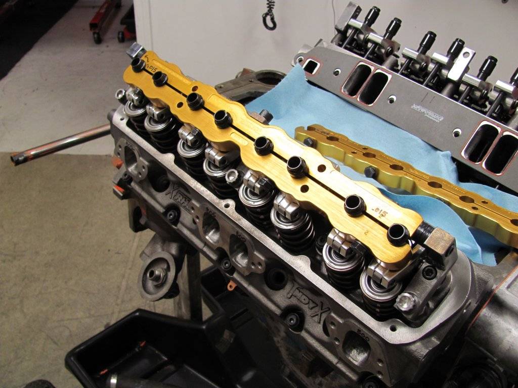

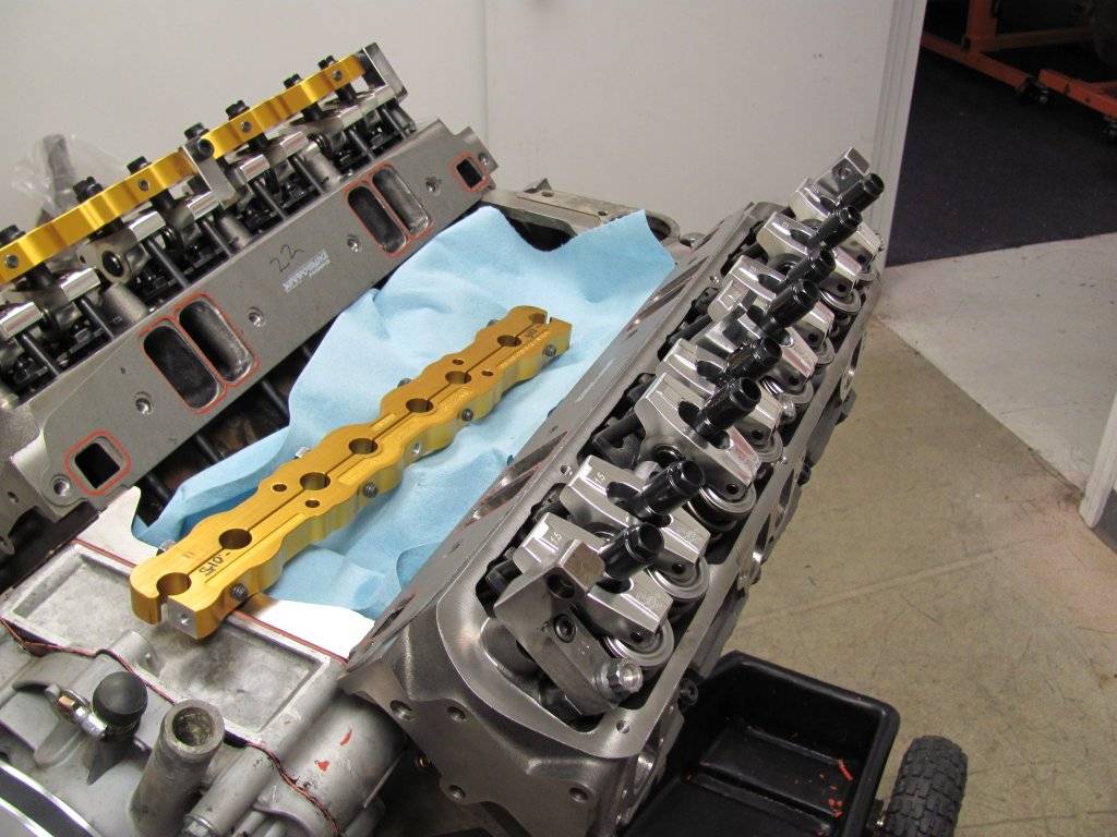

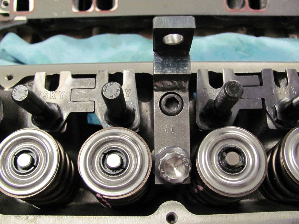

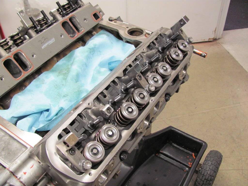

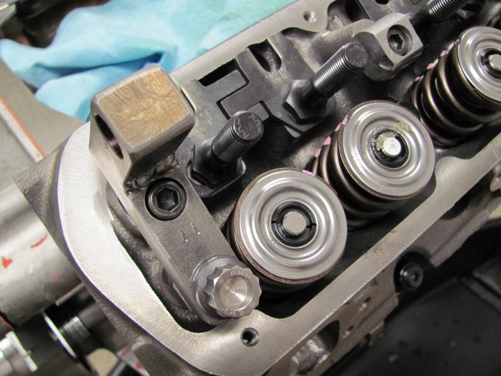

8200 rpm. that's a vary stable set up.
could you explain the gold bar across the top?
Just don't get how this setup works.......

These pictures may help. The "gold bar" is a stud girdle used to tie all the rocker arm adjusting screws together to help keep the individual adjusting screws from flexing under load.

Cudafever
Dec 23, 2010
146
11
Ok thanks alot! they say a picture is worth a 1,000 word an this is no exception.
So......the GM stud design was chosen to be able to get the right valve tip geometry thru proper push rod height/length?
Always felt that the chry shaft mount was way stronger. That set up look plenty sturdy!
