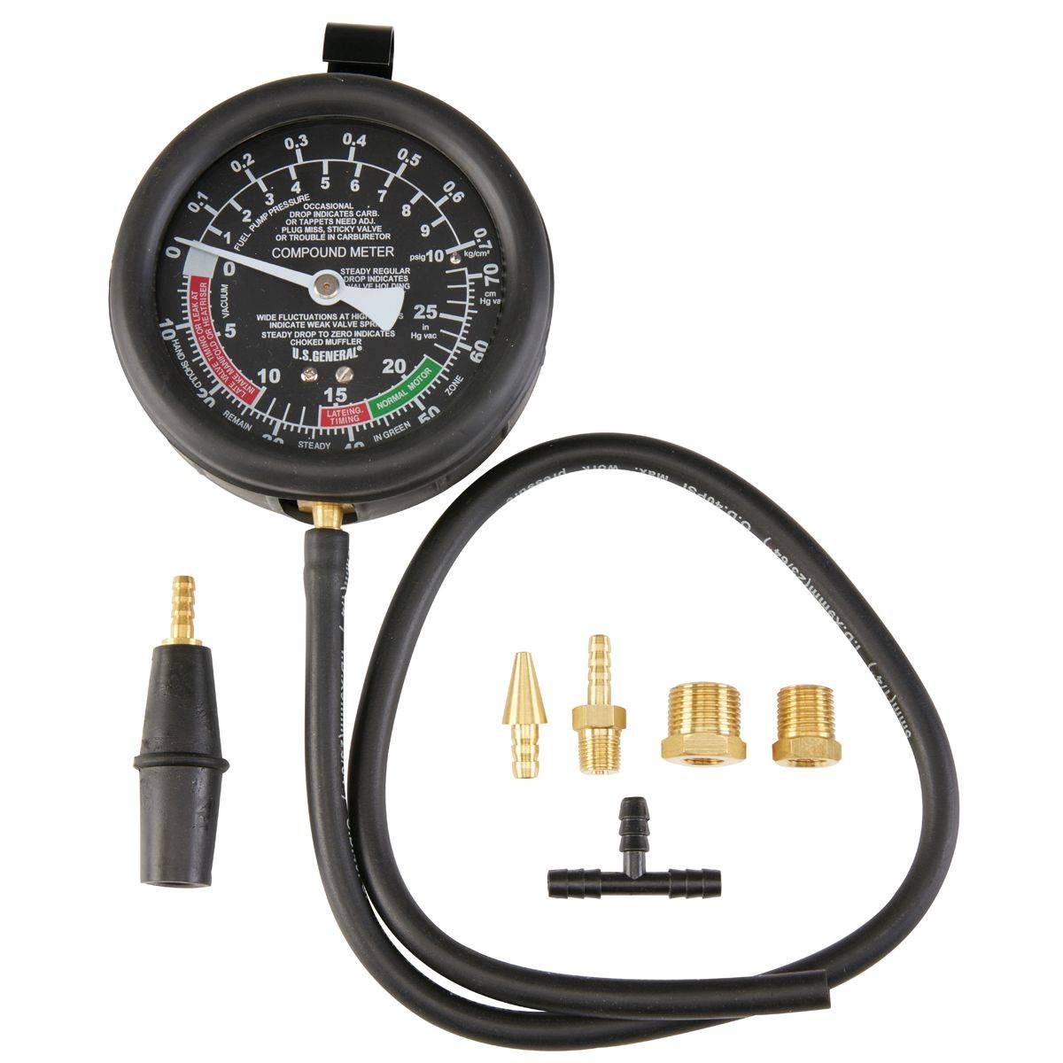

Spend less than $20 and buy a fuel vacuum gauge. Check it yourself.very easy to do and find out the problem.They have known to be in error!
