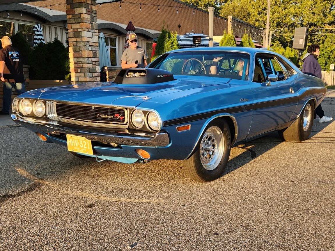

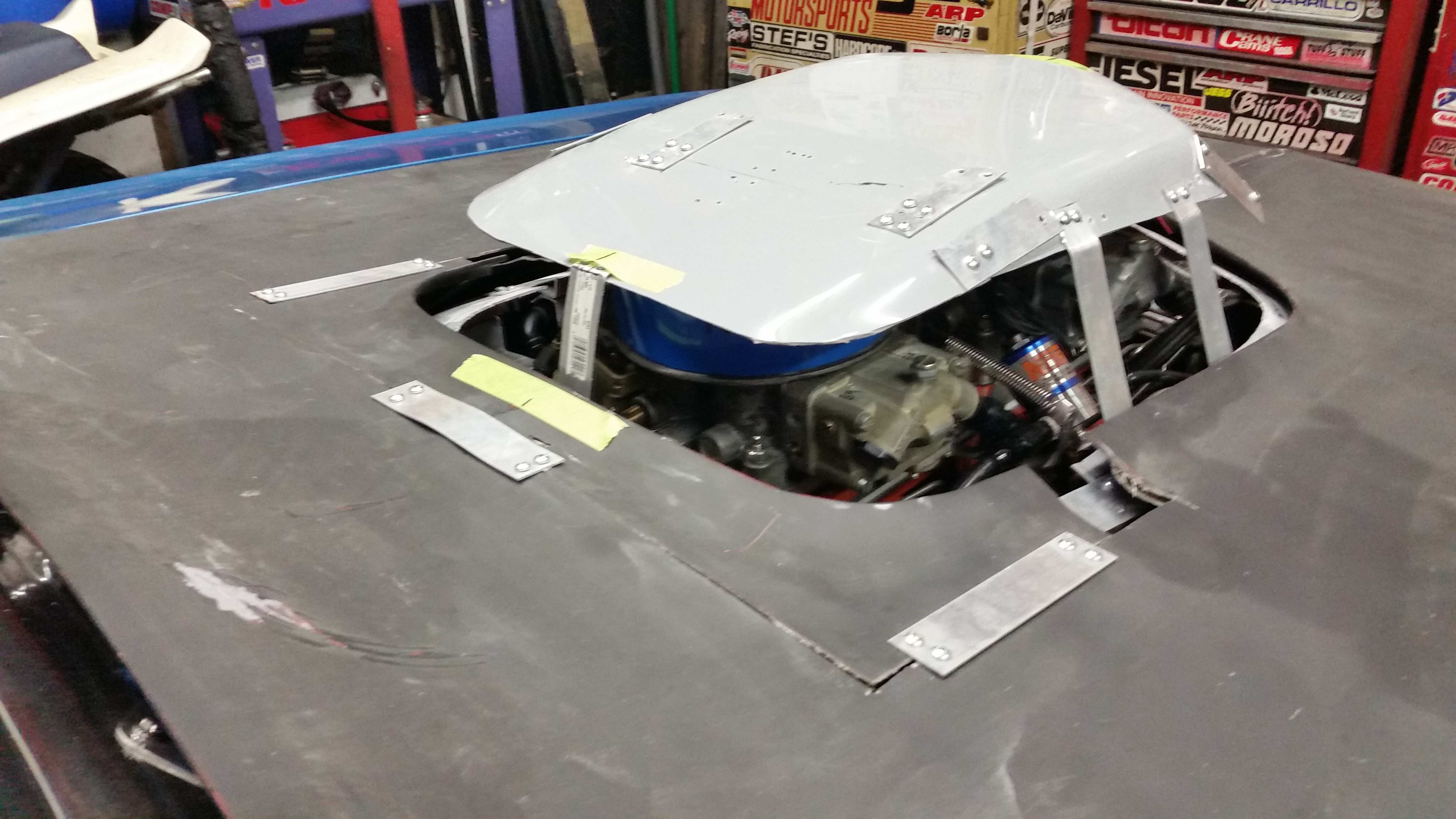

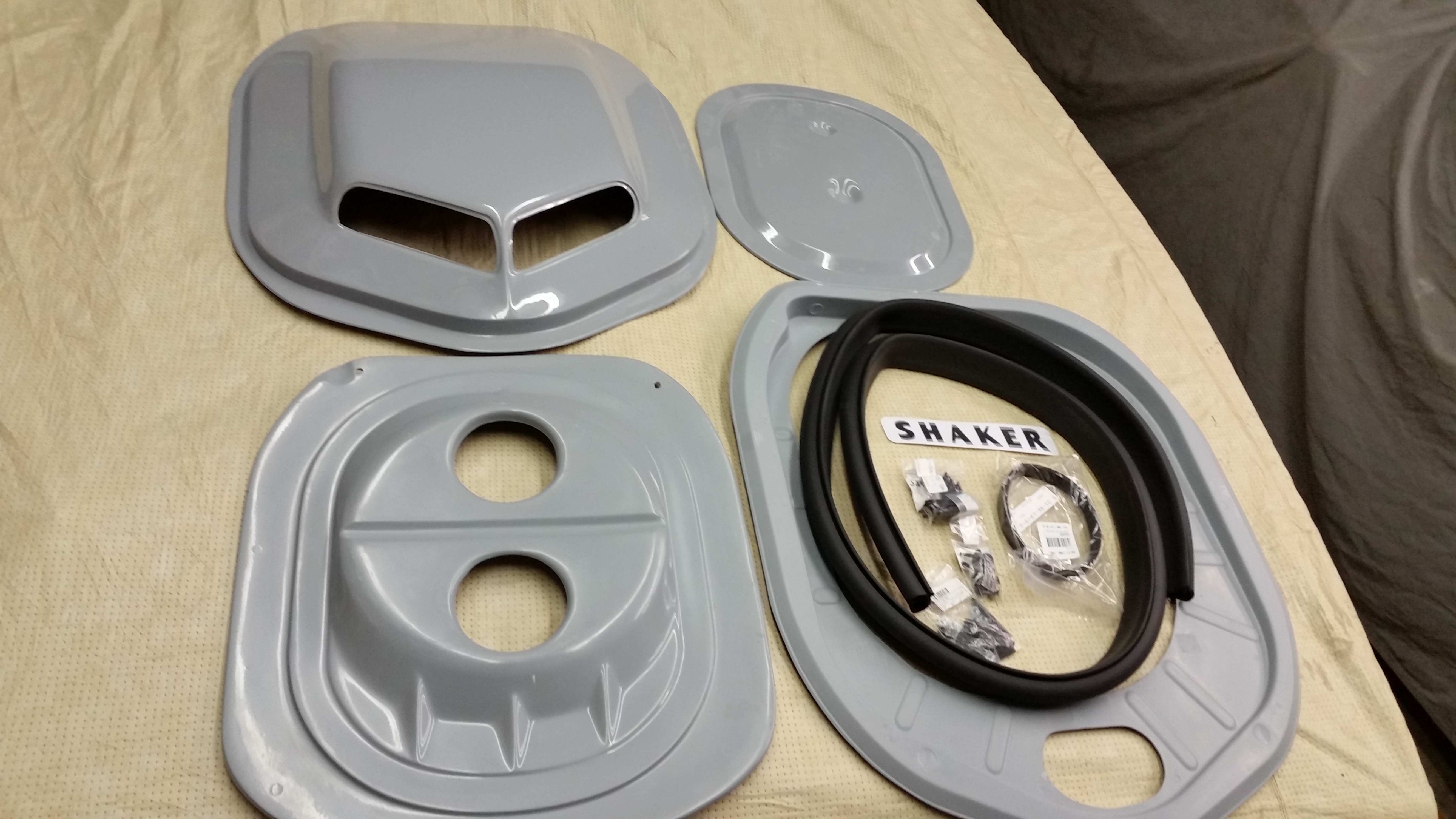

Anything can be fabricating to be functional and needs to be mounted to the engine. Mounted to the underside of the hood just seams cheap or lazy.
I custom fabricated and shaker hood and functional scoop for my 528" Hemi with two 1050 Dominators on top of an Indy tunnel ram.

Check here, he did a build thread that gave all the details. Not functional, but looks good.
HEMIRAG
Well the car looks great and there's lots of pics - thanks for sharing that. But I didn't see how he mounted it on top of the 392.
However, seeing what he has done on his car in the pics makes me realize that I can fit the shaker bubble on top of the 392 engine (there's enough clearance) and just figure out how to mount it in the right place. Thanks again.
