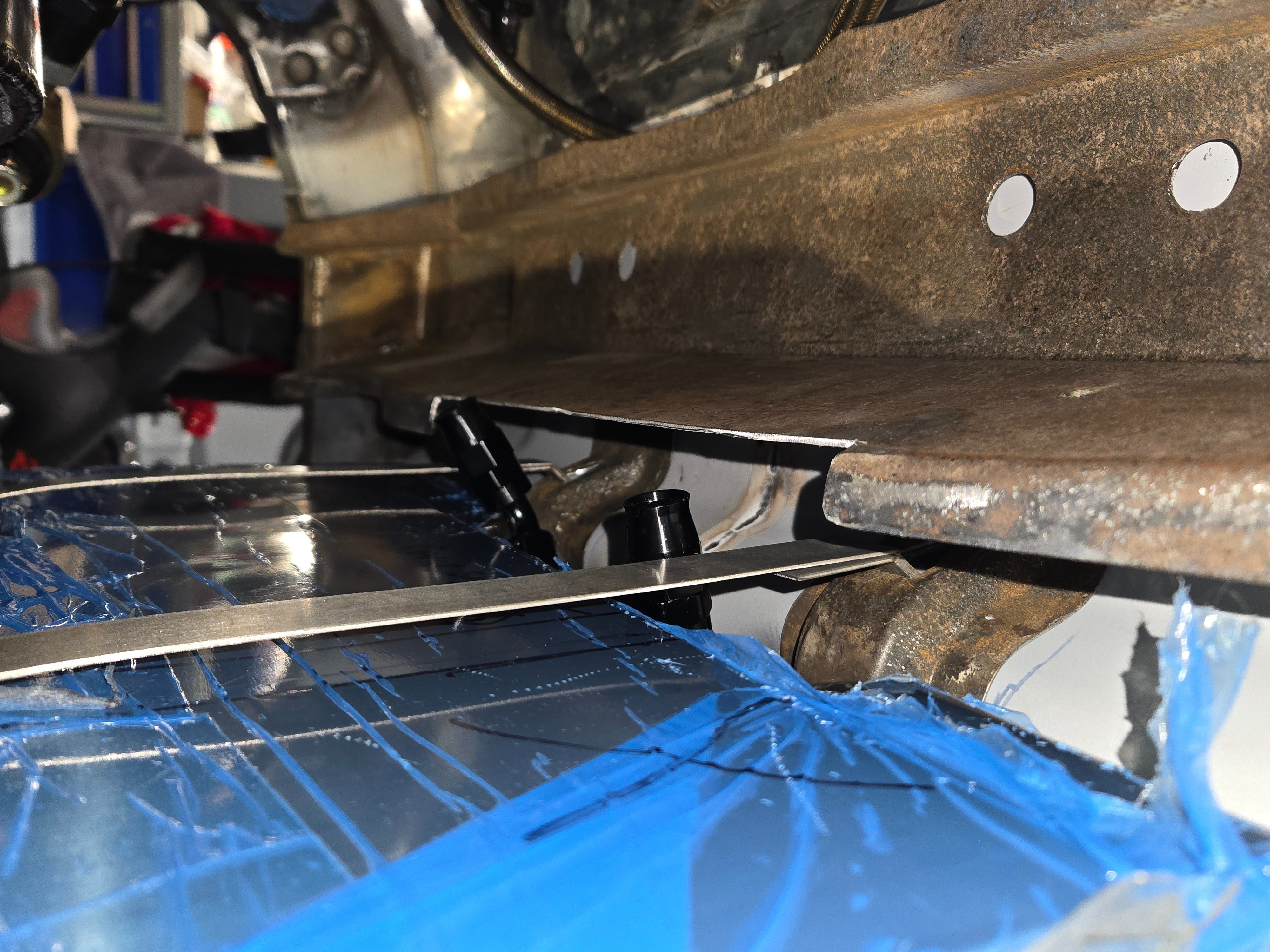

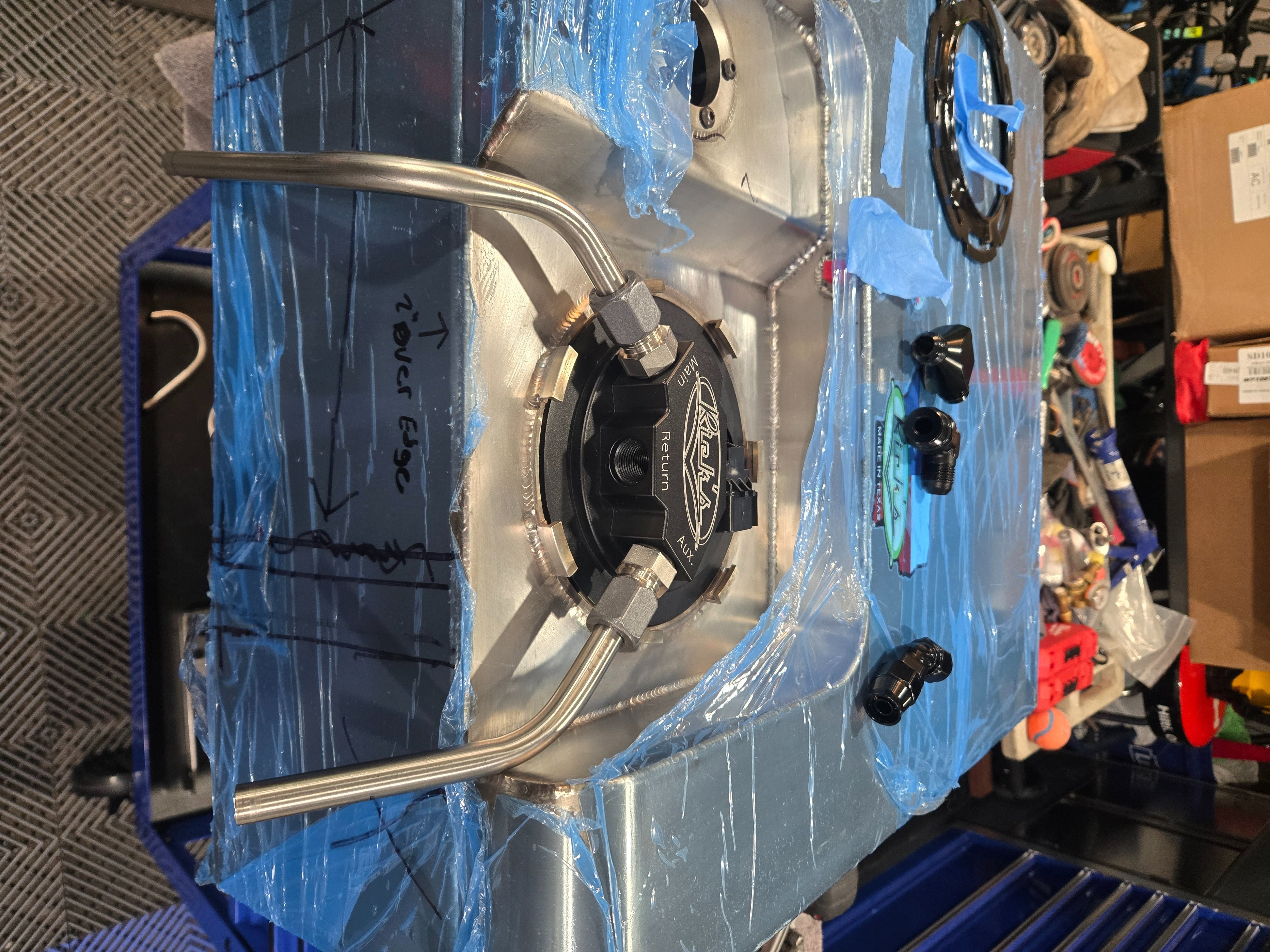

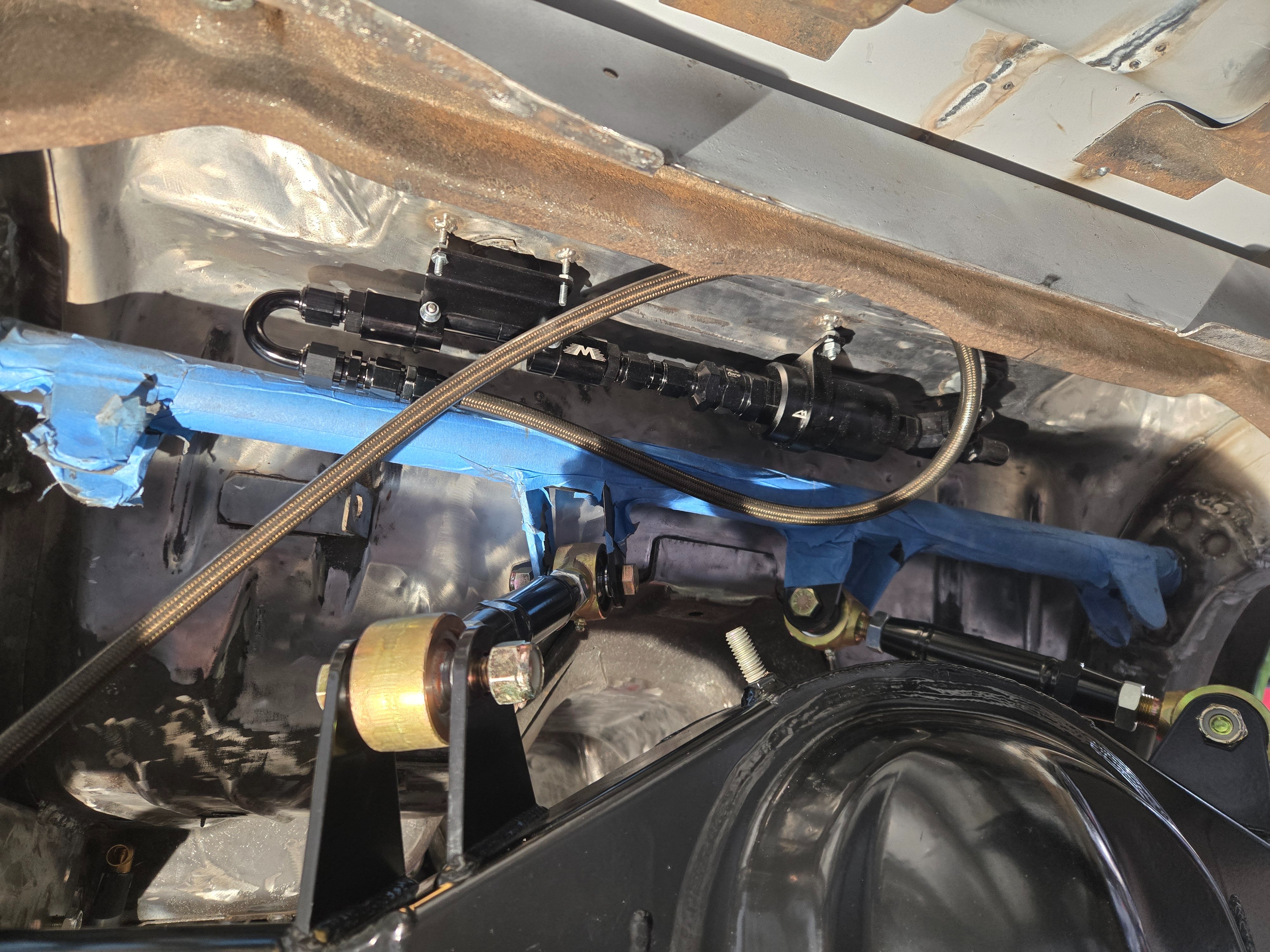

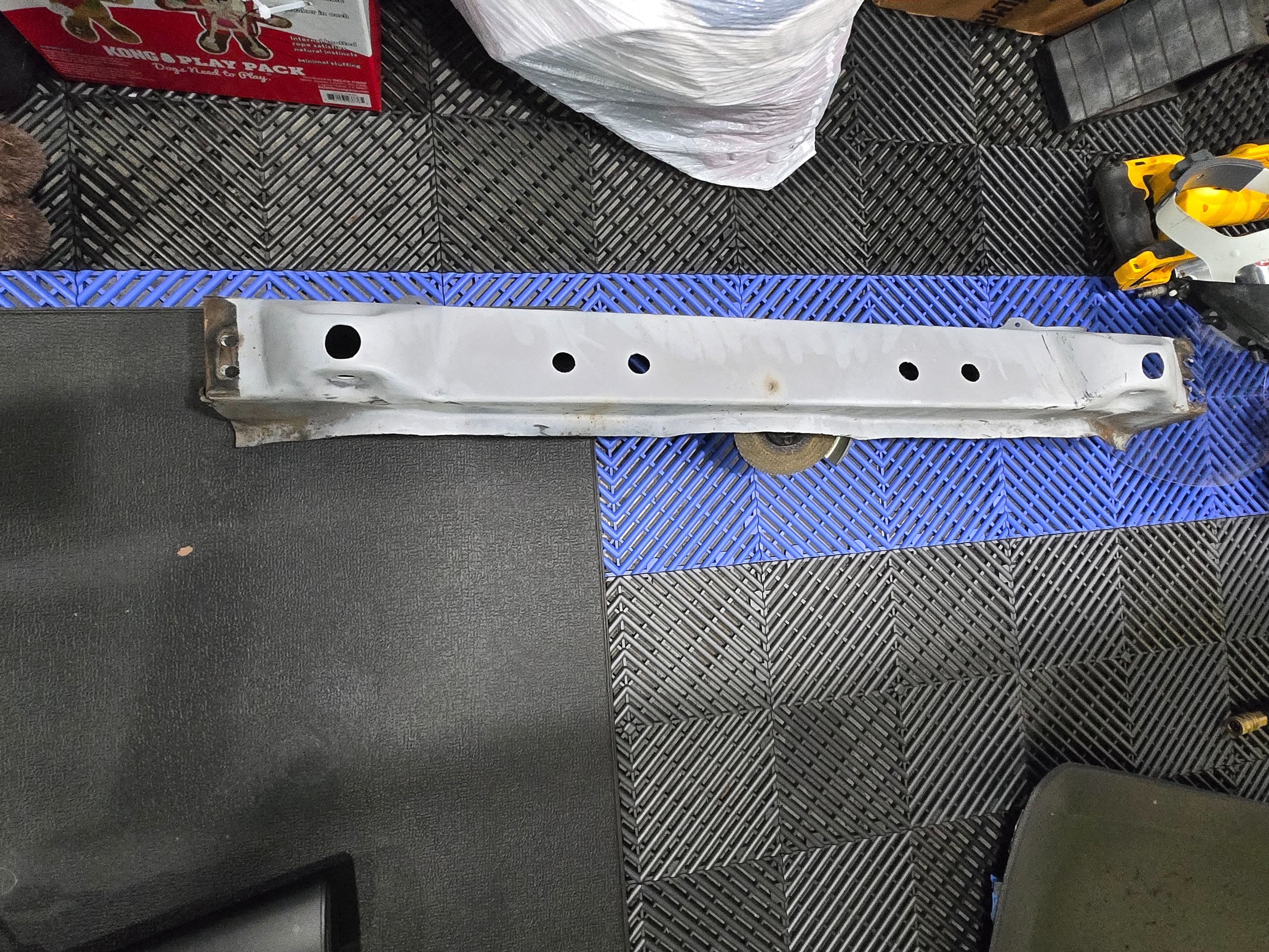

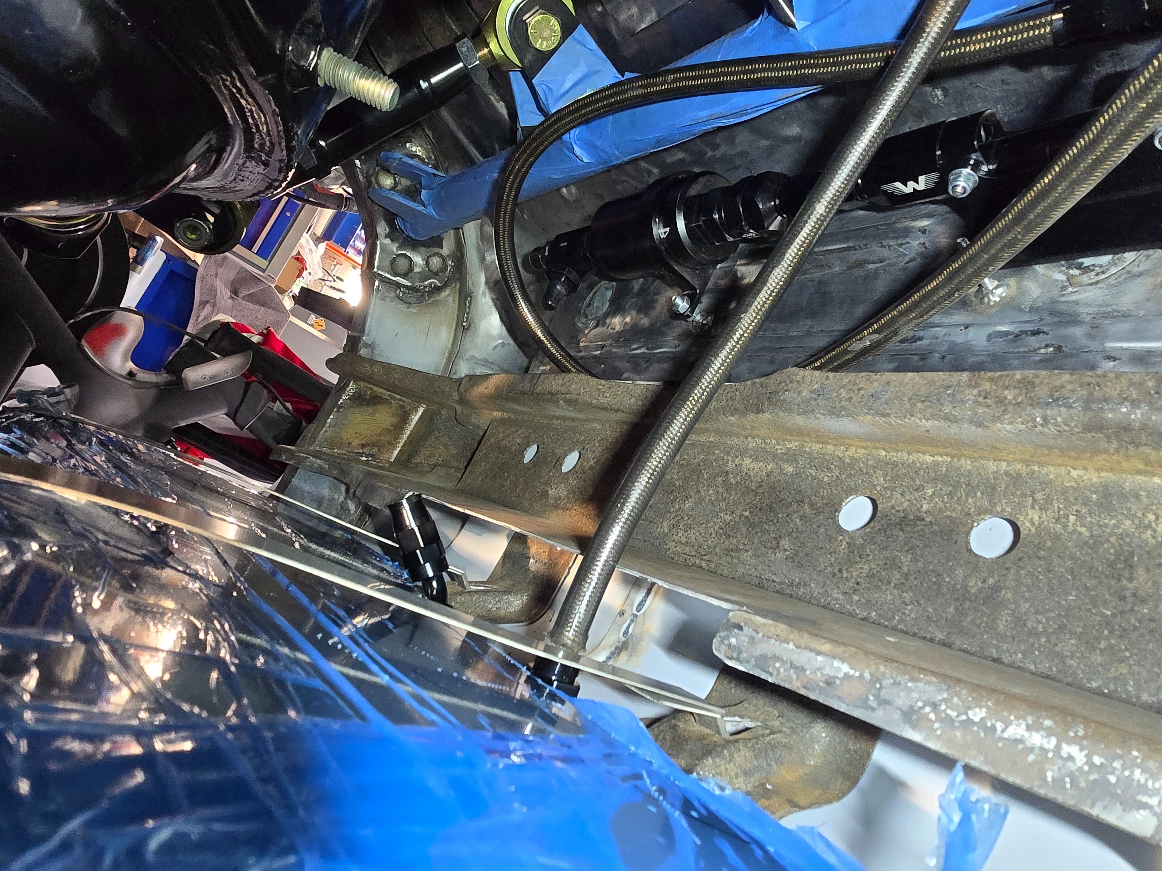

Anyone running a 4 link in the rear ever remove the old shock tower crossbar? The one that sits in front of the gas tank? I'm having a hard time trying to plumb the fuel lines from the tank to my filter and Ethenol sensor. I was thinking I could remove it and replace it with a round one bar similar to the four link cross bar. I have a Rick'sStainless steel tank and the pump hat isn't in the best location. In order to clear the rear end and not rub the fuel lines, I have to come out of the tank and almost straight up but the fittings will run into the factory cross brace. I notched it a little but it didn't help much. As much as I need to notch, it would almost take half of it out. I figure why not just remove the whole thing. If i ran the line straight across it would be smashed bt the rear end. Let me know your thoughts.
