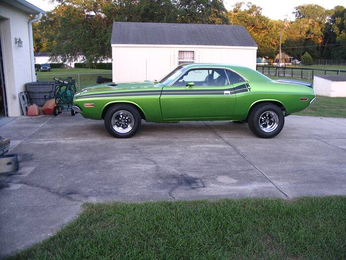

Cratos
Sep 11, 2018
408
65
Sunny Florida
Im going with a A body rear and doctor diff 1 inch relocation kit I have keystone 15 x 10s and 295-50-15s so I needed to move the tires in 2 inches on both sides .as soon as my disk brake kit gets her I'll post some photos.
